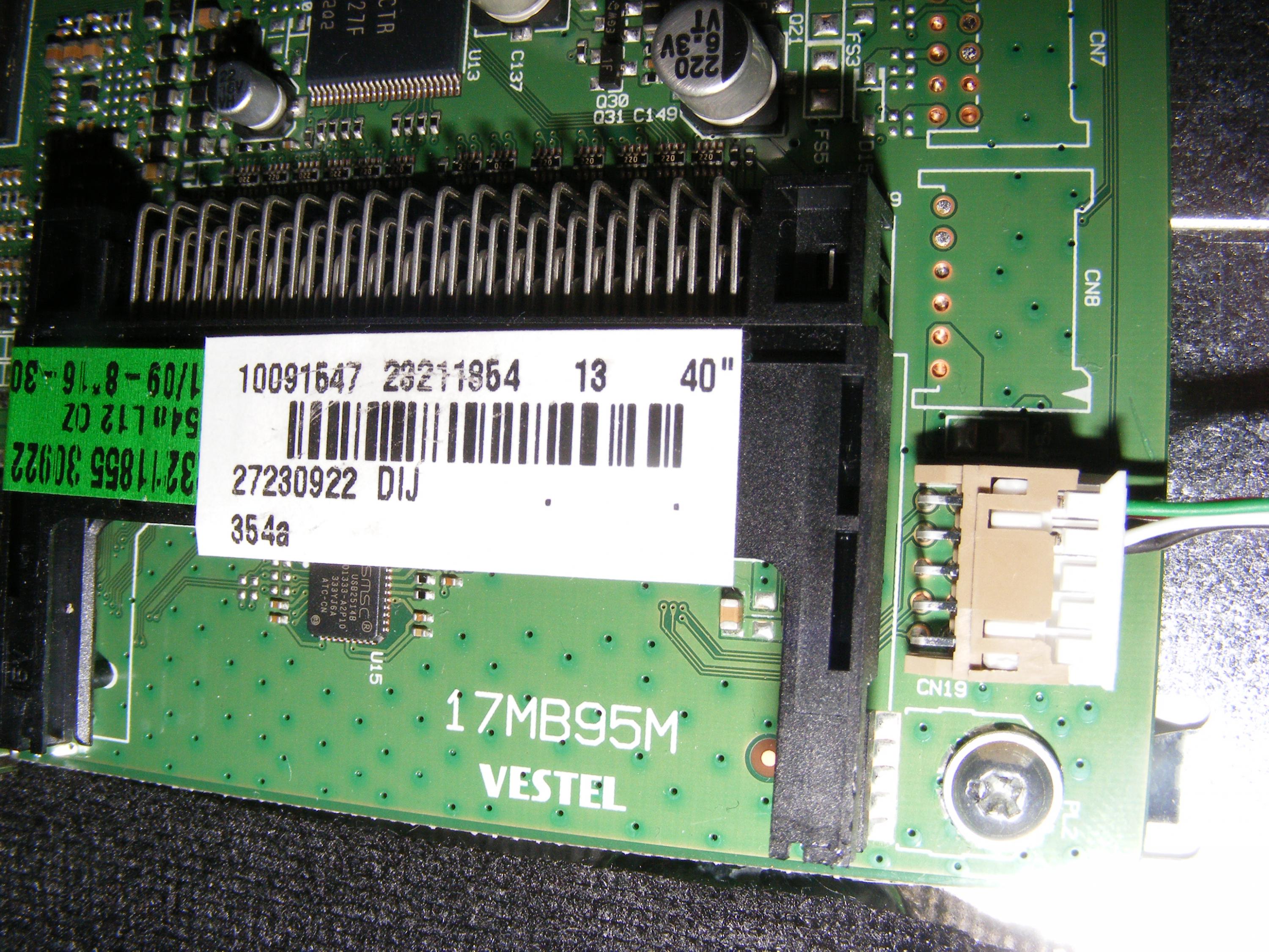

                  Mikeyboy, what's the model number of the TV? I'm facing a similar problem with a Bush 40" LED with a possible firmware issue. Am trying to find a file to try reflashing the firmware chip but no luck so far. My board is 17MB95M though.
                  https://www.badcaps.net/forum/showthread.php?t=44389

                      Interesting. Same model number but mine has the 17MB95M rather than the 17MB95S-1. Do you mind sharing your panel sticker and maybe the sticker on the back cover to see the other relevant numbers? I'm wondering if the firmware we're looking for is specific to the model number, panel number, main board part number or what. Toshiba's website has their Vestel firmwares by TV model number, and I wonder if they also use different boards in the same models. Anybody know about this?
                      I'm about to try some firmware flashing as soon as I get a moment to figure it all out.
                      It's a TV I got spares and repairs so I don't know if the previous owner was using an app when it happened. I didn't think to ask.
