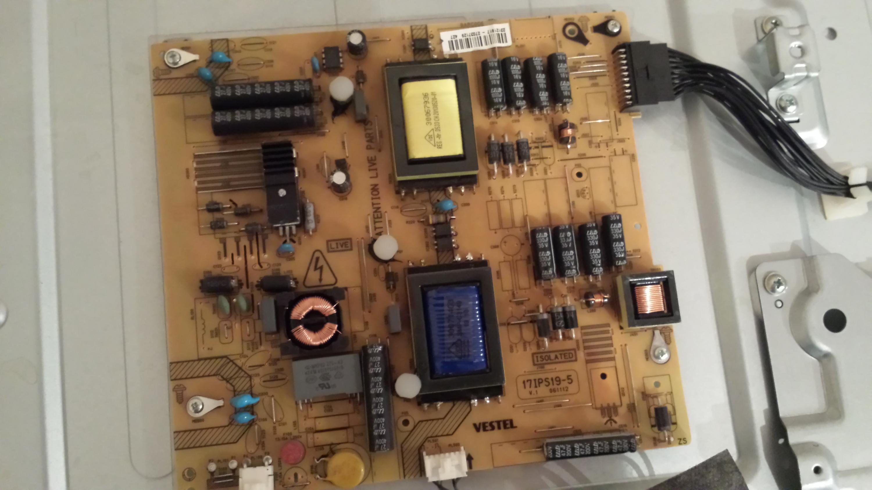

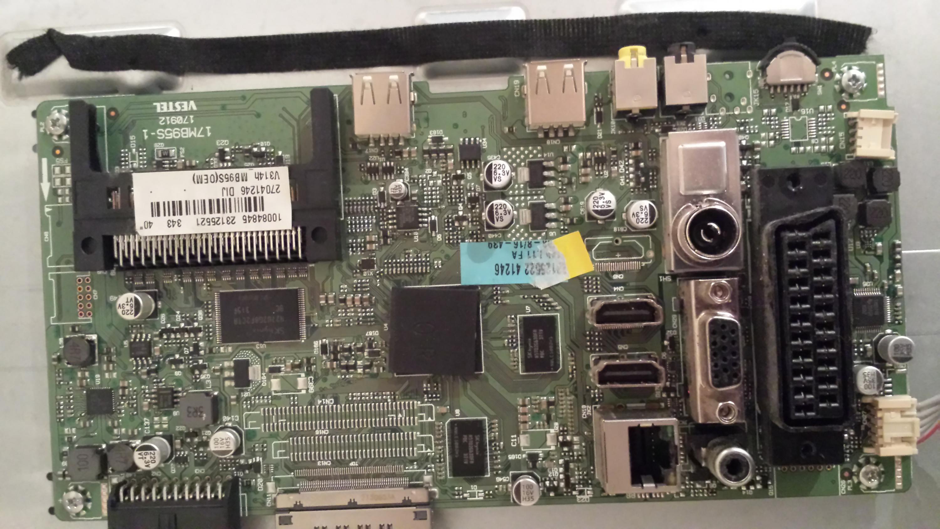

    Hi guys ive been asked to look at this tv by a neighbour. She said to me that she called the argos helpline as that is where she purchased from and they said it was because she shut the tv off while the Netflix app was open. When you switch the tv on it goes to a blue screen for 5 -10 seconds then shuts off and back on continously. The red LED on the front blink on and off repeatedly through the whole thing. Could anyone point me in the right direction for repair ? I have attached pictures of the 2 boards in the tv.
    Re: restart problem with Bush LED TV
    It's probably corrupted firmware. Maybe try flashing new firmware with USB stick. Vestel has a lot of issues with firmware corruption.

        No longer under warranty? It will probably need a new main board then.

        Might be worth checking some PSU voltages, perhaps try pressing down on the CPU see if it's got a cold joint on the BGA. Check LDOs: U14, U6.
        Schematic of PSU:

                    got new board through and installed in TV and still not working, tv doesnt shut off like before but still have no picture, changed Tcon board and still the same, could it be a possible faulty panel ?
                      So what new board did you try ?
                      what voltages have u checked so far ?

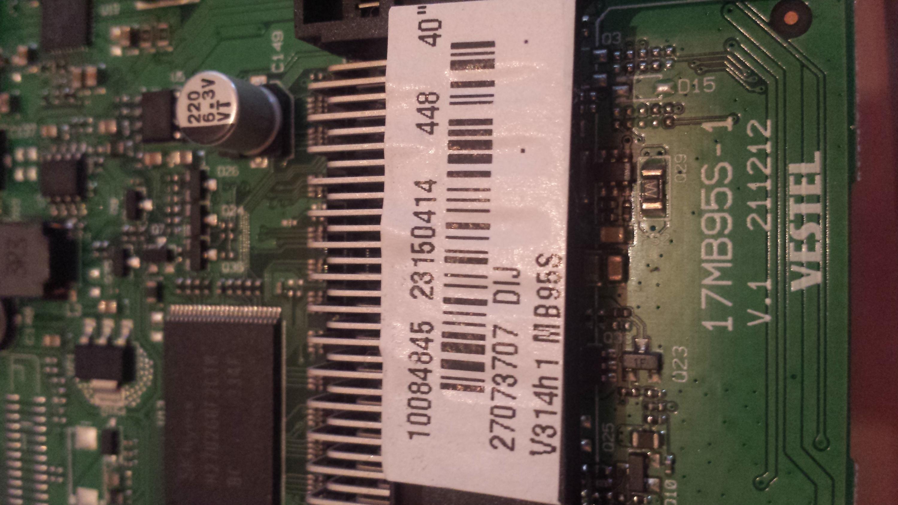

                        Be aware that there are many board variants and you need the exact one. Also, you should still have at least the original symptoms (shutting off) if the main board was good and something else is causing the fault... the fact that you don't would indicate the main board you have received is bad.
                          Ive had trouble trying different 17MB95 boards....
                          It MUST be the exact same one Ive found from the same sub-make (Alba, Hitachi etc) to work, and have the same paper label number.
                          I fitted one--and let the smoke out as the panel was a different version to the one it was made for!

                              But--IS the Paper Label Number the same....??

                                this is gonna sound so daft, but ive lost original board as i have loads of them so its been thrown in with the rest of them.
                                  Ah--But! You have a picture--With The Number--at the top on this thread!!
                                  TELEFIX
                                    is it the white label ? and has all the numbers got too match ?
                                      yes i try to match up the model of the tv and also the board number and the white label as well due to there being so many differnet versions of vestel boards around

                                        Im noticing a few differences.
