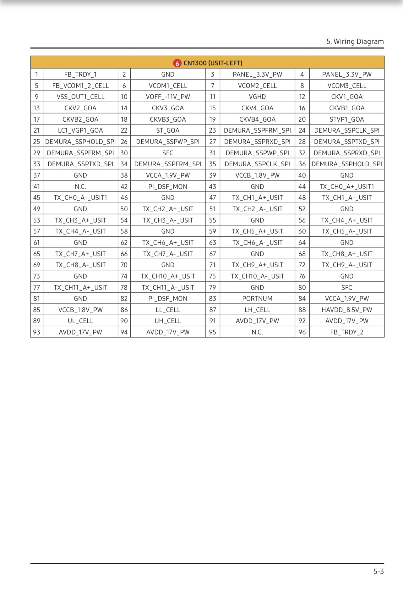

    I have the 55” variant of the Frame TV which is essentially a QLED tv. There's a weird problem where it would keep on restarting on its own. Funny thing is it might work perfectly for couple of days and then decides to go down the restart route. A few pointers:
    1. If I let the TV sit idle for a day, for the very first time it boots after that time period it usually keeps working for 5 minutes before restarting. After that it restarts every 5 seconds.
    2. I've tried the tape method and seem to find a pin where I can see the picture (although with frame skips, vertical lines and what not) and the TV doesn't restart. It's the VGHD panel pin.
    3. Since I've tried the tape method, that also implies I've eliminated other potential causes. Basically if I remove the display connector, there's sound and no restarting.
    4. If the panel is faulty, why don't I see any dead pixels or horizontal/vertical lines when the TV is working properly?
    I do have the service manual with me but not able to decode which pins should I try masking for a stable picture. I don't mind even if I end up with a dead pixel row. Any sort of help would be appreciated.

      Thanks for the prompt response. As a matter of fact, I saw the exact same video before going ahead with the tape fix. Unfortunately this particular model doesn't have an isolated TCON board. Also, the COF strip has a connection for the right part of the screen, but the left part is soldered. I've tried disconnecting the right side and it still restarts. Can't check the left part though
      Now, coming to what's shown in the video, I've actually tried taping those CLK pins but I end up creating more mess. Instead of any improvement the image deteriorates further. The best I could do was by masking only the VGHD pin. I guess I'll have to check for shorts on the driver.

                  Update: Got a professional to look into the issue. A panel COF is the culprit. Will probably have to get the whole panel replaced since the part is not available here.
