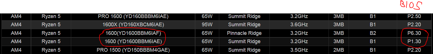

          Which version should I update to? Currently, I'm on p5.40. I know that some of the newest versions may be not compatible with ryzen 5 1600.
          • lotas
            • Jan 2016
            • 4879
            • Russia
            Re: Problem with stopping audio and video for no reason
            Here you need to look for a stable BIOS (for your processor and compatibility with RAM), look for reviews on the forums or experiment yourself ...

              And you need to know exactly what processor you have.
