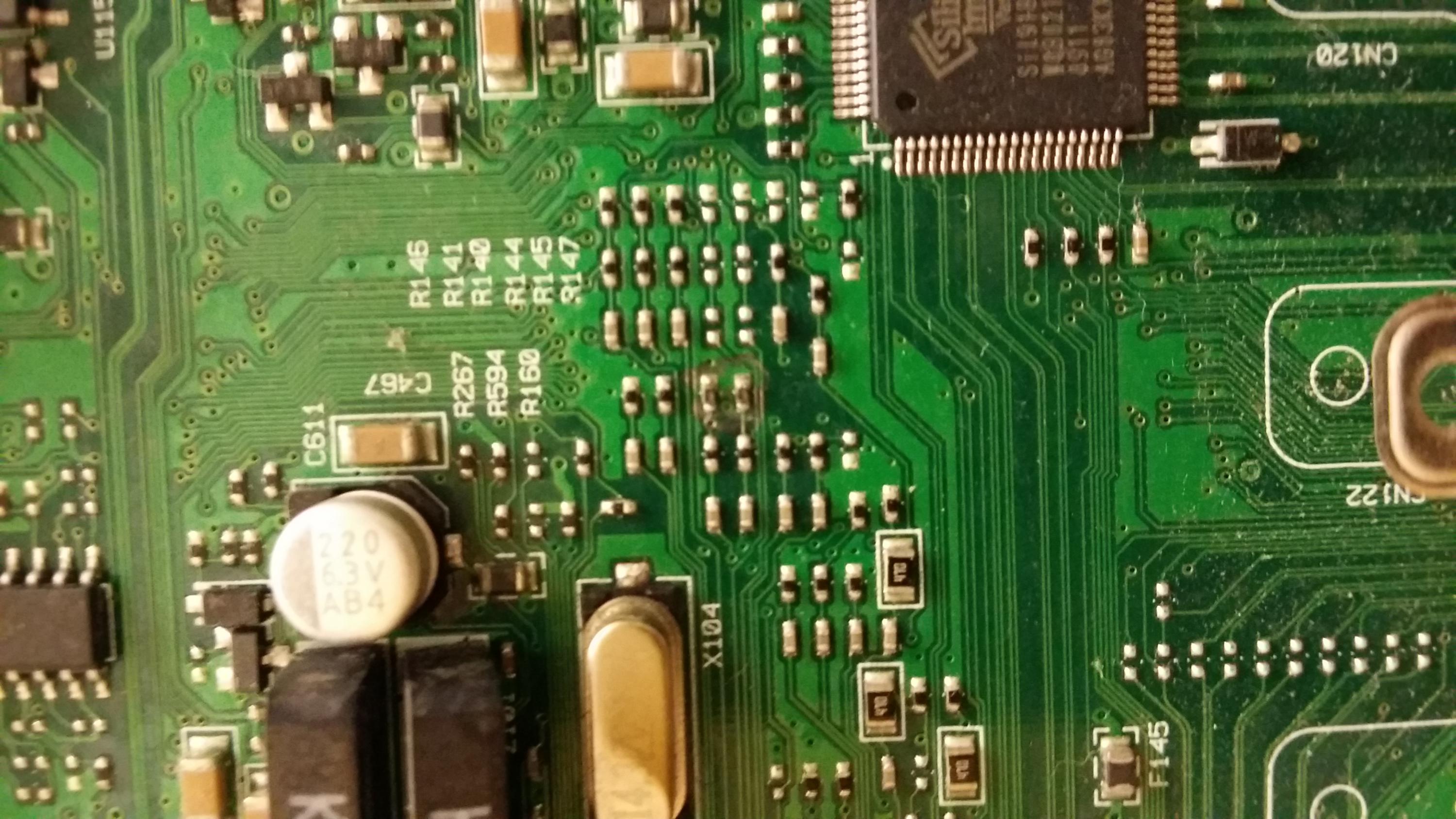

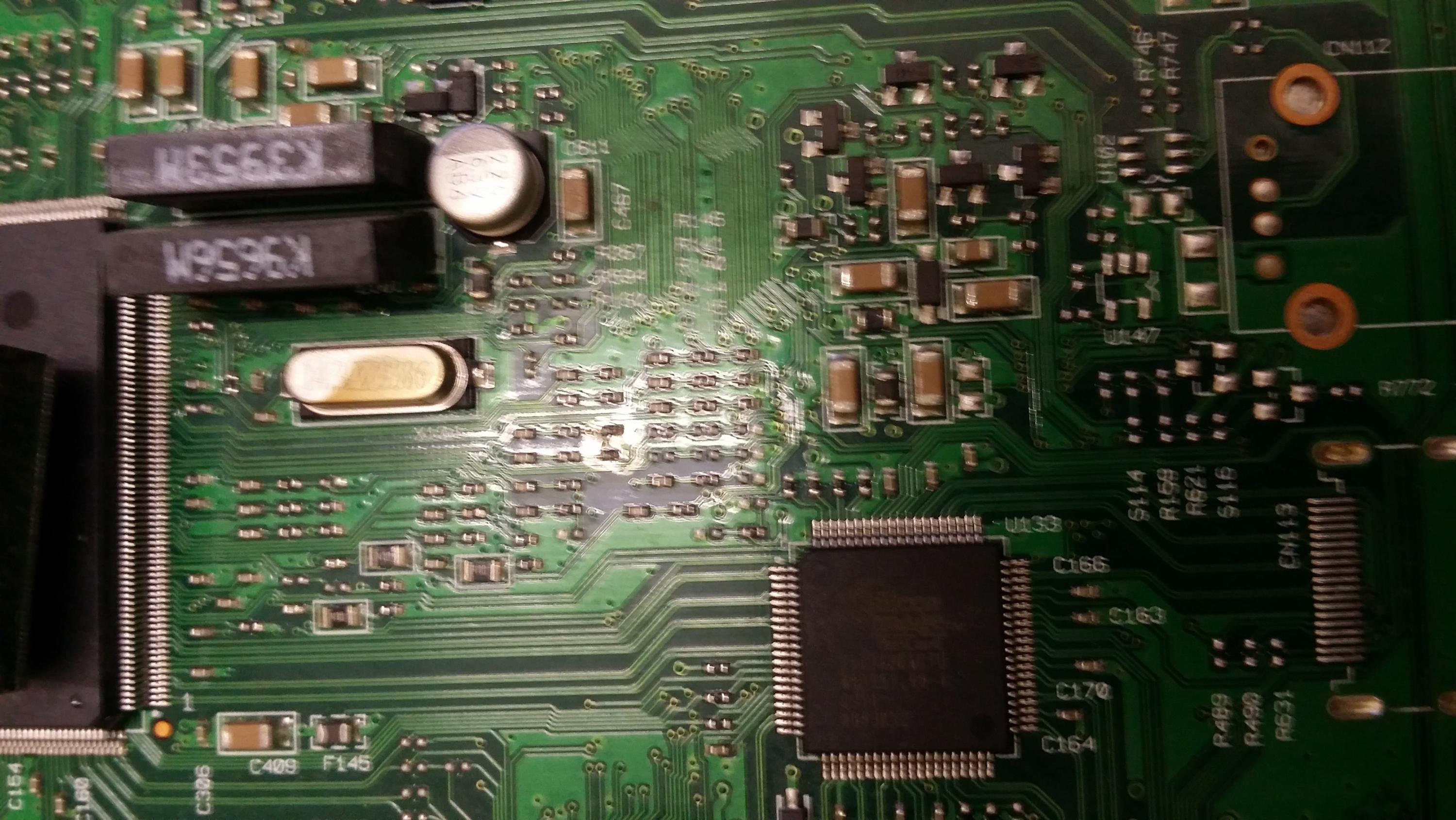

        I think I've found the problem. Not sure if I'm capable of repairing that. Are the black ones just a set value? I thought all surface mount resistors had a number on them.
        Just noticed how bad that first picture is, ignore that one.

          Re: Xenius LCDX42WHD89(A) stuck on standby
          what was it a bad measurement on the resistor?
          • quiggy
            • Aug 2014
            • 136
            • United Kingdom
            The 2 resistors, well I assume they're resistors with the marks around them. It was much blacker than that but I cleaned it up before taking the picture.
