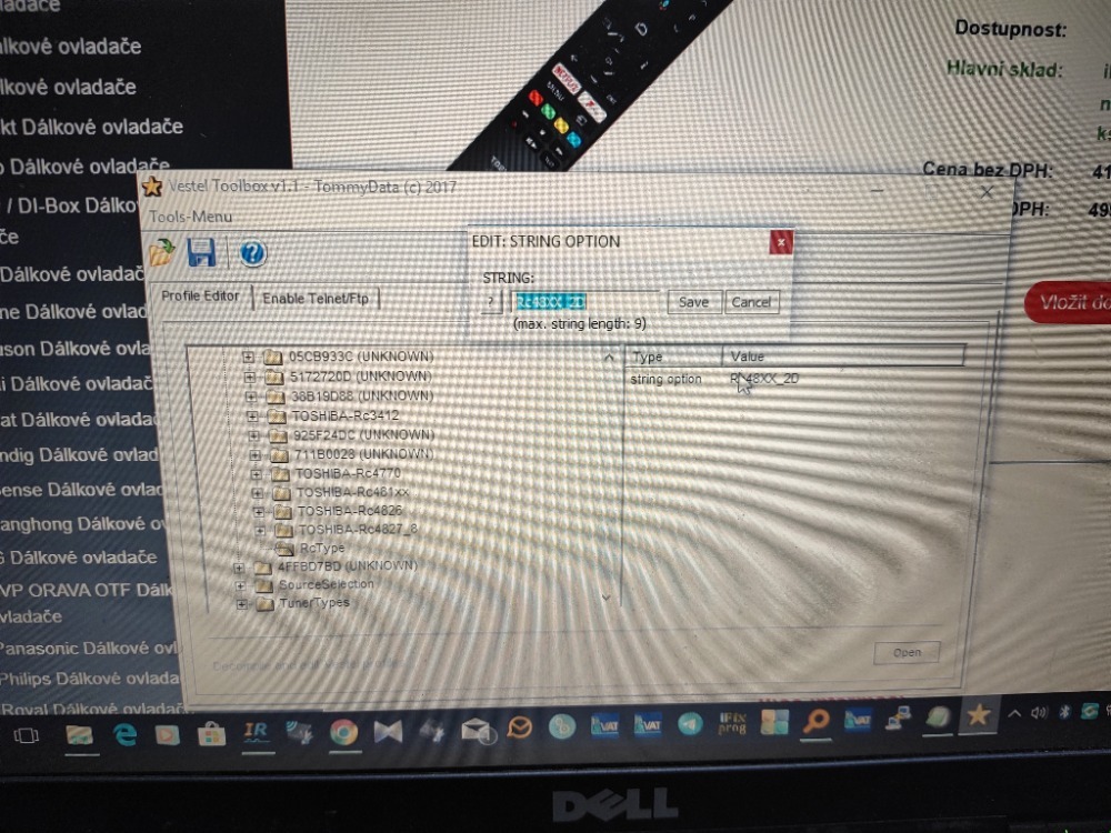

    Hello, board 17MB140TC, I need to change the remote control in Vestel tool box 1.1. The original is there
    Rc48xx_2D and I want to install TOSHIBA-Rc481xx, but the program says that a maximum of 9 characters can be entered. I only entered Rc481xx and the program does not accept the driver I have in the original. Does anyone know how to do this? Other Vestel codes work.
    I can send a dump.

    Hi. I tried to make the change too. I didn't succeed. I actually broke it worse so I gave up making such changes. The easiest thing is to rewrite the profile with one saved from the same TV model and that uses the same remote control.
    L.E.
    Try at your own risk. Delete Rc48xx_2D, type Rc481xx, Save.

      I tried it, but it doesn't work. Interestingly, it works with the 17MB110. I don't have the same motherboard as the 17MB140TC, which has a Toshiba remote control.
