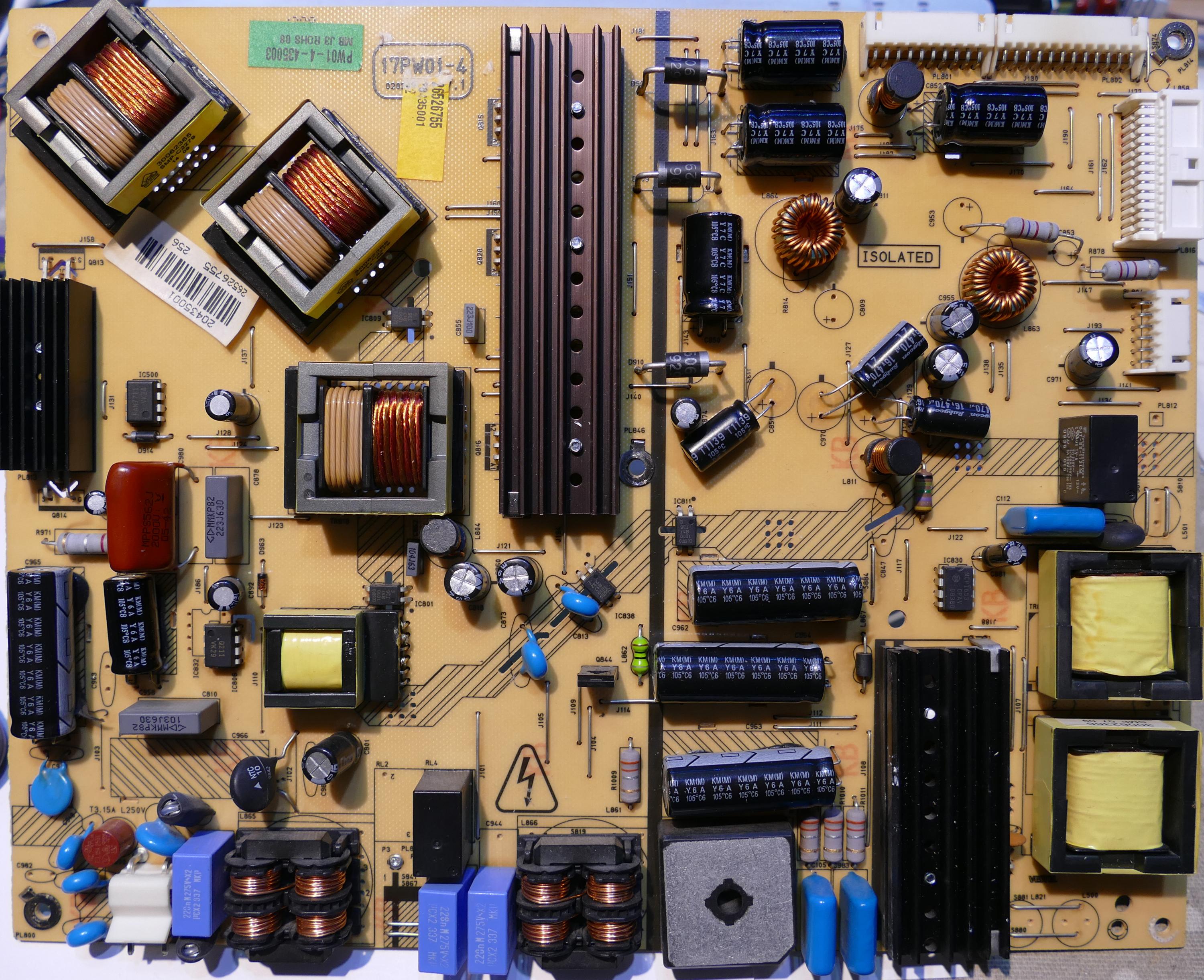

    Hi All,

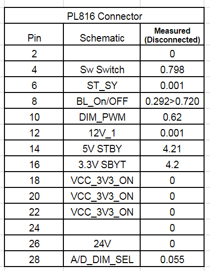

    I'm looking at a Finlux (Vestel) TV which is stuck in standby. On inspection, the power board had 3 bulging caps (C851, 970,969) which were replaced with Rubycon ZL series. (they are a strange angles at the moment to ensure I have a decent lead length if they are removed) The standby problem did not resolve it self.
    Off the TV i've measured the voltages of the PL816 connector that goes to the main logic board. The readings are below:
    The original capacitors are Samxon brand. I've measured the ESR and capacitance and all apear within 'normal limits'. (I had to desolder them as some of them were in parallel and I was getting skewed results)
    Similarly. I desoldered the big power diodes which were all fine.

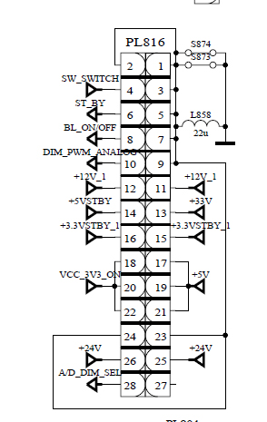

    Re: Vestel 17PW01-4 PS board stuck in standby
    It could be that the board only supplies 3.3v standby. to turn on the power supply board (disconnected from main) connect the 3.3VSTBY to pin 6 ST_BY. this should turn on the power supply. You can use a 1k resistor to be safe in case you connect to a wrong pin but a 47K resistor (r828) is already in place in Q804 base so no external resistor is needed.
    Look at the trace side of the board, the +5VSTBY may not be used or may be connected to the +3.3VSTBY
    The standby voltage could be a bit high due to no load when disconnected from the main. Also the voltage could be off due the the pfc circuit not operating in standby mode.
      Hi Both,

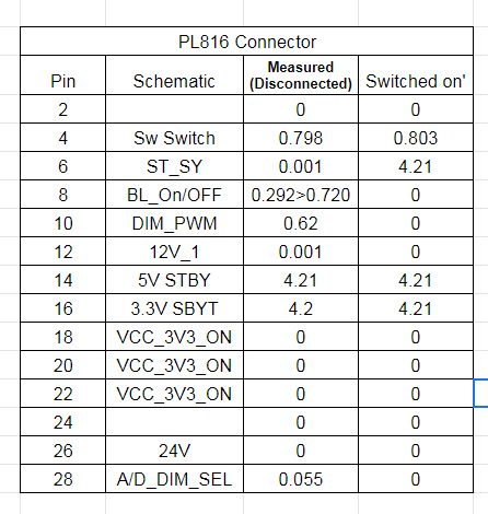

      I bridged the pins 6 and 16 as suggested and remeasured the voltages on the PL816 connector. The results are below:
      The other multipin connectors PL801 & PL802 also show no voltages.
      The RL5 Relay also switches when the PL816 6&16 are joined.
      Please let me know your thoughts and next steps.

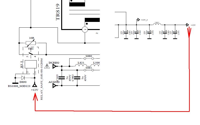

          When the PS board is connected to mains power there is a relay that switches on the primary side.
          After powering the board and when the 6-16 pins are joined the RL5 relay engages on the secondry side.
          • R_J
            • Jun 2012
            • 9627
            Relay5 is powered by +12 volts, the source for that is the secondary of TR817, so that circuit must be working. Are you sure you don't have +12 and +24 volts?
              CORRECTION:
              When the PCB is powered initially you hear the click of a relay. When you jumper pin 6 to 16 you hear another relay click.
              I falsly thought this click was RL5 on the low power side. It was not, it was RL4 on the high power side.
              RL5 is not energised at all. I've tested RL5 off the board and it works fine when energised with 12V.

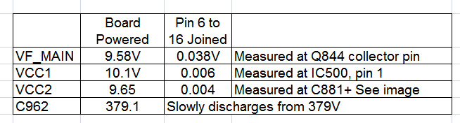

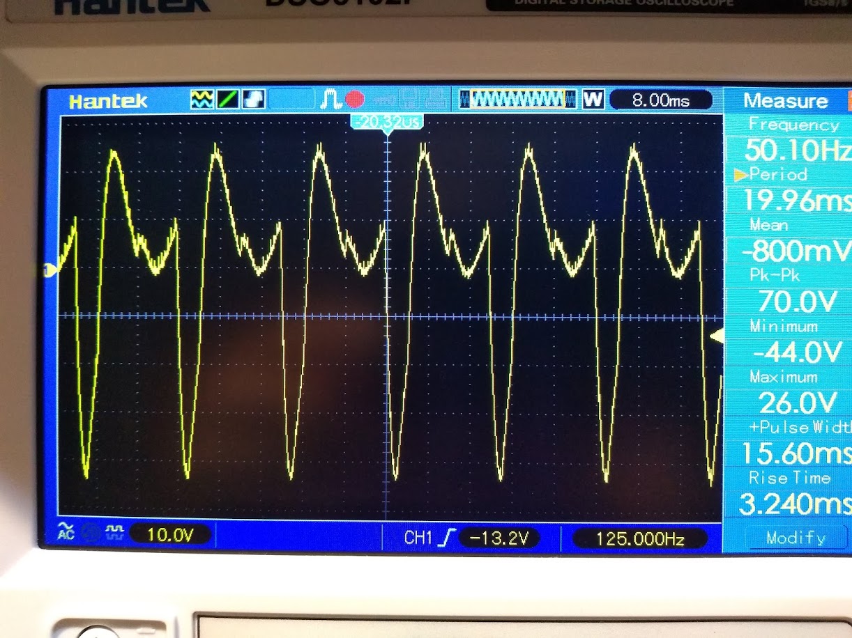

                      Hi Again,
                      I've taken the measurements you asked for, table below:

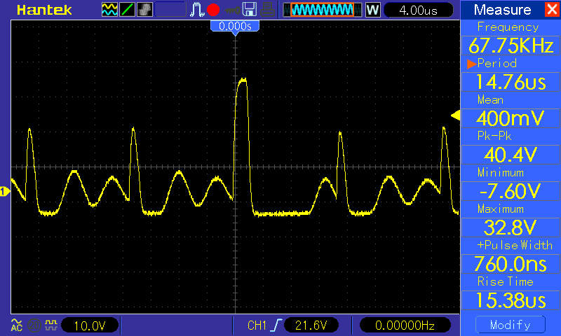

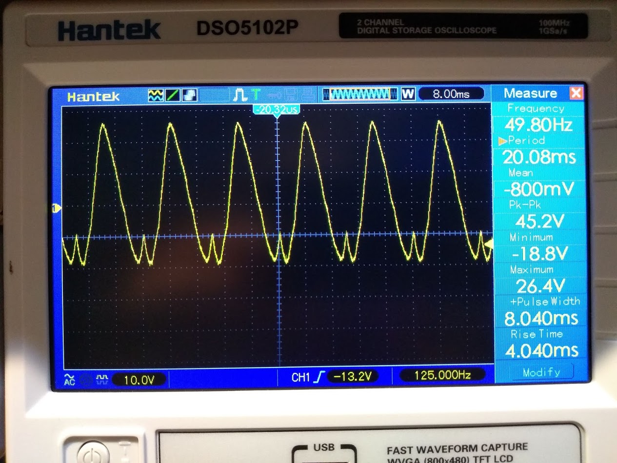

                      When I measured the voltage across the C962 I noticed a lot of ripple on the meter (Fluke 85). I then connected a scope lead to the + leg of C962. The grounding point being PL846. The first trace is with the board not switched on:
                      The next trace is with the board switched on:
                      I'm not sure if this helps or hinders but:
                      In trying to locate the voltages I looked at a few IC's e.g.
                      IC500 (FAN7711)
                      Measuring the supply voltage between pin 1 VDD & pin 4 GND was 14.79V when switched off and 0v when switched on.
                      IC830 (NCP1653)
                      Measuring the supply voltage between pin 8 VDD & pin 6 GND was 15.01V when switched off and 0v when switched on.

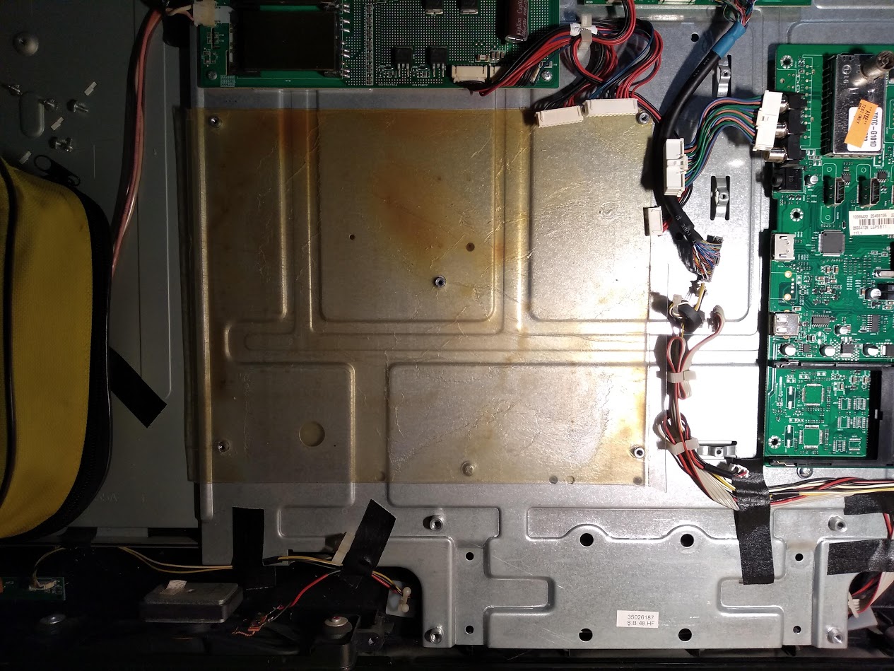

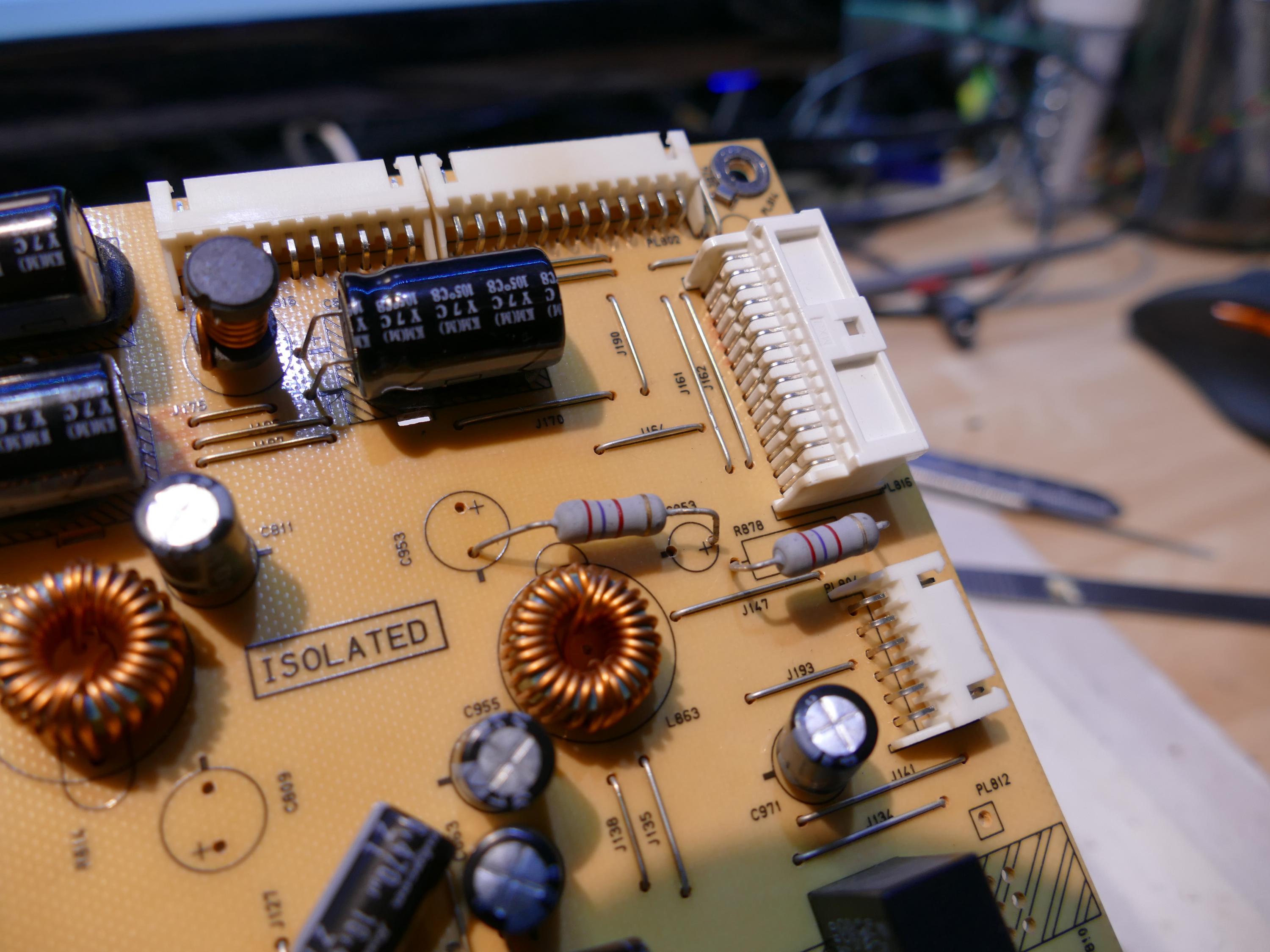

                            Not sure if this helps matters, but this is the plastic insulation from behind the power board and gives an indication of the areas of excessive heat:
                            I'm at a bit of a loss to find any shorted parts of VCC1 or VCC2.

                                Yes I have VCC of approx 15v on IC500 & IC830 and the voltage across C962-964 is 379v.
                                I tried to measure the voltage on VDD on IC832 and realised it was not a DC or sinusoidal AC signal so put the scope on it:
