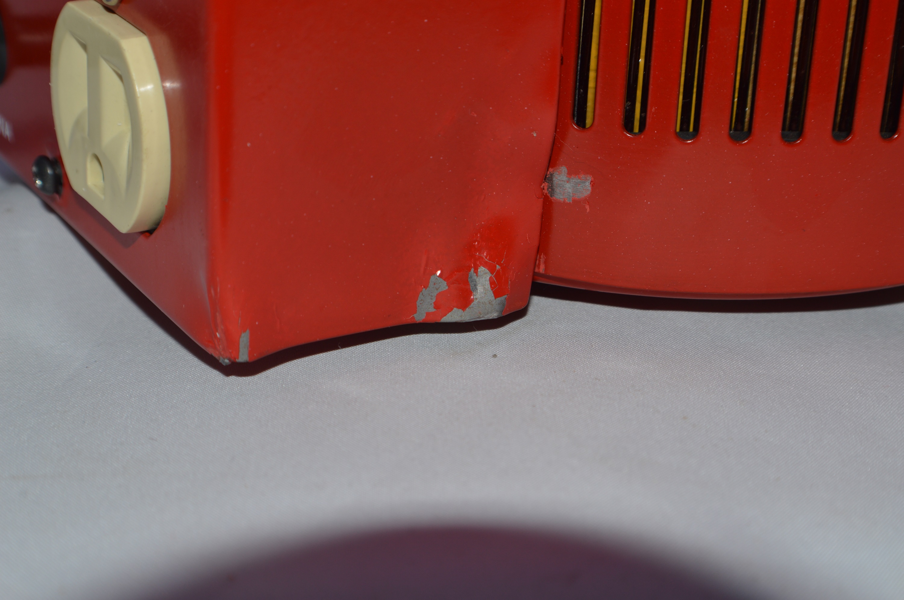

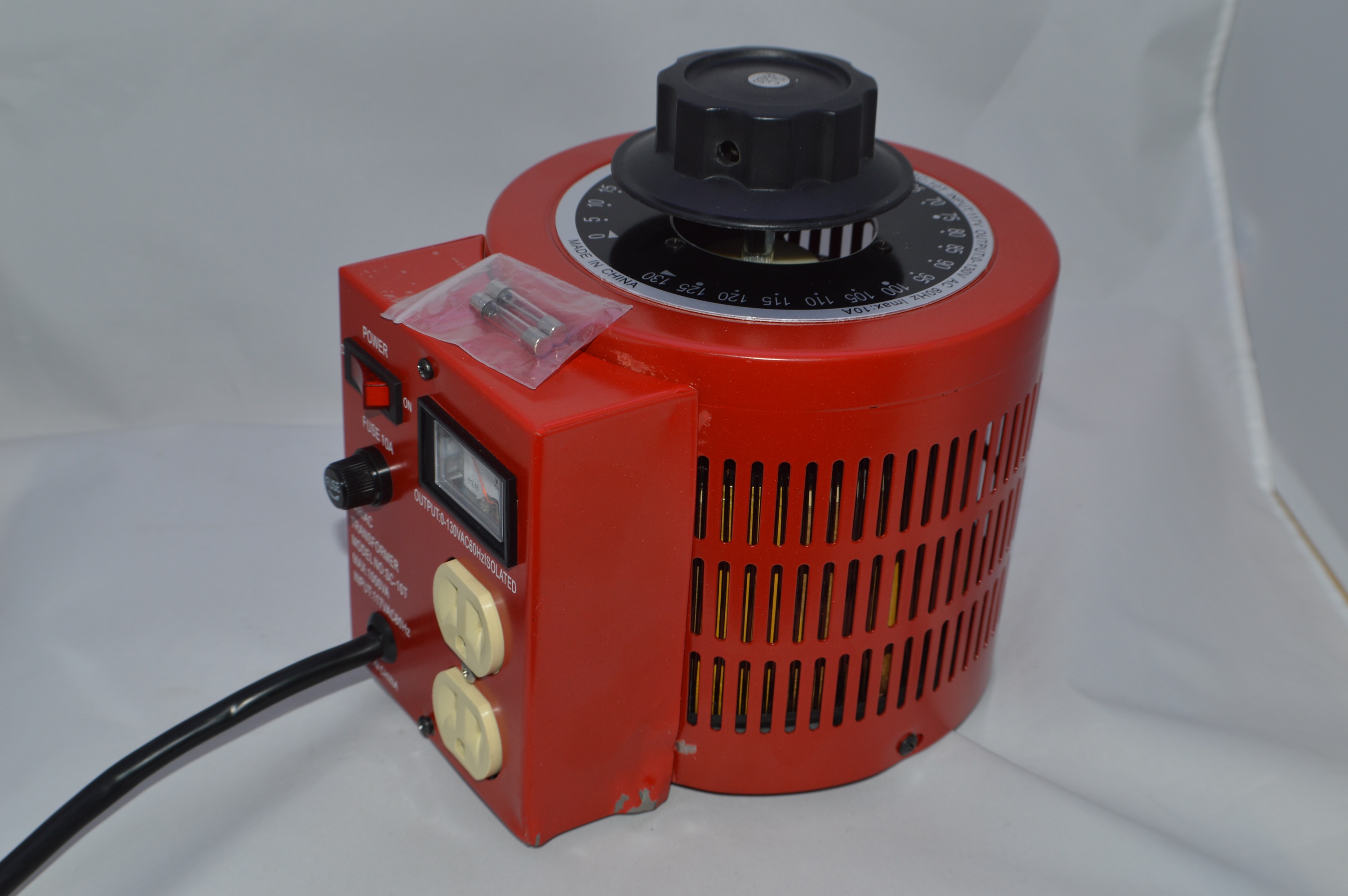

                              Variac arrived. It functions properly and is fully isolated. You can see from the pictures the little dent that saved me $30. I'll have to open it up and fix it so the front panel will stay tight, but that's no big deal. Talk about heavy though. This thing weighs 22 pounds. I need to find a permanent spot for this and never move it. Now it's time to learn how to use the scope and have some fun.
                              ------------signature starts here------------

                                        Couple issues I've noticed right away with this. The maximum voltage is supposed to be 130vac but it's 145vac. Is that because there's no load, or is there some way to adjust it?
                                        Also, the volt meter is wrong. It reads 110vac when my Fluke reads 145vac. I'm sure there's a way to adjust this. Not really a big deal because the gauge is so small I can't see it anyway. I think I'm going to modify it and add a digital display. I'll have to rearrange the panel to do it though, because I can't find a display small enough. I've found one that's 79mm x 39mm. I think it will fit if I get rid of the power switch. I'm thinking I'll move the fuse to the side, and put a round push button switch in it's place. Then it should fit and all I'll have to do is figure out how to power it. Or, I may just get some sheet metal and make a new panel. I haven't opened this up yet, but I'm figuring there should be a way to power it from the transformer, and of course, a rectifier circuit.
                                          Re: What frequency limit I should plan for when choosing oscilloscope for TV repair?
                                          Did you open it up to verify if the LINE, Neutral, and safety GND are wired properly?
                                          Verify if the the Neutral goes straight through from the AC plug to the outlet Neutral, and the fuse in on the line side not on Neutral.
                                          http://instrumentation-central.com/p...r_drawings.htm
