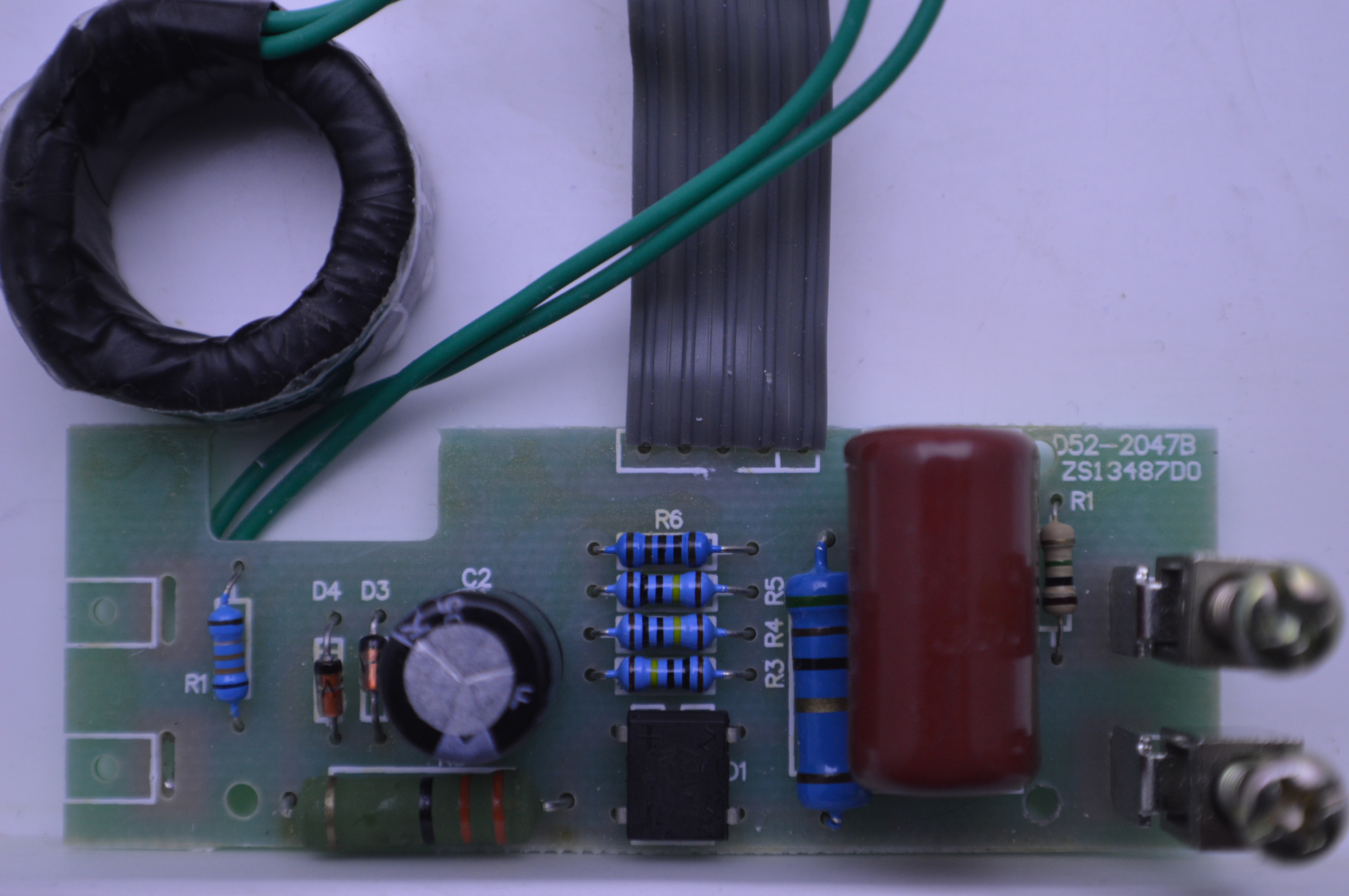

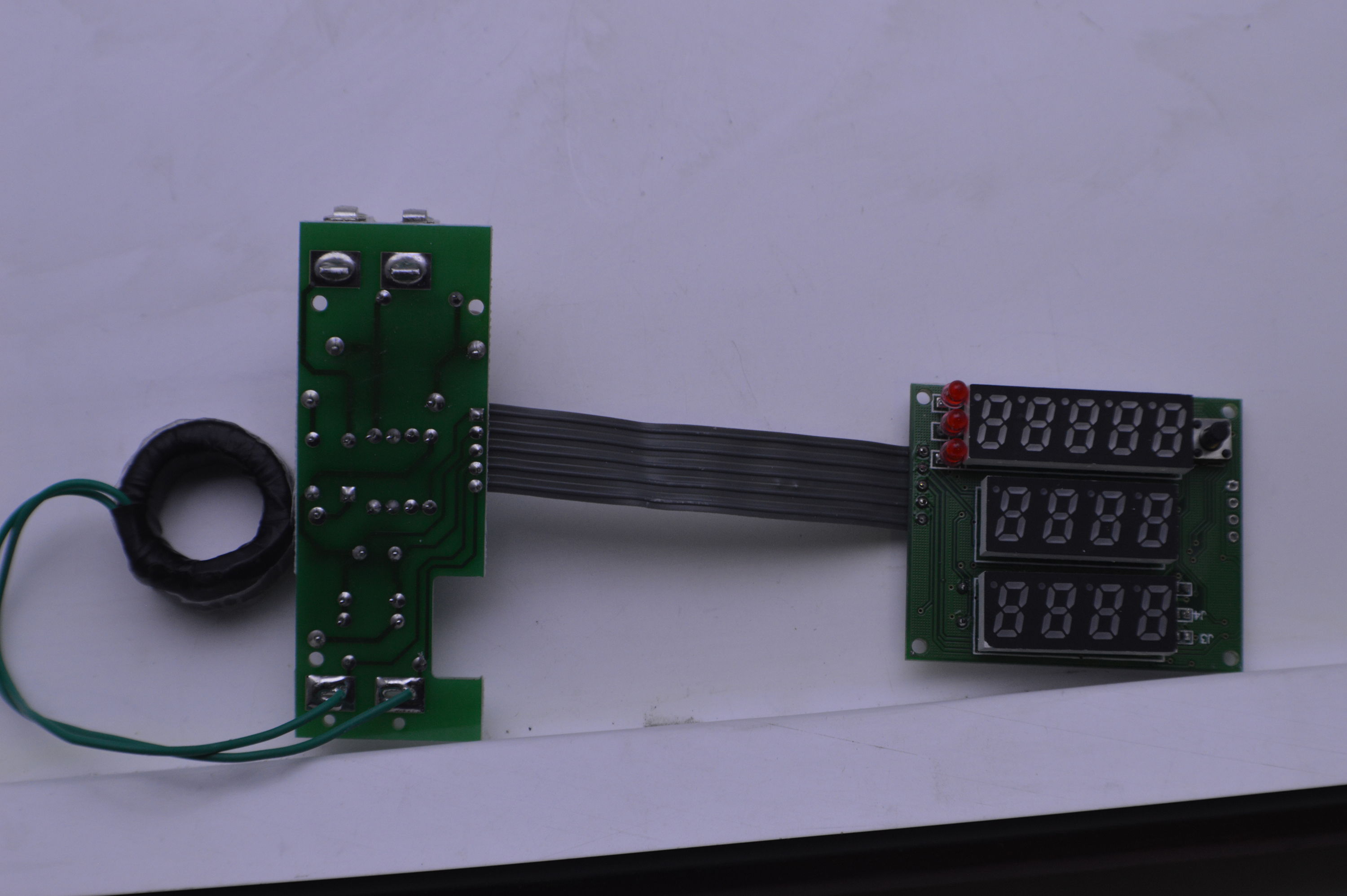

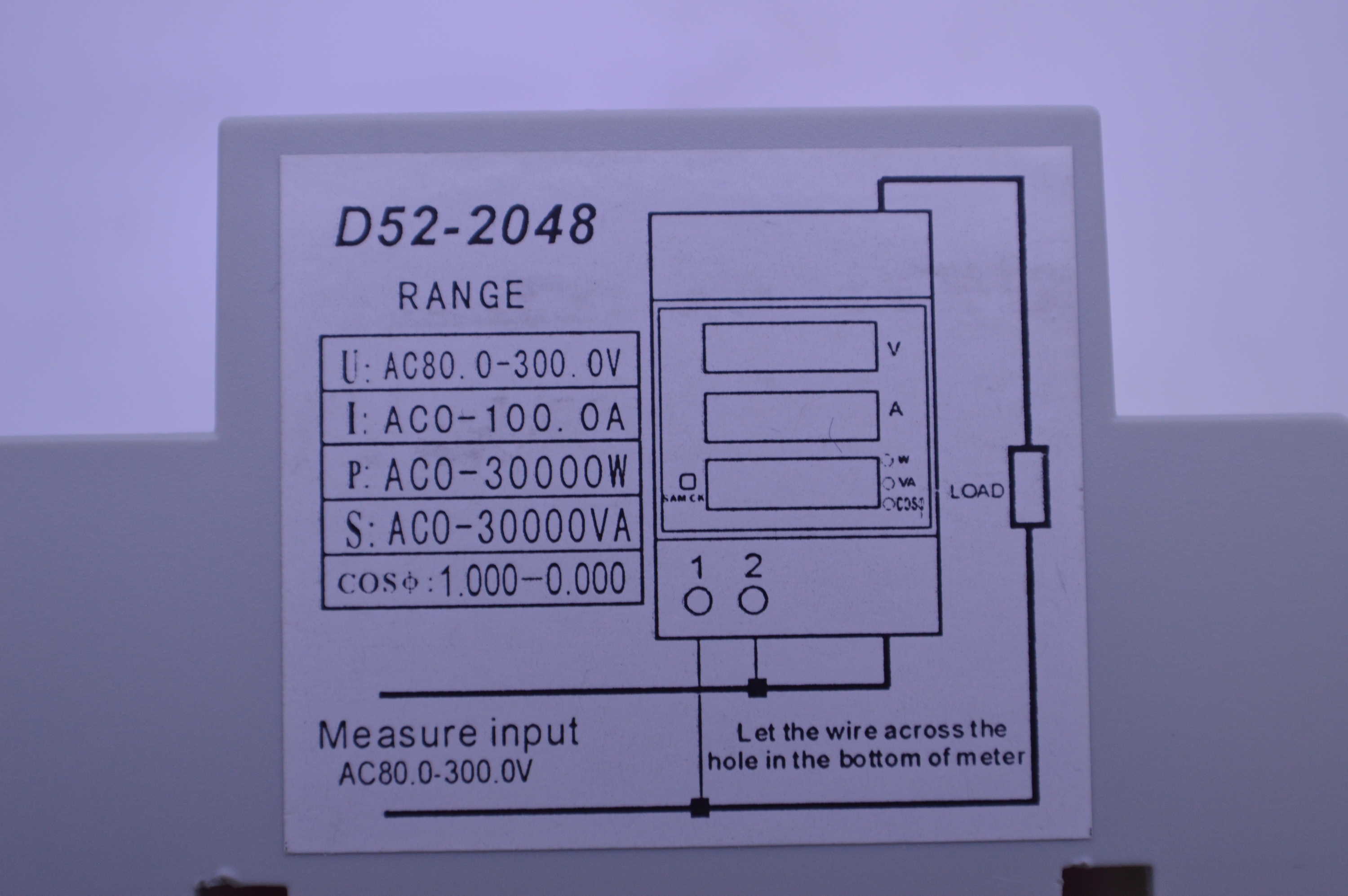

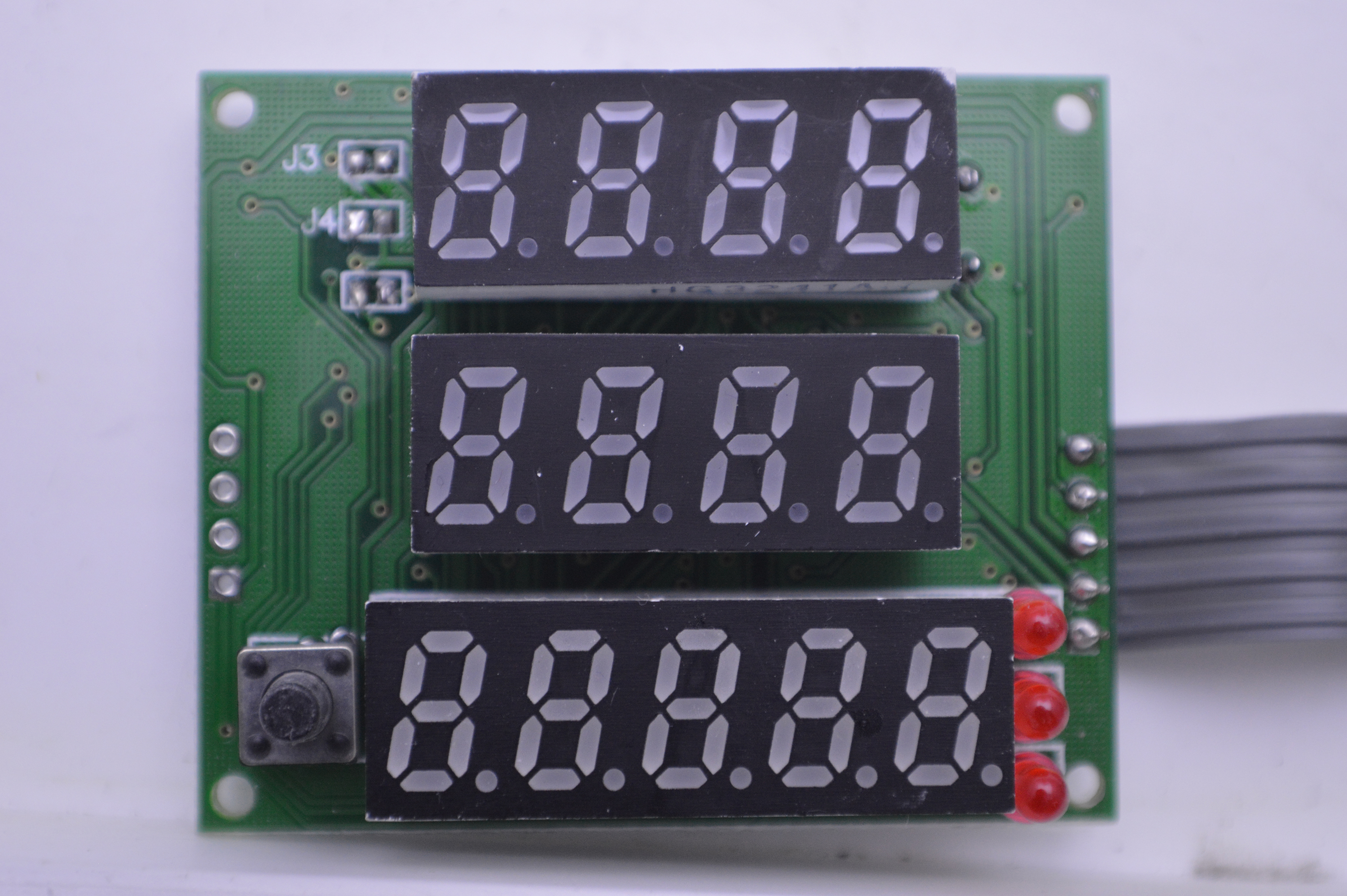

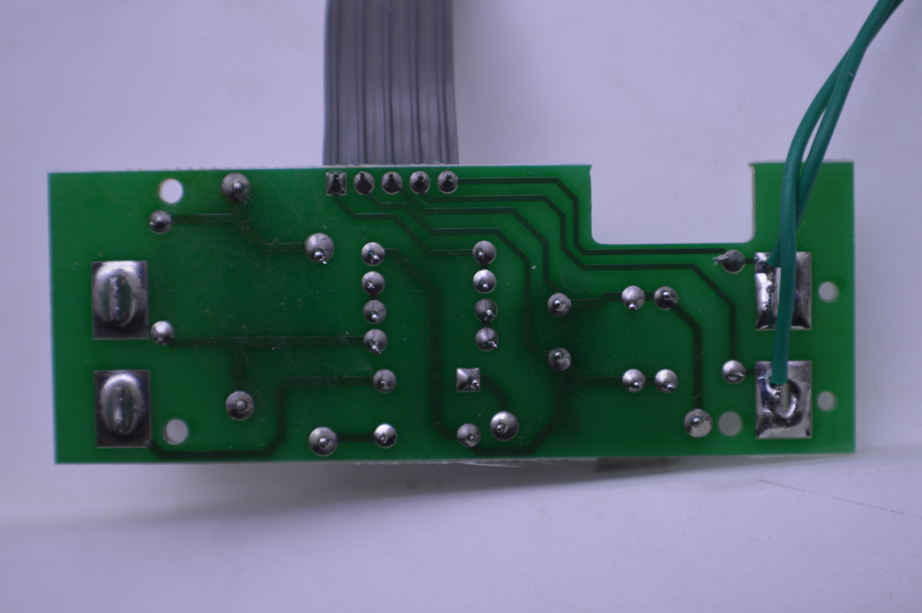

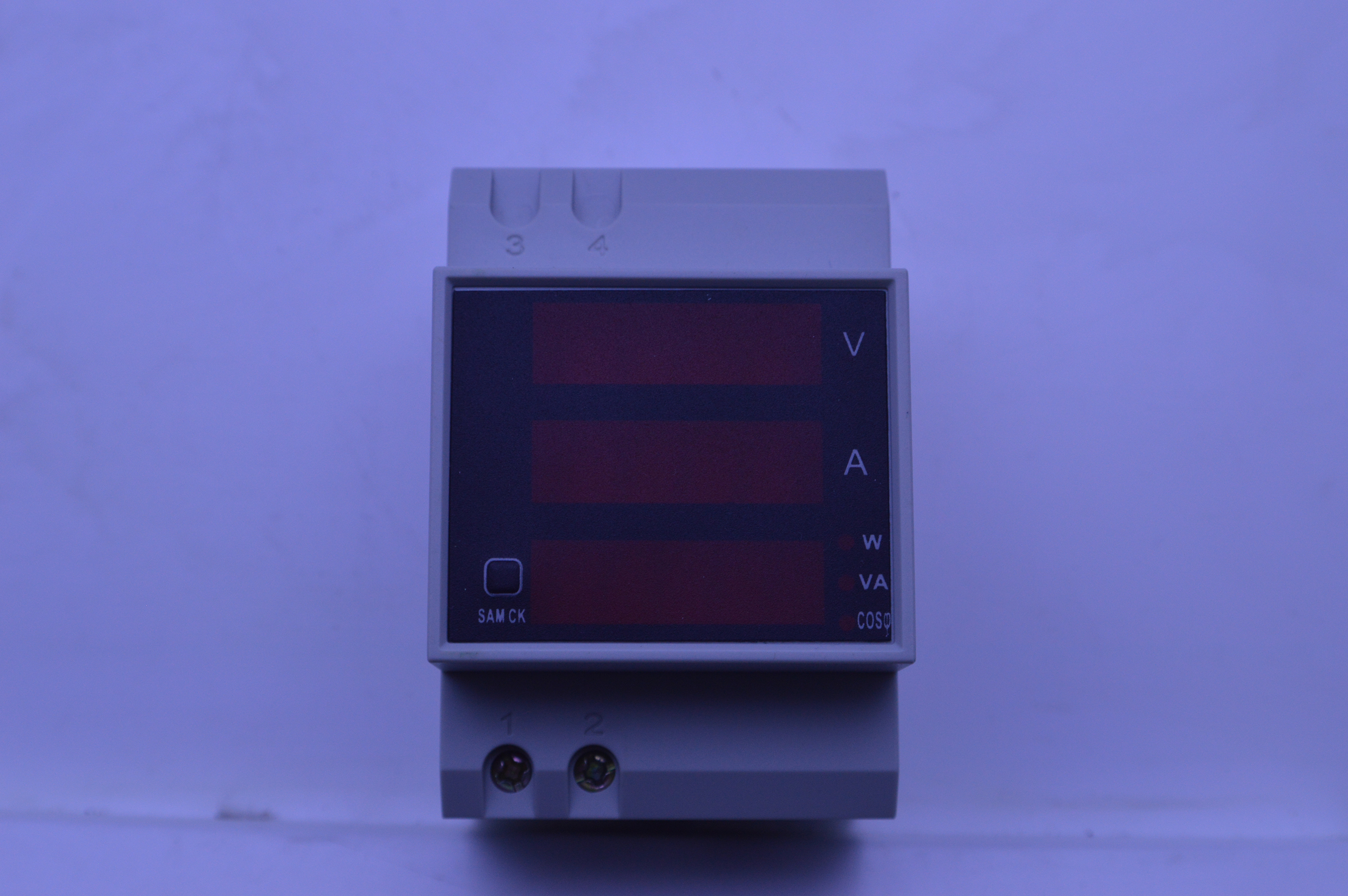

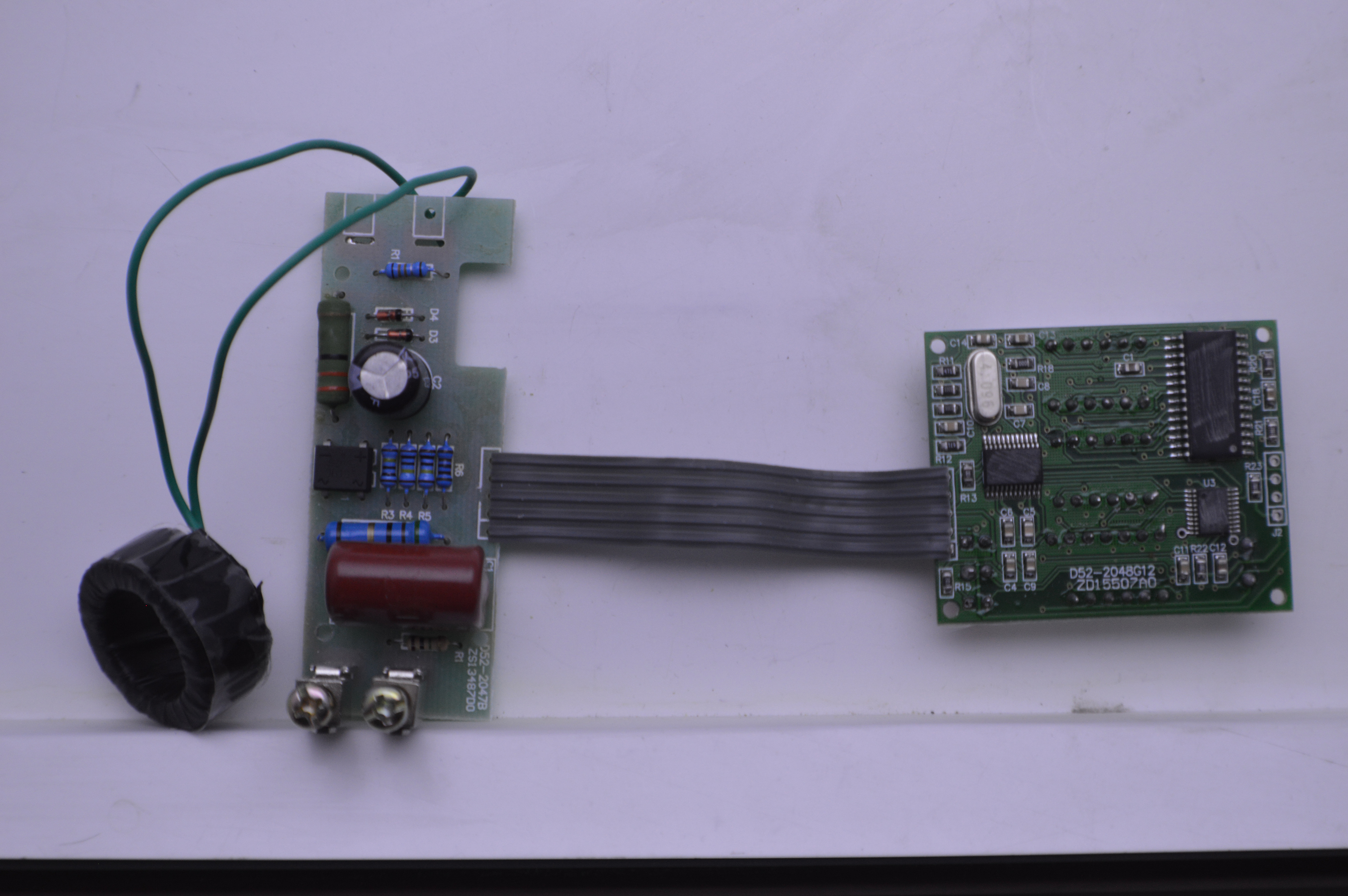

          Here's the meter I plan to use and all the pics.

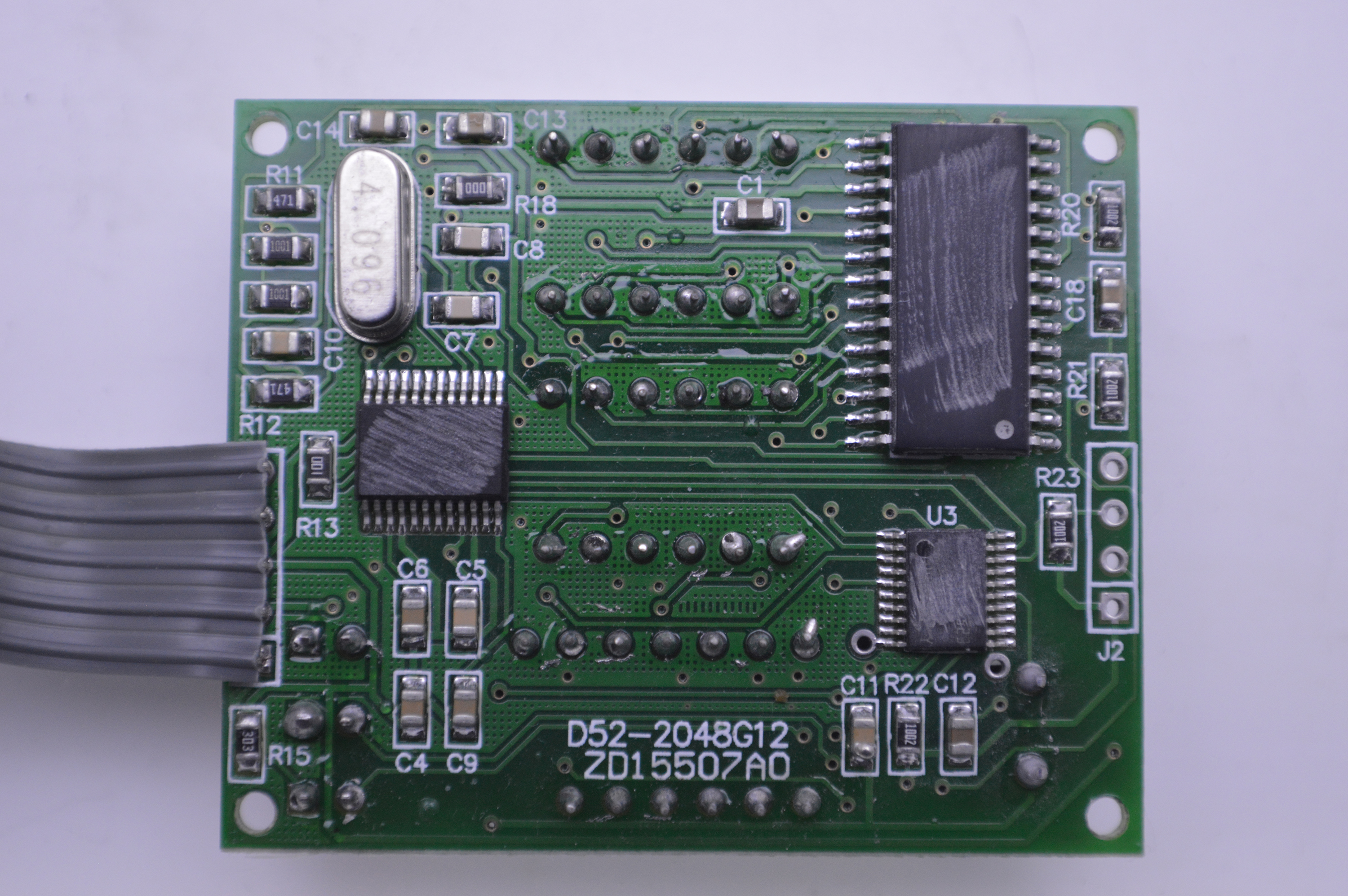

              Probably doesn't matter, at least one will be a uC and unless you get the firmware what's the point?
              Other two are probably just 7400\4000 series for the LED multiplexing

                #147
                Re: What frequency limit I should plan for when choosing oscilloscope for TV repair?
                nice, the small board has 2 pins on the ribbon for current, the other 3 are the supply and sense-voltage.
                so just need to draw a schem of the small board.
                btw, if you can use a meter to see how the 4pin header on the edge and the crystal connect to the 24pin chip around the ribbon we can id the microcontroller.

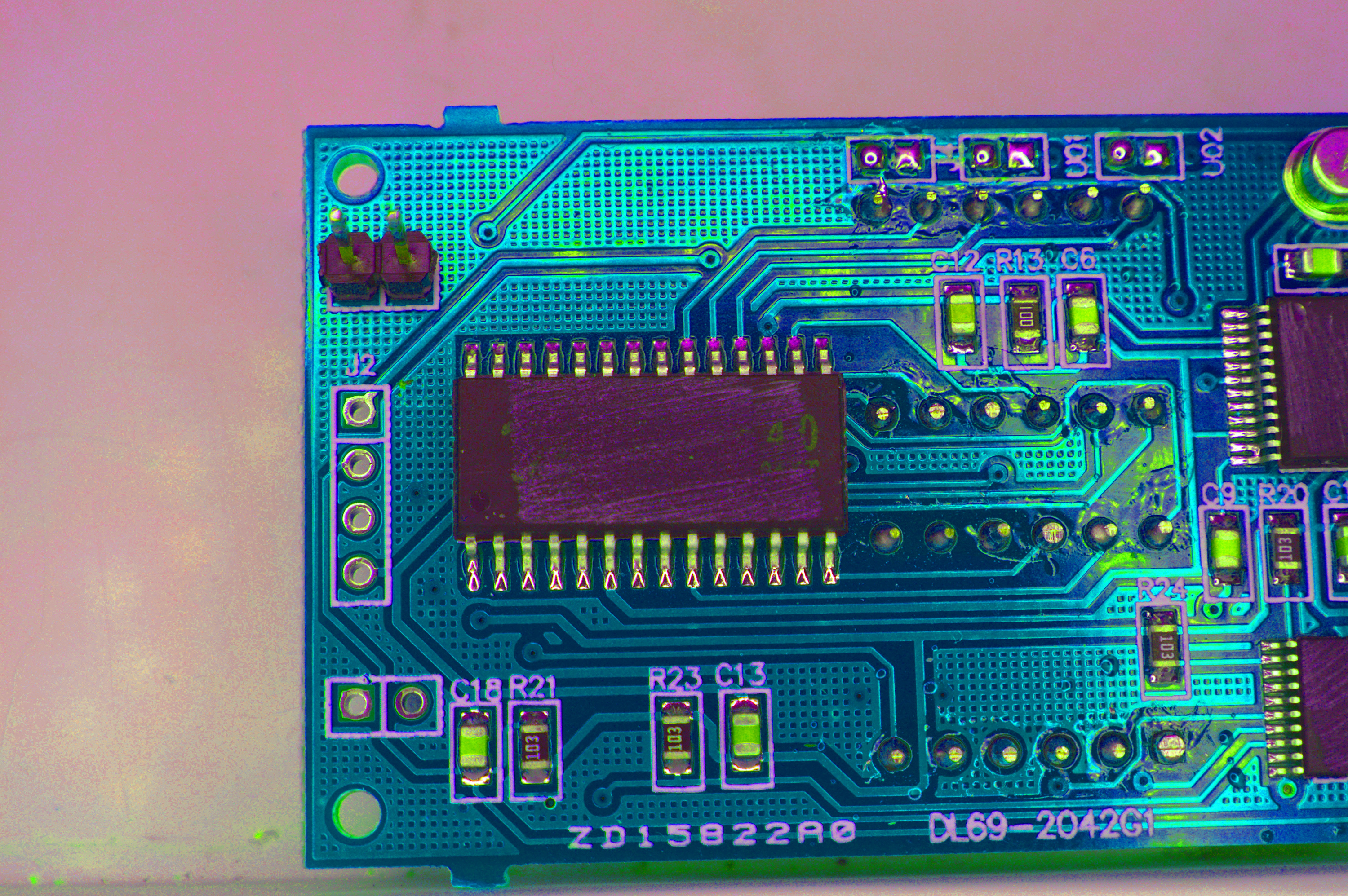

                  #148
                  I have programmers. If it's a flash chip, I can read it. I just need the pinout.
                    I'll get working on that tomorrow. I'm guessing the microcontroller is the big IC?
                    This image is from the other one of these. I'm thinking it's probably the same. I played around with Photoshop and made a couple numbers show up.
                      no, i think the big ic is the led driver - probably serial input.
                      i think the microcontroller is the medium-size one near the cable
                      the givaway is the 4mhz crystal

                        #151
                        Ah I see, because the microcontroller needs the clock signal.
                          exactly, and tracks must be short.

                            Is this likely to have one those internal fuses that they blow after programming the ROM to prevent it from being dumped?
                              Likely, I think most microcontrollers do... the question is, did they use it?
                                I guess I'll figure that out after we ID it. I hope they didn't. I'd like to be able to see the code and try to figure it out.

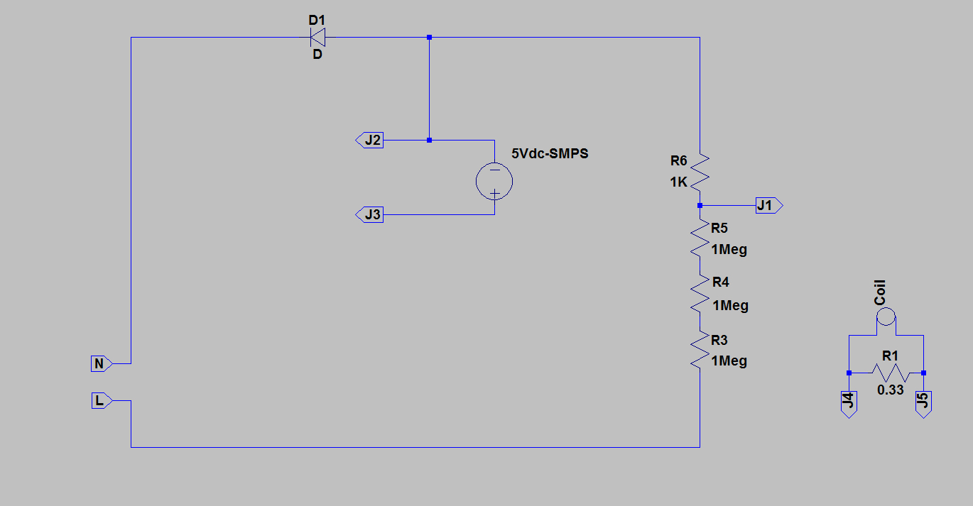

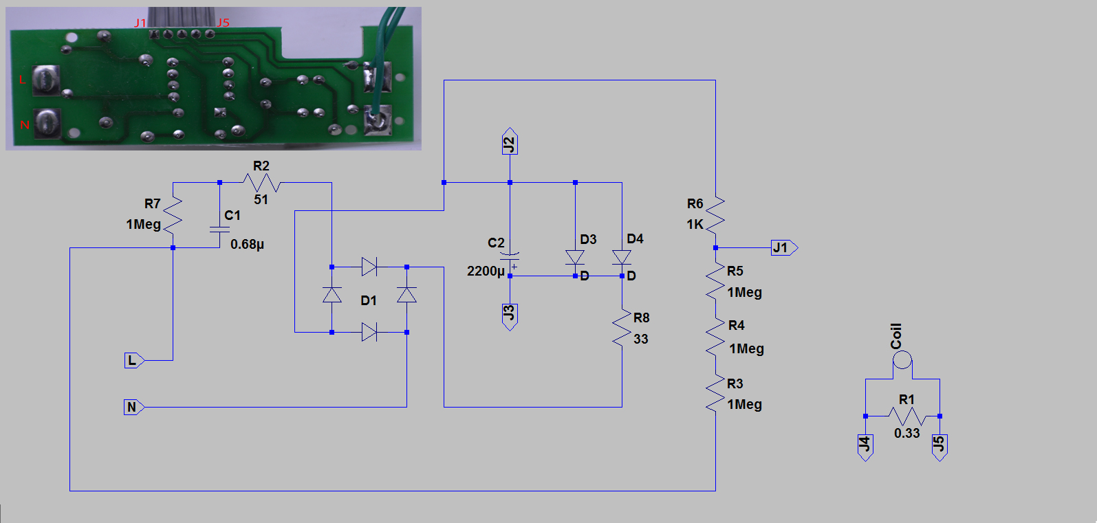

                                  Here's the schematic I made for the small board.

                                    • 31191
                                    #157
                                    nice
                                    so J2 is ground AND SHARED WITH THE SENSE INPUT
                                    and J3 is the positive supply
                                    d3 and / or d4 are probably zeners - see what's printed on them.
                                    stuff 100'ish volts into the circuit and put your multimeter across j2&3 - lets see if it's outputting 5v
                                    btw, what's the voltage rating on the electrolytic?

                                      #158
                                      nice
                                      The zeners are marked Z5V1. I'm finding datasheets for 5v1 and their the same as a 1N4733. I'm guessing 5.1v.
                                      The electrolytic is 10v.
                                      With 100Vac input, I get 4.8Vdc across J2 and J3.
                                      The display reads 99.2 Vac, and I get exactly 100Vac with my Fluke and my Radio Shack meters. Not perfect, but pretty darn close. I noticed all the resistors are 1% tolerance. I wonder if there's something I can do to make it perfect?

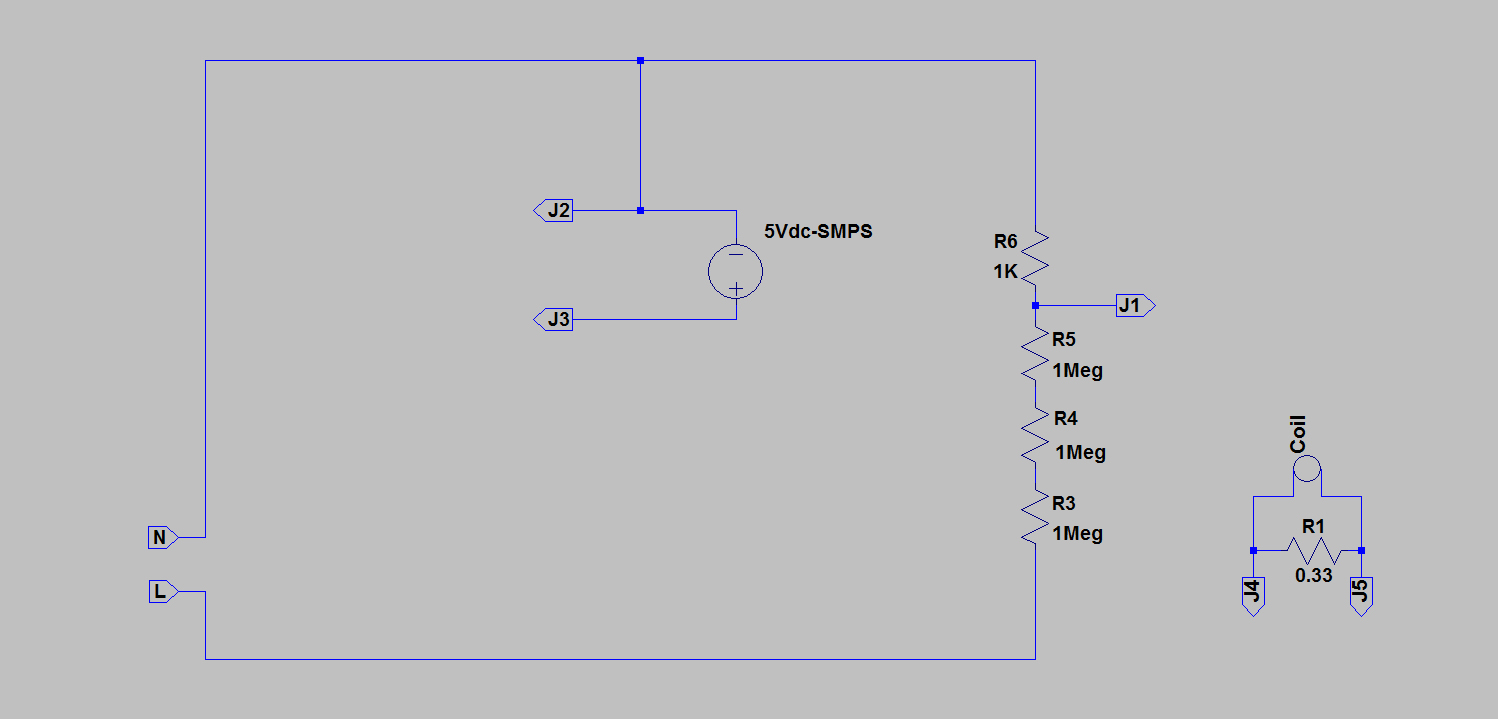

                                        I'm trying to figure how I'm going to mount all of this in the variacs panel. I have the 5v SMPS that I have to fit in there, plus the display, and it's a tight fit already. It looks like most of this board serves to supply the power for the device. Can I just eliminate this board completely by daisy chaining the resistors and connecting neutral direct to J2? Then I could just heat shrink it all. The current sense is completely separate anyway. My thinking is that I don't need If I can do that, I won't need a new panel.
                                        Would this be correct?
                                          Or, is it better with the diode here?
