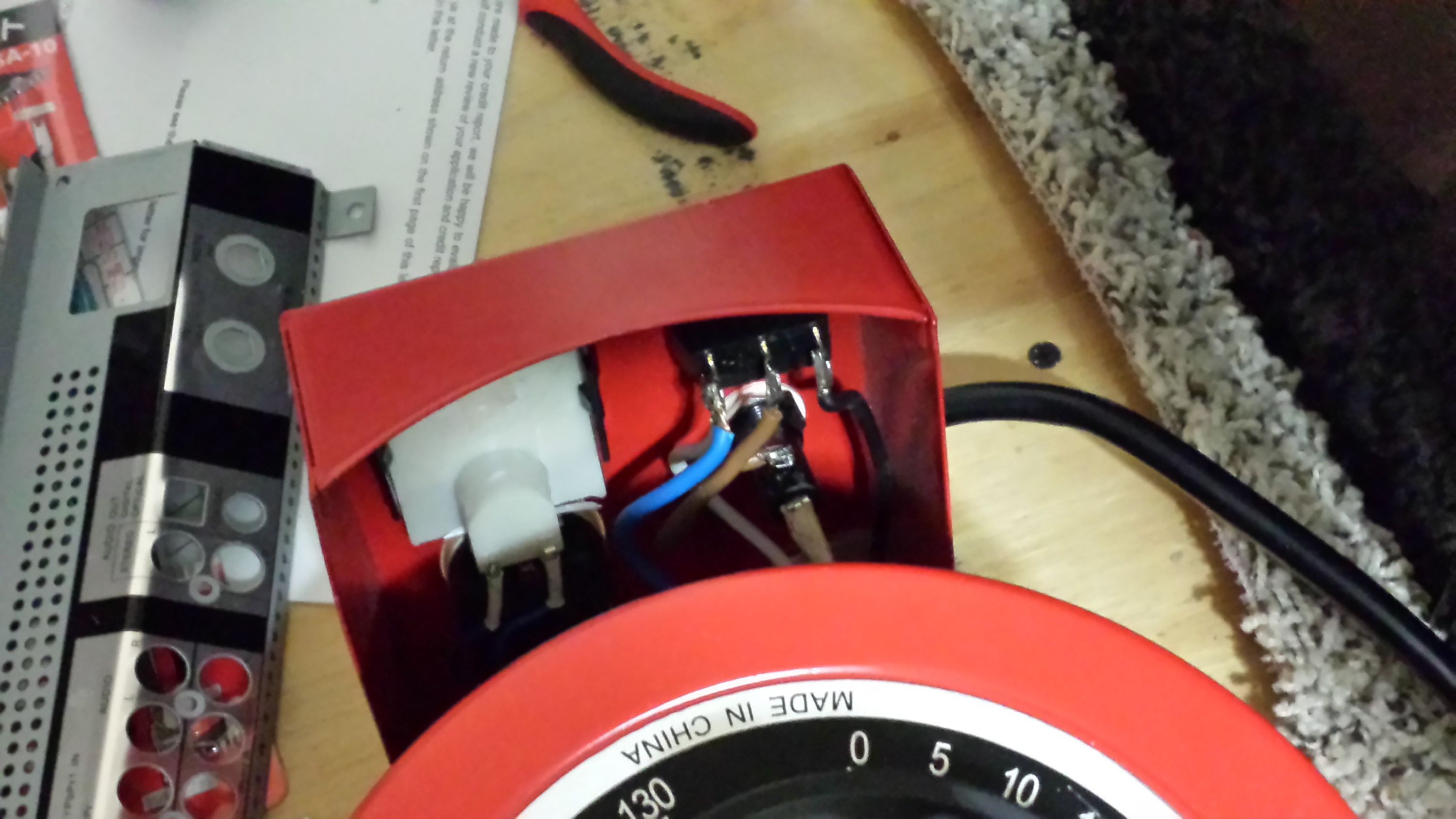

    Originally posted by budm
    Did you open it up to verify if the LINE, Neutral, and safety GND are wired properly?
    Verify if the the Neutral goes straight through from the AC plug to the outlet Neutral, and the fuse in on the line side not on Neutral.
    I haven't opened it yet, but I did use my meter to probe the AC plug and the outlet. I get no continuity from AC plug neutral to outlet neutral, no continuity from AC plug Line to outlet Line, and I do get continuity from AC plug ground to outlet Ground.

      #102
      Re: What frequency limit I should plan for when choosing oscilloscope for TV repair?
      Yup, they got the fuse on the neutral side. I'll change it.

        #103
        The wiring should be the same as the one in the link (The main fuse should be right at the incoming AC LINE instead of at the output).
        'I get no continuity from AC plug neutral to outlet neutral, no continuity from AC plug Line to outlet Line,' That does not sound right.
        Never mind, you have the isolation type.

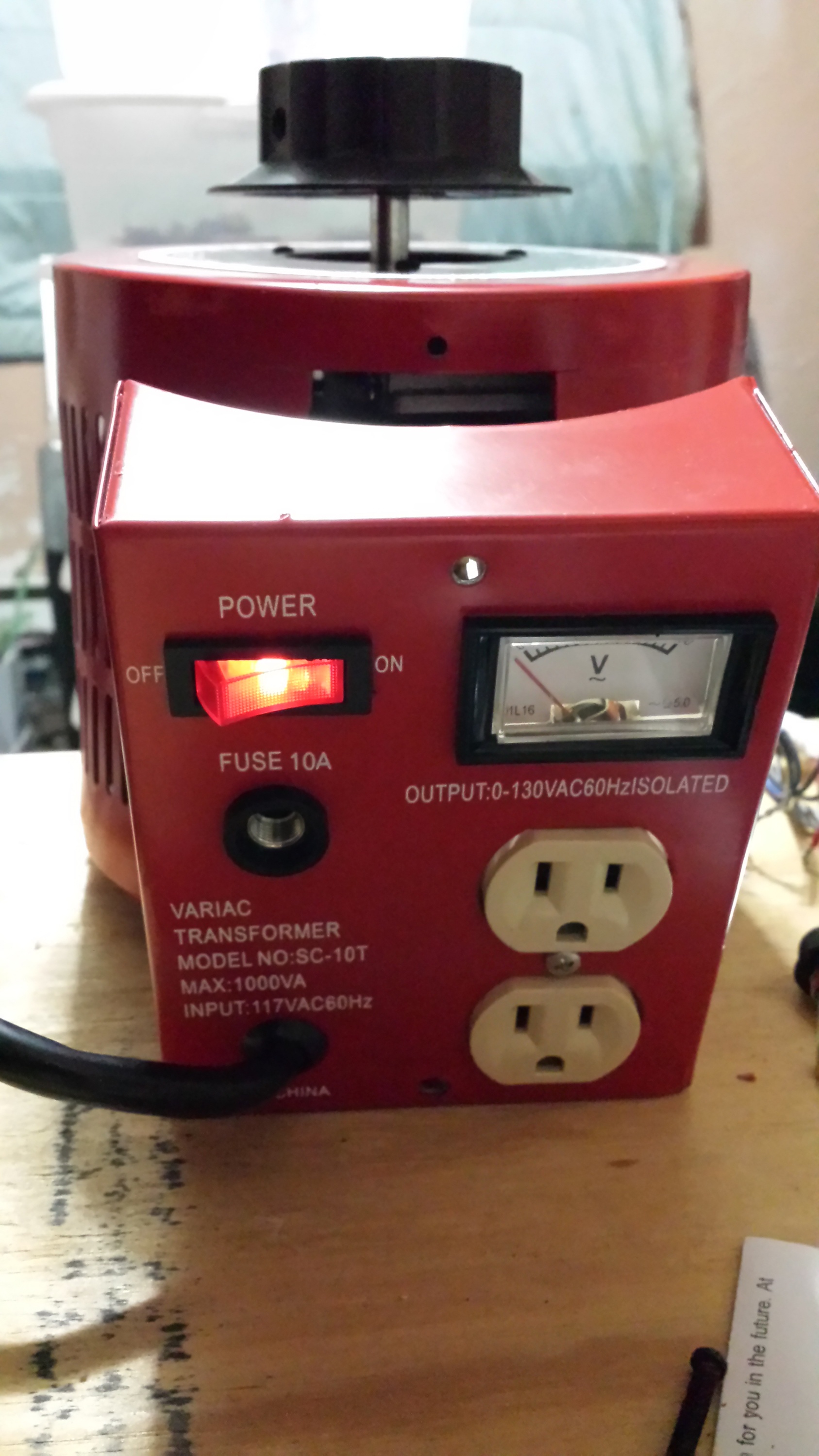

                                  #116
                                  What's wrong with this picture?
                                    You should draw out the connection before fixing it. May be they have the fuse on the output winding like the one used in STACO.

                                      #118
                                      Nothing is wrong, the behavior of the device is consistent with the word "China" on it.
                                      Or maybe the lamp is before the fuse, showing you when the device is plugged in and has power at any time. That could be kinda useful actually, in an over-paranoid way.

                                        #119
                                        It's actually connected in series between the switch and the transformer. I was mistaken earlier when I said it was on the neutral line. With no current flowing, there is very little resistance on the winding, so that made me think the fuse was on the neutral.
                                        I needed a good laugh, and that did it. I could see that being useful as an indicator, as long as the switch doesn't eventually blow up like the one in my coffee maker did.
                                        I'm thinking about replacing the fuse with a panel mount circuit breaker too.
