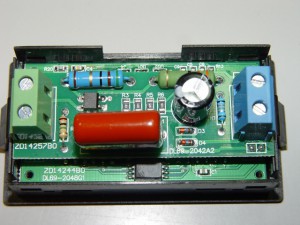

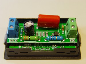

                            Re: What frequency limit I should plan for when choosing oscilloscope for TV repair?
                            that's nice, they are a lot cheaper than they used to be!
                            when you get the display, open the casing and lets draw a schematic of the power input.

                                    #137
                                    i would say those modules actually run from 12v or 5v in the end.
                                    have to wait to see inside one.
                                    they could use a microcontroller or some custom meter chip.

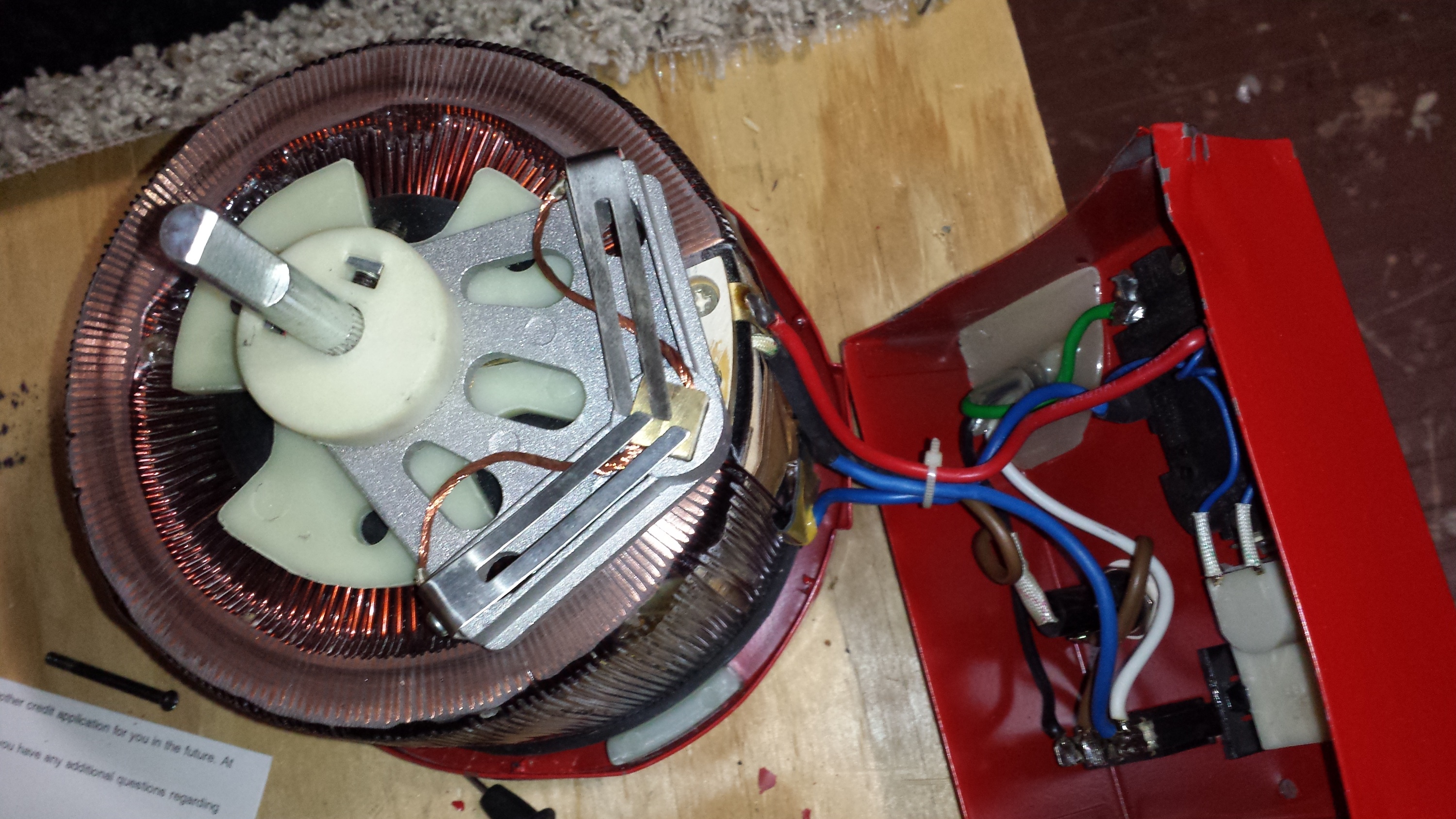

                                      If you want regulation then you're out of luck with a variac - the voltage varies with the load and input voltage. Most of those modules that generate various output voltages use poor quality components so the output is often oscillating or unstable.
                                      One project you could consider is to use a servomotor or brushed DC motor to control the variac arm, varying the variac voltage set point to keep the output under regulation. That would be an advanced level project--but the bonus is, you could sell it to some audiofools, who buy variac power supplies to ensure the supply voltage to their audio and video equipment is precisely regulated. Fools and their money are easily separated.
                                      http://audiophilereview.com/amps/why...-a-variac.html
                                      • lookimback
                                        • Aug 2013
