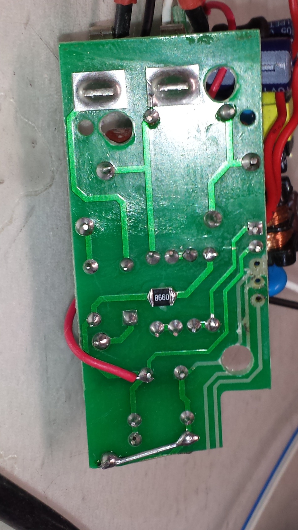

              • lookimback
                • Aug 2013
                • 1489

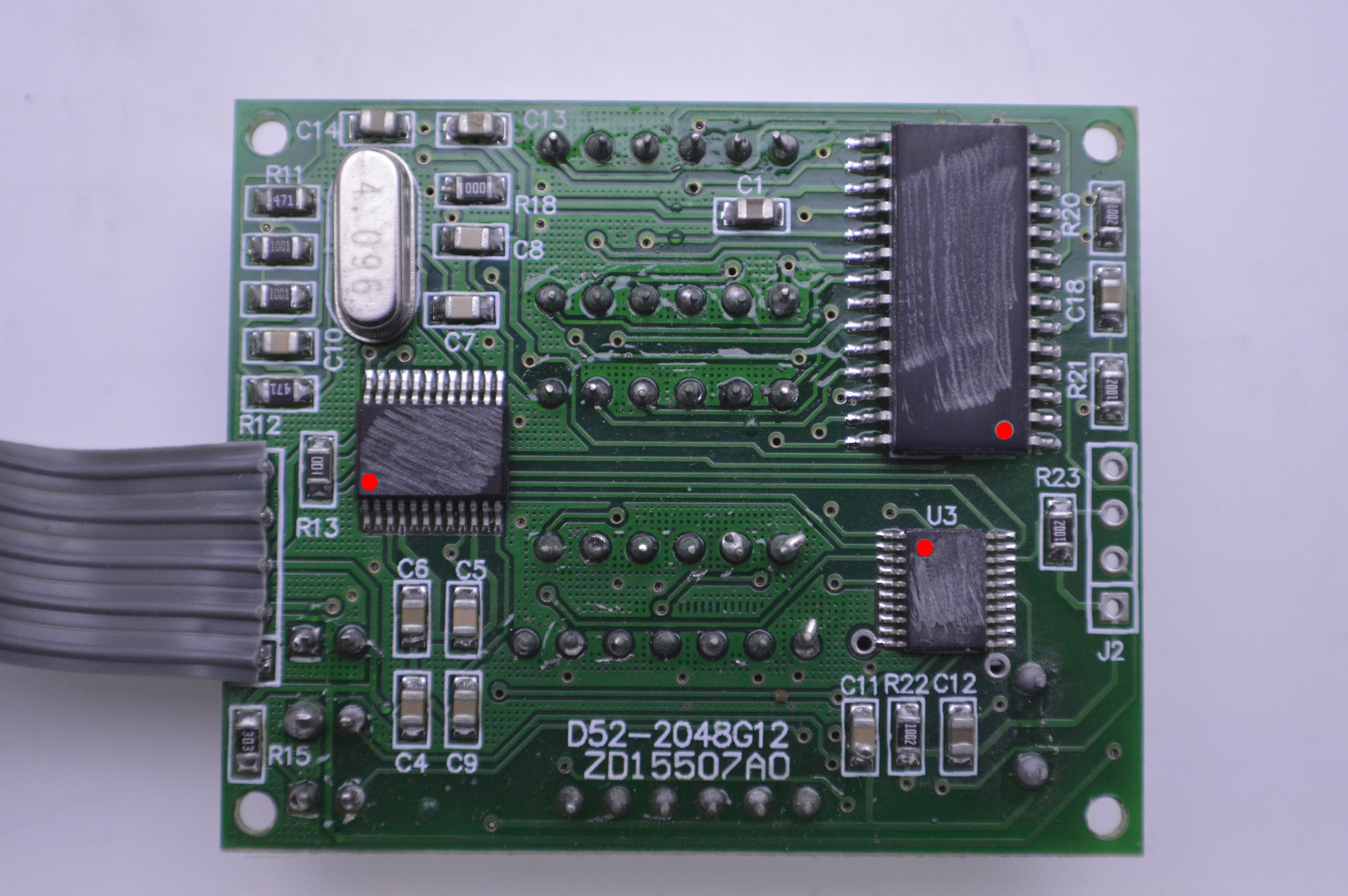

                #187
                Re: What frequency limit I should plan for when choosing oscilloscope for TV repair?
                Originally posted by stj

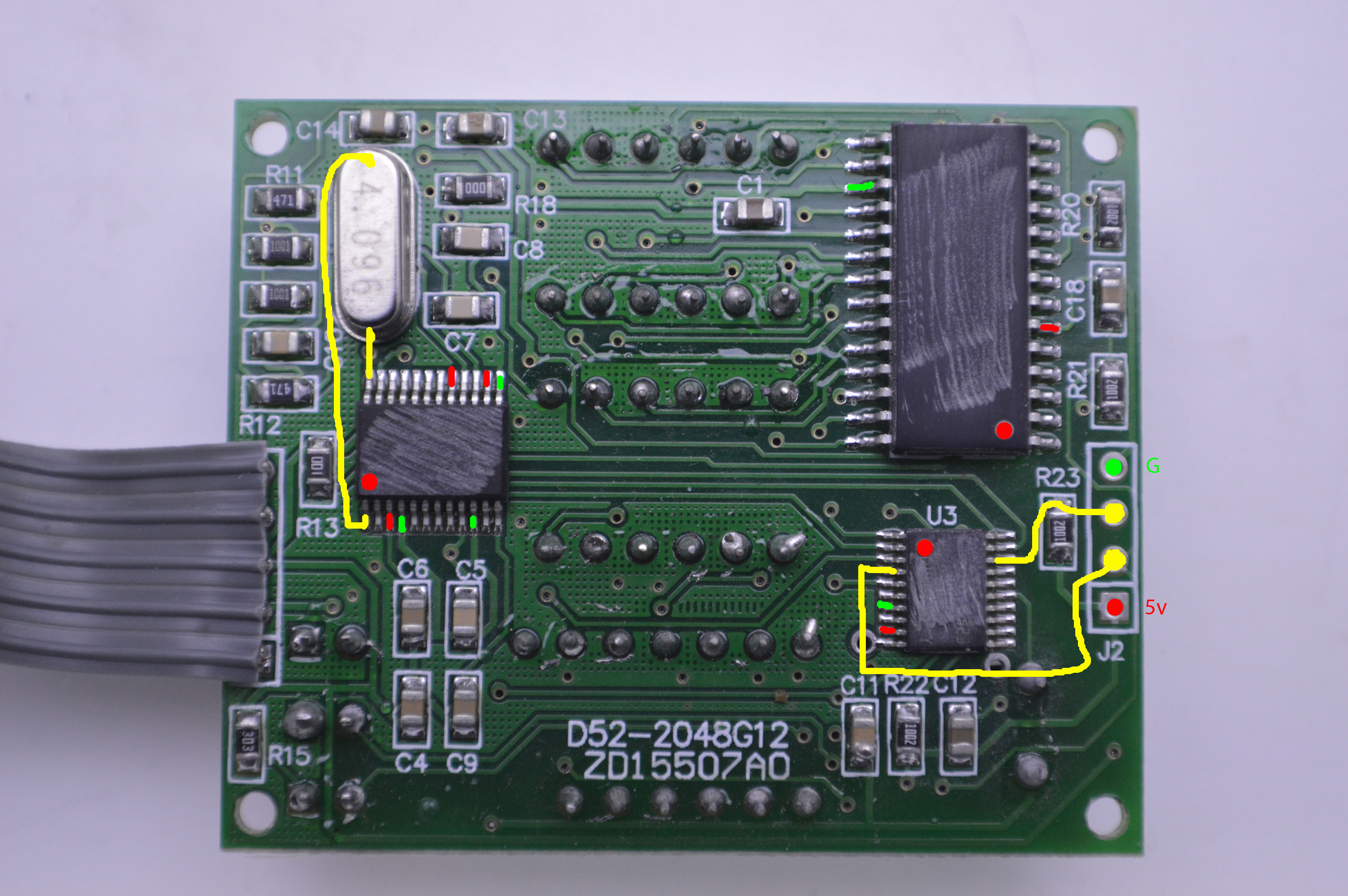

                nice, the small board has 2 pins on the ribbon for current, the other 3 are the supply and sense-voltage.
                so just need to draw a schem of the small board.
                btw, if you can use a meter to see how the 4pin header on the edge and the crystal connect to the 24pin chip around the ribbon we can id the microcontroller.
                The 4 pin header only connects to U3, 5v, and Gnd. Does it sound like U3 is a flash IC? I marked Gnd and 5V on all the ICs.
                ------------signature starts here------------
                  • 31187
                  #188
                  u3 may be a microcontroller,
                  but with that power layout it's not a pic or an avr
                  • lookimback
                    • Aug 2013
                    • 1489
                    #189
                    I really want to decap them just to satisfy my curiosity, but I don't want to play with nitric acid without the proper safety equipment. I'm just kind of prefer my fingers, lungs, and eyes the way they are.
                      • 31187
                      #190
                      just download datasheets for mcu's with that many pins from lots of company's until you find one with the power on those pins.

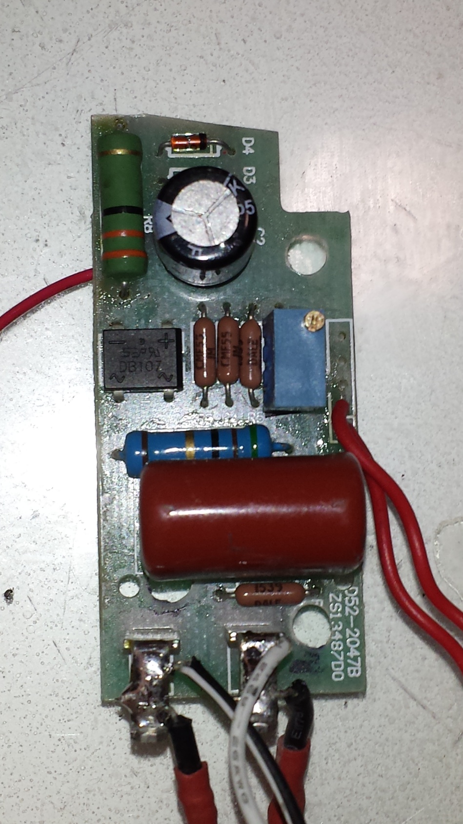

                              Well here's something I didn't think about in my plan is to use a pot to adjust the value of the 33Ω resistor. I'm replacing the resistor with a 27Ω one to give me a bit of adjustment room, and prevent any damage to the circuit by having too little resistance if the pot was turned down too far. The resistor appears to be a 3 watt, so I replaced it with a 3 watt 27Ω resistor in series with a 3 watt 50Ω pot. Now, what just dawned on me is that I didn't need a 3 watt pot because most of the heat will already have been dissipated by the resistor. Would that be correct?
                                • 31187
                                #195
                                maybe, but not so much that it should be less than a 1w cermet pot
                                and remember the voltage rating needed
                                as for the resistor, avoid wirewound because they are inductive - stick to metal-oxide types.
                                • lookimback
                                  • Aug 2013
                                  • 1489
                                  #196
                                  The 27Ω is MOX. The rest are metal film.

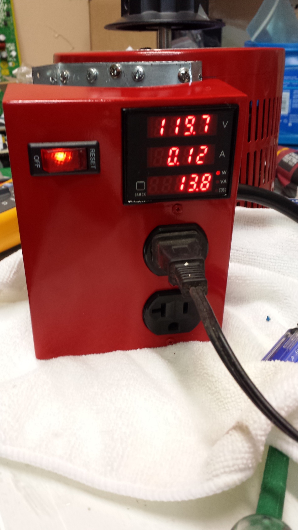

                                    • lookimback
                                      • Aug 2013
                                      • 1489
                                      #198

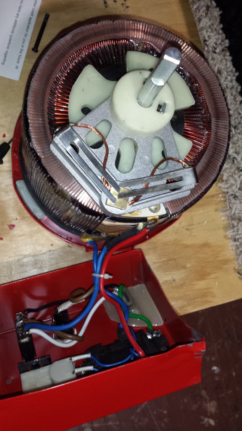

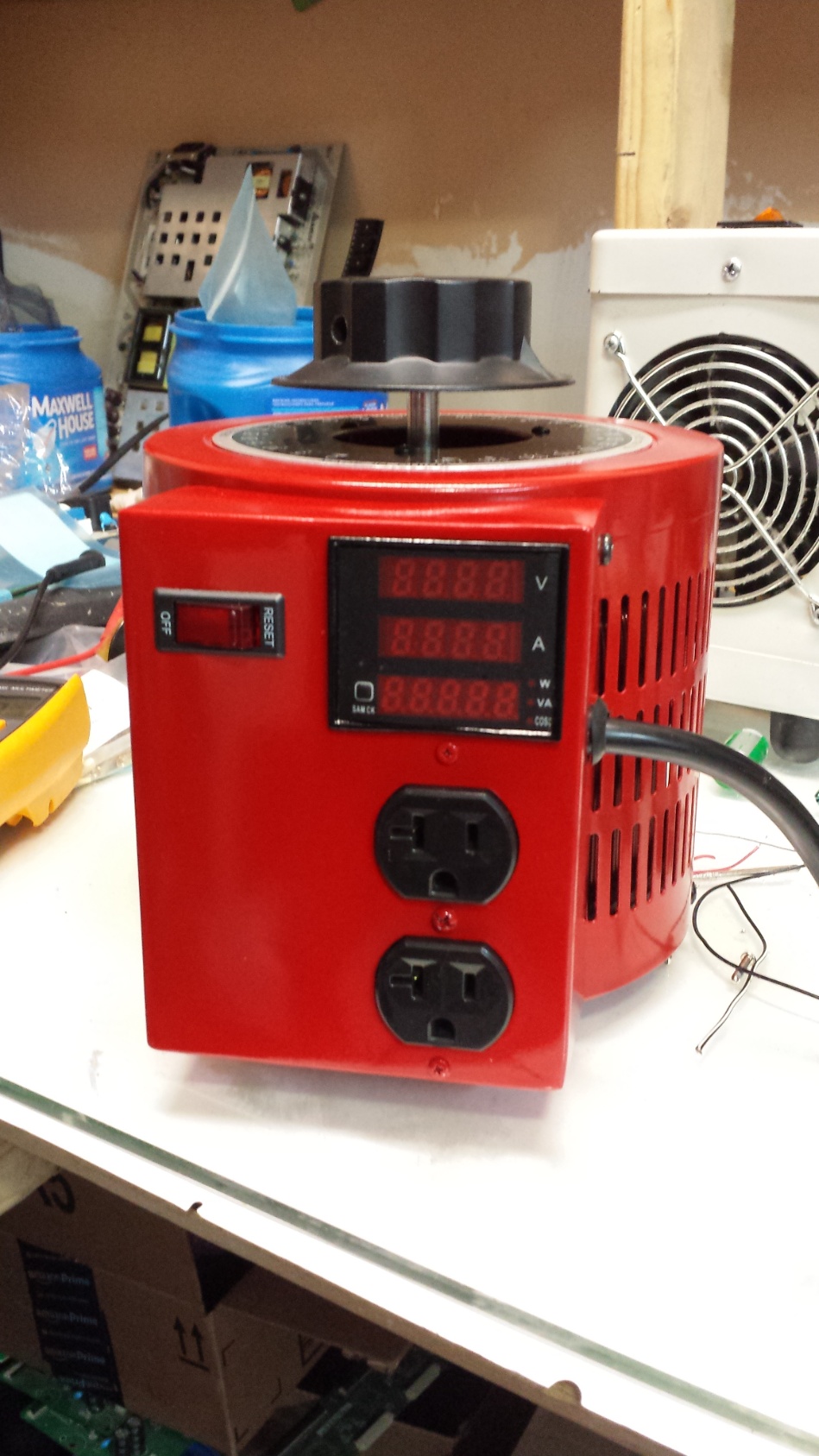

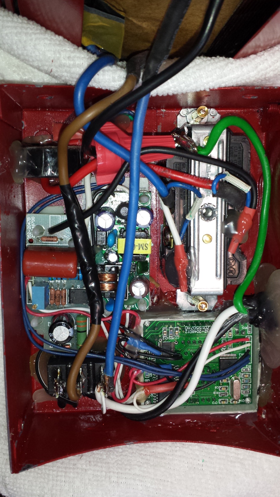

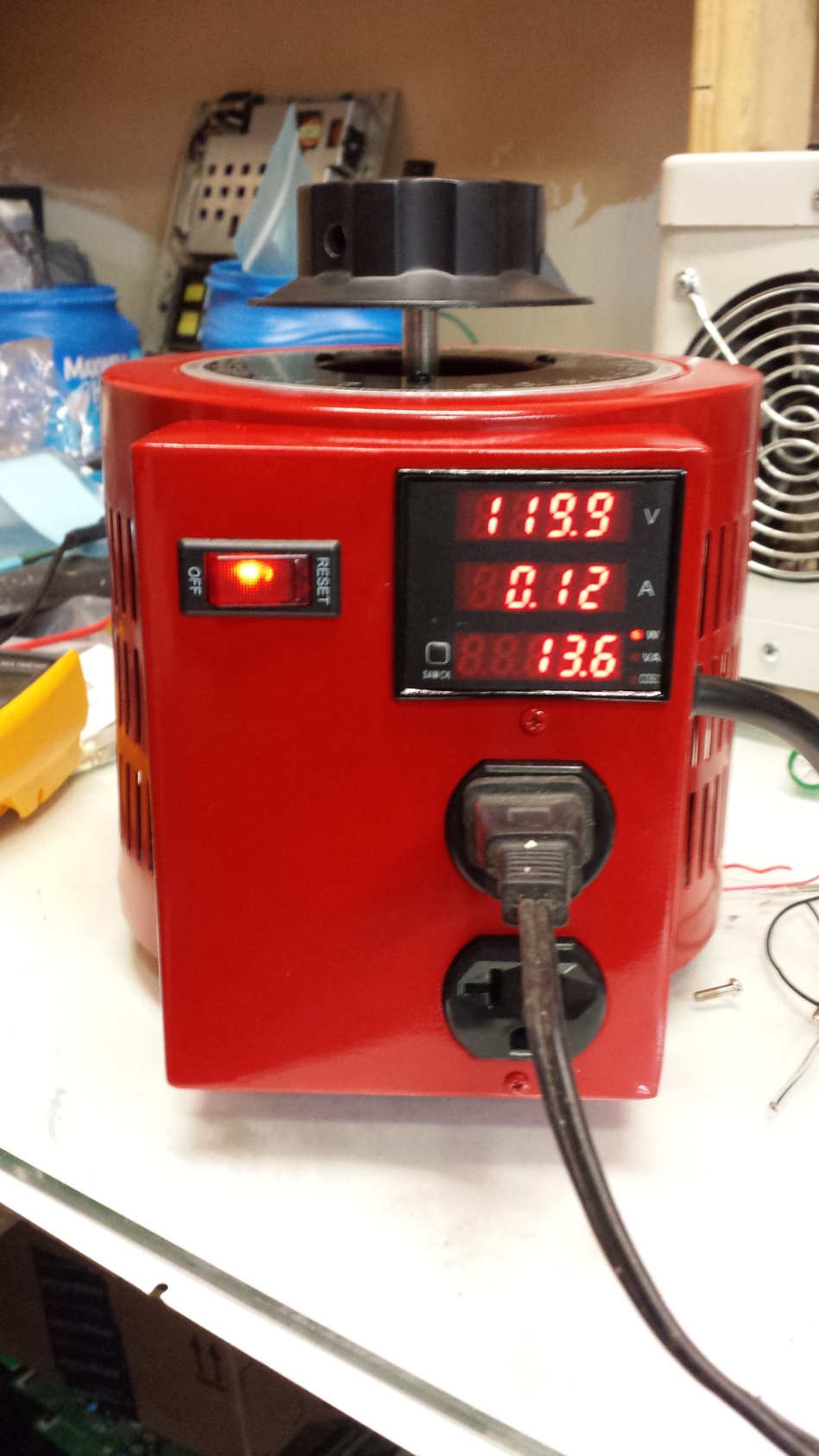

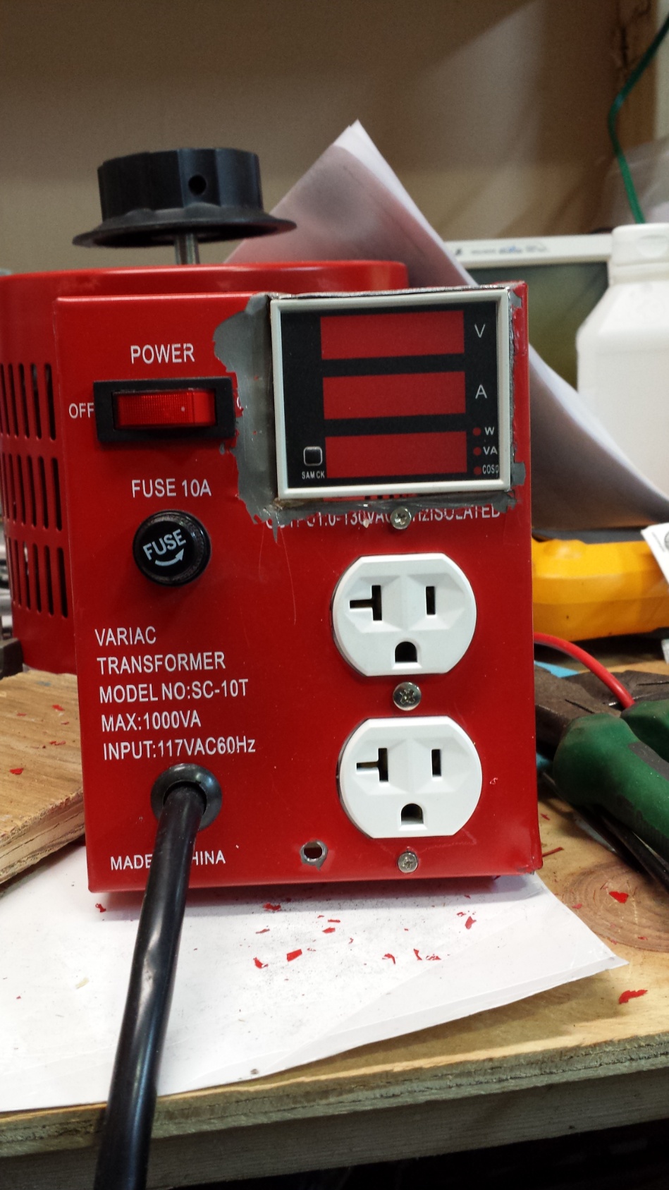

                                      Done for now. I ended up replacing R6 with a 866Ω resistor in series with a 200Ω, 1W, 25 turn cermet pot. It isn't quite right though. I can dial it in perfect, but it doesn't stay dialed in when I change the voltage. I'm going to buy another meter to play with, but for now I need the variac usable. I'm thinking it's a software problem. I think it looks really good though.

                                      • lookimback
                                        • Aug 2013
                                        • 1489

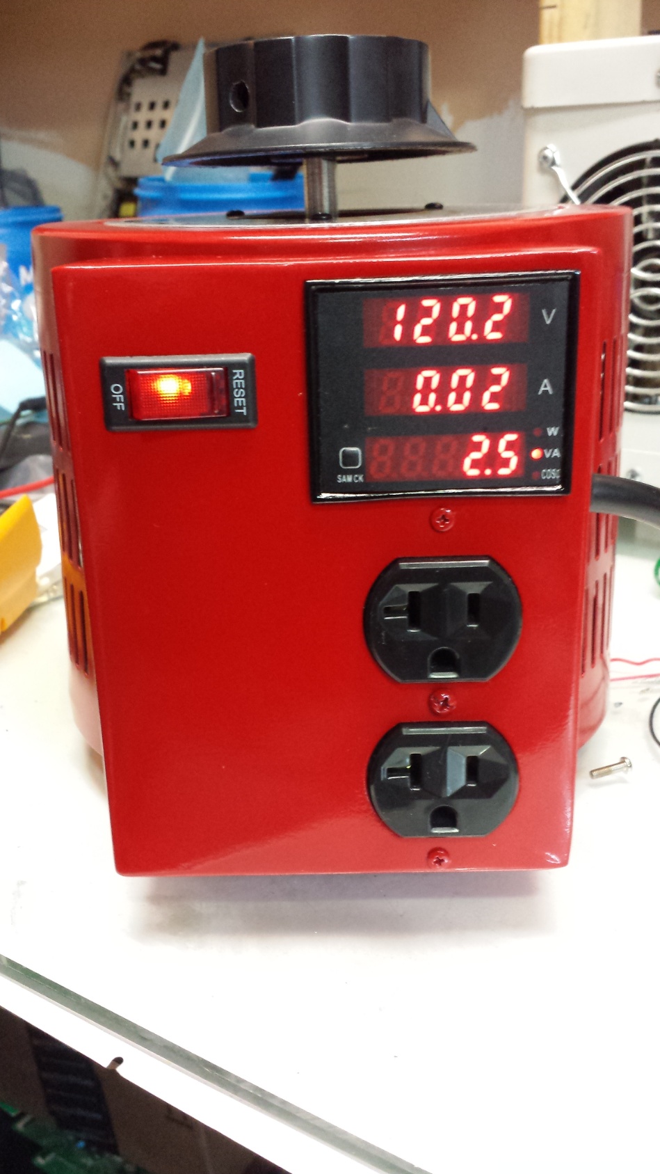

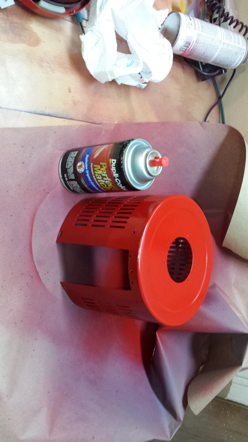

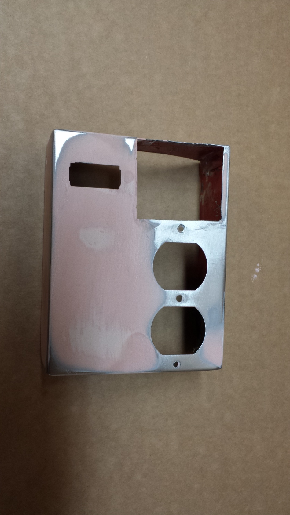

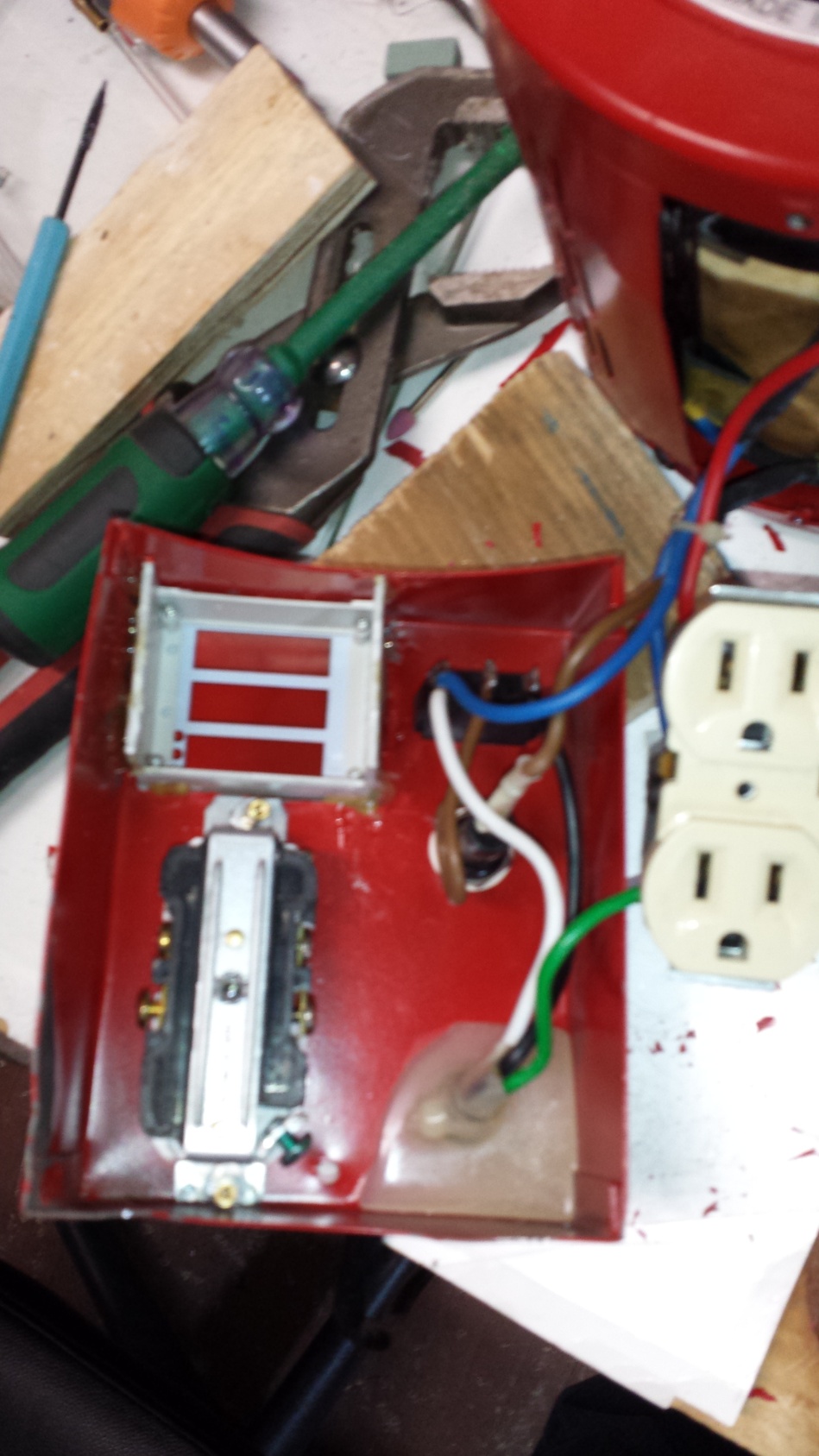

                                        #199
                                        Just the before and after pics.

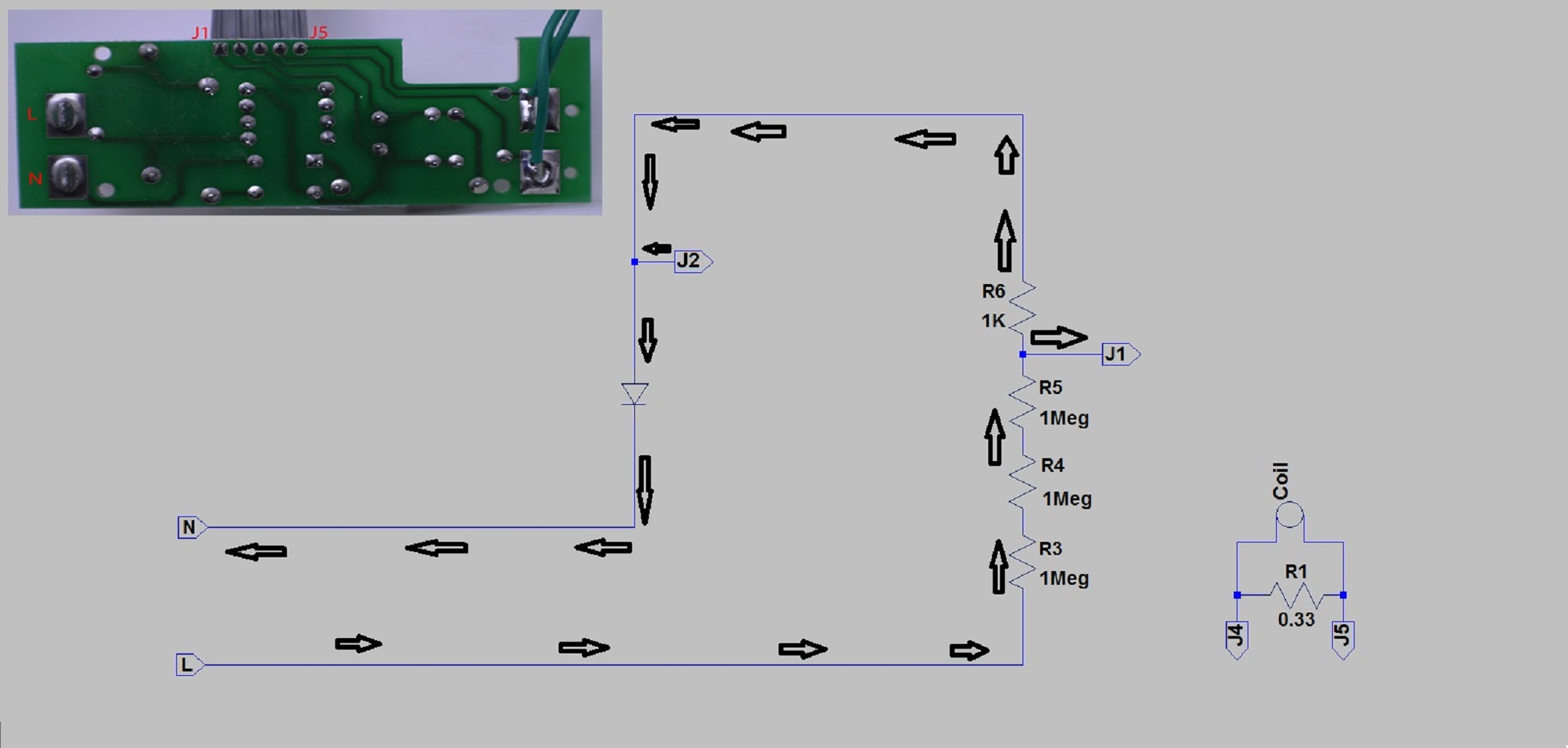

                                          #200

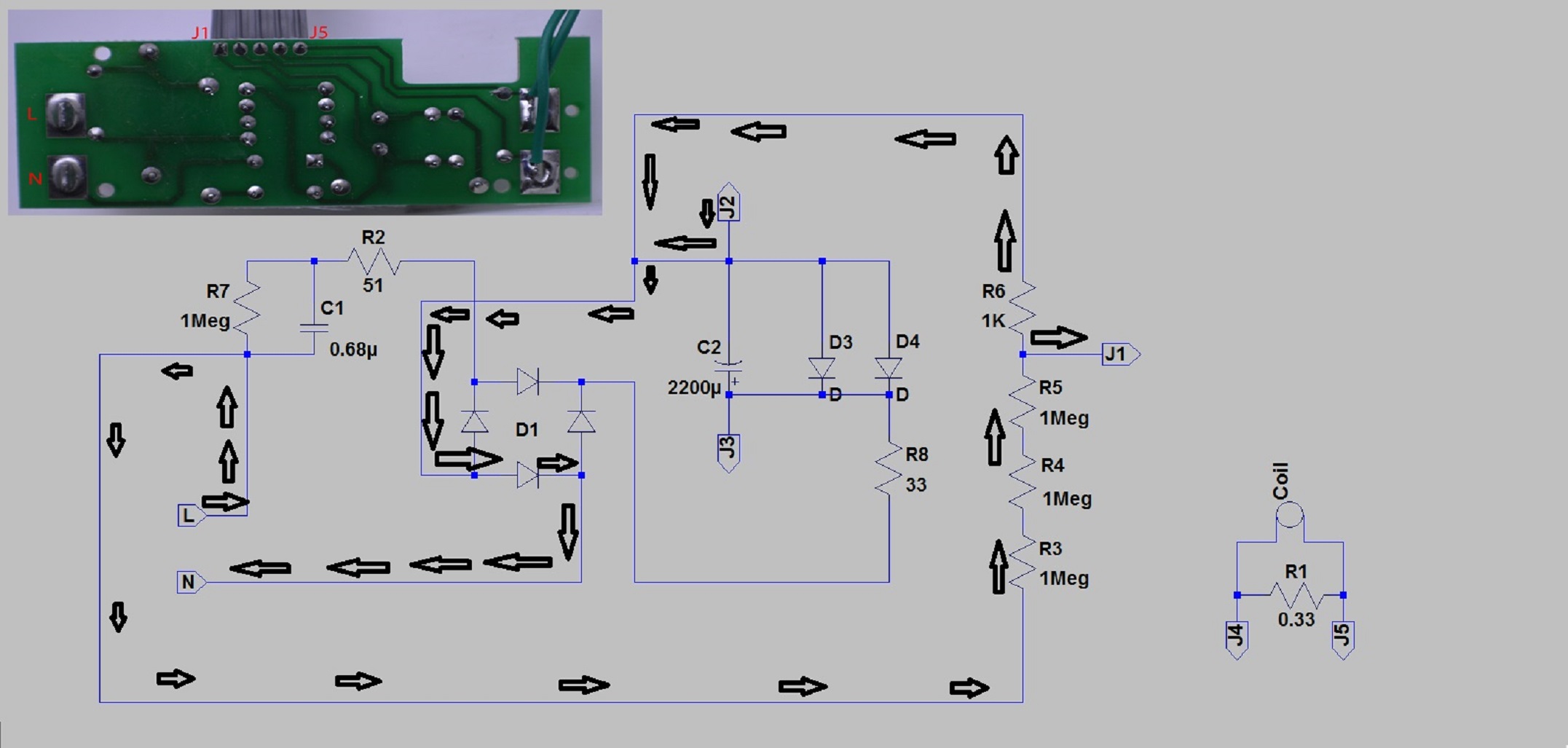

                                          So, I've learned a lot in the 2 years since I modified the variac. Still never got it perfectly accurate, and I'm ready to open it back up. I found a different revision of the meter I used, and found that the big 28 pin IC is a TM1640, which is an LED Drive Controller. Still no idea what the other two ICs are. I suspect one is an eeprom. I want to completely eliminate everything which isn't part of the voltage sense circuit with the hopes of finally making it accurate.
                                          The first attachment is the power supply circuit.
                                          The second is how I think current flows through the voltage sense circuit (ignoring the power supply portion of the circuit).
                                          If I'm correct, then would the third attachment be right or would there be some parallel equivalent resistance from the power supply portion of the circuit which would affect the sense portion?
