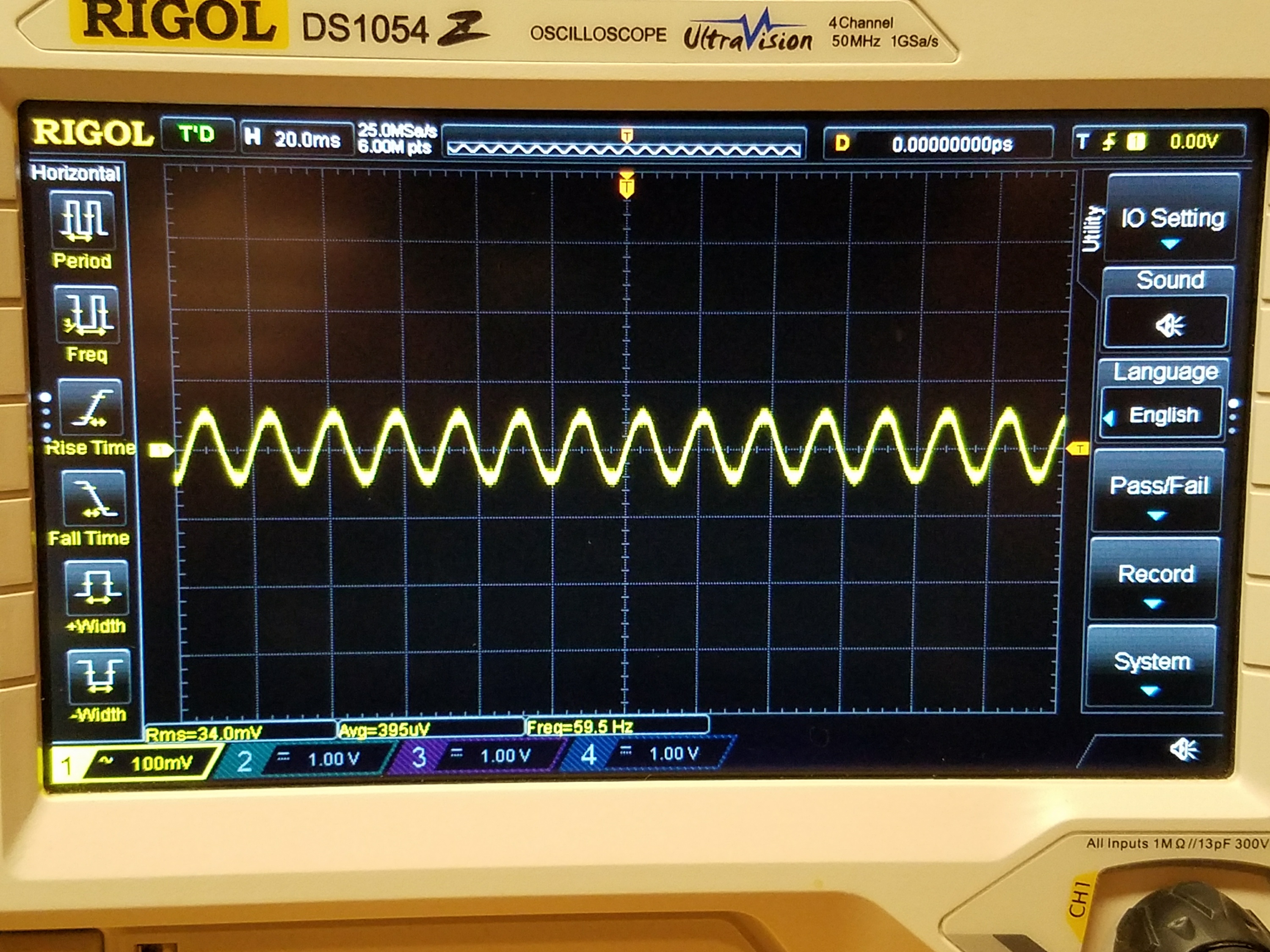

    Here's what I see on the scope from the output of the voltage sense circuit. This is not the one in the variac , but the identical circuit. The input voltage is 100V and Ohms law says the output should be 33mv, so it's pretty close, but that 1.3mv that it's off amounts to the meter being over 3v off. The one in the variac is probably more accurate, because I've upgraded to all 0.1% resistors.

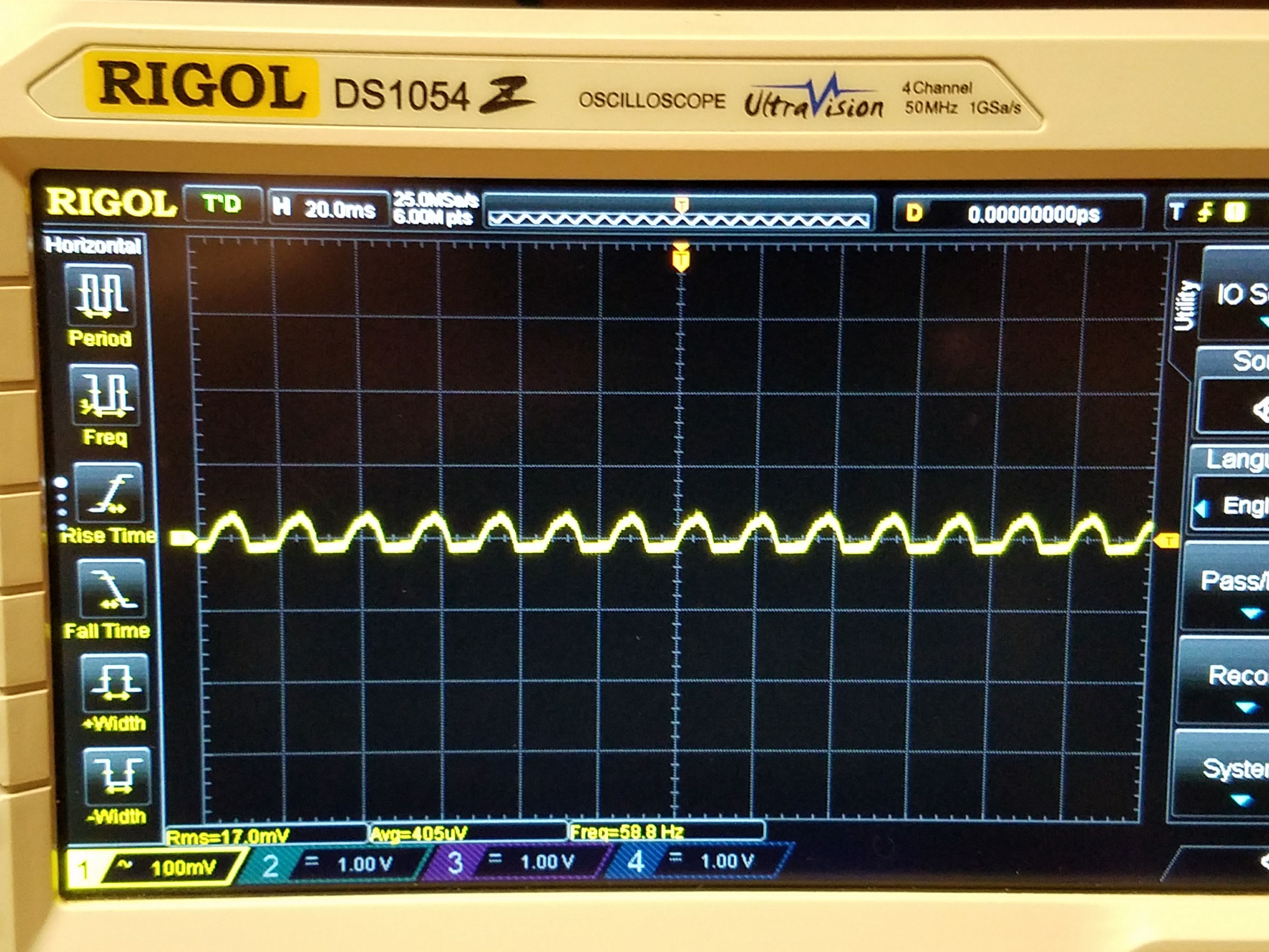

      So I gutted everything from the sense board which was related to the power supply circuit. The first waveform is with the bridge rectifier in place, and it's equivalent to a single diode at this point. That is the waveform I expected before I altered anything. Obviously, I forgot about what happens when the current changes polarity.

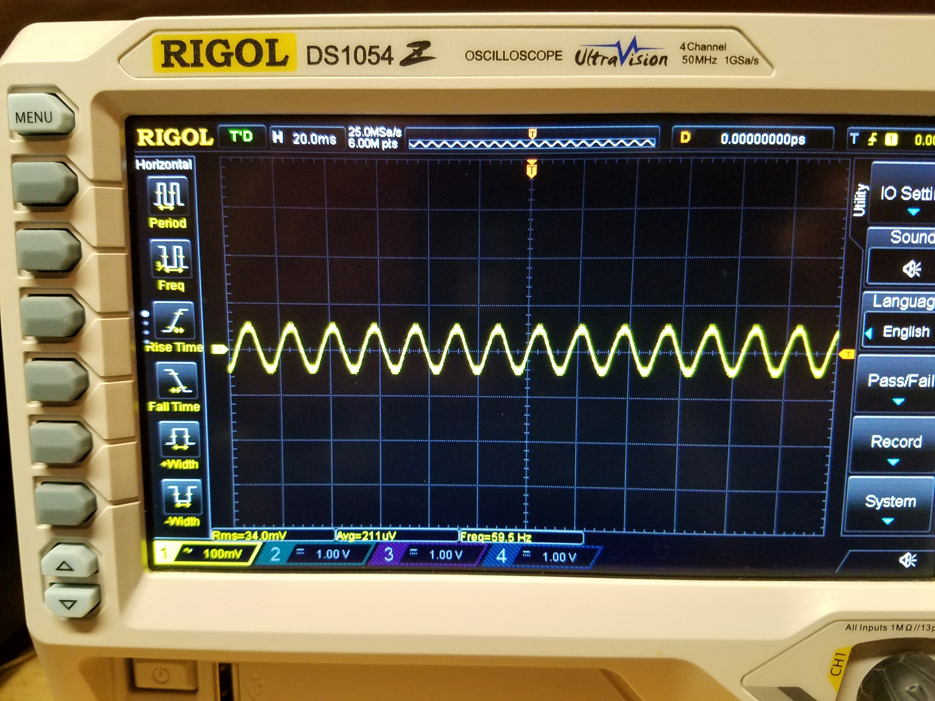

      Second waveform is with the bridge rectifier removed, and a jumper to complete the circuit between neutral and R6. That waveform matches the original one. I'd call that a success. I'll do that to the one in the variac and adjust my voltage divider so it's correct, then it's on to the control board. I think I just need to decouple the AC sense line from the power supply circuit, and maybe add a pot to the voltage sense input on the micro.

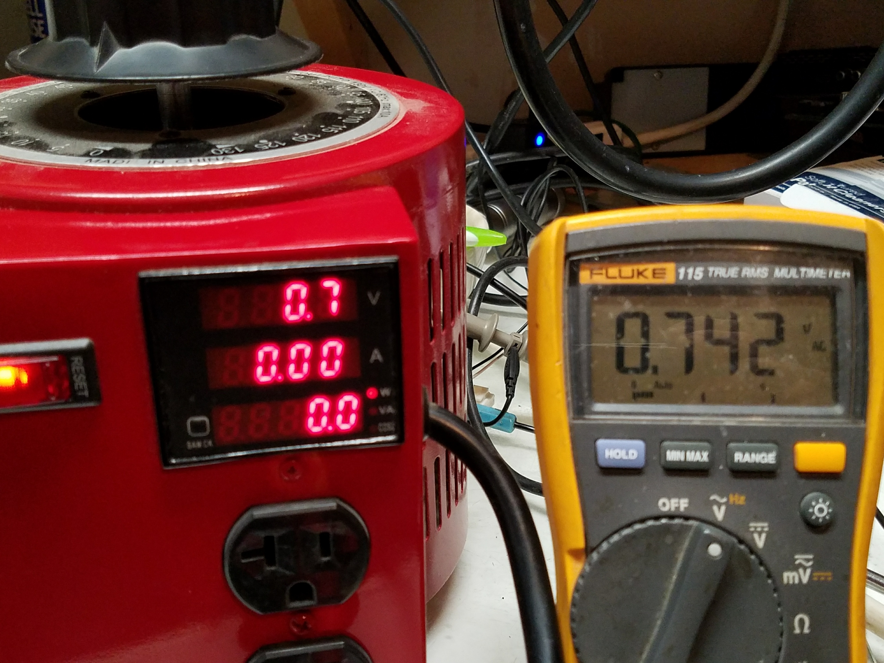

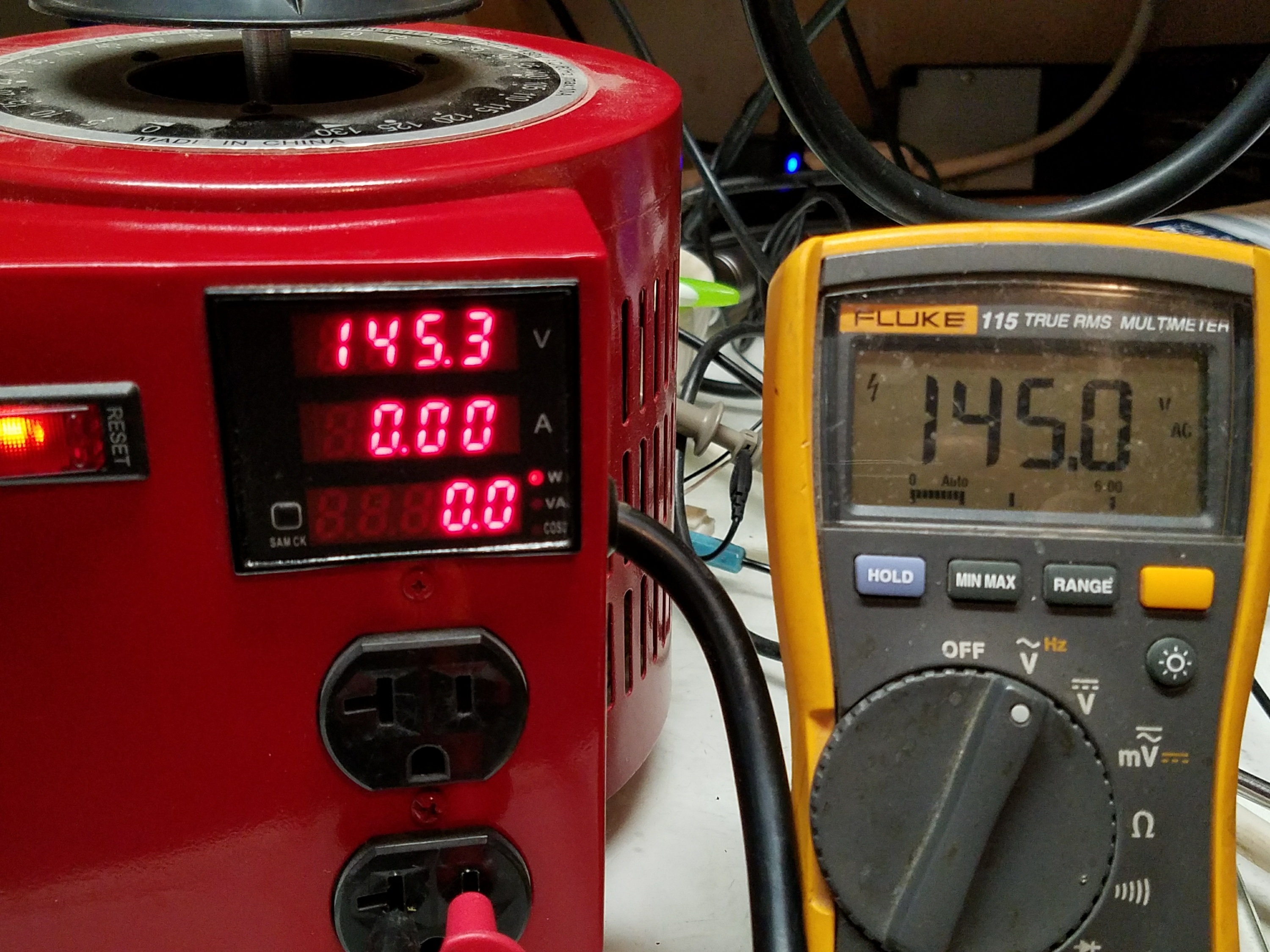

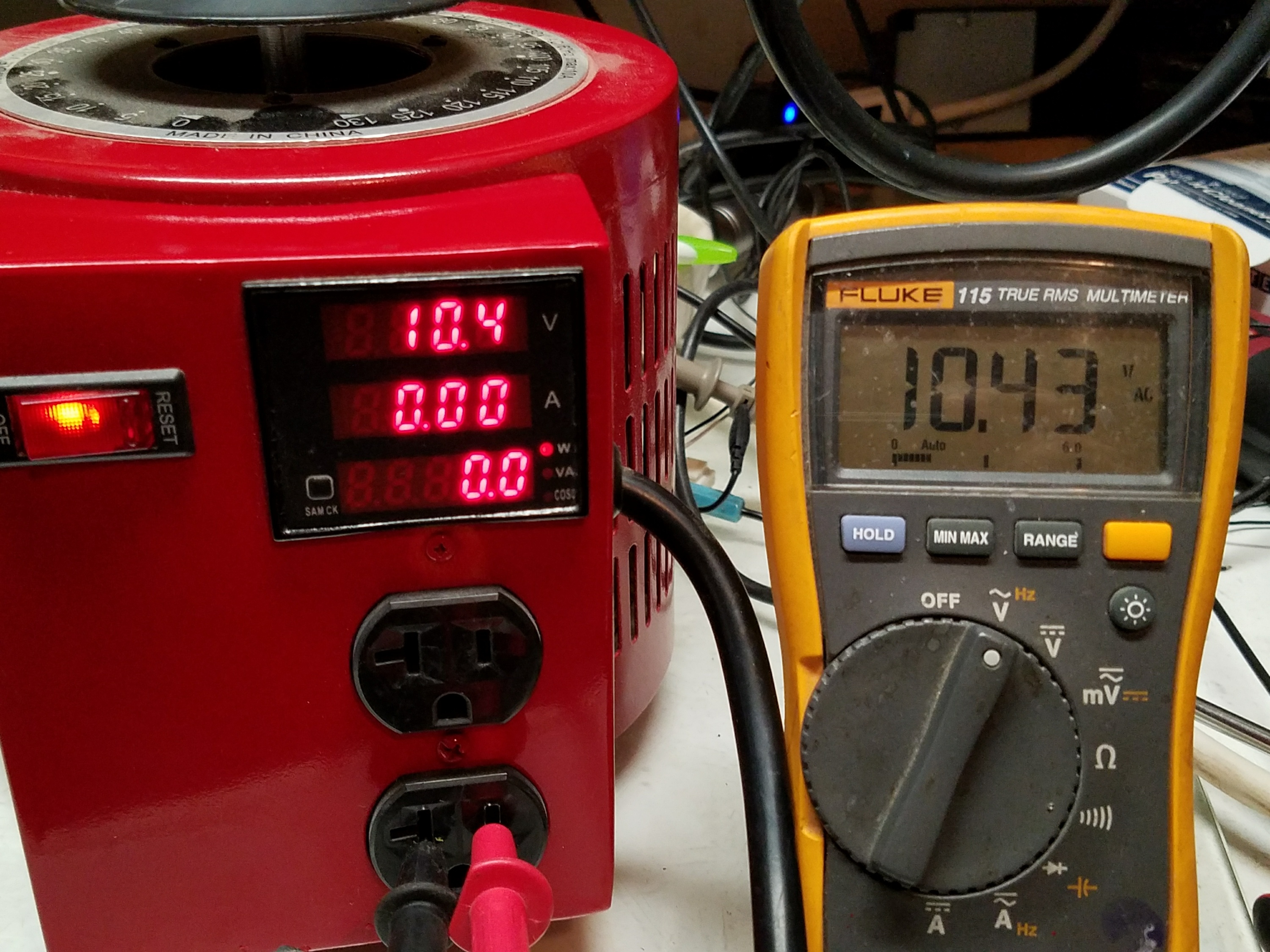

        Solved! I removed everything which wasn't part of the voltage sense circuit, and now its within 3 to 4 hunredths of what my Fluke reads at any voltage. Some of that could be from the single digit resolution on the meter. I could probably add range adjustments and more resolution in the software if I could ever identify the micro, or at least figure out how to dump the firmware. The lowest it goes is 0.7v, but that's the variac itself.

            Would have been a cool project to try and make it auto ranging. Still though, I'm happy with how it turned out. I also took a file to the back stop and got it down to 0.2v. If I had a meter which could cancel out it's lead resistance, I have no doubt I could make this as accurate as my Fluke. It's all about the voltage divider. The voltage is sampled between a 1k resistor and 3 1m resistors. I think they're all 1%, maybe .1%. It's been 2 years since I did the rest of the mod. If I put a pot on each side of the divider and dialed them both in perfectly, I think I could close that .3v difference. But really, I'm not lugging this thing around to use as a multimeter, I just want to be confident that if it says 120v, it's close enough to not damage anything. That, and if it's close, the wattage displayed will be close to accurate.
