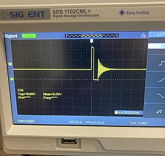

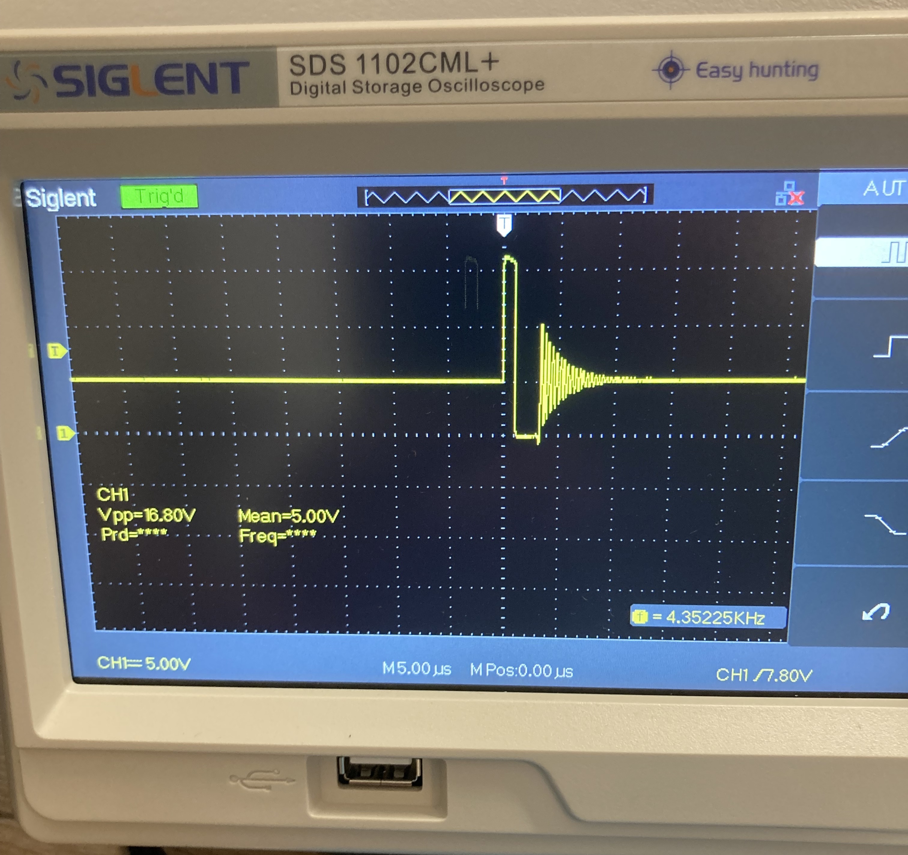

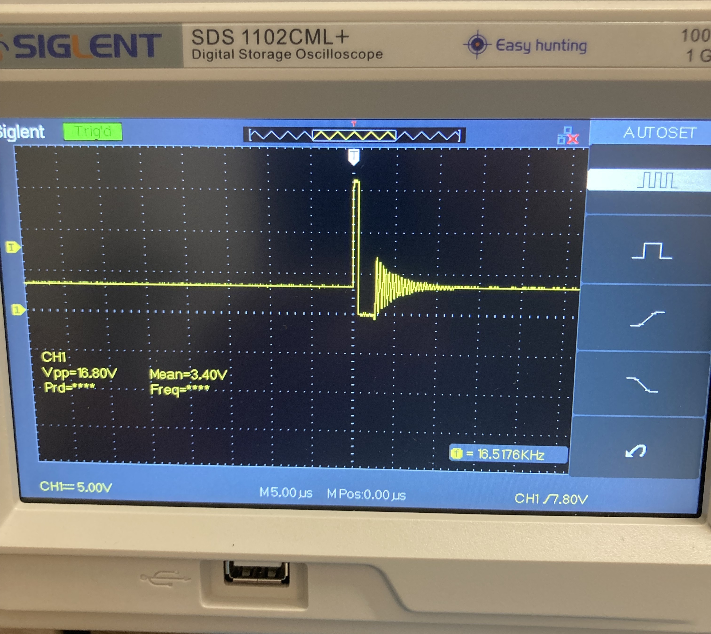

    I have a PGOOD pin down on this chip and I’m wondering if it could be because there is 5,2 v on VREG5 ( the high limit according to the datasheet is 5,1v ).
    if yes, why is it to high?
    the motherboard board is LA-G881P.
    thank you.
    here is some measurements :
    • VIN = 16,3 V
    • VREG3 = 3,299 V
    • VREG5 = 5,203 V
    • SW2 (repos) = 3,423 V, pikes at ~16,4 V
    • VBST2 = 8,592 V → VBST2 − SW2 = ≈ 5,17 V
    • VO1 = 5,28 V (stable)
    • EN1 = 3,08 V, EN2 = 3,04 V
    • VFB1/VFB2 ≈ 2,1 V
