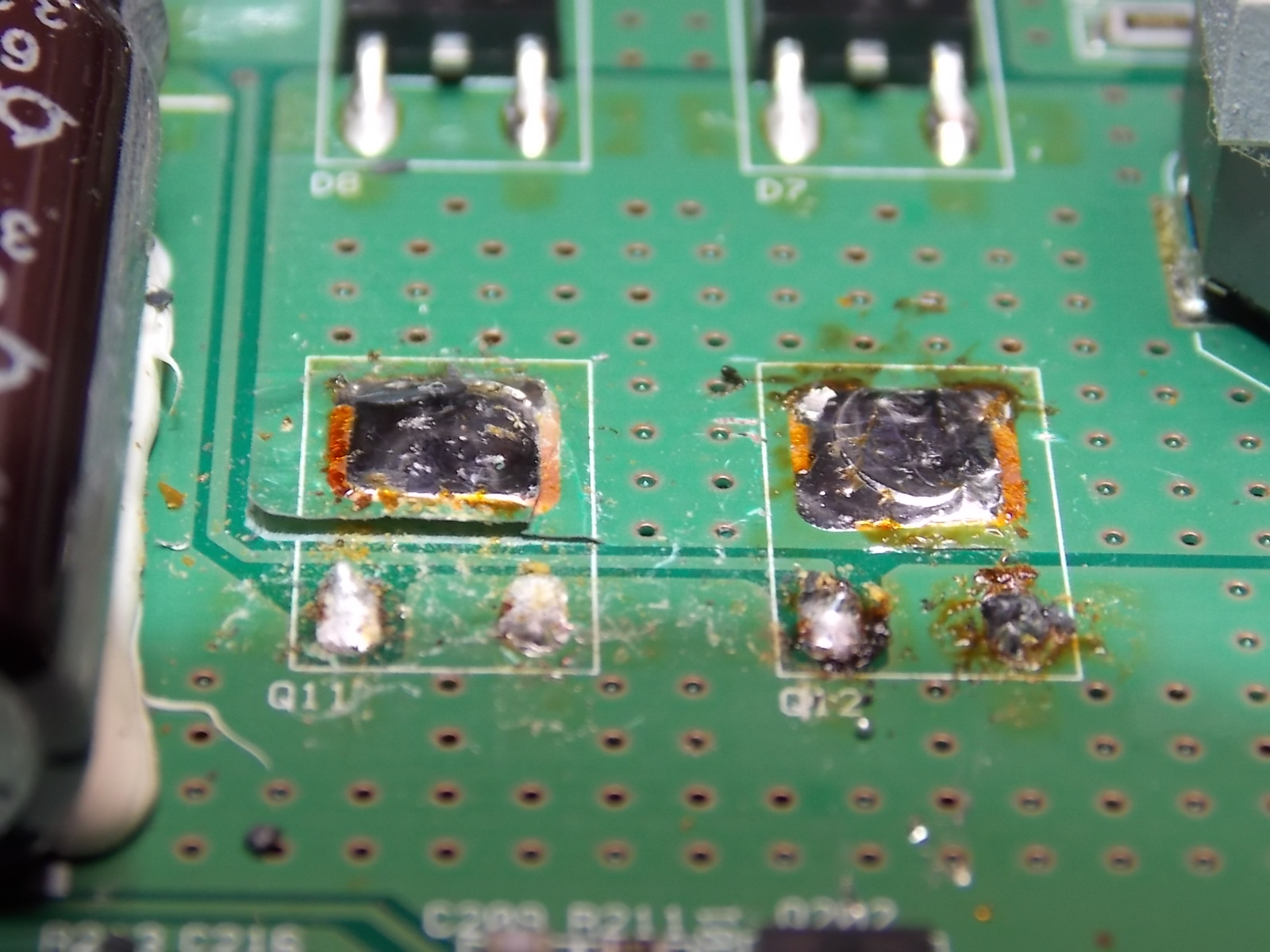

    Well, my first time desoldering a MOSFET/Transistor didn't go so well...I probably damaged the pcb . The laminate underneath the big base tab on the MOSFET bubbled up some and the first one even peeled up some laminate/copper with it when I removed from the board (I didn't even know that was possible!). Too much heat and prying. The second one came off much easier after I saturated with solder, so at least I learned my lesson, just angry with myself and venting a bit.
    On with the results...both of the MOSFETS that tested bad in circuit, also tested bad out of circuit. I will try to source some replacements and cross my fingers that the board will live to see another day.

      Let us know how it goes - if you need help or an opinion on repairing the board post pictures of the damage.

        not enough heat and prying too much! Once they are hot, you should just be able to pick it up like nothing, just add more solder maybe. You do need a good soldering iron though. A 25W isn't that great.

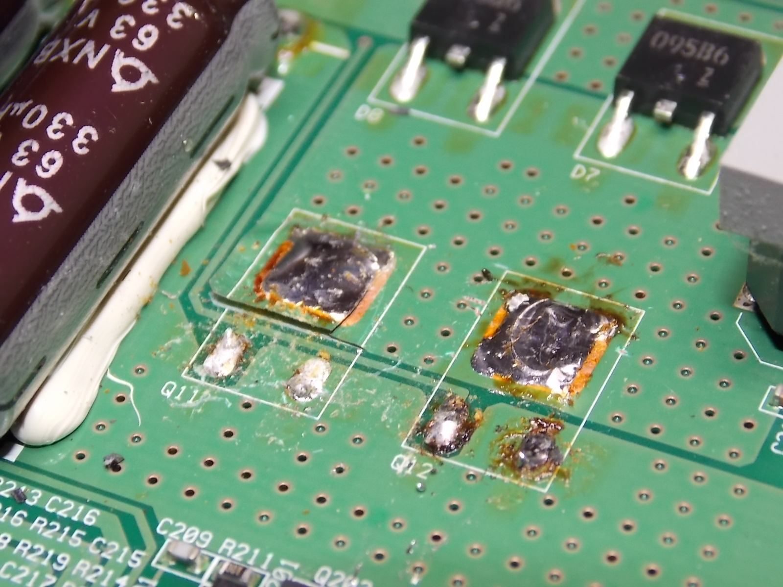

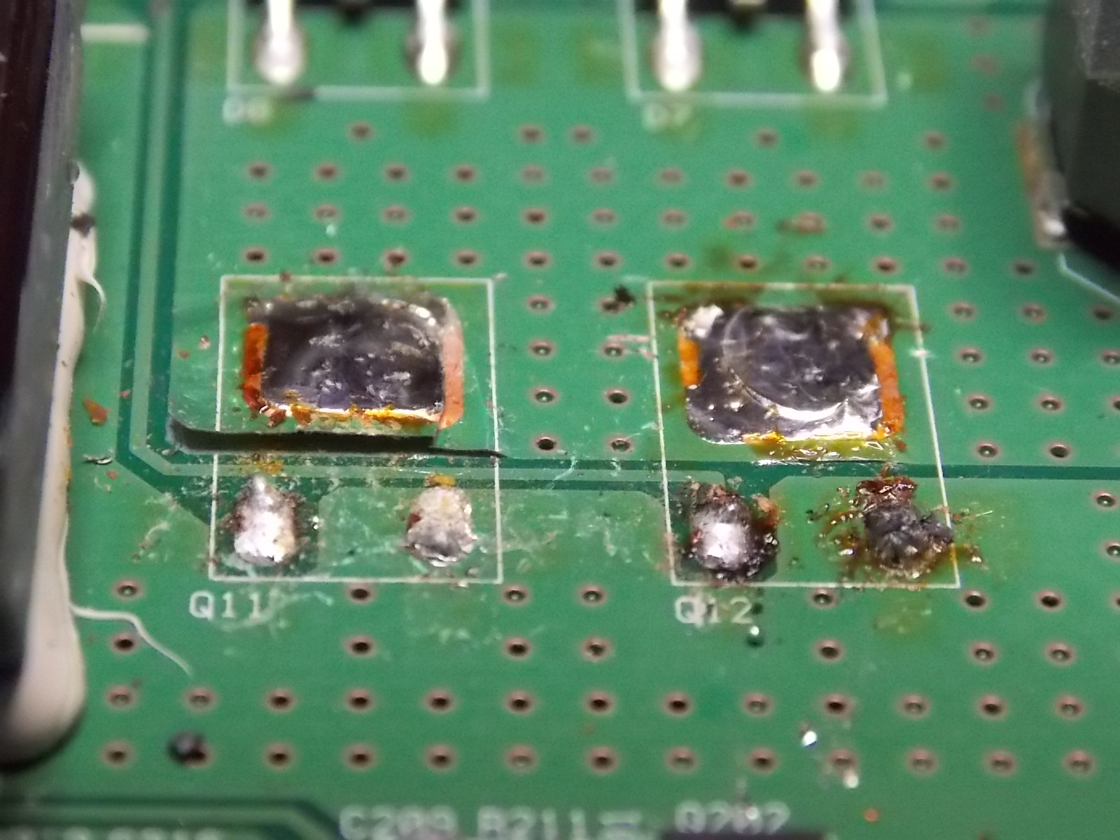

          I really hate to even post these photos...be gentle lol. I did a terrible job and its quite embarrassing, but I would feel more comfortable letting you guys take a look and getting your honest opinion if this pcb damage can be fixed or not. My main concern is the copper pad on the left that the MOSFET sits on, since it is raised up off the board. Can that just be adhered back down? Will soldering the new MOSFET in be ok if left as is? I probed around on the board just doing continuity checks in the area and it tests the same as the pad on the right, but I may be overlooking something obvious. It's just hanging on by a thread and has me concerned.
          I think I need a new tip on my iron as I just noticed that the end doesn't come to a point anymore, some of the metal eroded away. This may be why I had issues transferring heat, but regardless I shouldn't have pried so hard. Also, while I'm at it, I believe I will try a flat tip for the large pad area next time to see if that helps.

            ok, could not foresee that you would pry on the component, but mistakes are how we learn, there are some good solder/desolder tutorials on youtube. I'm bad at soldering too.
              Re: Vizio VF552XVT, audio, but no backlighting
              When I remove this kind of SMD, I cut the two legs first then I use my 60W Weller with wide tip and add the solder to the tab for removing it off the board.

                In hindsight I should've watched the videos before digging in lol, I just got the cart before the horse. Thanks for the sympathy.
                budm, that definitely sounds like the best way to tackle these SMDs.
                So, I'm still wondering...should I attempt to patch this thing back together? Will it hurt anything if I leave it as is and solder in the new components? Thoughts? Suggestions? I've got the replacement components ordered already and I'm just wondering if I should do some sort of maintenance on the PCB before putting on the new parts. Thanks in advance.

                  IT WORKED!! I just finished soldering the 2 replacement MOSFETS in the LED Driver Board, connected the board back up, and presto. To the best of my knowledge, the 2 shorted MOSFETS on the LED Driver Board were all that was wrong (knock on wood, it's only been running a short time up to now). I'm guessing there is some sort of feedback loop that detected the shorted MOSFETS which then told the PS to cut power to the LED Driver Board as a safety feature maybe? I'm still not positive on that one, but regardless, it is up and running.
                  I'd like give a big THANK YOU! to everyone that helped me with this project and also thank for your patience and understanding. This is honestly one of the most informative forums around and has a great community. I definitely learned a lot from this. Thanks fellas! Now to find the next project.
