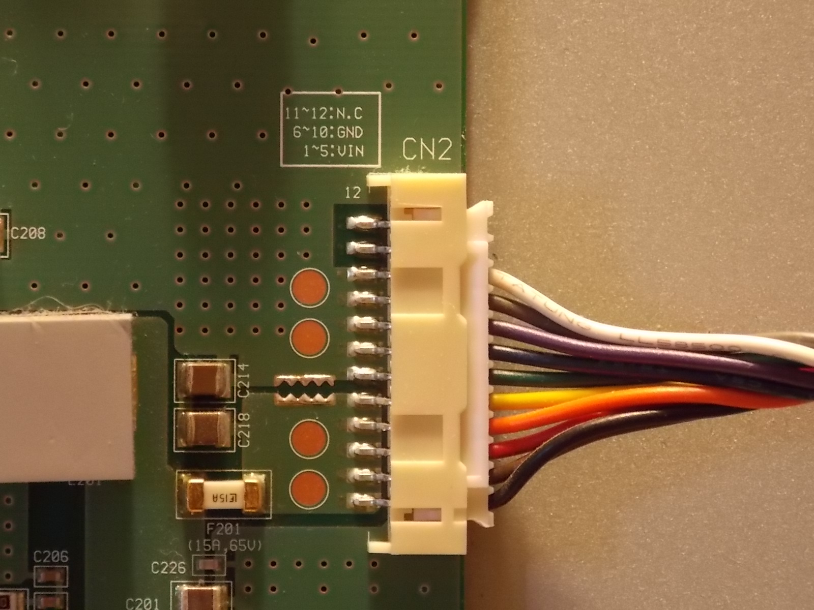

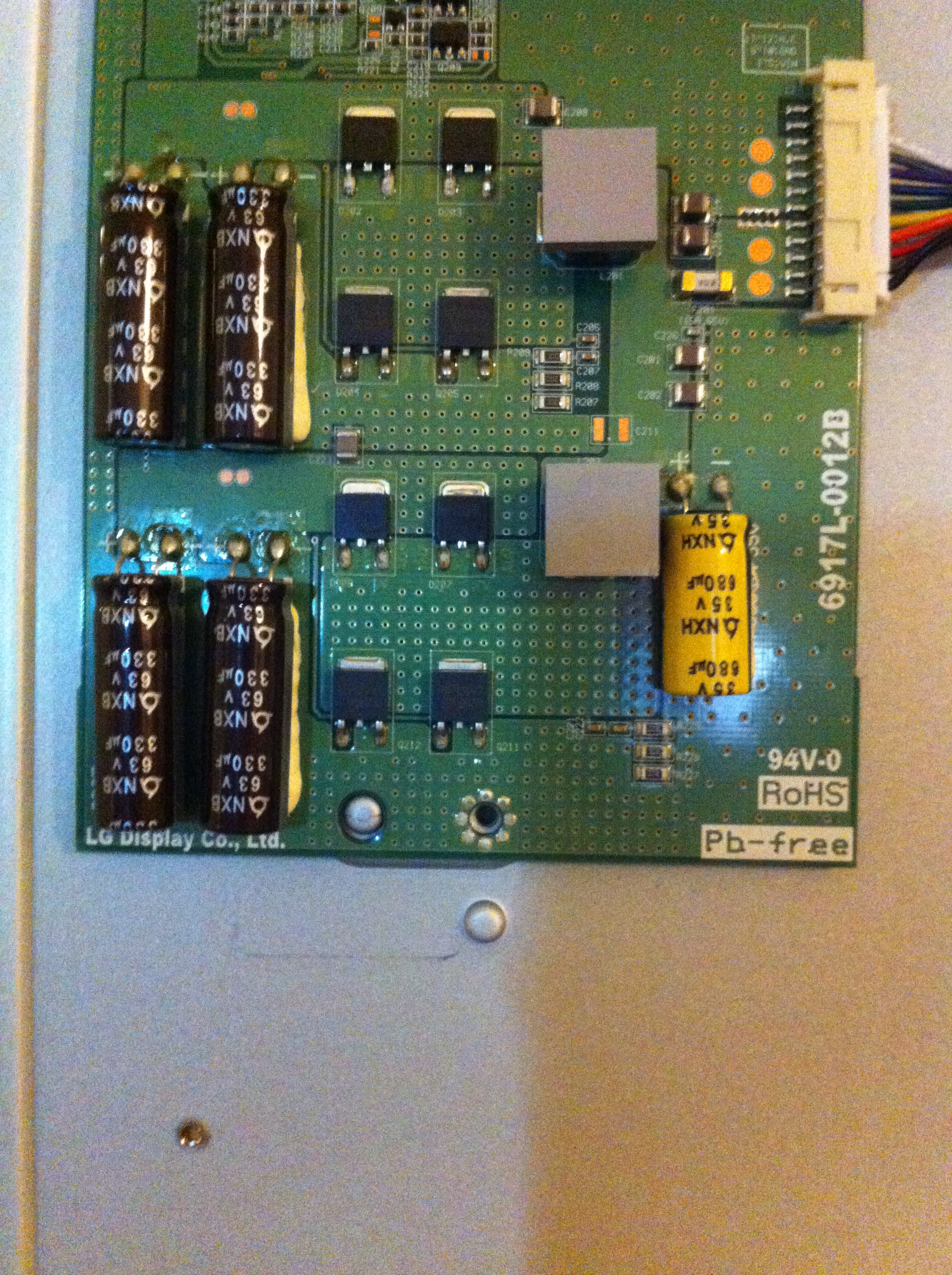

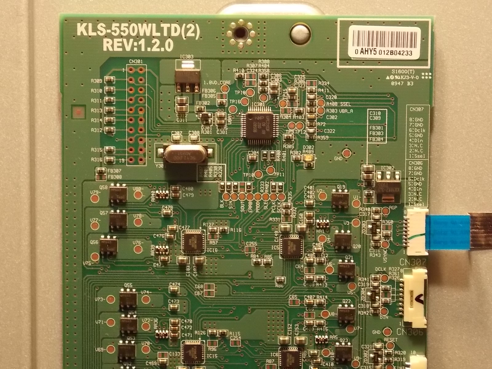

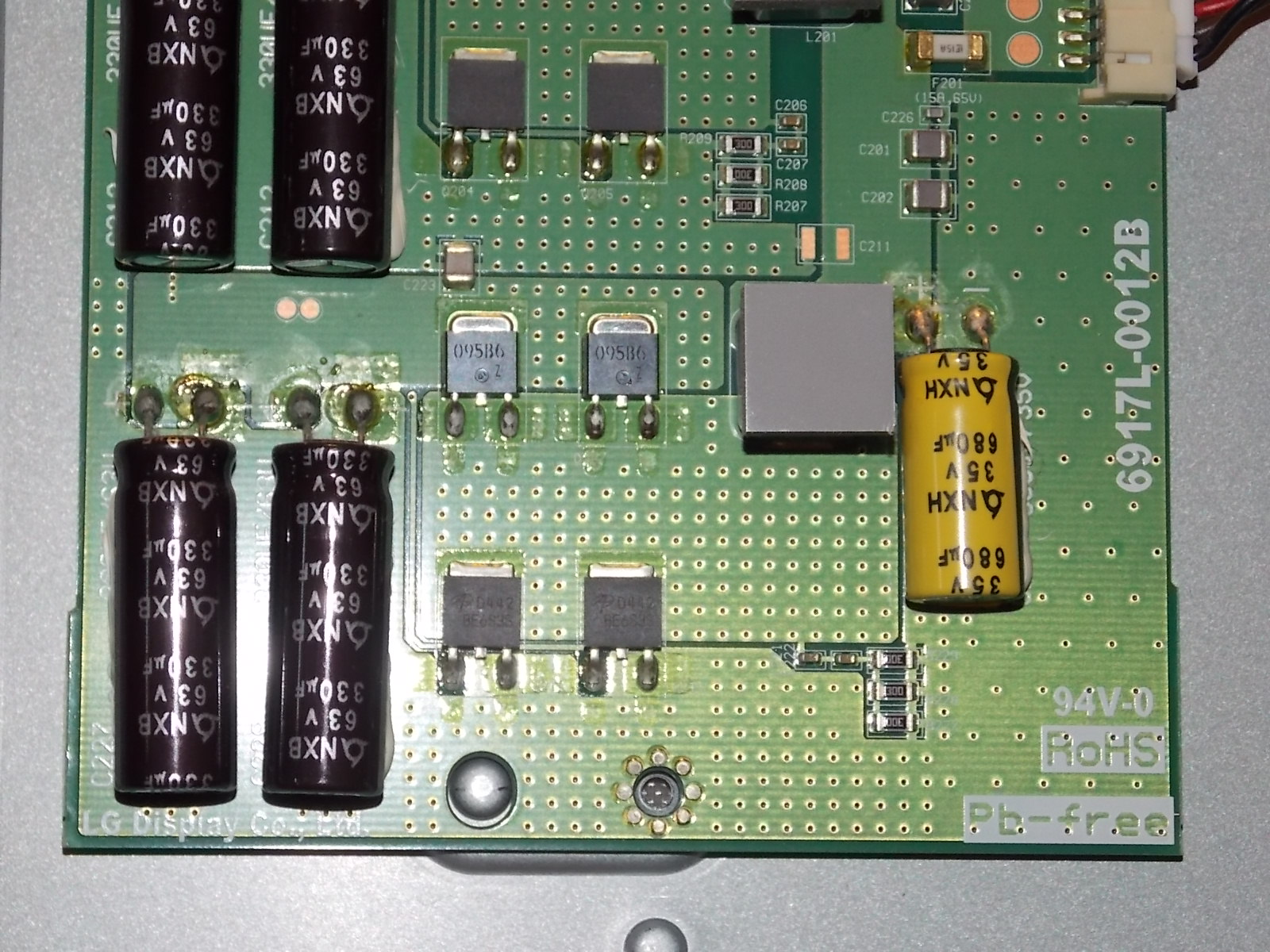

          LED Driver Board Info:
          Brand - LG Display Co., Ltd.
          P/N - 6917L-0012B (also another P/N in top left corner, KLS-550WLTD(2))

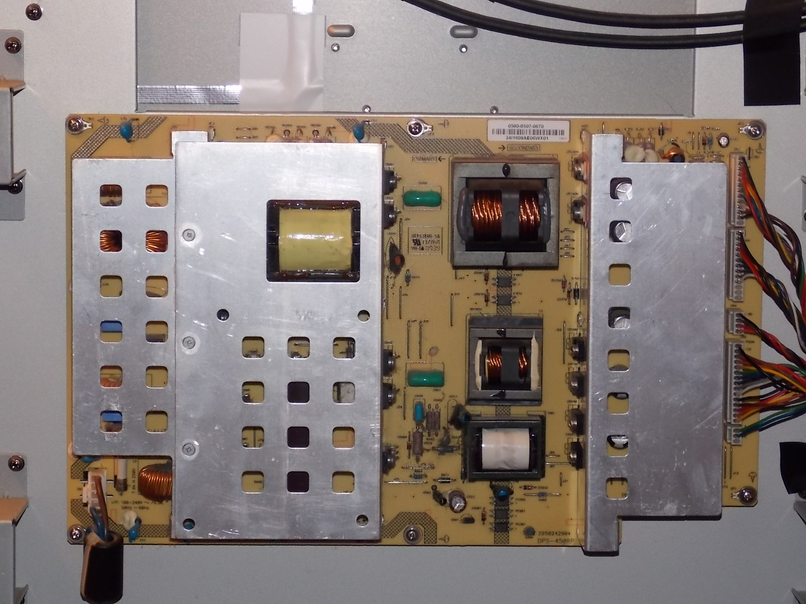

          Power Supply Info:
          Brand - Delta
          P/N - 005-0507-0670
          Hope this helps clarify the LED Driver Board, I ran out of room for the PS photos, but can put in a new post if it would help.

            Re: Vizio VF552XVT, audio, but no backlighting
            Not sure how a 2.5mb picture can be so fuzzy Not enough light probably and the first picture is just poor.
            Anyway have you tested the fuses on the board? and voltage on each side of the fuses with respect to ground

                There appear to be 3 fuses? if ok try disconnecting the leads to the leds and see if
                the 24v still drops. Probably will as it will detect no lamps as a fault and will shut down.
                At that point I think we will be struggling as next step is probably to open the panel
                and look for faults on the led strings.

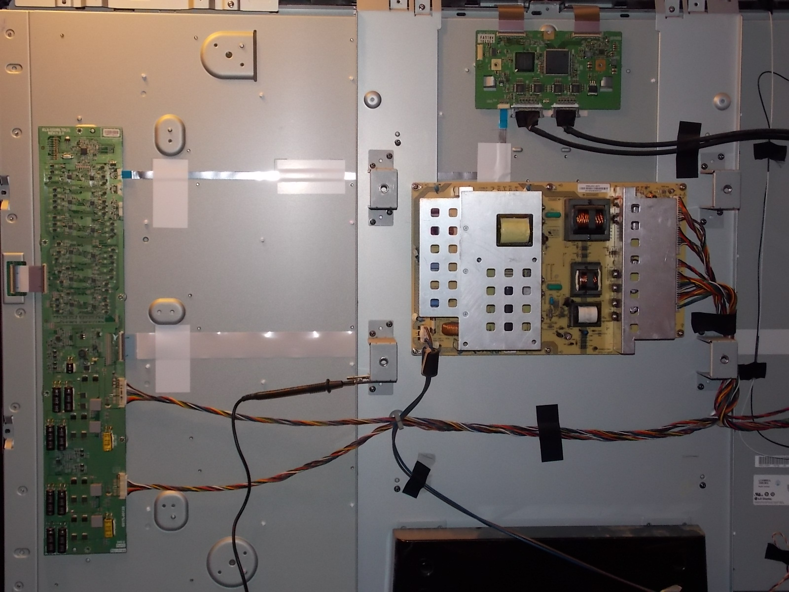

                    You just ruled the LEDs out for now. Back to the led driver board. Check those transistors and diodes if they are shorted. Are the fuses good (should read a short)?

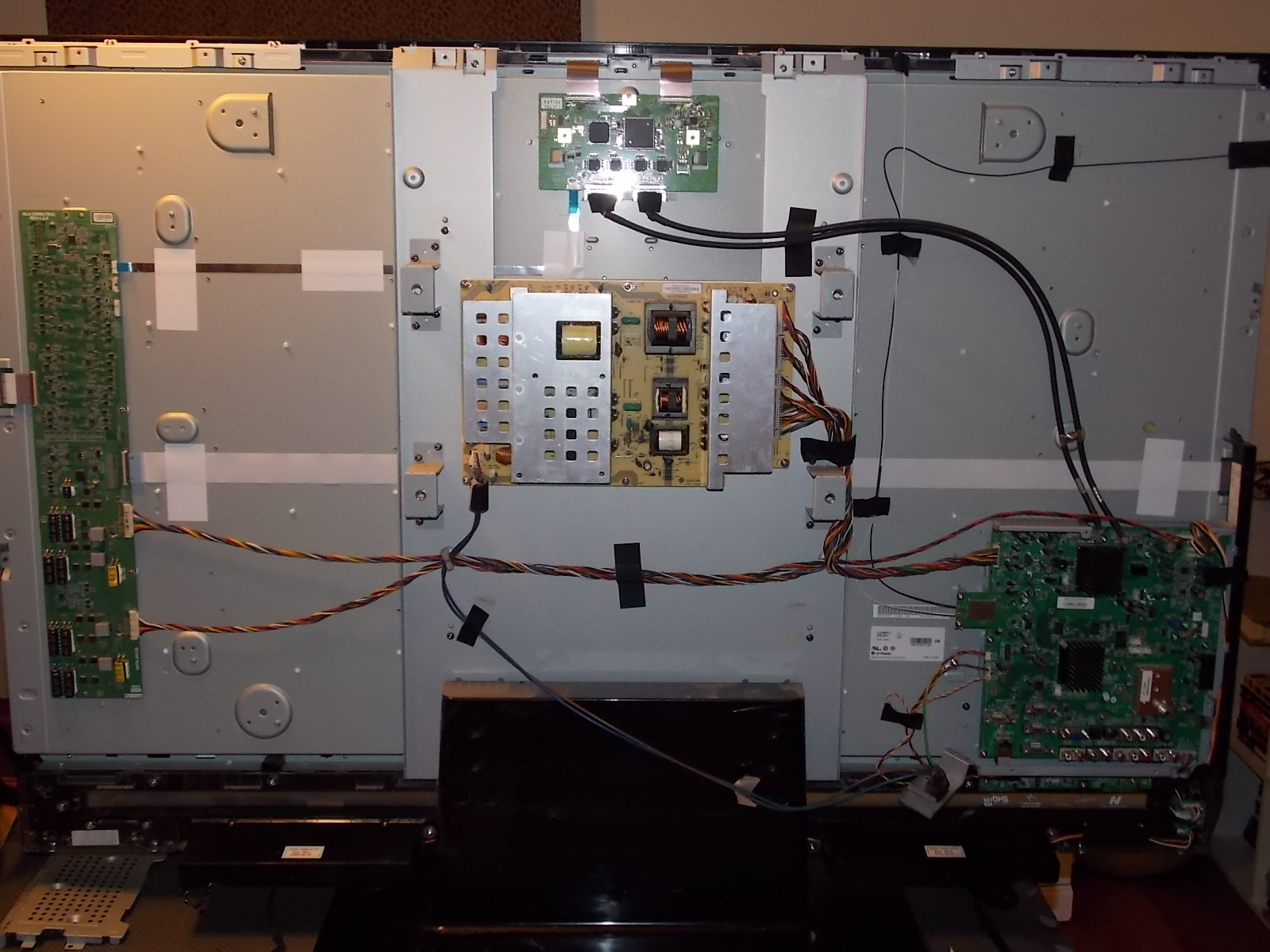

                      Can we see the whole back side of the TV so we can see how all the boards are connected together?

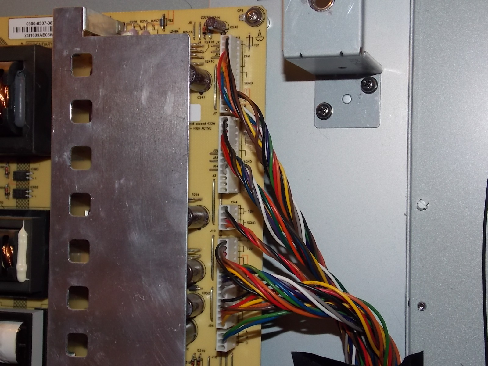

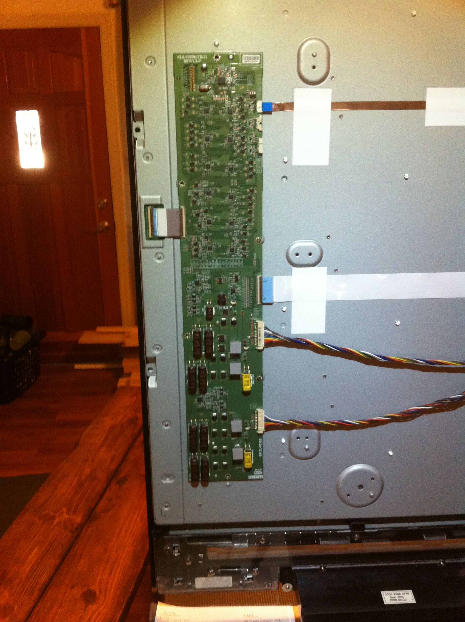

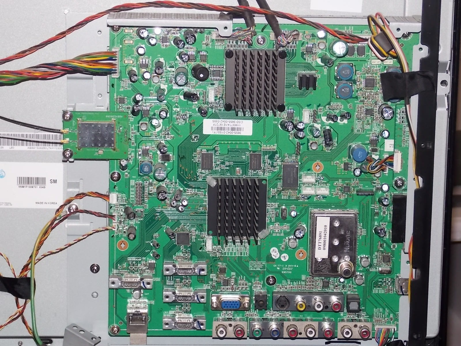

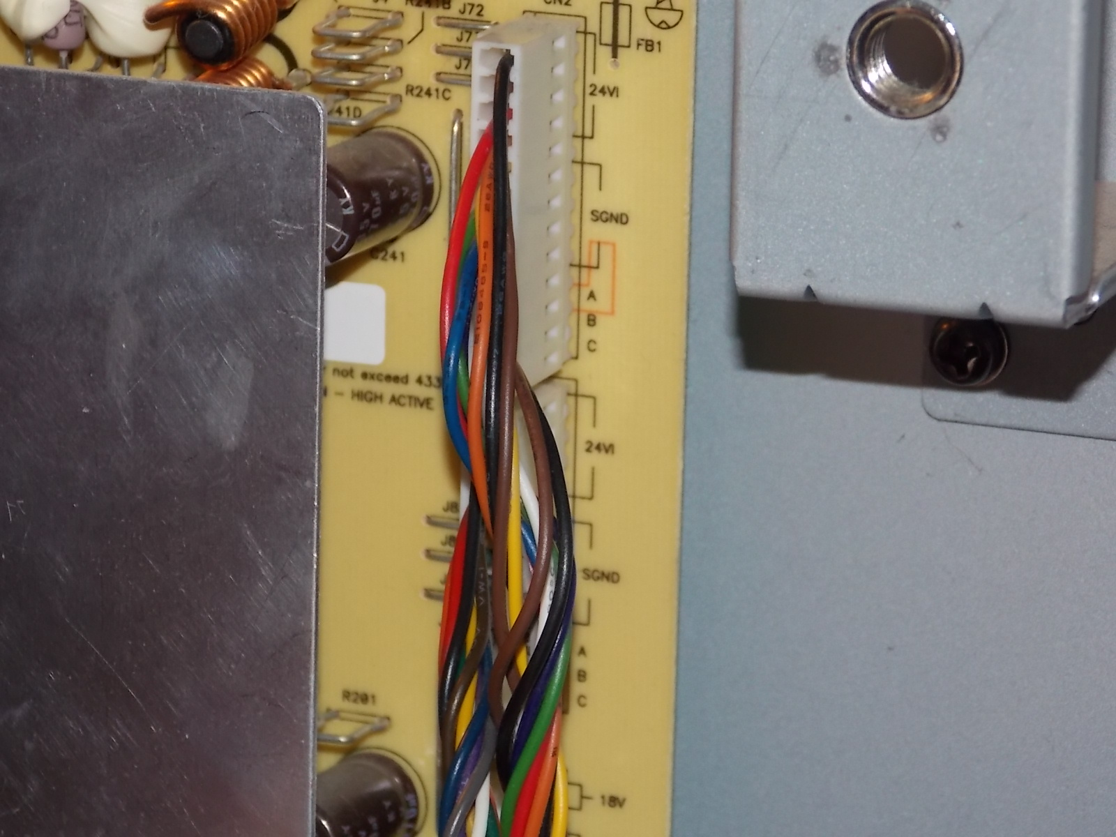

                            I hope these photos turn out better than the first. I took a photo of the back of the TV and then each individual board. My main focus right now is the Power Supply Board (dead center, yellow) and the LED Driver Board (Left side, tall, skinny).
                            The Power Supply Outputs are all on the right side of the board. The 2 topmost connectors run down and to the left and connect to the LED Driver Board on the bottom right side of the board. Top connector I believe to be the master because it has the 2 extra pins, "Ext_VBR-R" (pin A on Power Supply) & "ON/OFF" (pin B on Power Supply), while the other board I believe is the slave.
                            I've ran out of room on this post, more photos to come shortly.

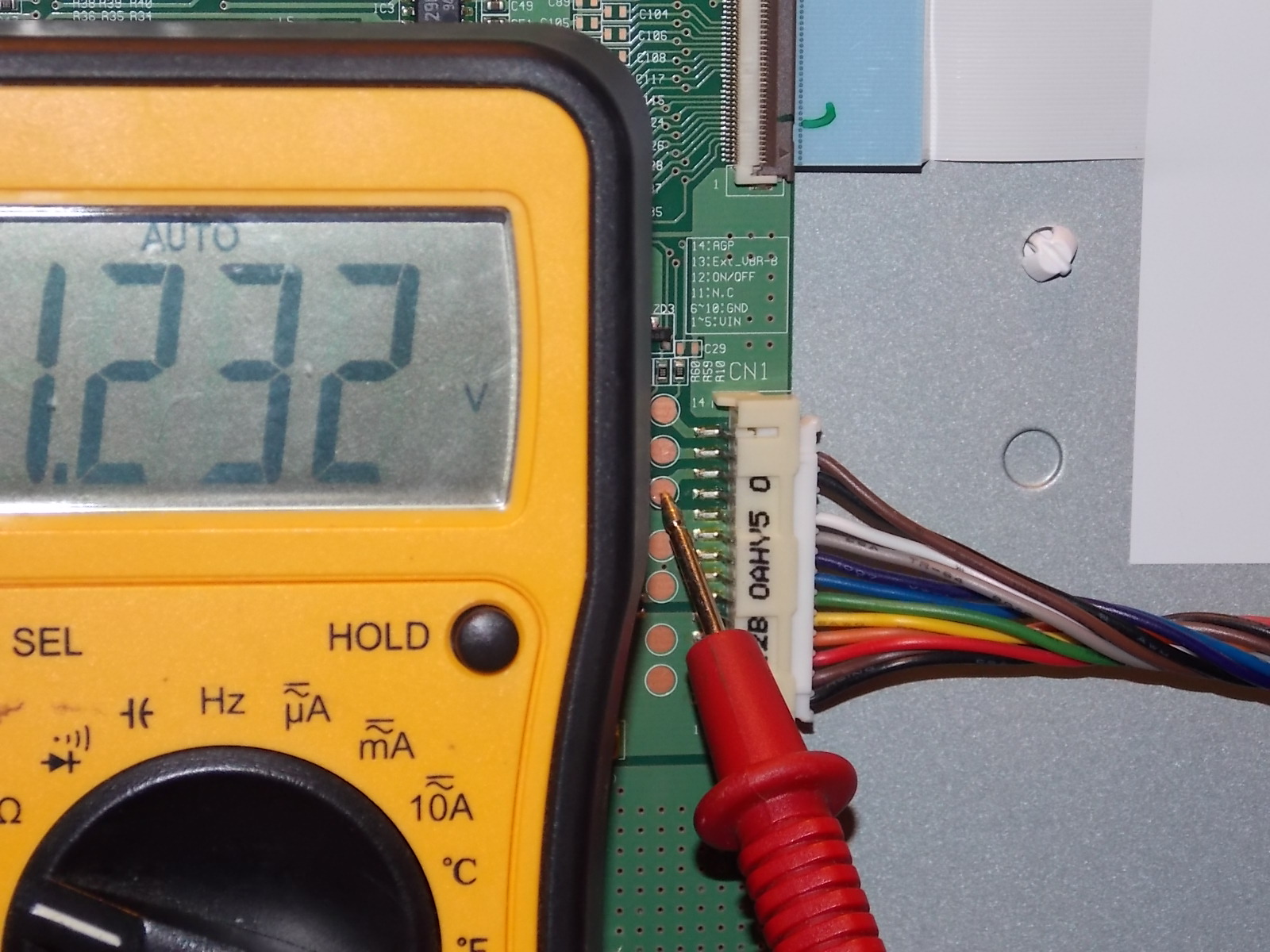

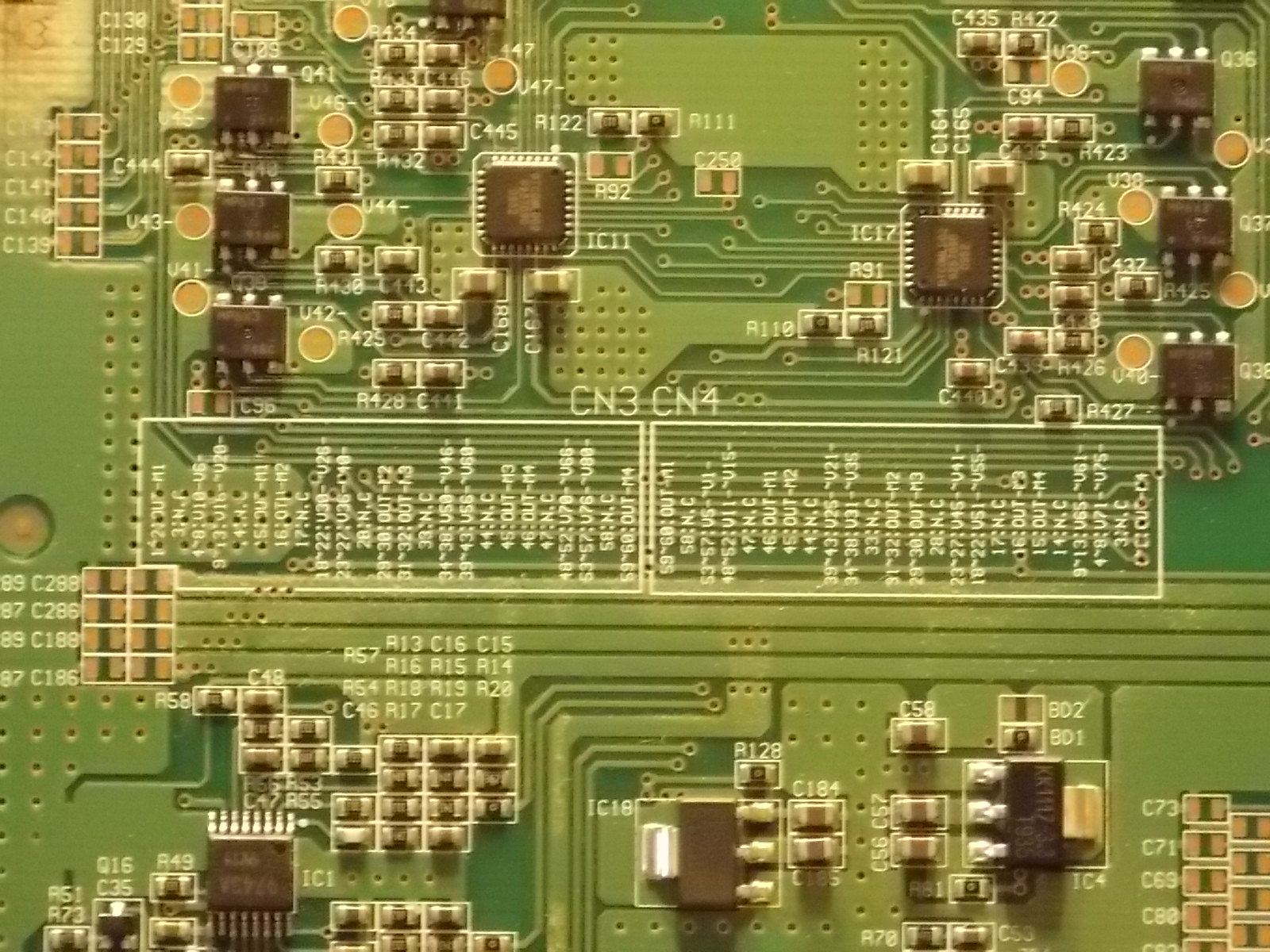

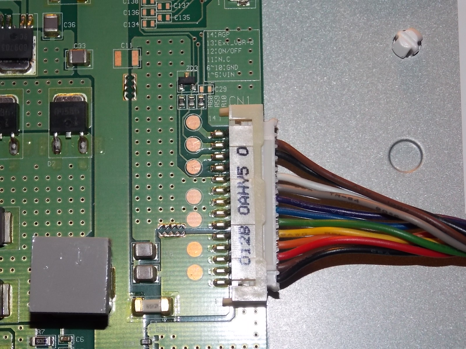

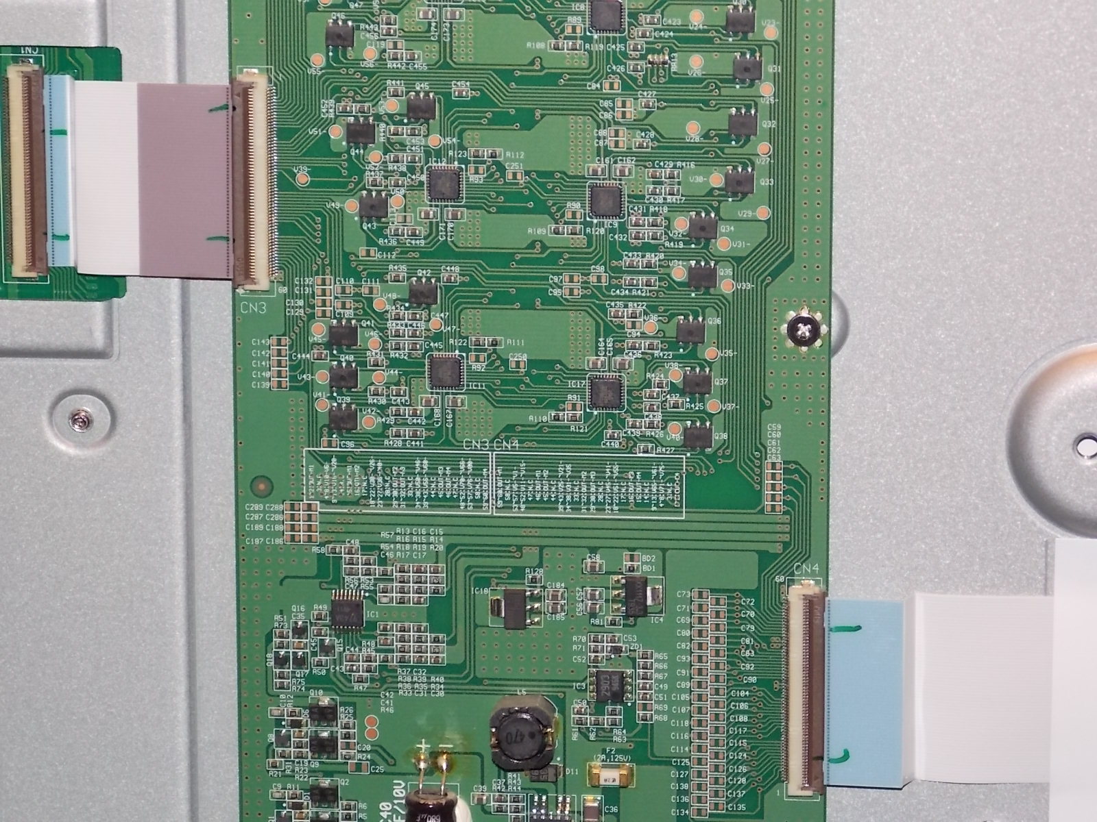

                              Just in case, I've added some closeup photos of the LED Driver board if anyone is interested. The ribbon cables in the 3rd photo are what I disconnected to remove the LEDs from the circuit. As mentioned before, same result.

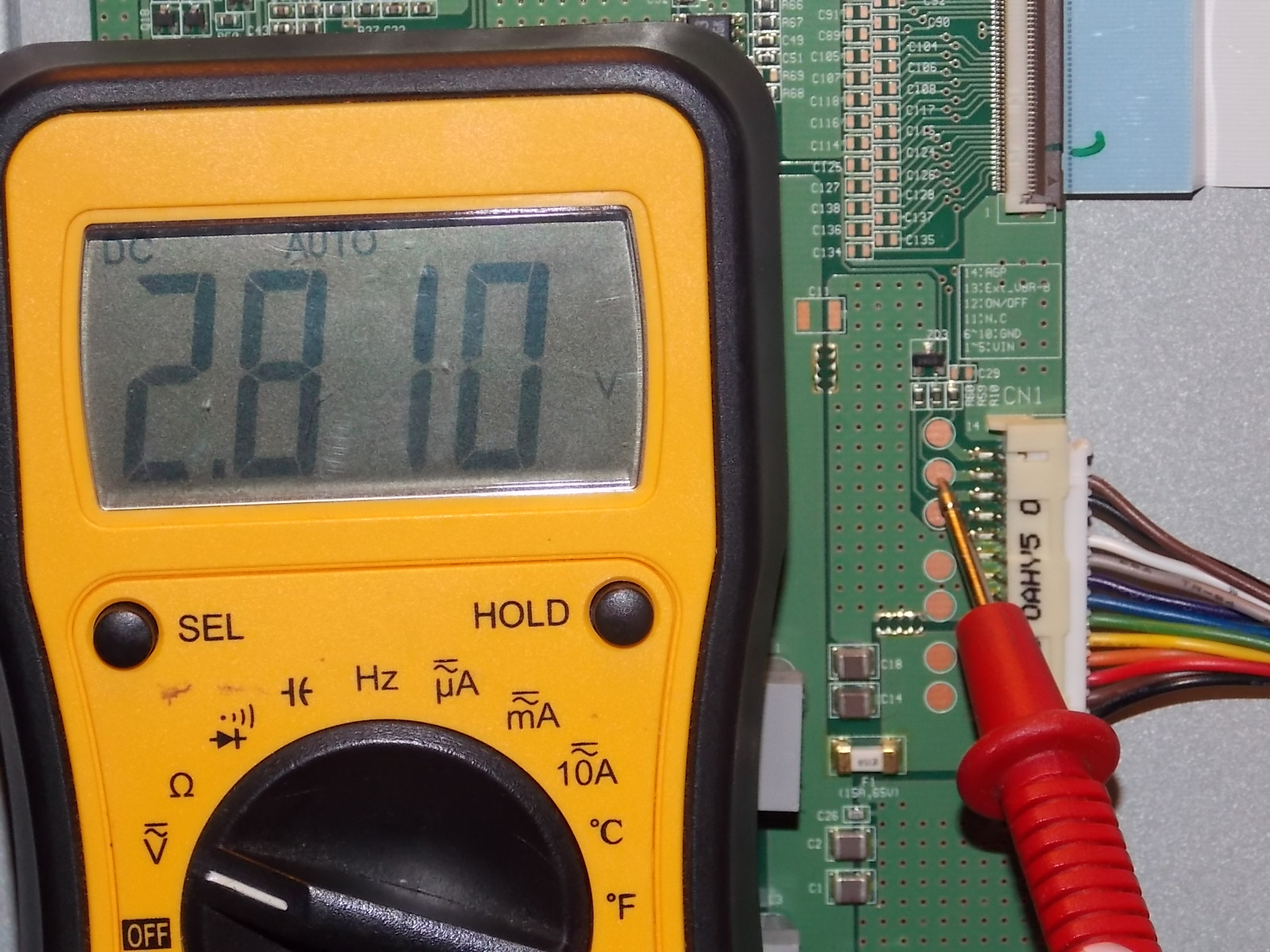

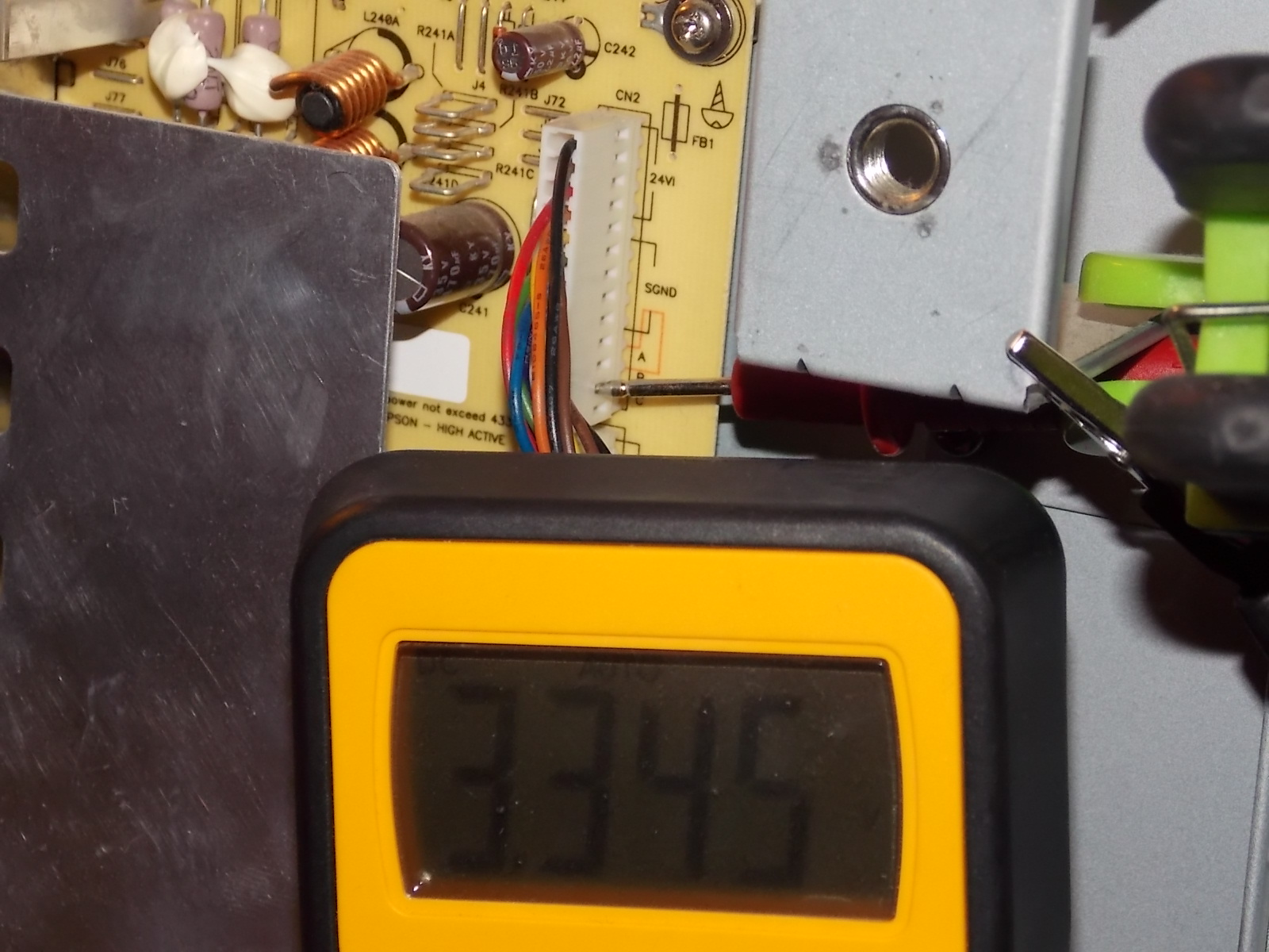

                              I did get some photos of voltage readings taken at the LED Driver board inputs (same as what the PS it outputting, but wanted to show at the LED Driver Board since the pinout was right above the connectors and easy to read). These readings are just for the pin 13 and 12 (Ext_VBR-R & ON/OFF respectively). See photos titled: LED Driver - Pin 13... & LED Driver - Pin 12....
                              Pins 1-5 have 0 volts.
                              to be continued.

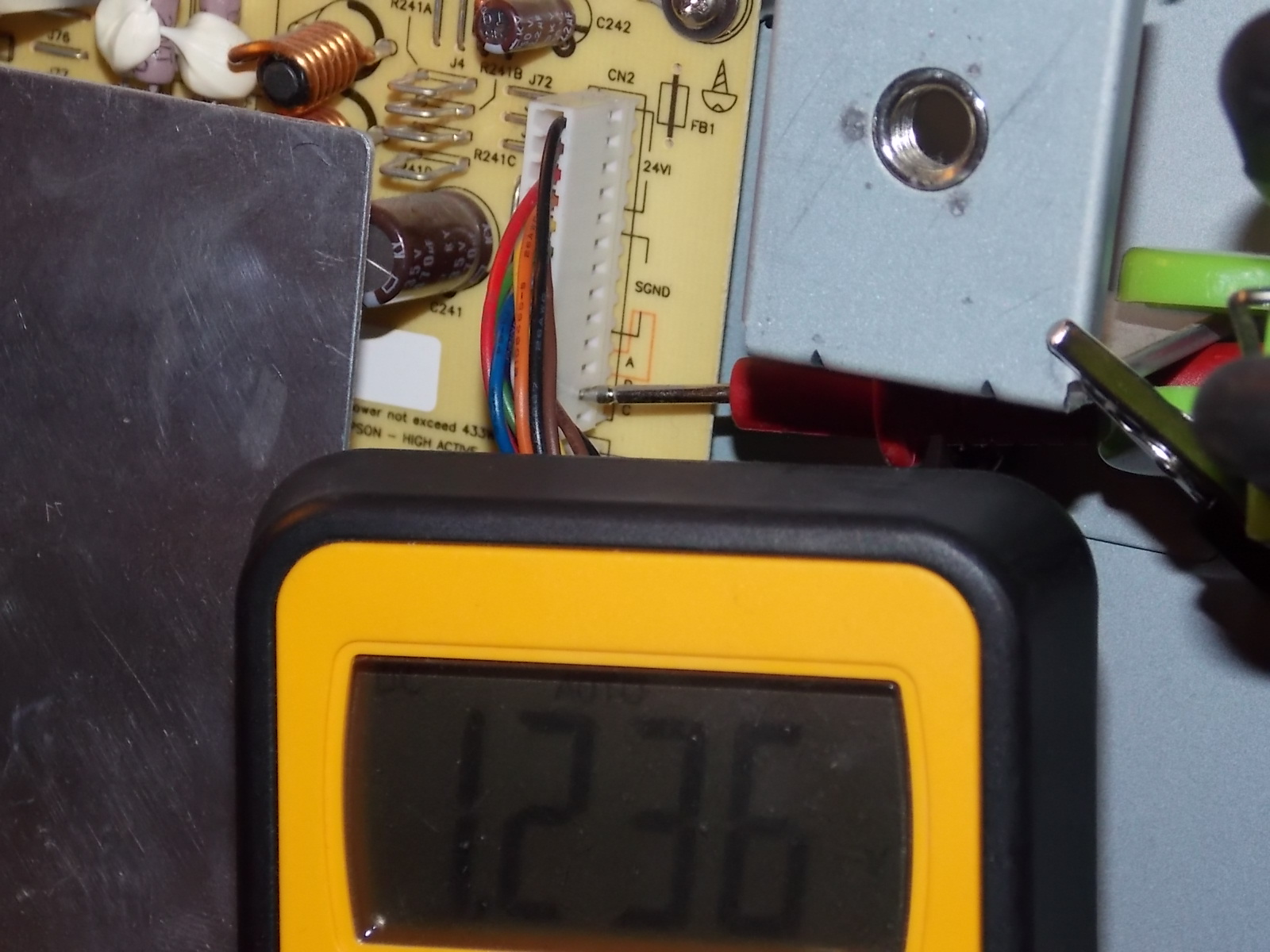

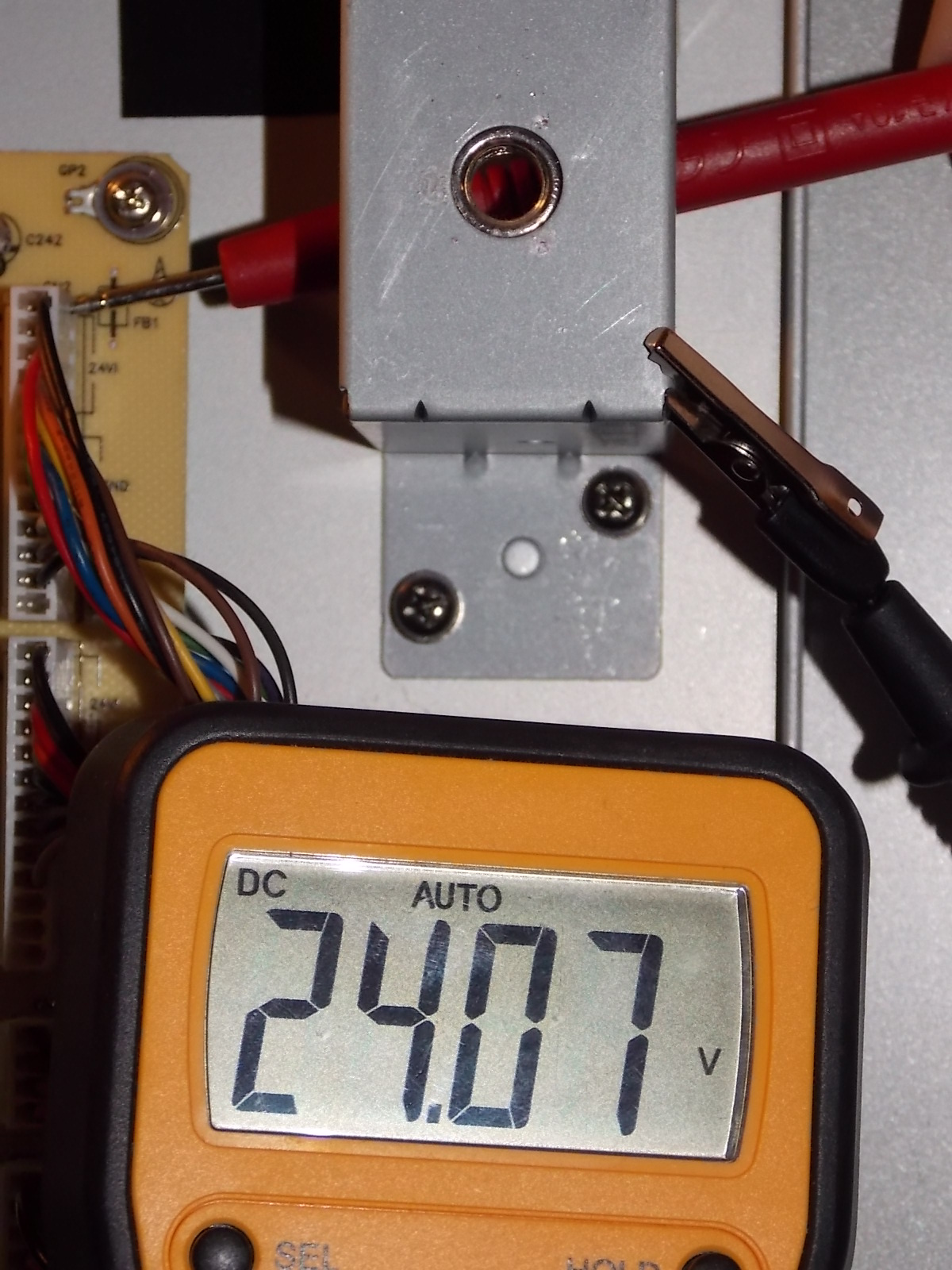

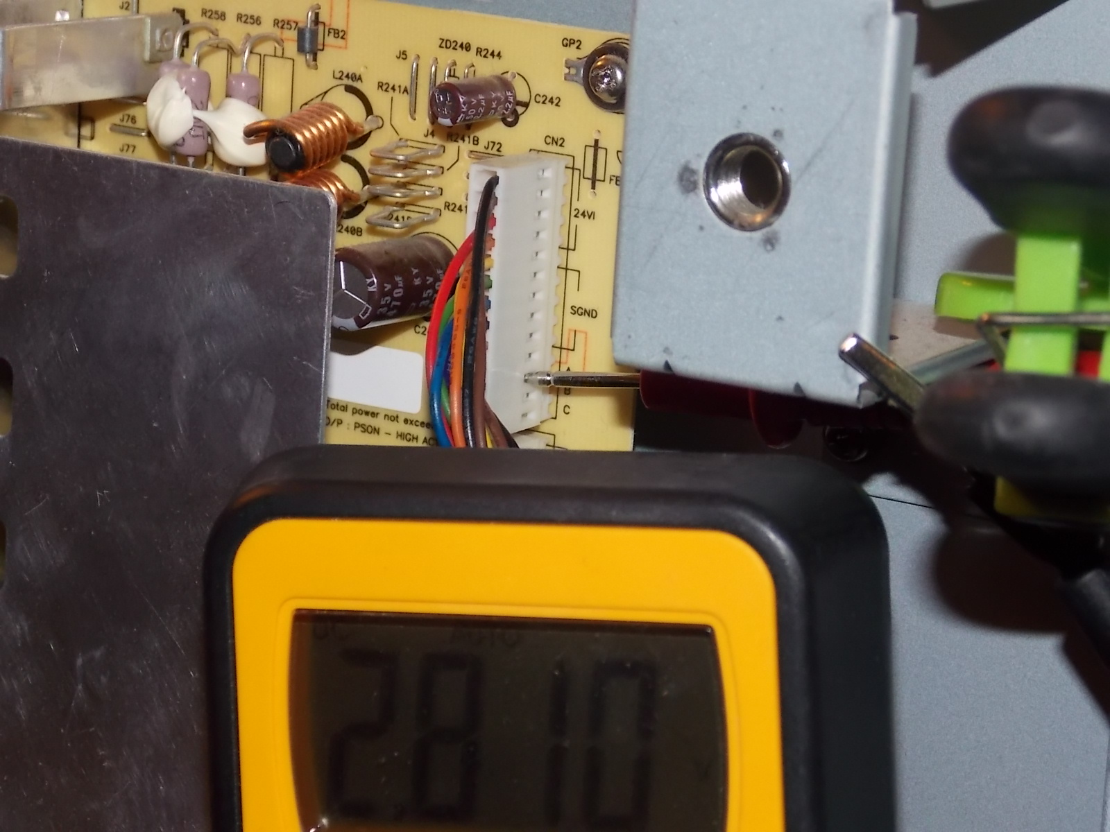

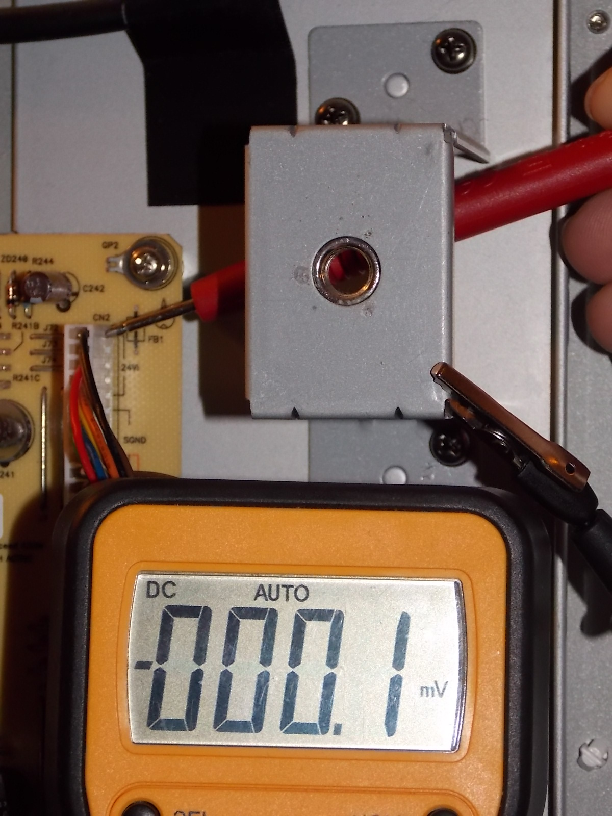

                                Here are the final photos, all taken at the Power Supply. The photos show voltage readings taken before and after disconnecting the LED Driver Board from the Power Supply...the 5V, 12V and 18V outputs on the PS were good regardless.
                                The first 3 photos were taken with everything connected (before)
                                Photo 1 - Vout=0V
                                Photo 2 - A=2.8V "Ext_VBR-R"
                                Photo 3 - B=1.2V "ON/OFF"
                                The last 2 photos were taken after disconnecting the LED Driver Board (after)
                                Photo 4 - Vout=24V
                                Photo 2 - A=2.8V "Ext_VBR-R"(remains 2.8V either way)
                                Photo 5 - B=3.3V "ON/OFF"
                                I hope these photos are clear and help clarify my issue. I've had a hard time trying to find the right words to explain what is going on lol Let me know if something is still fuzzy and I'll try my best to explain.

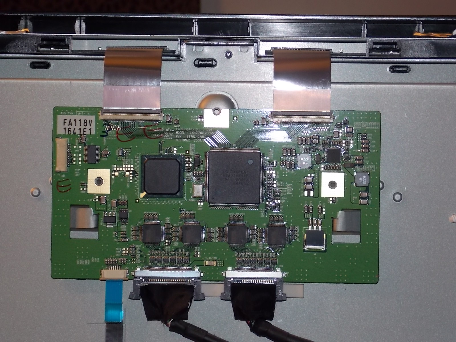

                                  The LED backlights driver is also controlled by the T-CON, there is a small flat ribbon cable from the LED driver board to the T-CON board, try disconnecting that cable and see what happen.
                                  • Vandy30
                                    • Sep 2013
                                    • 27
                                    budm, I did as you mentioned and still no luck. Essentially, I've isolated the Main, PS, and LED Driver Board (removed T-CON and LEDs) and still got the same results.
                                    The GOOD NEWS is, I started probing some of the larger transistors and diodes and may have just found that 2 out of 8 of my D442 transistors are bad. The 2 in question read a short while the other 6 read 0.70V.
                                    I did have a question with regards to testing diodes though. Do most diodes read between 0.3-0.8V? This was stated in a youtube video on how to test diodes. I was testing some Schottky (? spelling) diodes and kept reading around 0.128v on all of them. Is that feasible? It has me concerned that either I was reading them wrong or they are all bad.
