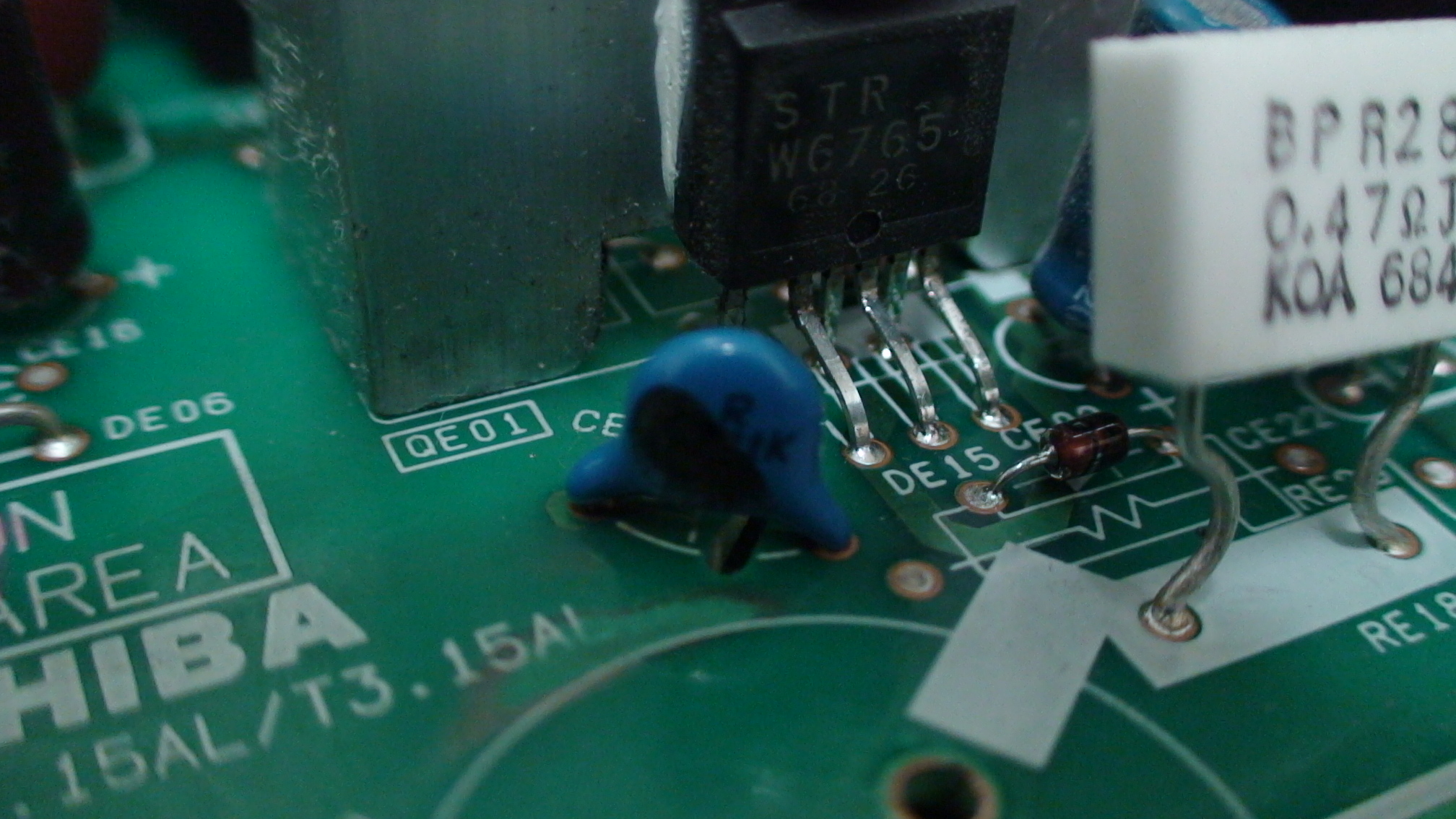

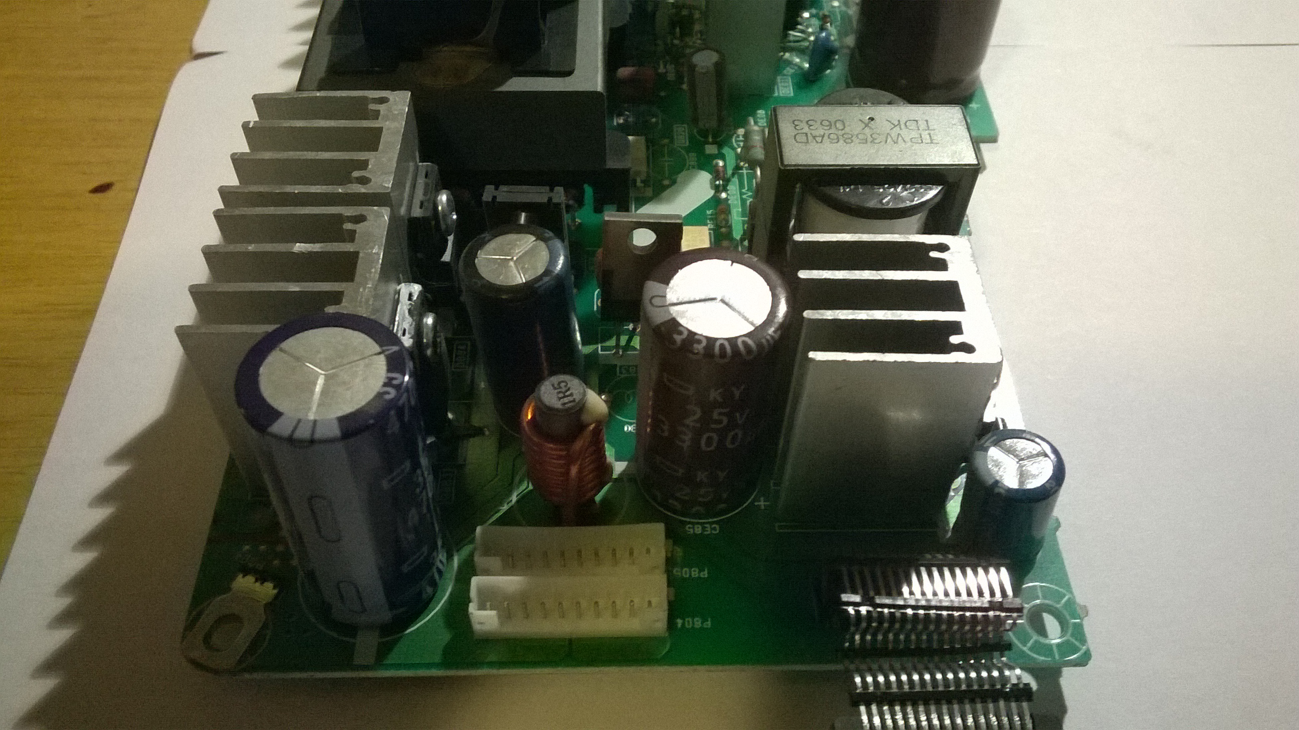

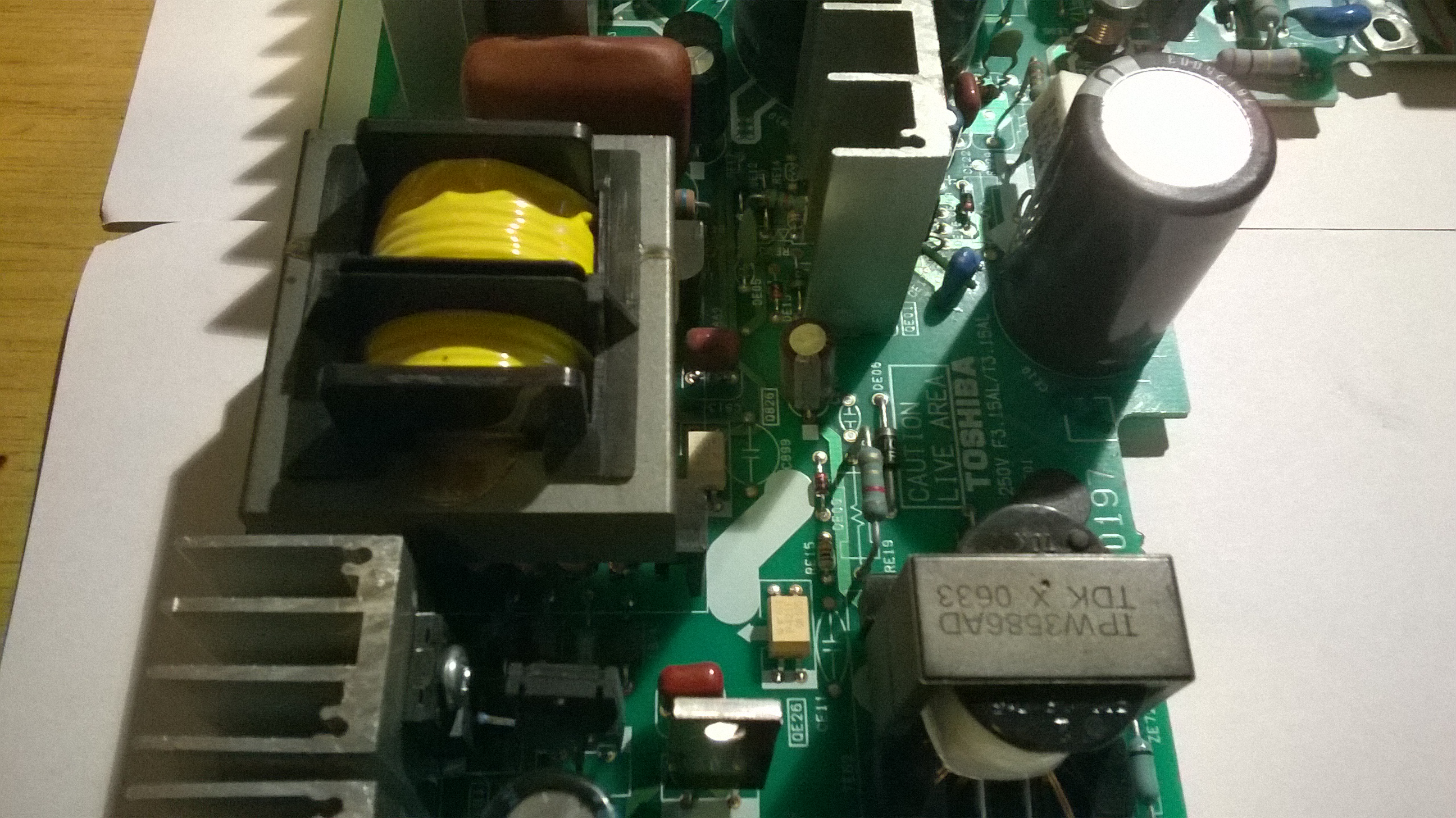

    Has anyone on here had any experience with the toshiba Regza 32WLT68 lcd tv at all ? I have just aquired one that there is no power at all getting to the tv the led's aren't showing and there's no activity at all. The person who i got it off said it was working fine one day and she went to switch it on and there was nothing at all. I've read about the standby fault and replacing the IC420 on the signal board but i'm suspecting that isn't the problem and was wondering if anyone else has had any problems with bad caps on the power supply board or elsewhere and could point me in the right direction with it. Ive sourced a power supply board online and i'm currently waiting for delivery.

        Good clear pictures of the board?

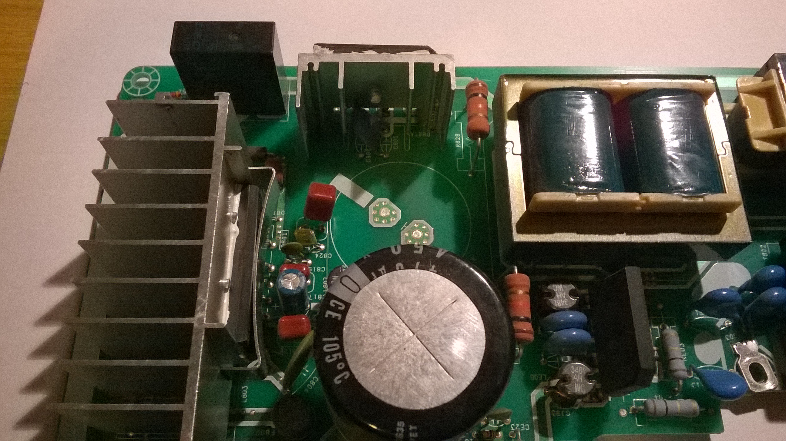

          Re: Toshiba Regza 32WLT68 lcd tv
          this is the power supply board.

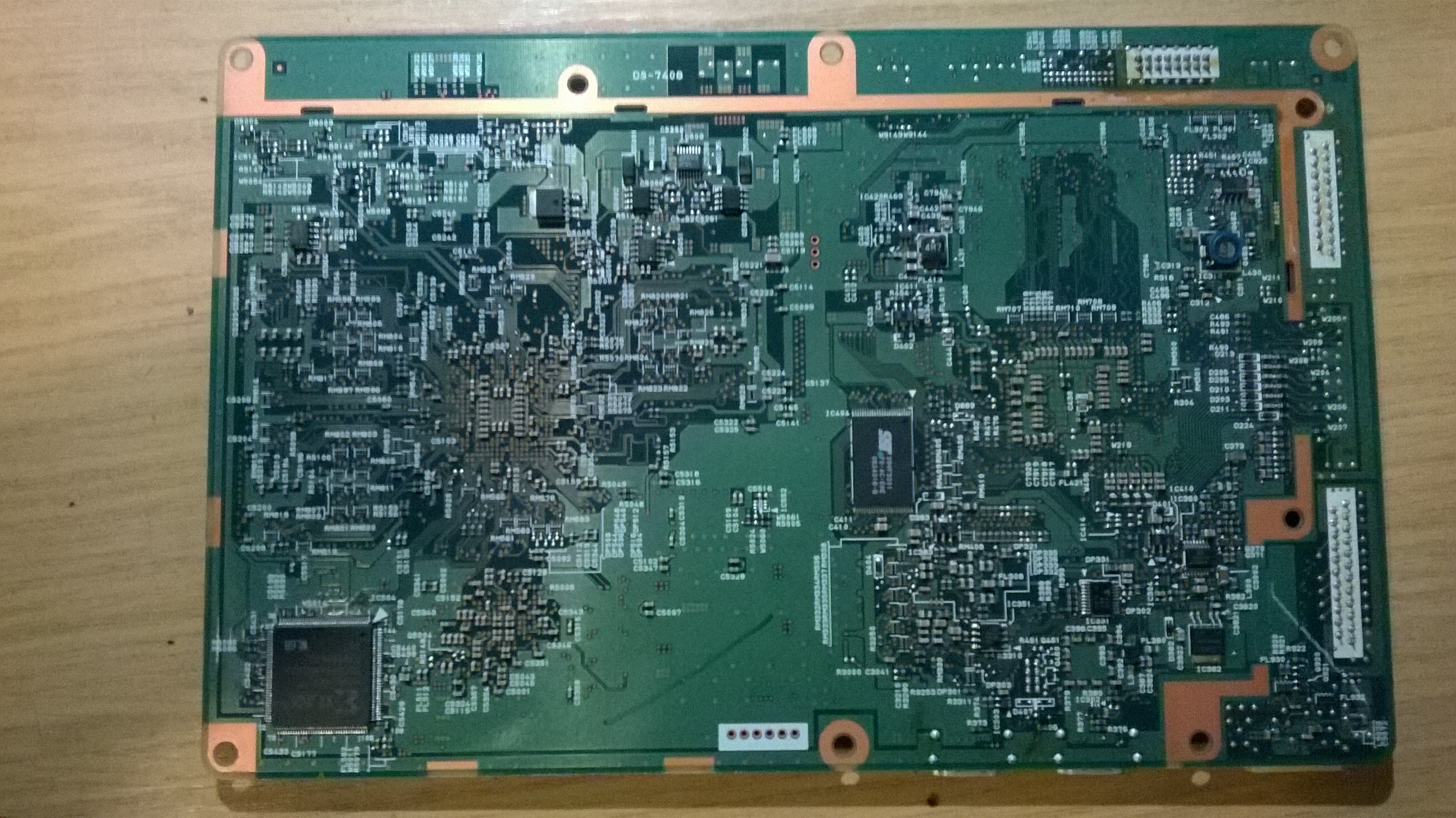

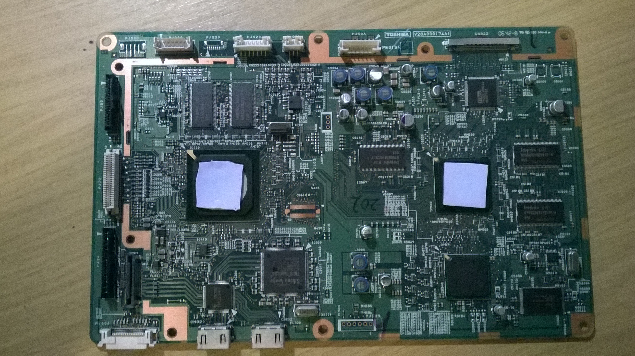

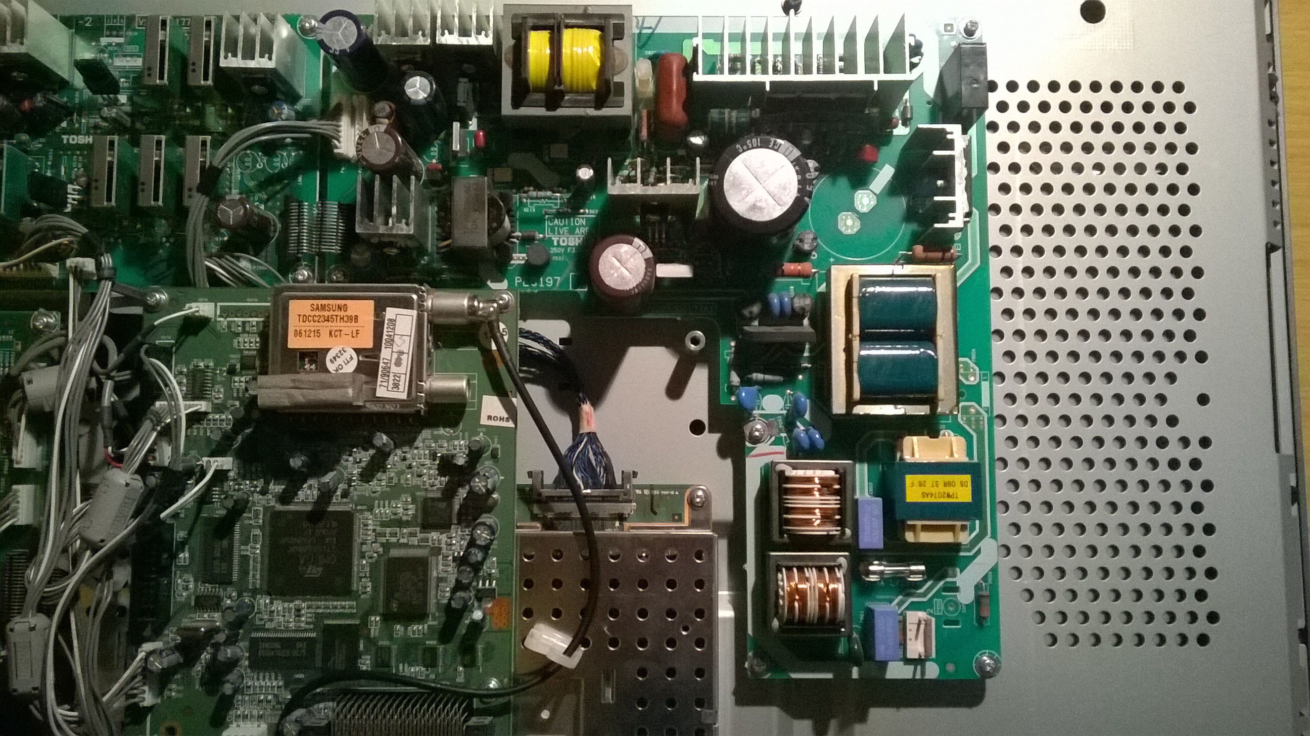

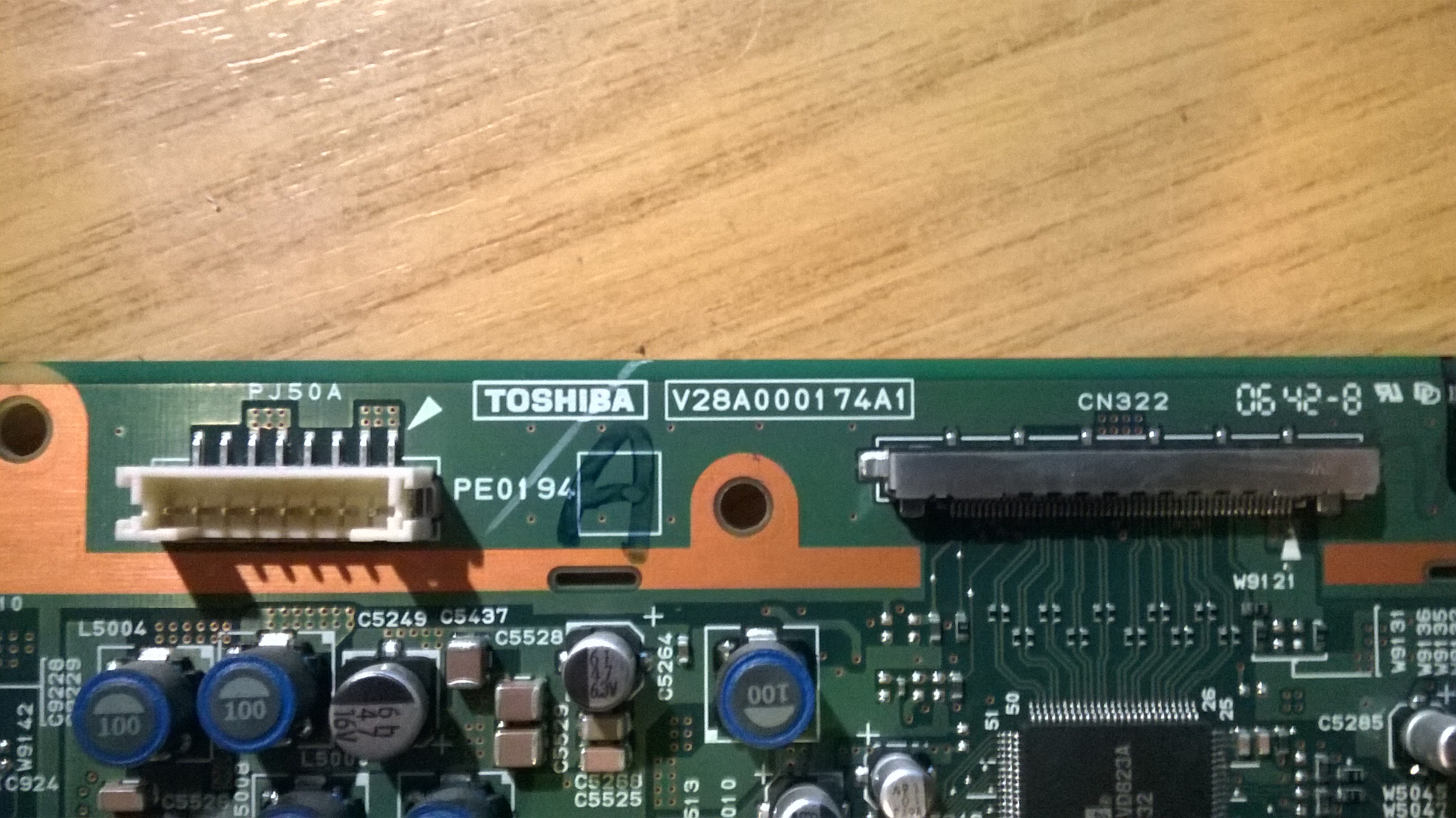

            this is the signal (Mainboard) which according to post viewed on google is the board that contains the IC420 that's prone to cause standby fault.

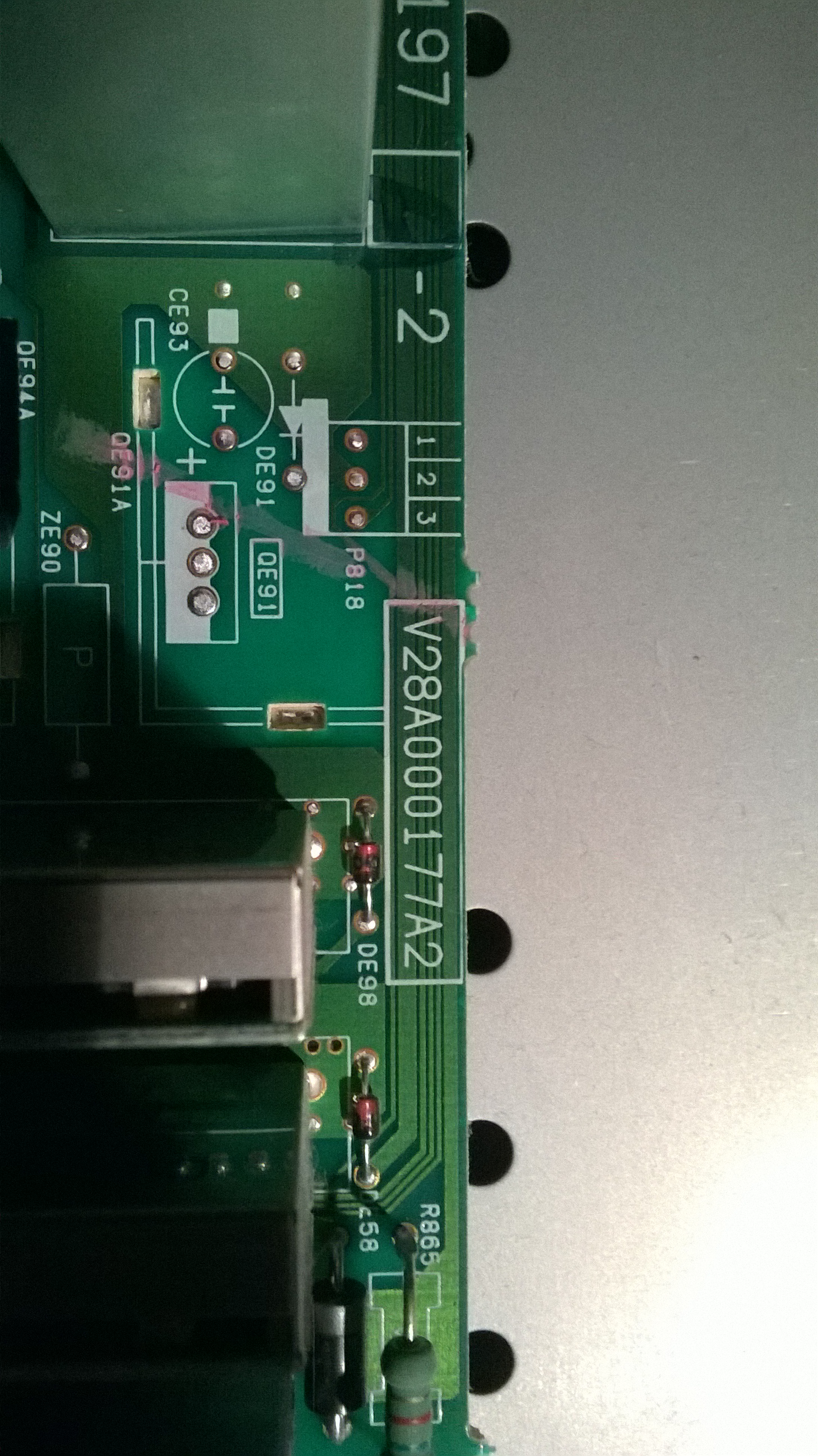

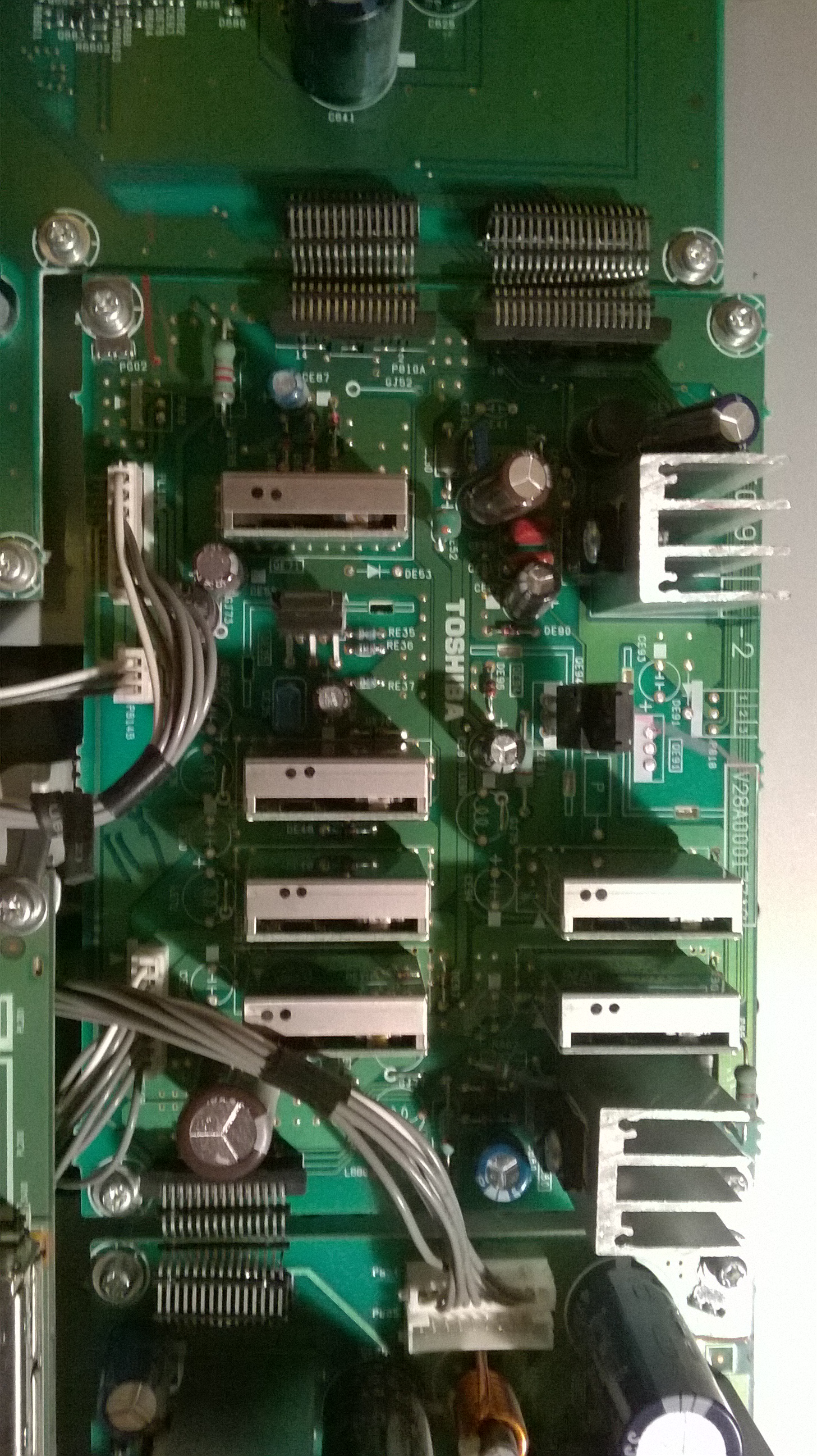

              This is a secondary board to the power supply board

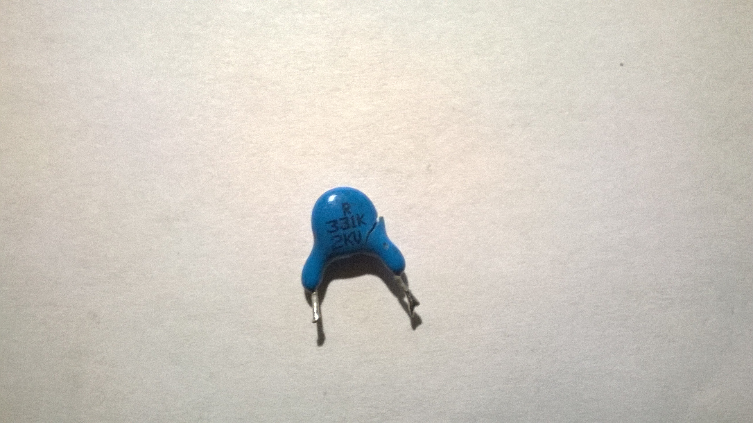

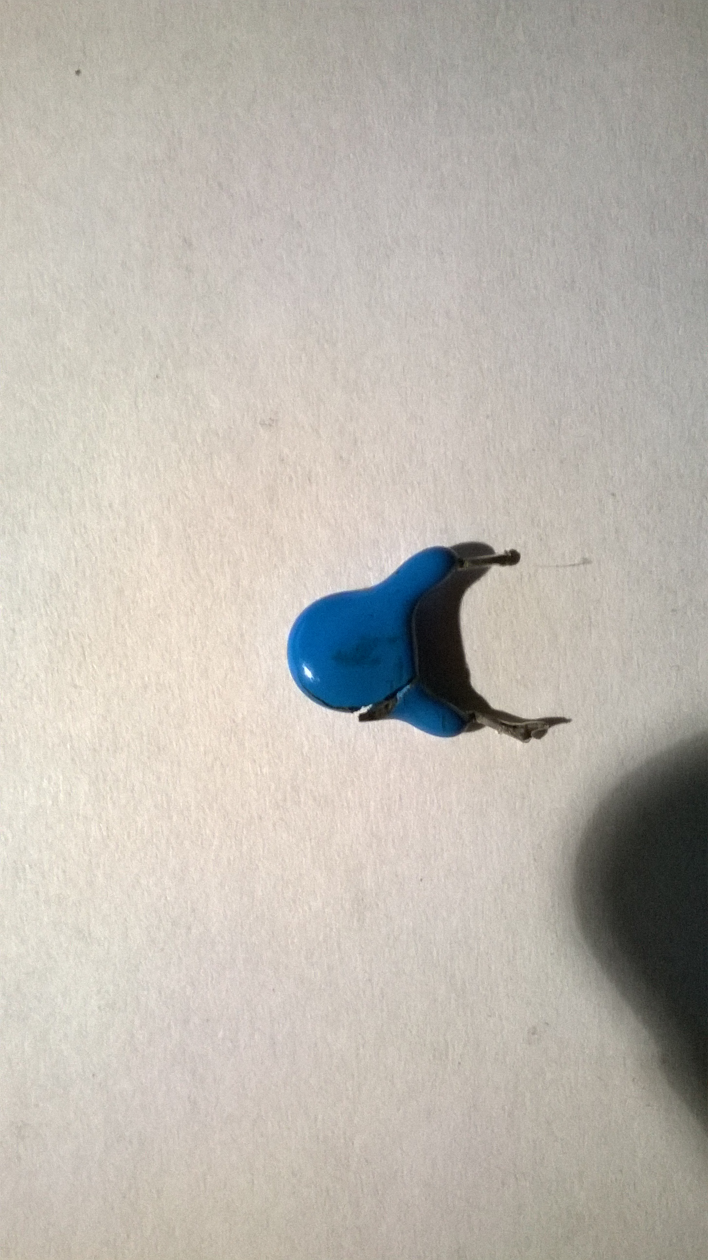

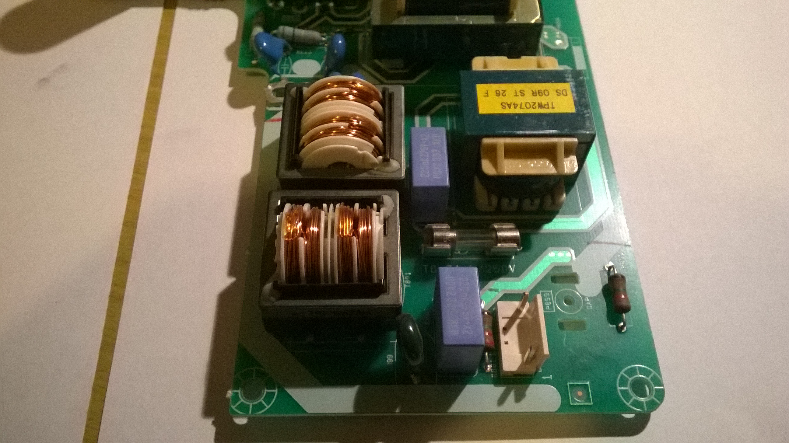

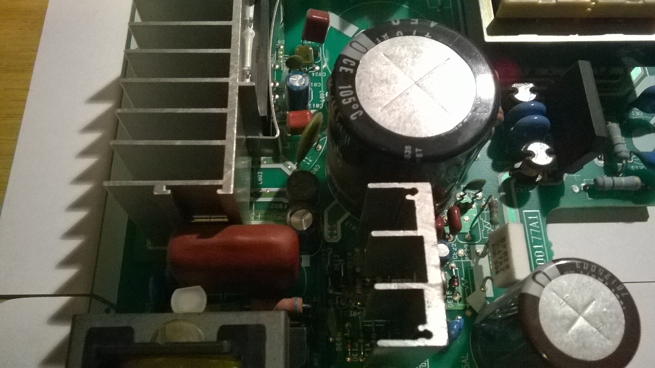

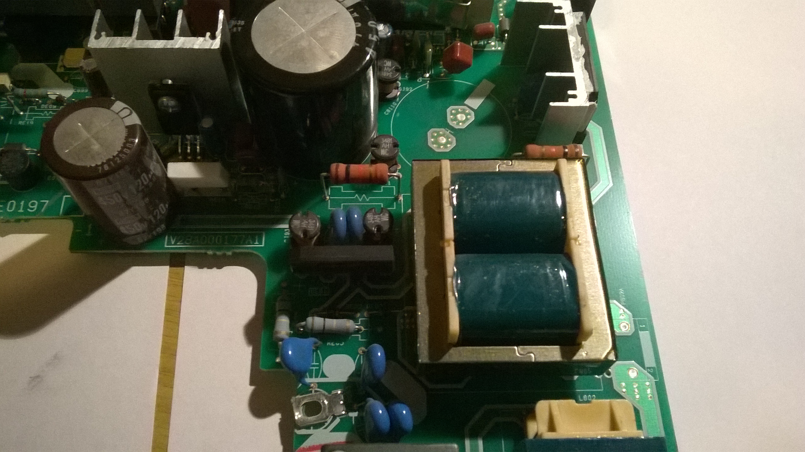

                    yeah there's no activity at all none of the front panel led's are lit when plugged into the mains i've ordered a power supply board which should be here on wednesday/thursday so we'll see if it's that and if not back to the drawing board. I've had a look around the all the boards and i can't see any bulging oe leaing caps anywhere apart from one that was cracked which i've replaced and it still won't power up. The cap i replaced was a R331k 2kv which is shown in the attached photos this was the only one i could find that was damaged.
                      Pictures of the main board are not sharp enough - what voltage do you get at the big cap
                      (CARE high voltage 400v) If you are lucky you may be able to test this on the pads where
                      the second BIG cap is not fitted. If no voltage there then you need to look at the Bridge Rectifier.
                        That is the snubber cap for that STR SMPS IC.

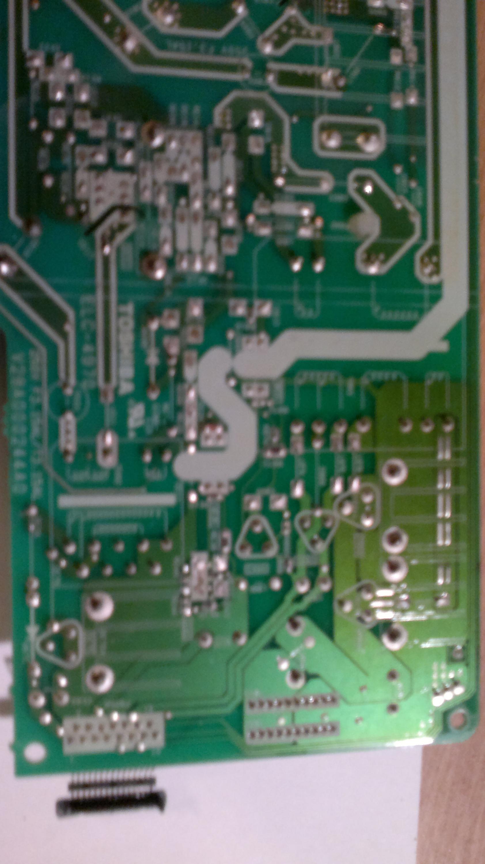

                        We will need much much better pictures of the whole back side of the TV, the whole top and bottom side of the power supply board.
                        More likely that the fusible resistor for feeding the B+ to the SMPS IC is blown.

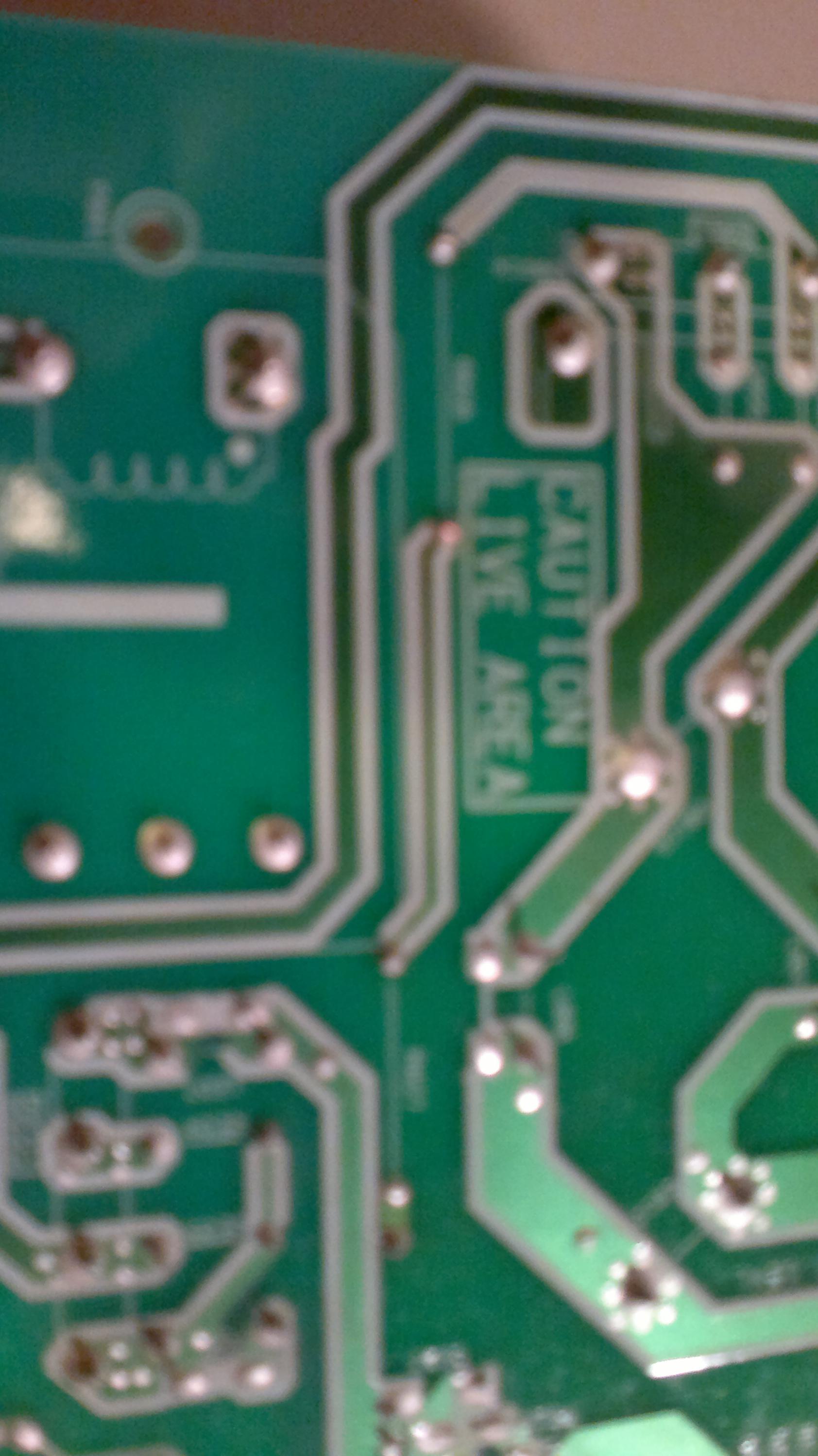

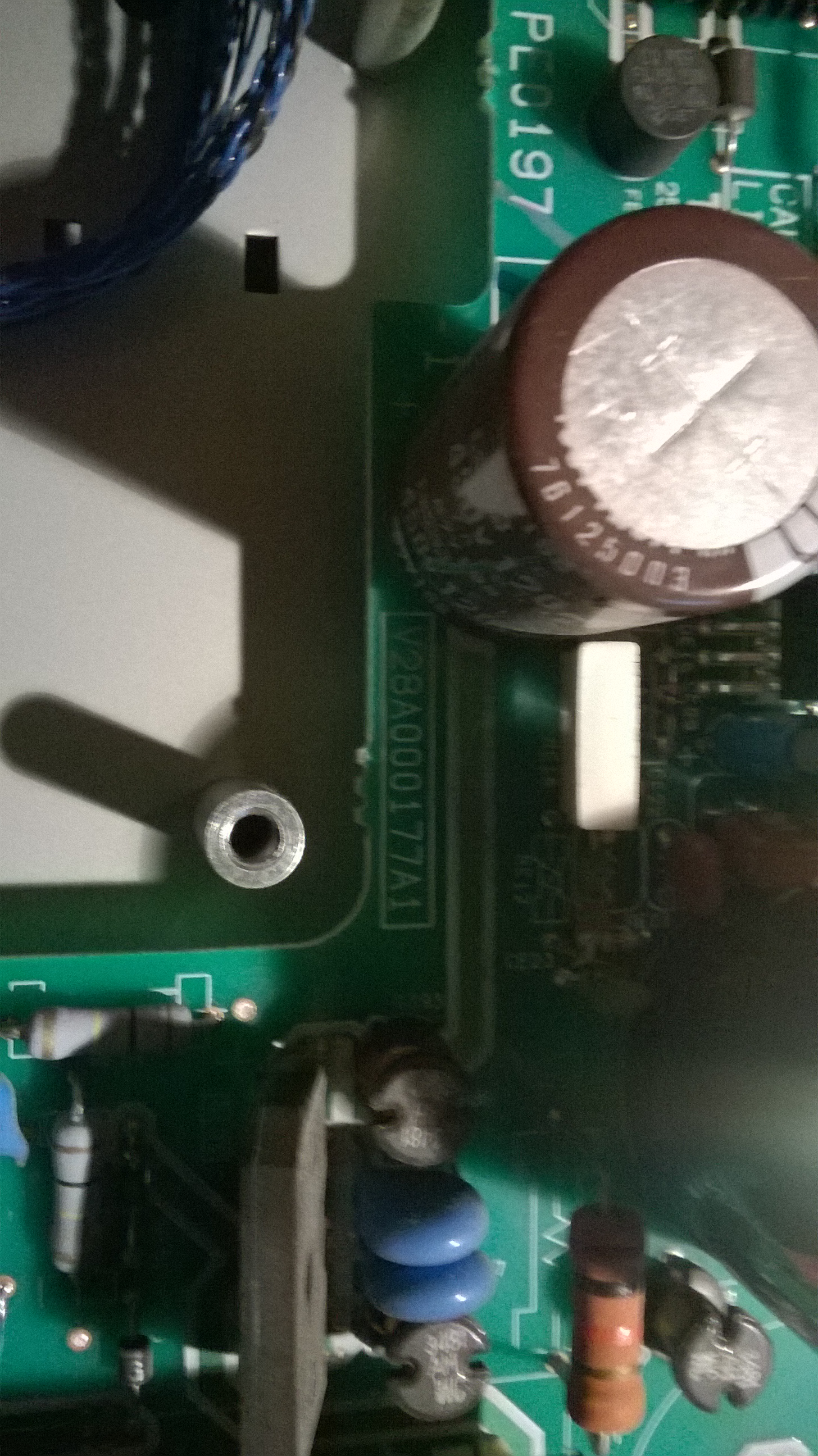

                            here are the pics of the power supply board budm. And tom66 do you mean the ic420 that causes the standby fault ?

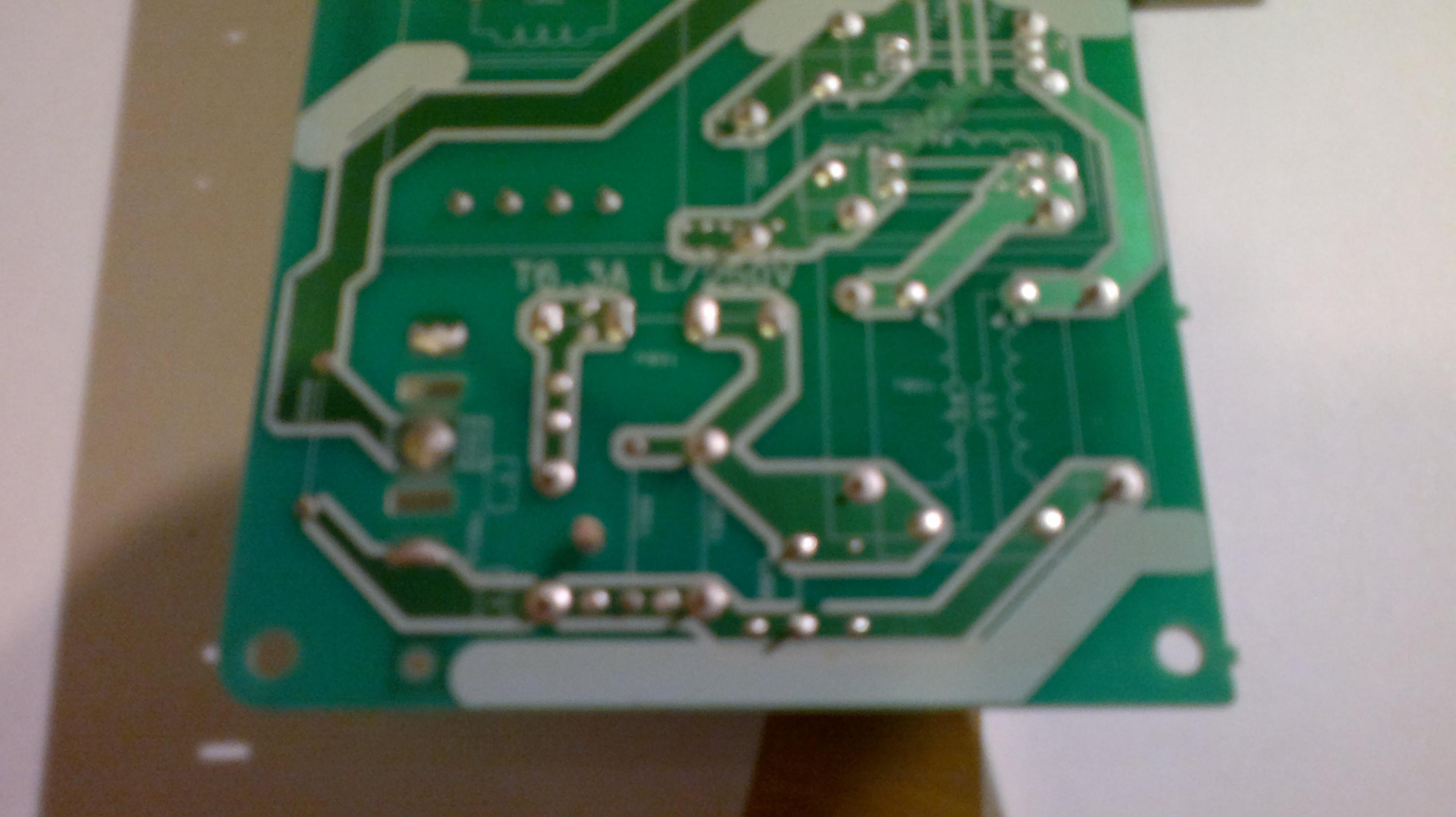

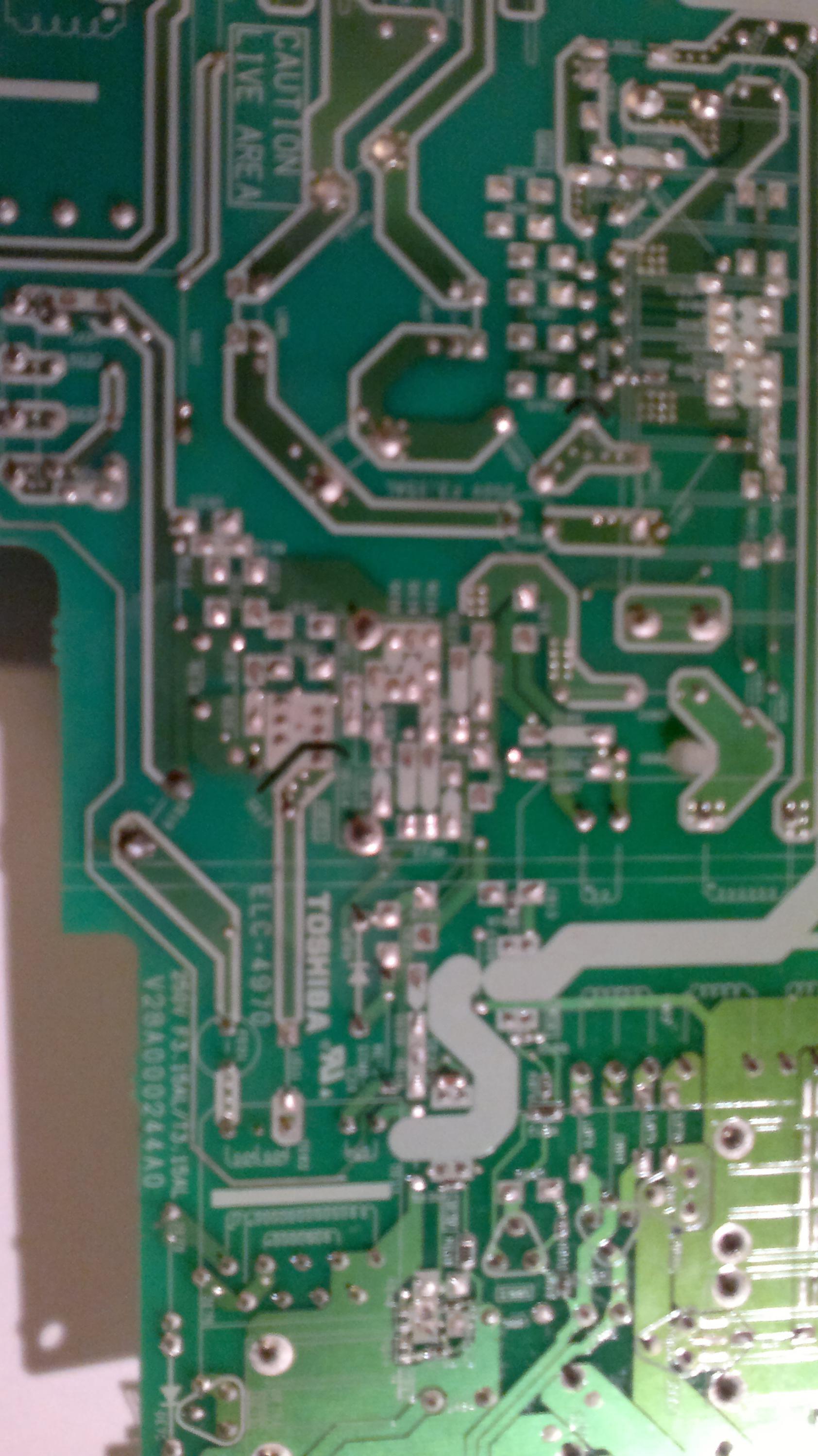

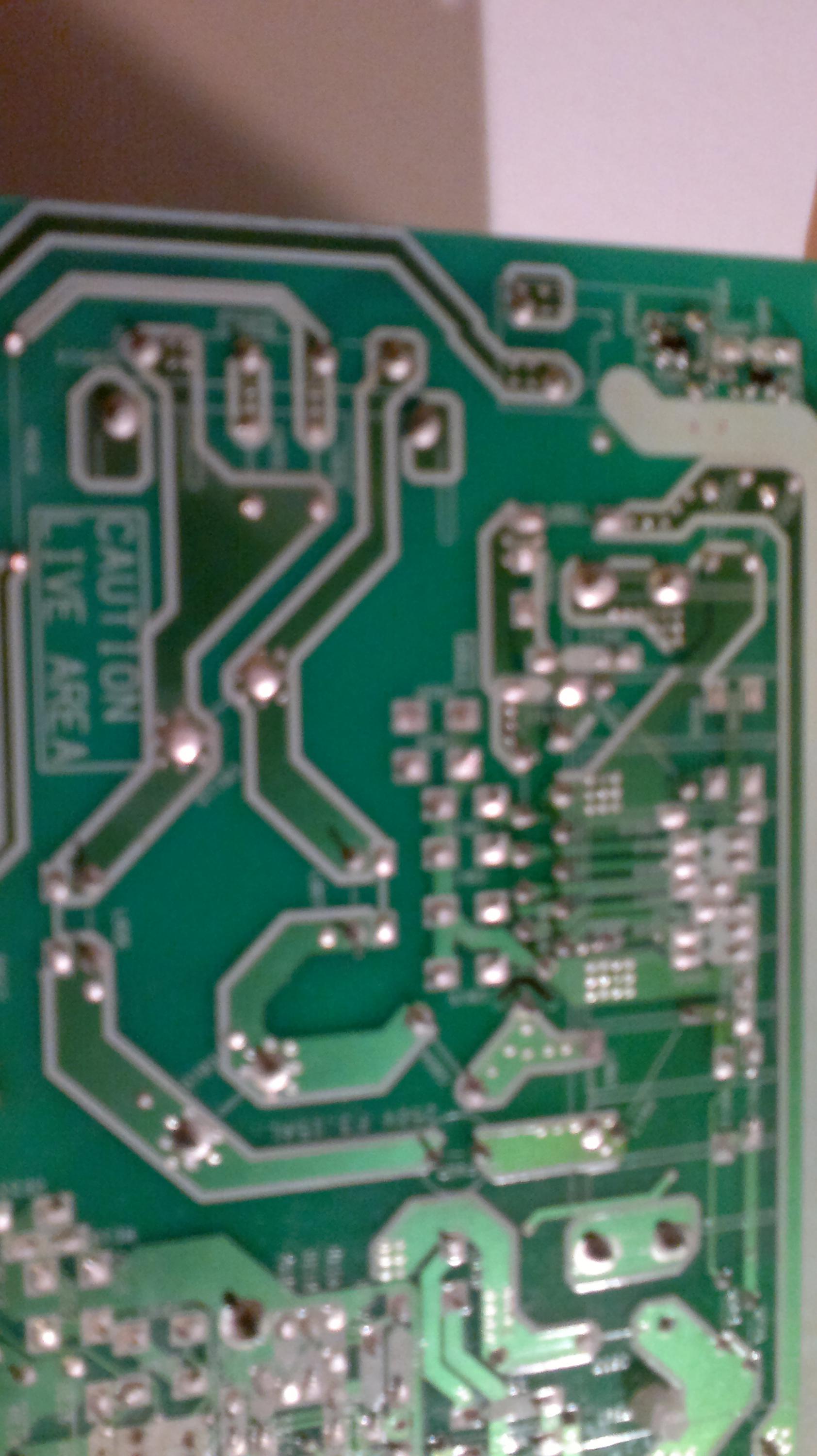

                                Here's the back side of the board

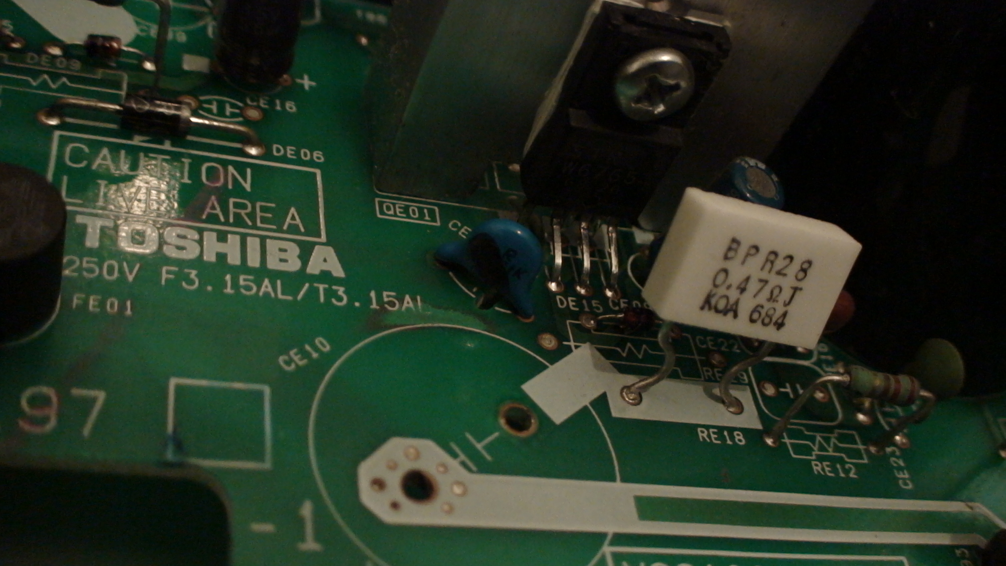

                                        I need the pictures of the whole board so I can see the board lay out to figure out the function of each section of the power supply.
                                        https://www.badcaps.net/forum/attach...6&d=1421010025
                                        I see black round fuse (the label next to it shows 250V F3.15A/T3.15A) in the standby power supply section.
                                        Good clear pictures are important to me to figure what is going on, I do not have the board in front of me to look, without good pictures as I requested it will do me no good to help.
                                        My post 12:
                                        "We will need much much better pictures of the whole back side of the TV, the whole top and bottom side of the power supply board."
                                        There are MANY boards in this TV.
