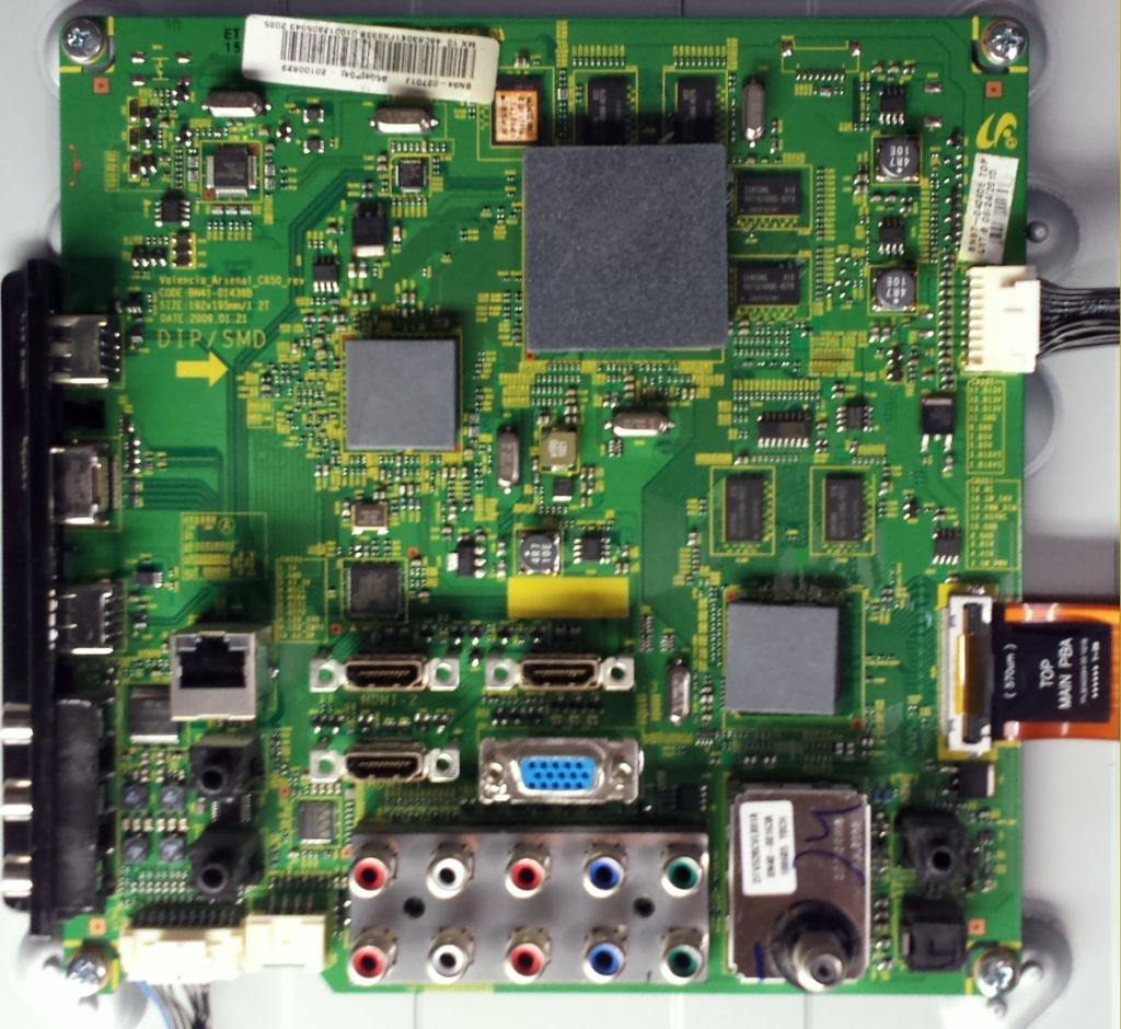

        Pictures of the boards ? Have u tried gently pressing on the processor with the end of a insulated screwdriver could be a bad panel though ?
          Re: Samsung LN46C630 Thin Vertical Lines on entire screen
          Attached Board Photos
            Pressing and tapping on main board did make a change Lines, some times they disappeared and came back, they are not there now, but if I tap again its back

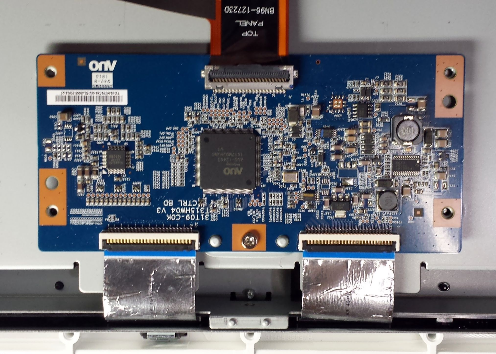

                        By accessing the service menu you can activate separate main board and T-con board test patterns. Put the TV in standby, then on the remote press in succession Mute, 1, 8, 2 followed by Power. When the TV powers on the service menu should appear.

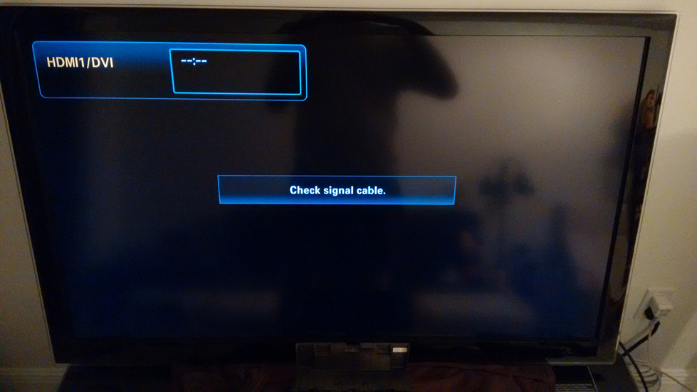

                                    Ouch! I have same exact problem. I will try to upload a pic or maybe make a video soon.
                                    I already disconnected a cable between PS and Main, then turned TV and I saw a backlight which was steady (no flickering). Then I connected that cable, but disconnected a cable between Main and T-Con. Same thing - backlight was steady.
                                    I will now connect that cable back and will turn TV on and I want to load test picture. then I'm going to make photos and possibly a video.

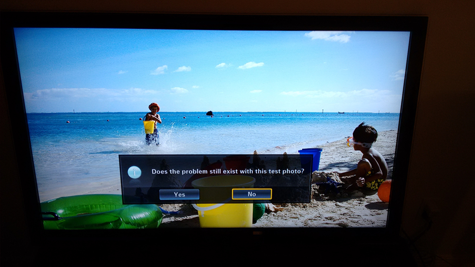

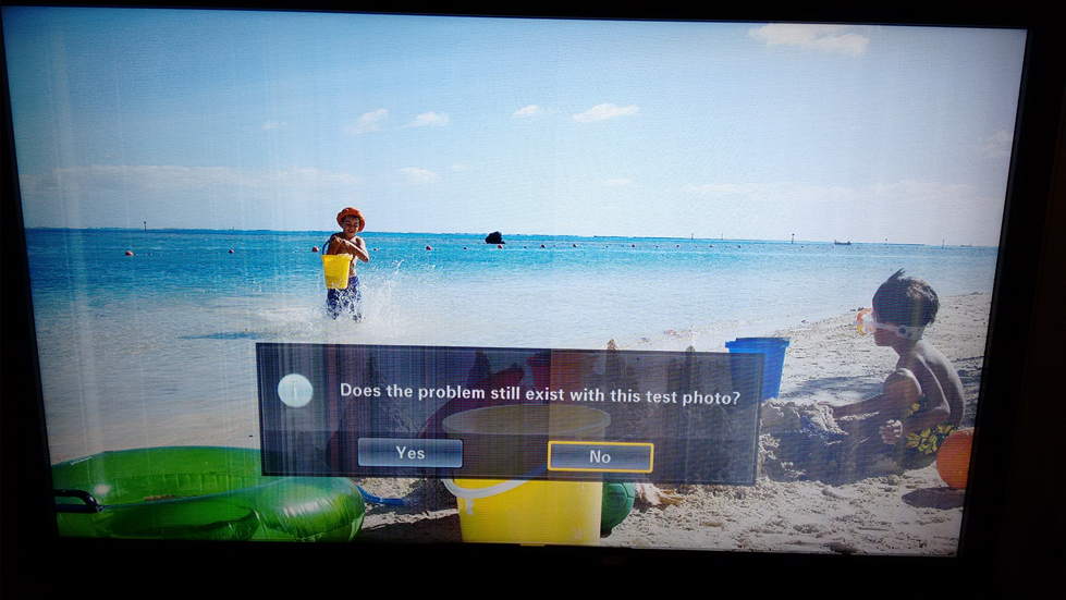

                                      Here are some pics showing the the problem with my LN46C630.
                                      When I turn on TV everything is OK for a several minutes. Then after it warms up first I see some flickering then I see vertical lines.
                                      Also when a test picture turns off you can see that "no signal" message doesn't properly moves on the screen. There is a lag.
                                      2 pics show how everything looks like BEFORE my TV warms up and another 2 pics show the problem AFTER it warms up.
                                        That looks like tab bonding issue.
                                        What happen if you try flexing the panel?
