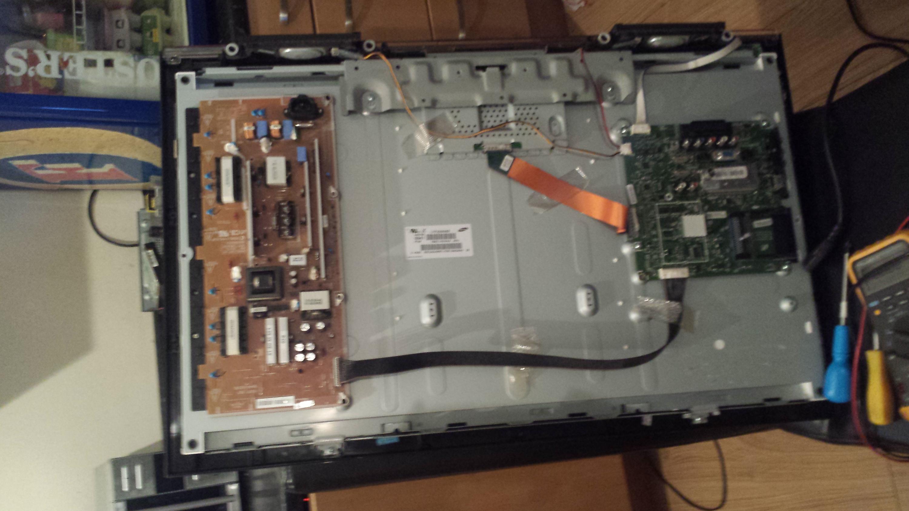

    Hi all, I have here a 32 inch samsung tv which is showing no red standby led when power cord is connected, I tested the connector which supplies power to the main board and getting no voltage on any pin, both fuses on power board tested ok, i am geting 233.2 ACV at the first fuse and 130 ACV at the second fuse, I have tested all mosfets and diodes using atlas dca55, all caps on cold side of the board are also good. Only problem i can see is a small crack on the power board near one of the transformers but it does not pass through any traces, Not sure what else to test now.... Any help would be great. Thanks in advance.

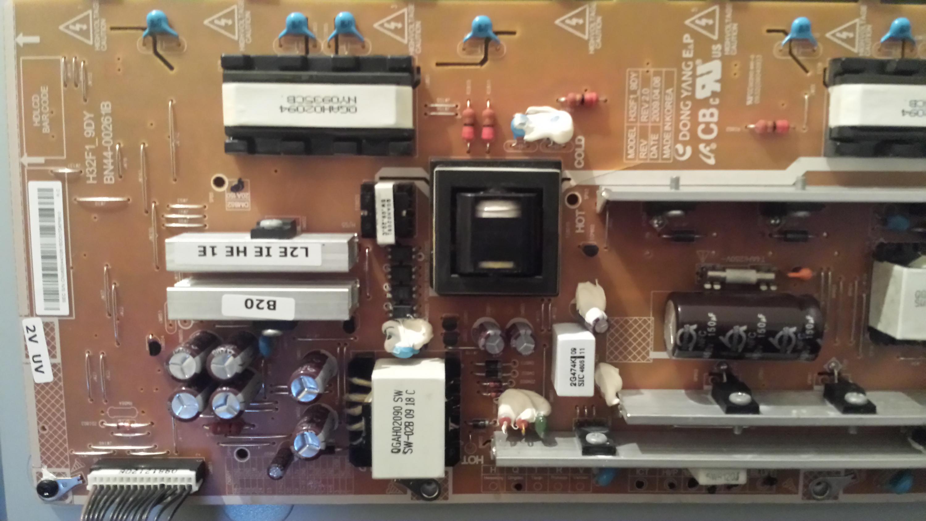

                                Please provide good clear pictures of the whole bottom side of this power supply board.

                                    Re: Samsung LE32B530P7WXXU No Power
                                    Hope this helps,
                                      Its not really clear enough - can you retake it - get it near a window for more natural light
                                      and no flash.(adjust the camera for low light?) If you cant do the full board better try for the top right across to where is says "COLD" that will give us the connector and the labelling.

                                        try unplugging the cable from the power supply to the main board, see if the backlights come on, not sure if you described weather they come on or not.
