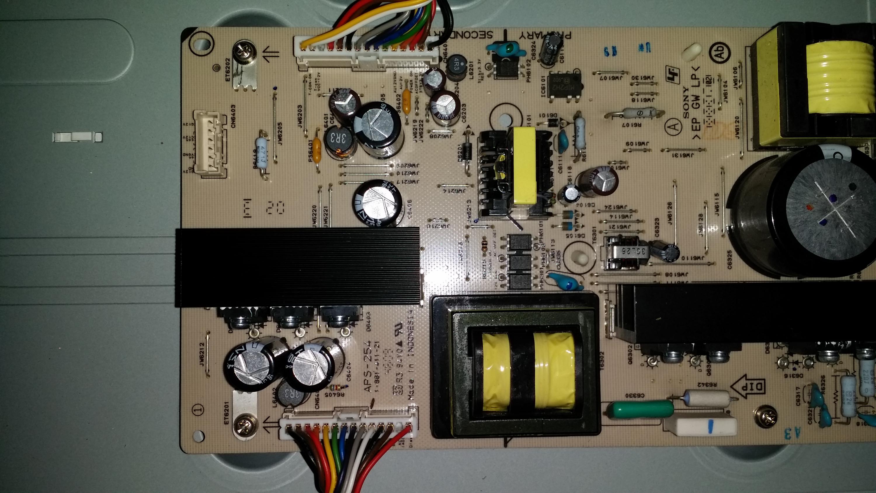

      I would like to try and repair the power supply. They are asking to much everywhere i see it for sale.
        Re: Sony 40EX400 Dead No Power....
        How have you determined the power board is bad?
          Yes - so have you tested anything at all - we dont have time to go through asking if you have tested each component one at a time. Have you read the other threads on the same problem with the same set.
            Yes read the other threads. Im getting 3.3v only. No power indicators. Im not quite sure how to do the jumper. Also im not quite sure how to test on the hot side of the board. Basically using my 450v as reference, haven't made it that far in my online course yet ;-)

              1. Test the 3 fuses
              2. voltage on BIG cap - care high voltage maybe 400vDC ish.

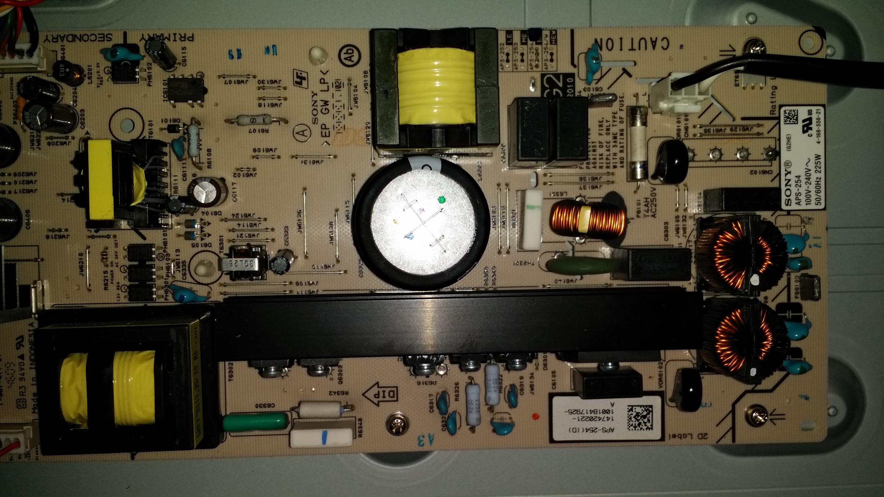

                        Fuse PS6401, PS6402 on the power supply board, the main AC fuse is OK otherwise you will not get 3.3V

                            So these black components screwed into the heat sync on the power supply are fuses?
                              I have no ideas what you are talking about, did you look at the board?
                              https://www.badcaps.net/forum/attach...1&d=1416577619

                                  And nothing at either fuse....
                                    What do you mean by nothing? Did you check the resistance of the fuse to see if it is less than 1 Ohms?
                                    Do you know what fuse is and its function? What other tools do you have and do you know how to do SMD repair?

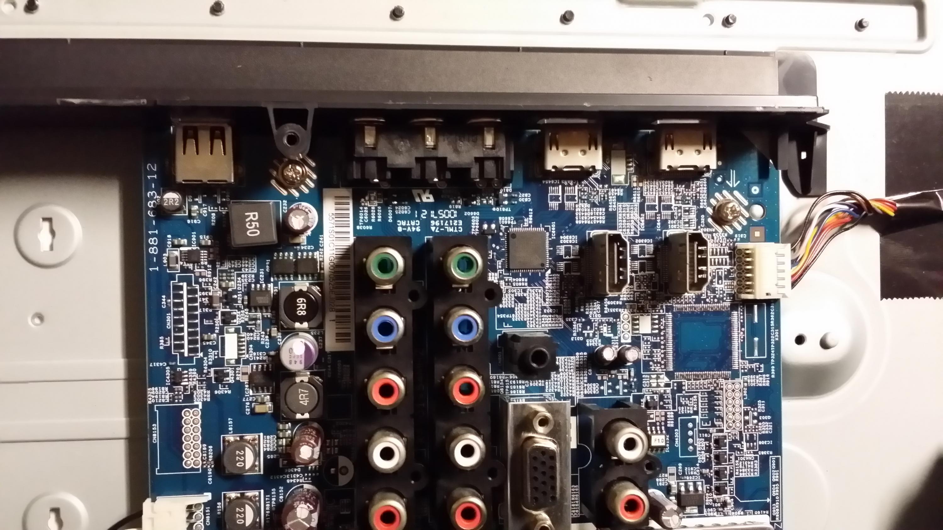

                                        Right now the main board is getting the standby Voltage of 3.3Vdc to run the board, if the main board is OK then when the power switch is activated, there should be more than >2.5vdc on the POWER_ON pin, if not, the main board is no sending the signal which then we need to find out why.
