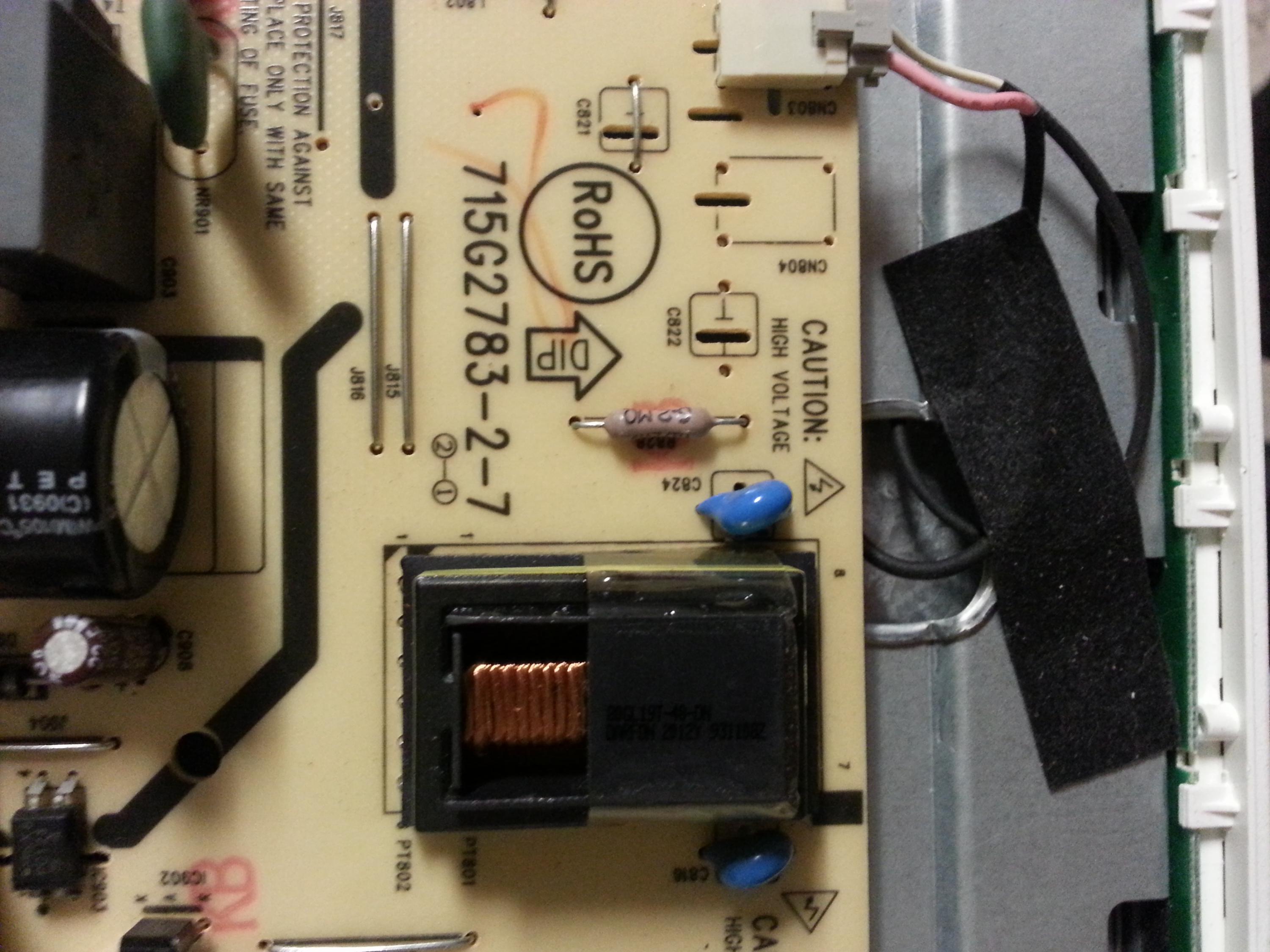

      Ok I checked those fuses and there were no resistance.
          The TV is not plugged in, right?
          The resistance should be the same as when you touch the two probes of your meter together.

            And I understood that test before sounding retarted. If the fuse was blown there would be resistance. And I have tested on the hot side before. I just dont remember any of it.

                Re: Sony 40EX400 Dead No Power....
                That is why I ask if you understand what the fuse is.
                If the fuse is good, the resistance will be <1 Ohms, if the fuse is blown that it will show as open circuit.
                  On the meter they both showed 0 let me check again. Tv off correct
                    "Tv off correct" not just off, it must not be plugged into the outlet.
                      I mean its off anyway. There isn't even a standby light. But just like the other thread same issue. 3.3v no standby light. The guy bought a power supply and fixed the tv. I wanted to see if I could narrow down the problem on the actual board instead of replacing it.
                        Ok tv unplugged they show the same as the meter.
                          "I mean its off anyway." If it is plugged in it is not off because the standby power supply is ALWAYS on this power supply CANNOT BE TURNED OFF, the Voltage on the PRIMARY is ALWAYS present. NEVER check the resistance when the units is plugged into the outlet or power source.
                              Okwhat are those chips called with the hole? I know they put thermal compound on them. I also have all them parts I would have to remove them from other boards. Only thing I dont have is that longer black chip with all the legs on it.
                                  Is that 6.2MOhms pink chip a fuse?
                                    "I also have all them parts I would have to remove them from other boards."
                                    "Okwhat are those chips called with the hole?"
                                    "Only thing I dont have is that longer black chip with all the legs on it."
                                    How do you know you have the correct part when you do not know what they are? Are you being serious? I am outta here.
