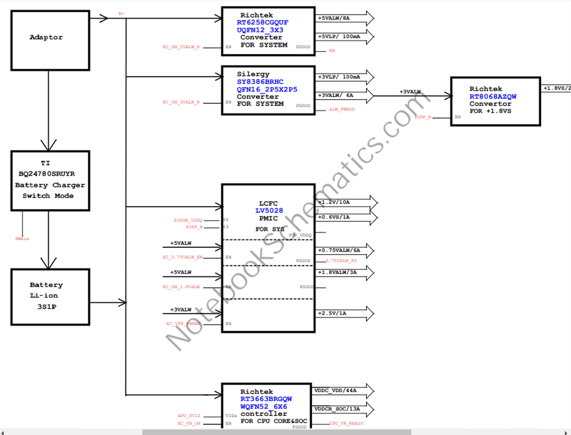

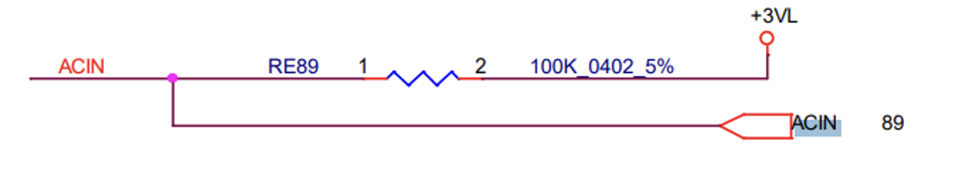

    Tracing ACOK it's connected to ACIN which is connected to a pin GPB0 of IT8227 but also shown as connected to +3VL via a 100k resistor (to pull it high).
    It seems that +3VL is not present as it is low and BQ24780SRUYR shouldn't be pulling it low based on it's datasheet.

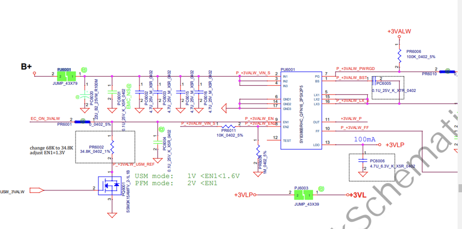

    I am confused at where +3VL is generated as the information I have does not specify. The only mention of +3VL is that it is jumped with +3VLP at PJ6003.
    Checking PJ6003 jump I see 0v and it appears not be shorted to ground.
    My understanding is +3VLP is created by PU6001 - SY8386BRHC but it seems that it's input comes from B+ via jump PJ6001 but I don't have B+ (it's 0v) as the PQ5400 isn't turned on.
    It is unclear to me where +3VL is to be generated, I assume it is generated outside of B+ as B+ depends on the PQ5400 being turned on and that depends on ACOK being high that depends on 3VL being present.

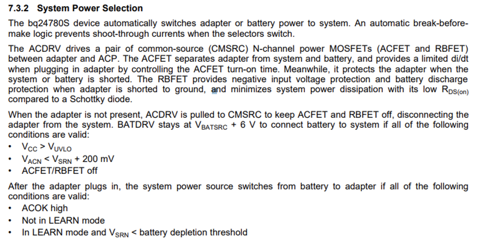

        I have attached part of the TI datasheet for bq24780S that implies that power is only switched to using the AC adapter if ACOK is high, but how can that happen if there is no 3VL from another source?

          You're absolutely right in concluding that +3VLP aka LDO is generated by PU6001 and since it doesnt receive VIN,3VLP will be absent.
          ACOK is an open drain pullup from +3VLP. So you are right in your conclusions.
          However, ACDRV will rise only when ACDET/VCC/REGN/ACOK as well as CMSRC has valid input. In your case ACDRV wont rise as CMSRC is missing.

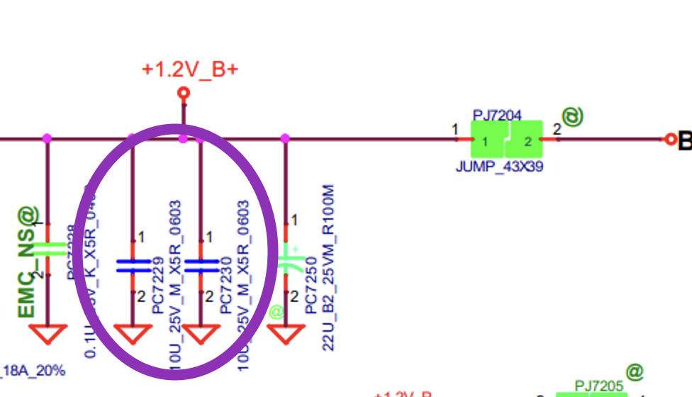

              Spent some time trying to find out what is shorting B+ to ground. Went through and disconnected jumps that connect directly to B+ PJ6001, PJ5701, PJ1010 and PJ7204 progressively looking for change and identified the short is within the PJ7204 area as with PJ7204 disconnected the short to ground on B+ is gone.
              Plugging in the adapter with PJ7204 disconnected gives 20v at PR5425. Pressing the power button the power LED flashes (which is better than before as it was completely dead).

                  I managed to find that caps PC7229 and PC7230 were shorted and removing them from the board removed the short. Reconnecting PJ7204 and powering it up with those caps removed it boots successfully.

                    Well done!! The caps will probably not be missed but in your travels, hit up a local electronic parts store for closure. They are 10uf 0603 SMD size at a voltage that should be higher than the operating voltage. There are articles that report that the spec of the capacitor voltage should be close to the operating voltage else the capacitance will derate.

                      Glad to know you solved the puzzle. Replace those caps with 10uF/25V ratings even though the system will work without the caps.
                      They were put for some reason by the manufacturer-so dont ignore it.
