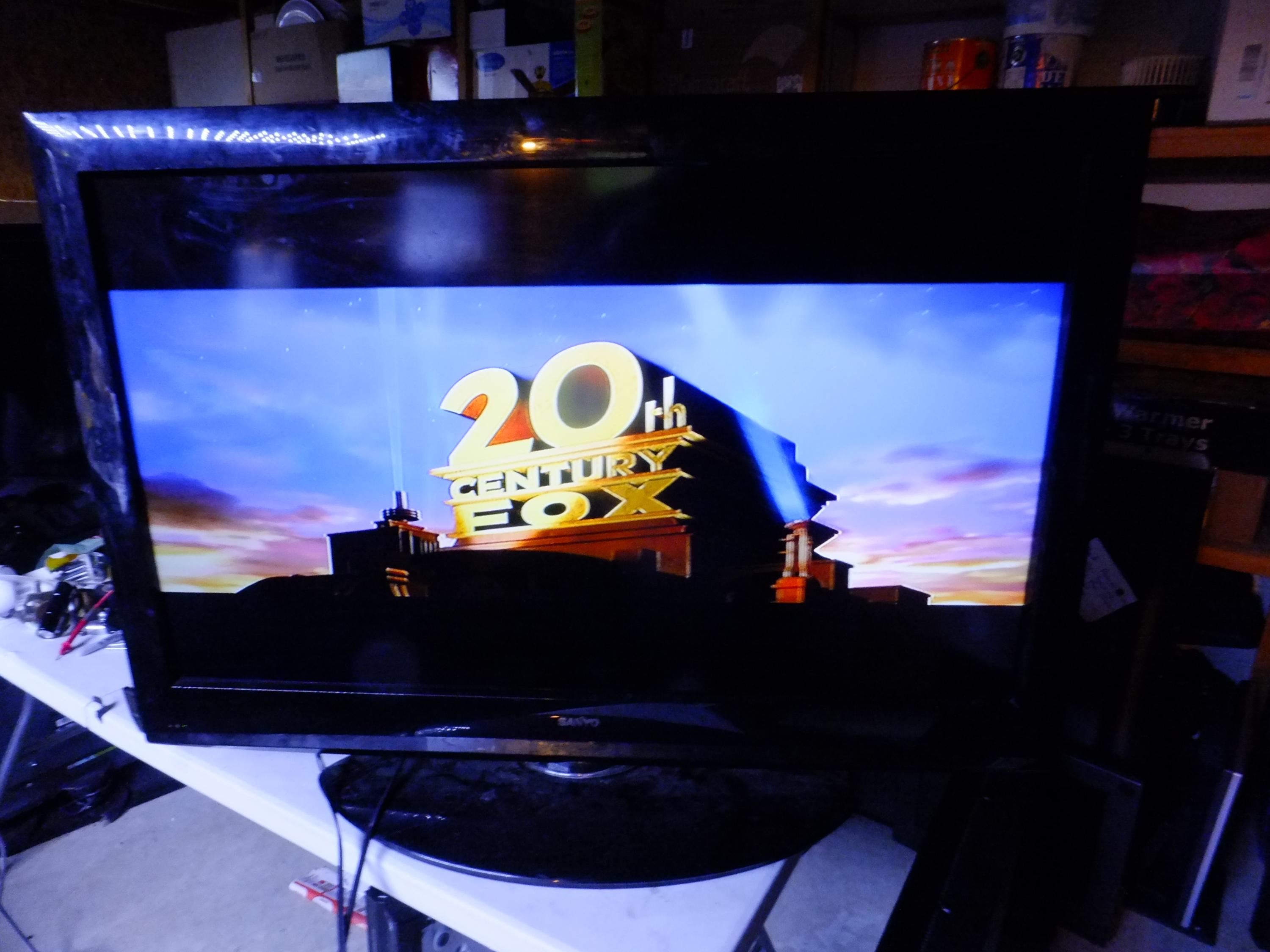

                  Well, good news. The TV is fixed. I had to replace 2 LEDs but I thought I was going to have to replace all of them because 2 strips were bright and the other 3 were very dim. But I put it back together without the screen and the LEDs were very bright. So then I put the TV all back together and it seems to be working good. Time will tell. I have included a picture.
                  Once again this web site has helped me fix a TV because I thought for sure it was the main board. I best keep reminding myself these LEDs love to burn out.
