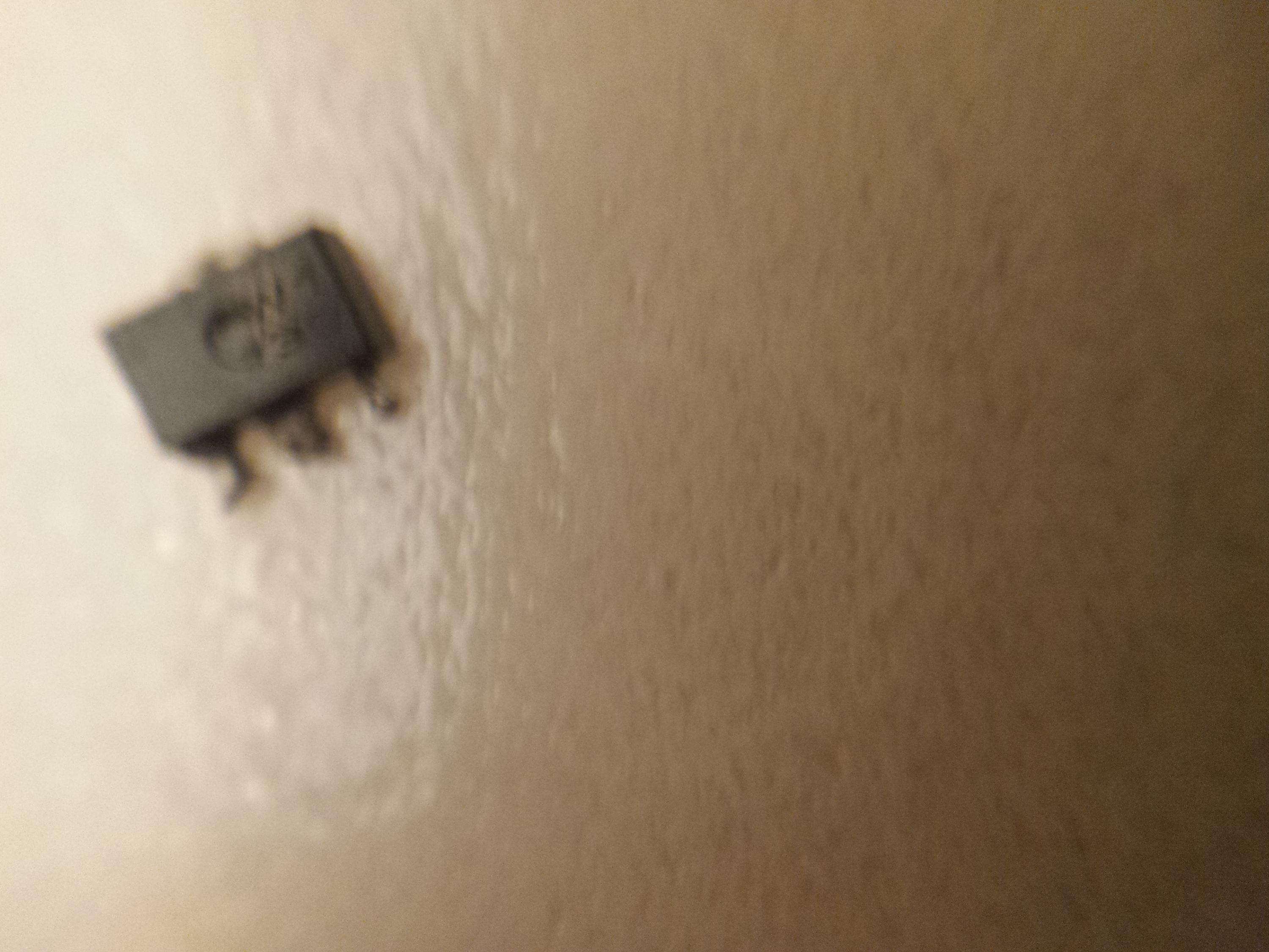

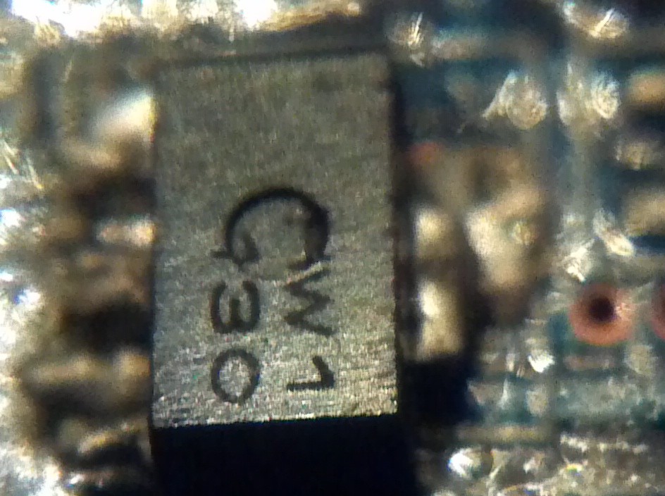

    Thanks Kasfamily. Sorry for the quality. They were taken with a cell phone. I will get a picture of the bad component posted sometime today.

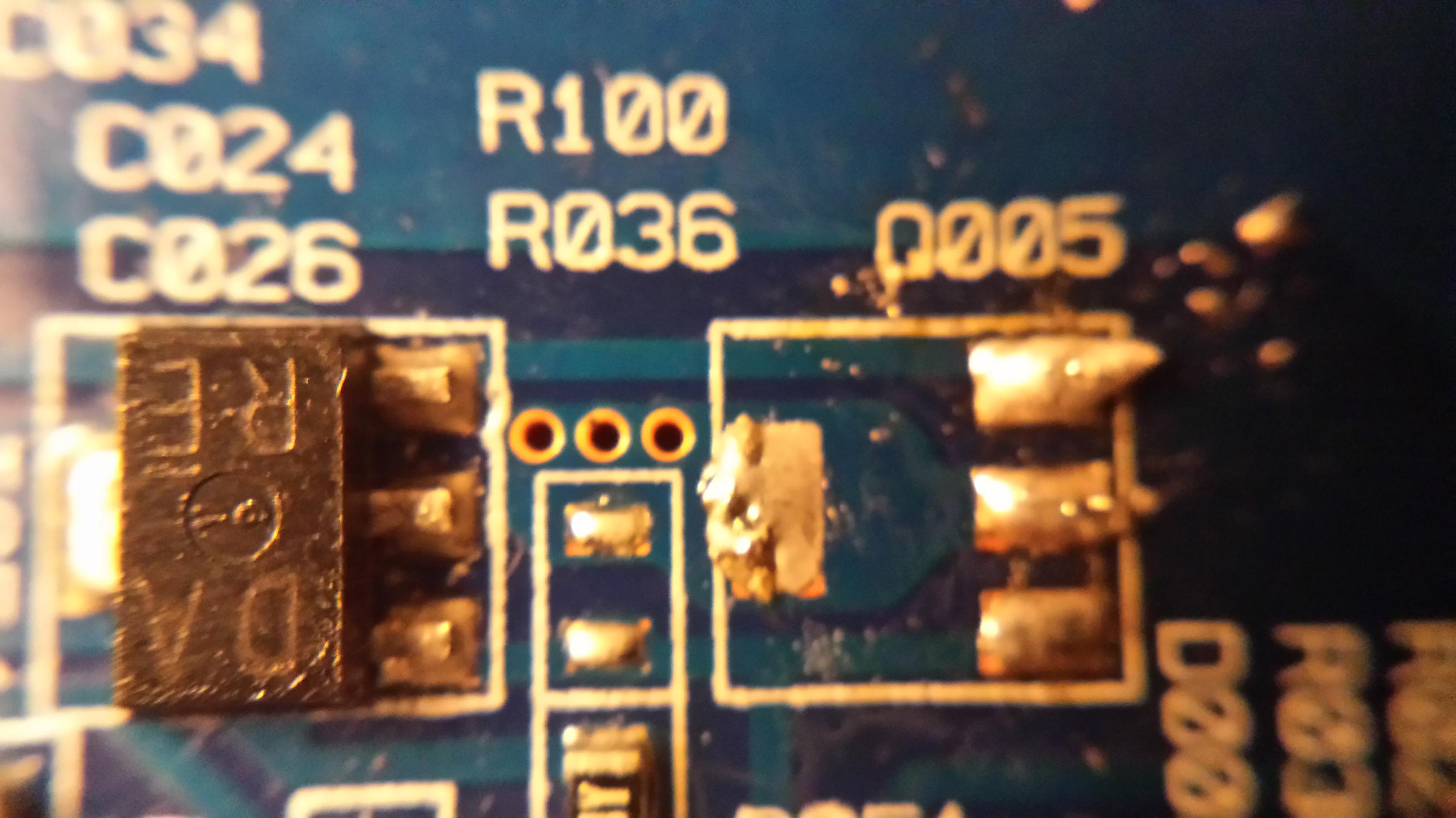

      Here is a pic of this bad component. It is the best quality i can get at the moment. I am sure you are right about that da transistor. There are 2 of those and this w1 is connected back to back with the one you identified.

        Re: Sanyo DP40142 No backlight
        Hi Herbssat! Necessary though, would be like this
          Thanks. What did you take that picture with? Will see if i can find a better camera.
            These pics may be slightly better. I still cannot get enough zoom to help you identify what q005 is. I am working on it.

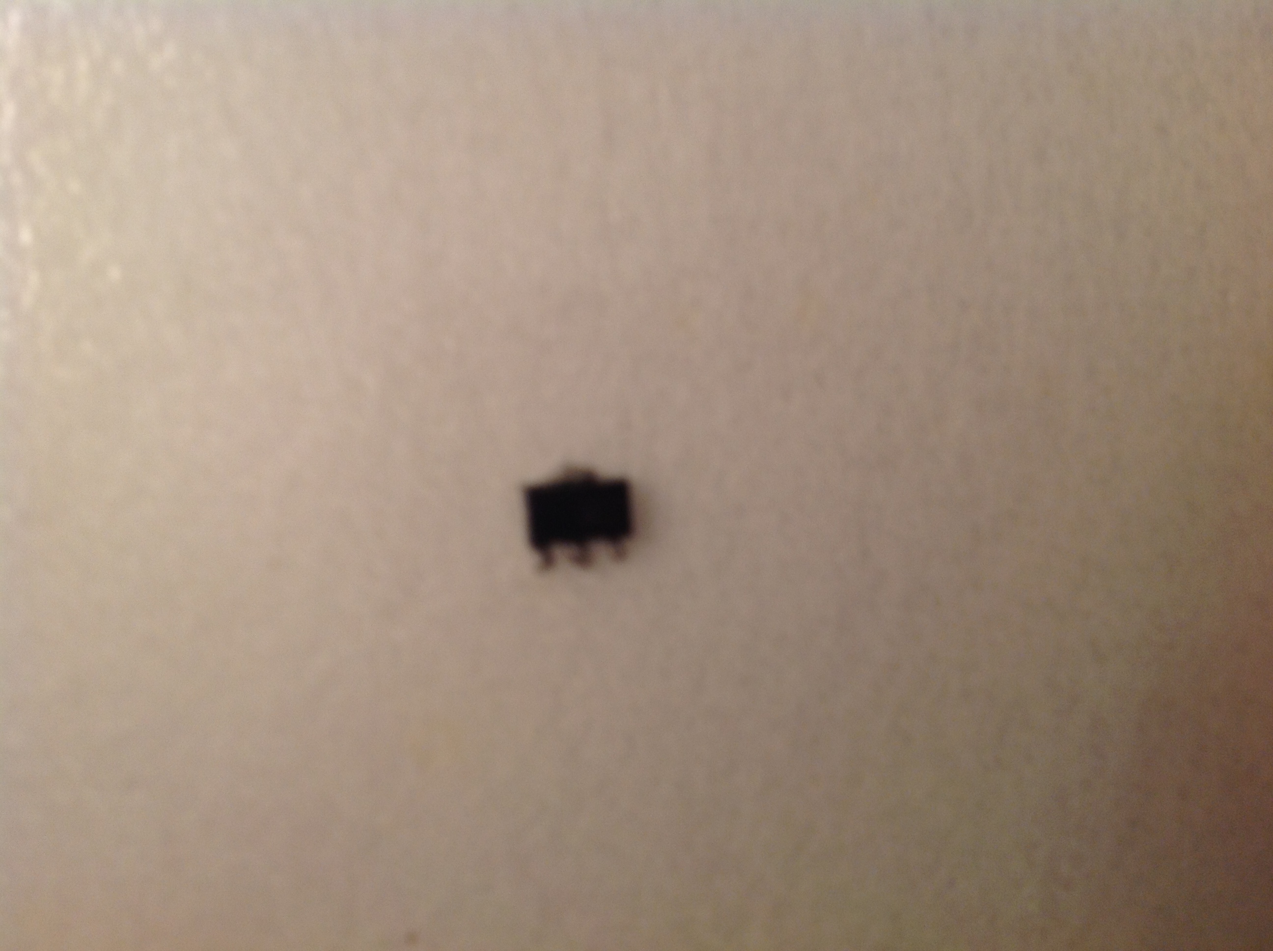

              A little better picture of the bad component.

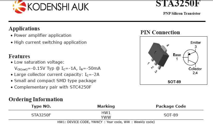

                Q005 marking W1 maybe STA3250F
                  Thanks Kasfamily. I have got a little better picture now. Check this one out.
                    Well and you ask why need good photo transistor, here in the last photo you can see everything and search would have taken much less time.
                      Thanks for hanging in there with me Kasfamily. I had to download a third party app in conjunction with my camera phone to get a good shot.Now i have to match the ratings of this transistor with another.I will probably have to get a generic from another company. Once i find it and put it back on the board i will post my results.
                        Ok.Well, what's wrong with Q005, shorted transitions?
                          Hey Kasfamily. I had a lot of runs to make today.Here is detailed testing of this transistor.
                          Using positive lead
                          Base to emitter-OL
                          Base to collector-0.001
                          Emitter to base-0.566
                          Collector to base-0.001
                          Collector to emitter-OL
                          -0.563(swapped leads)

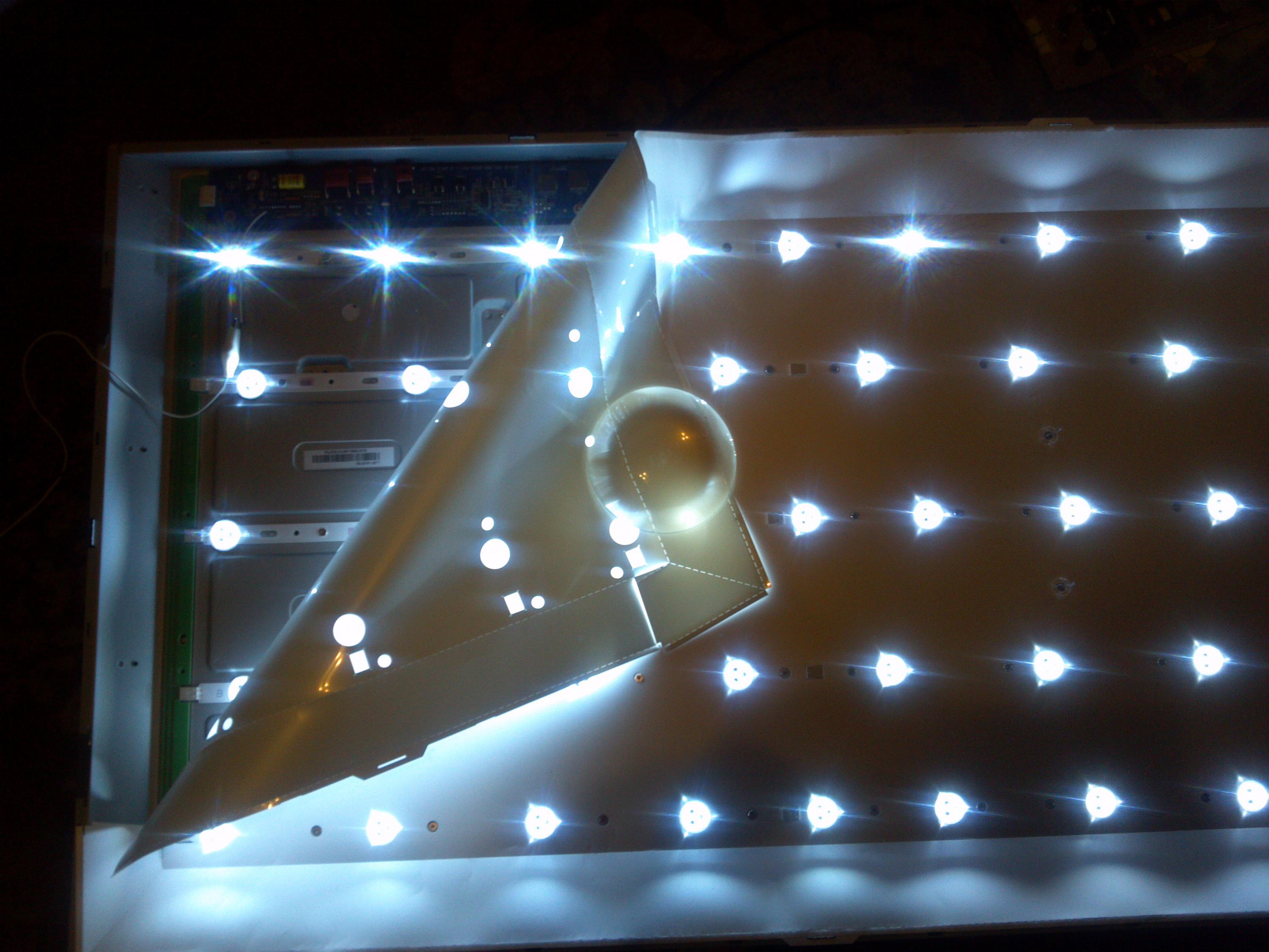

                            Here is an update on this set. Replaced the pnp transistor (Q005) and the backlights turned on for about 30 seconds and shut down again. Was able to get them back on but only sporadically. The 24 v is there when they shut down and i am simulating the bl_on signal with a 3.2v battery pack. When it was working the vout was about 140.75 on the driver board.

                              Anyone know where i can get a SUS400 A73 4led type a backlight strip from? Haven't found one anywhere. Your help is appreciated.

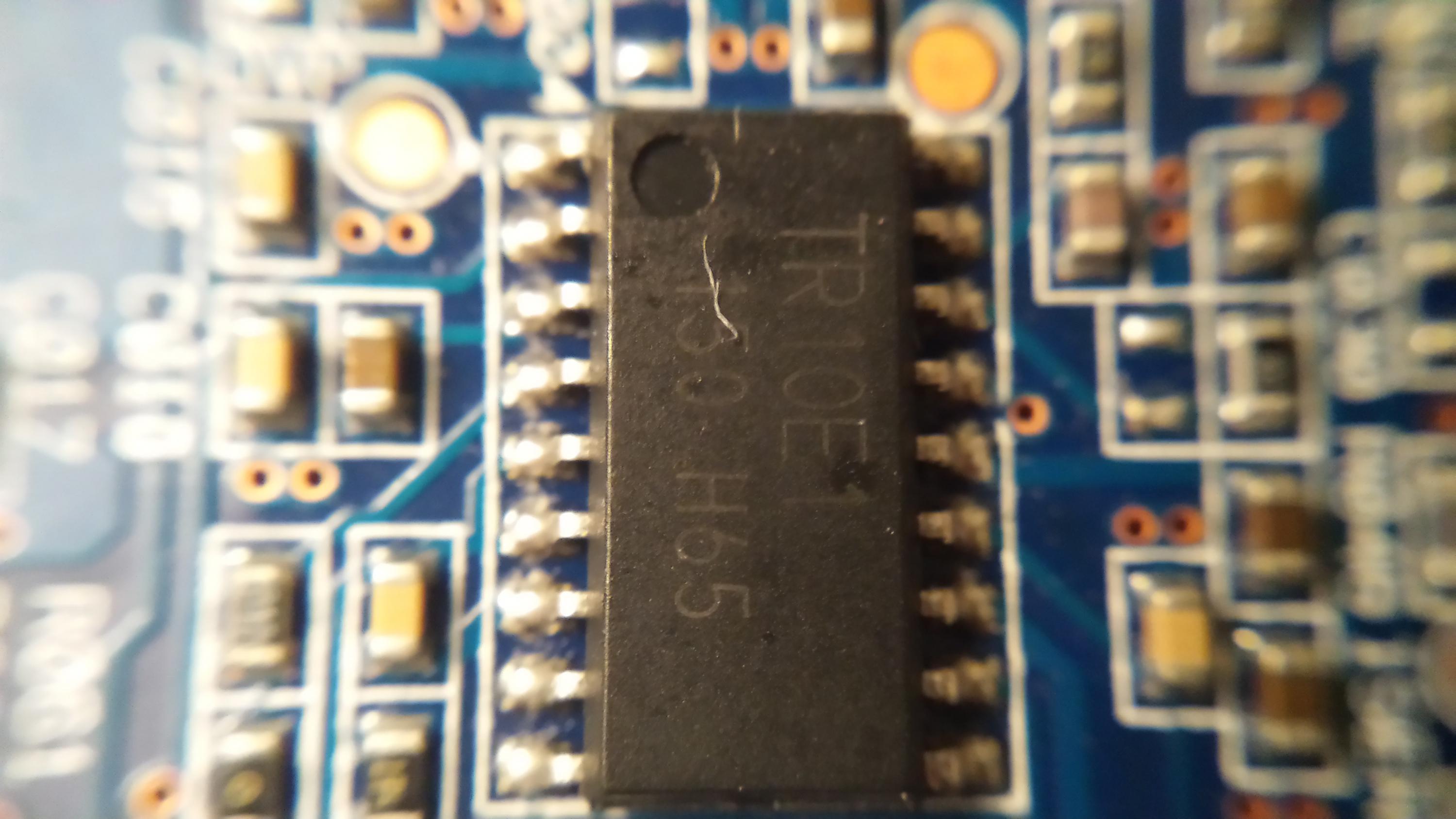

                                  Thanks again Kasfamily. I need to hurry and get these on order. I also ordered a tr10e1 ic from china. Getting a lot of weird erratic voltages coming from this chip. I could not bridge the backlight strip well enough evidently as the driver ic may be sensing a problem. According to the handmade jpg you sent i have no voltage out at pin 11 going to the base of q008 and no 7.7 volts going to q004. Do you guys celebrate christmas in russia? I would love to send you something in a monetary form for your help.

                                      Hi Kasfamily. Enjoy your vacation. I am from the US. I am currently trying to order the strip. I hope they ship internationally. Appreciate all your help.

                                        Are there any more suggestions for obtaining this strip or a creative way to fix this. I would like to put the original strip back in if possible. The russian company that kasfamily referred me to does not ship to the us.
