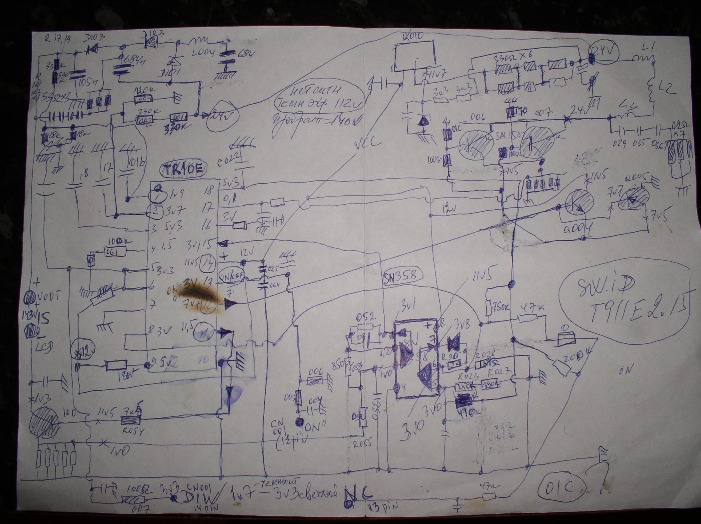

                Re: Sanyo DP40142 No backlight
                http://www.kenotrontv.ru/forum/uploa...1407958929.jpg
                • Herbssat
                  • Sep 2011
                  • 194
                  Many thanks to you Kasfamily for your help. This gives me a good general idea as to what kind of voltage i should be seeing at the various points on the board. The only voltage i recall seeing is the 24v at both mosfets and the 3.2v or so near the connector on a smd capacitor or two. Why are parts so hard to find for this panel? The bottom line is i will have to rework the board just to get the backlights working again.

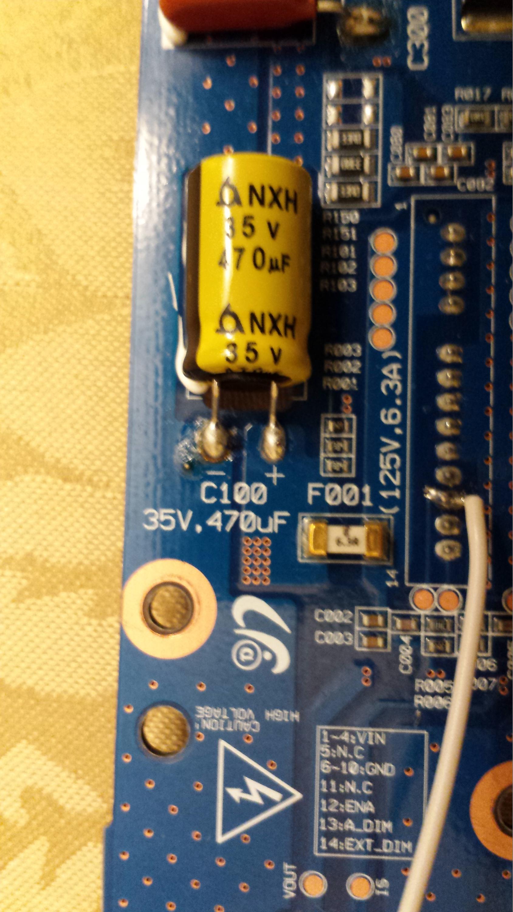

                              Hi Kasfamily. You already sent a picture of the led driver board with the voltages. What i can tell you is that both the base and emitter of Q00t4 and Q005 are tied together.Q004 is the transistor with the 5v.Q005 is also tied to pin 3 of the dual op amp that shows 16v.
                                The photo from the other site is not clear enough to see the components and how they are connected together.
                                We need good closed up pictures of the both sides of the board and also in sections to be able to see the traces on the board.

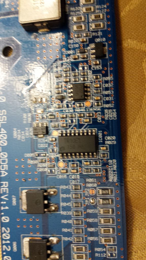

                                  Hi Herbssat. Need photo marking Q005. Here's what I found on this driver, it is not my
                                  • Herbssat
                                    • Sep 2011
                                    • 194

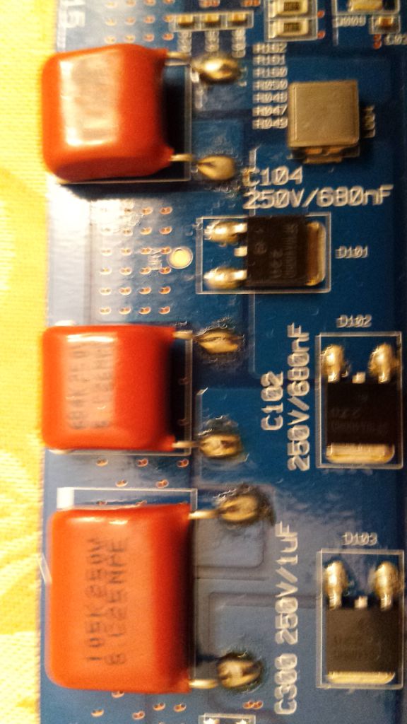

                                    Thanks Kasfamily and Budm. Here are some pics. Hope these can help you to help me. Q005 is off the board. i presume it is a transistor also. It checks bad.
