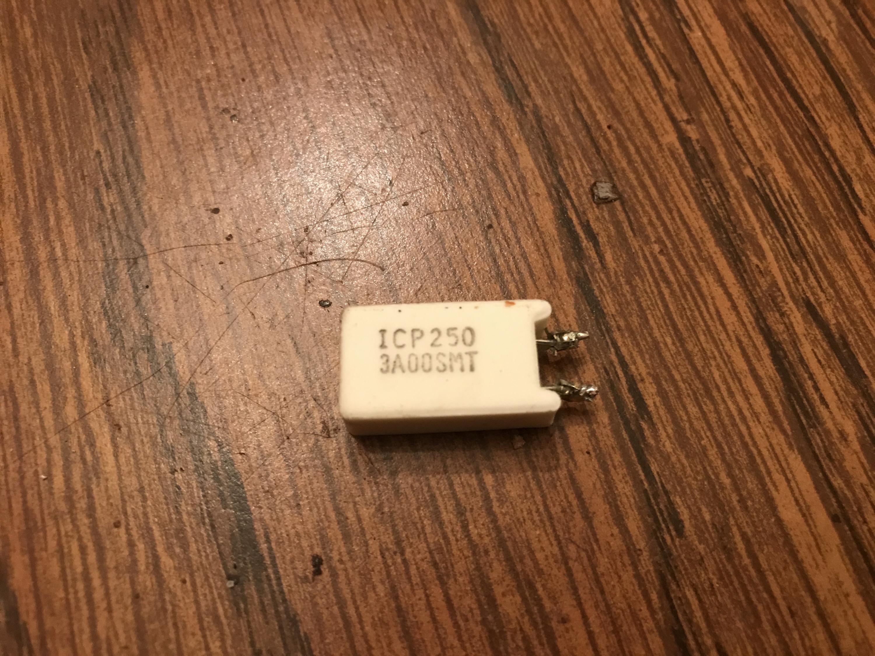

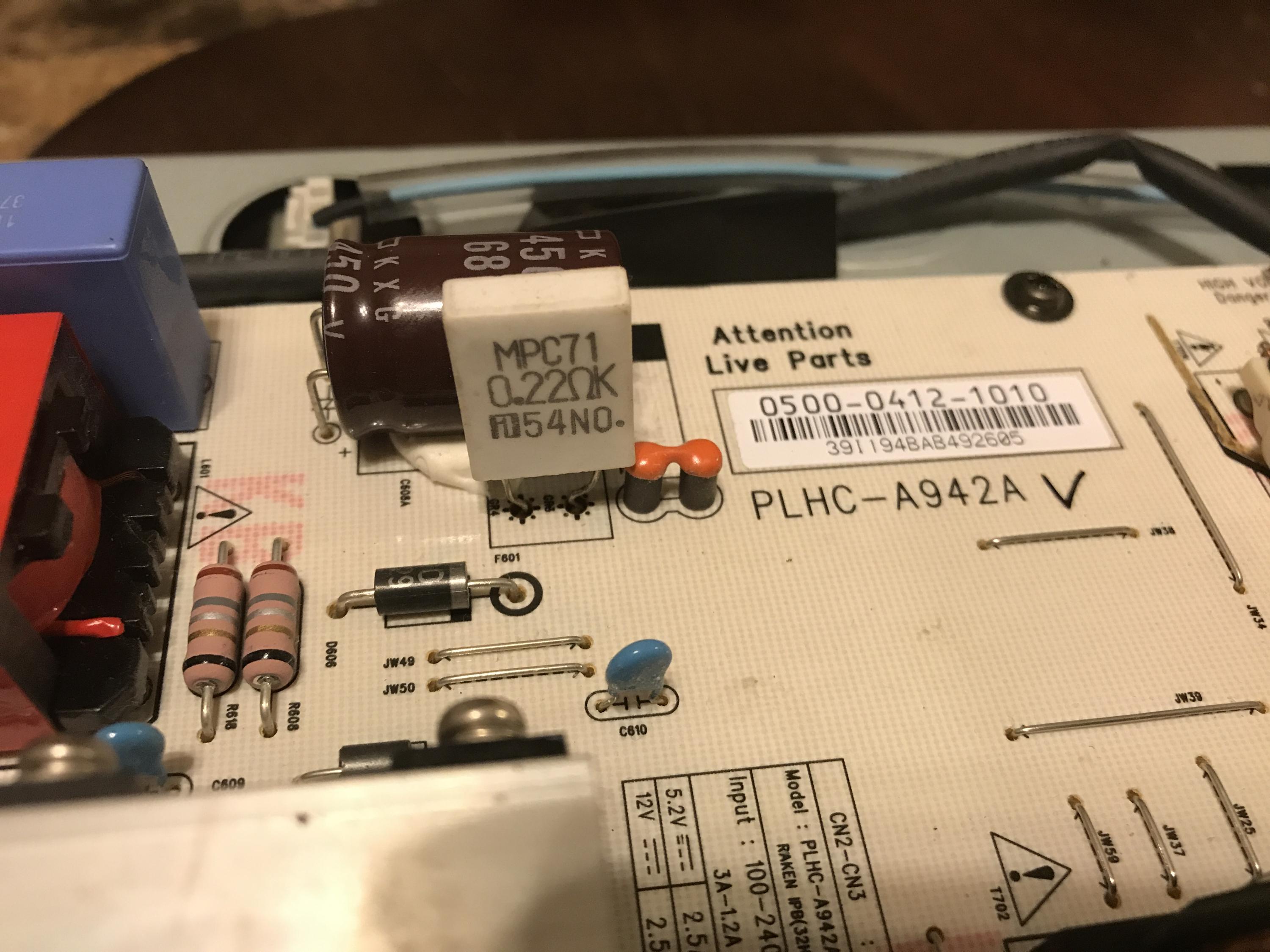

            #65
            Re: Vizio E320VL - No Power, No 5v Standby - DEAD PSU??
            Originally posted by budm
            OK, check fuse F601? WHITE RECTANGULAR BOX close to the 450VDC large cap to see if it is OK first, if it is then:
            you can test the power supply board by itself first without having other boards connected to it, you will be measuring the DC Voltages on the two legs of the cap C104, C105 which are in the hot DEADLY side of the circuit so care must be taken.
            You will have to flip the board so you can easily work on the bottom side of the board, make sure not to touch anything or let the probes slip on you.
            We also need the P/N of U101 SMPS IC so we can look up the spec sheet for it.
            You should pug the board into GFCI outlet for safety.
            I have one of these tv's that had no logo light and no voltages whatsoever on the output pins.
            I replaced the ICP250 with a MPC71 I had on one of my junk parts boards and the tv fired up !
            The value of the ICP250 IS .16 - .25 ohms 5 volts, I replaced it with .22 ohms 5 volt.
            THANK YOU BUDM !!!!!
