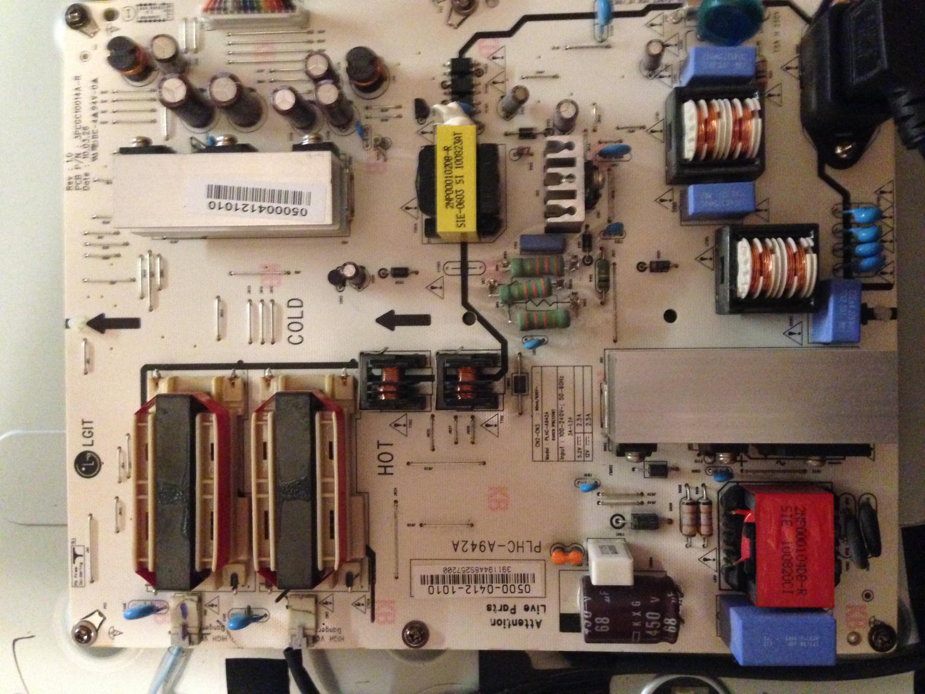

Vizio E320VL - No Power, No 5v Standby - DEAD PSU??
  • hdguy
    • Sep 2014
    • 49
    Multimeter: neg probe to frame, red probe standby pins on the wiring harness that goes from the power supply to the main board, I get 0v. In fact, I get 0v across all of the pins.
    Main system board fuse continuity check (it's fine)
    Plugged in checked AC @ main fuse: 122.8.
    Also: No status or indicator lights at all
    ... is it as cut & dry as: Dead Power Supply?
    If yes:
    option 1: buy 0500-0412-1010 (are there other boards as viable alternatives?)
    option 2: fix power supply (where do I start????, no visible issues - very clean board (see pic)
    If no, it is possibly something other than psu -
    then please advise on next steps

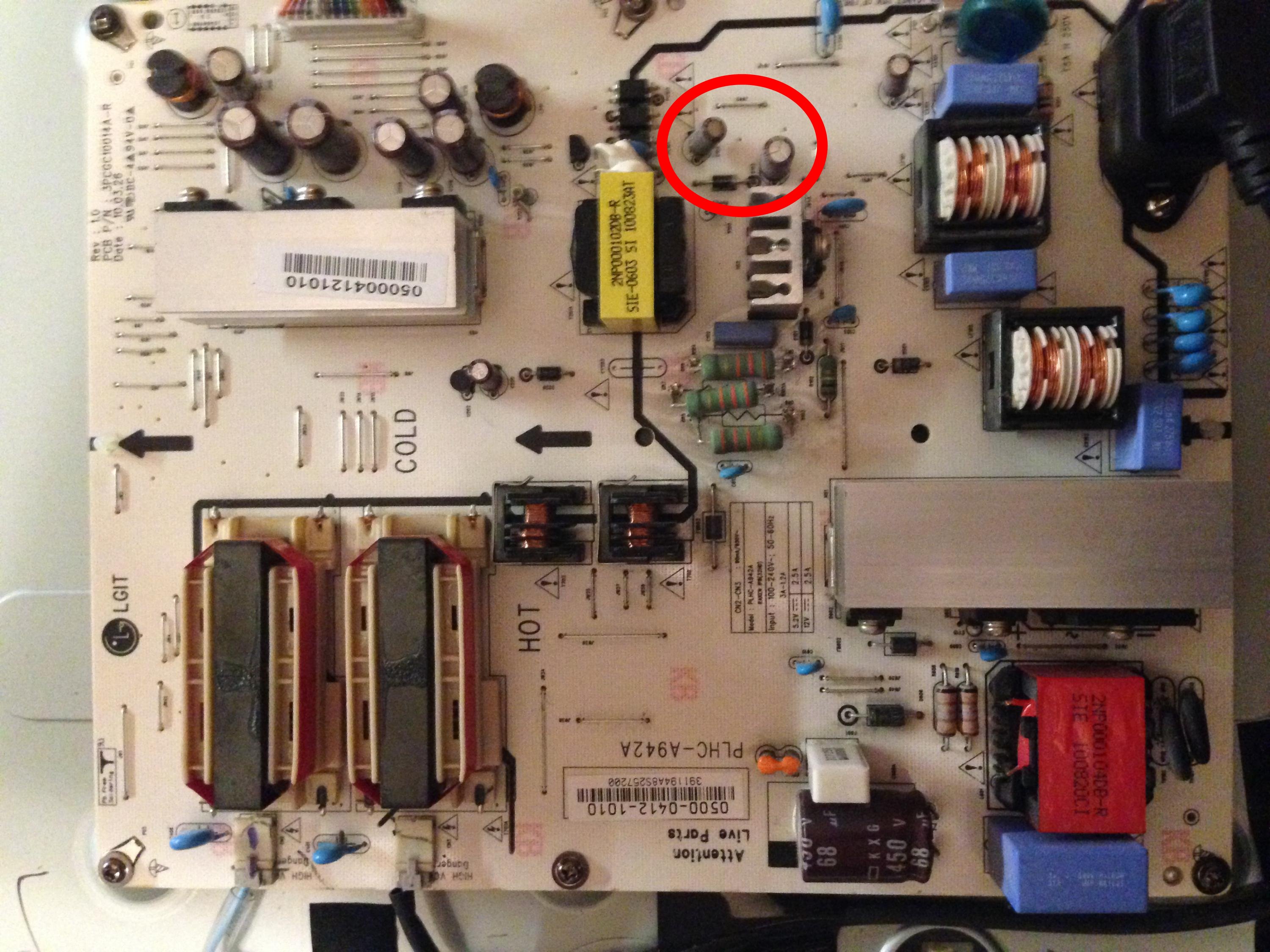

    On the output of the bridge rectifier is the main filter cap. It should read about 170 vdc across it. It is across the rectifier output. 120x1.414=169.68. When the PFC is working voltage across the the main filter cap should be about 385 vdc
      Re: Vizio E320VL - No Power, No 5v Standby - DEAD PSU??
      Try heating those two caps with hair dryer and then apply power and see if you will get Voltage at the connector.
        Ok - I'm pretty lost already, from all of the googe'ing & YouTubing, I think I am able to provide what you asked for.
        vdc readings on the bridge rectifier (BD101):
        +: 107.5
        ~: 0
        ~: 0
        -: -59.5
        The large cap (C608A) measured:
        +: 107.2
        -: -59.5
        For fun, I did check vdc readings on the two other caps that were pointed out, for the hair dryer trick, and they were both the same: -59.2 on all pins (C104 & C105).
        I also checked for continuity on FB601 & F601 (fuses, right?) and it passed.
        Is this helping narrow anything down?
        Is it time to do the hair dryer trick?

          Ok - I tried the "dryer on the caps method" mentioned above (let it heat for about 90 seconds) and it did not change any of the readings. I hope I did it long enough, but I've had bad luck with this in the past, which included an Xbox 360 and a heat gun, so I am a little gun shy...
          Any other thoughts on how to get low voltage up to the pin harness?

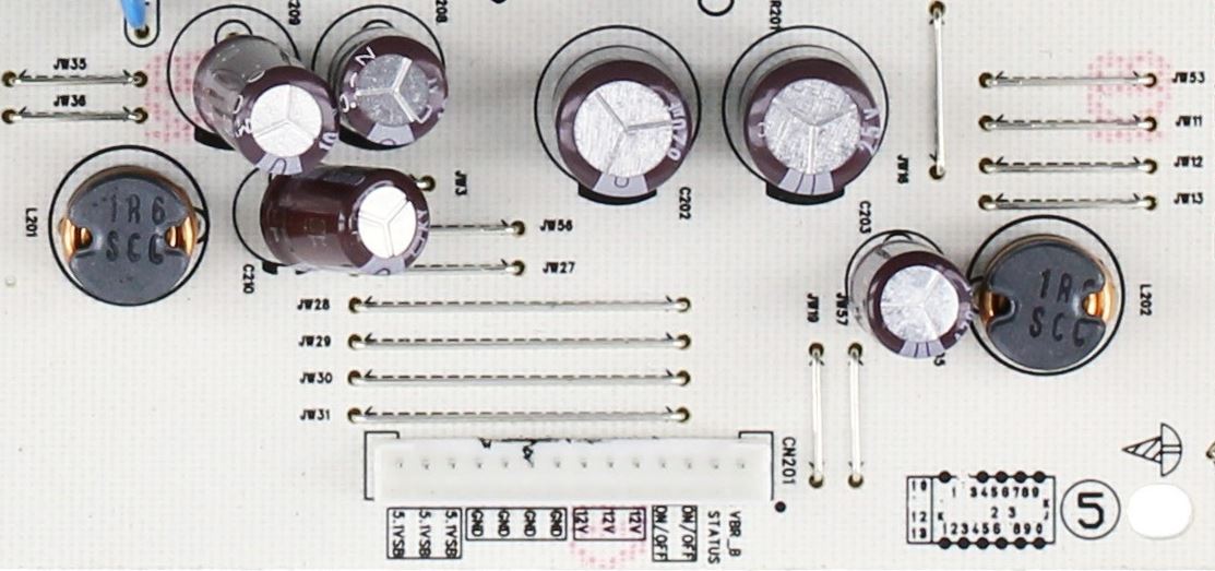

            I would jump the power supply, with some resistors between the standby pin to power on and inverter on pins and disconnect the main harness going to the mainboard.
            You should have backlight on and all the voltages.
              To be specific, are you suggesting, wire the following pins together (see photo of the mainboard connector on the power supply):
              • ON/OFF (either one) --> 5.1VSB (any one of them)
              • ON/OFF (the other one) --> 12V (any one of them)
              From there, apply power and confirm:
              • Blacklights should work
              • I've got 5.1v & 12v @ the connector
              Also, are resistors needed on both of the above scenarios, and if so, how big ?
              ......Is this all right?
                  Ok, I'll try again:
                  168.5 vdc
                  168.9 vdc
                  The reading was the same regardless if I used the (-) of the large cap or the bridge rectifier.
                  This is telling us something.. right?! by the way, thanks for your help so far!

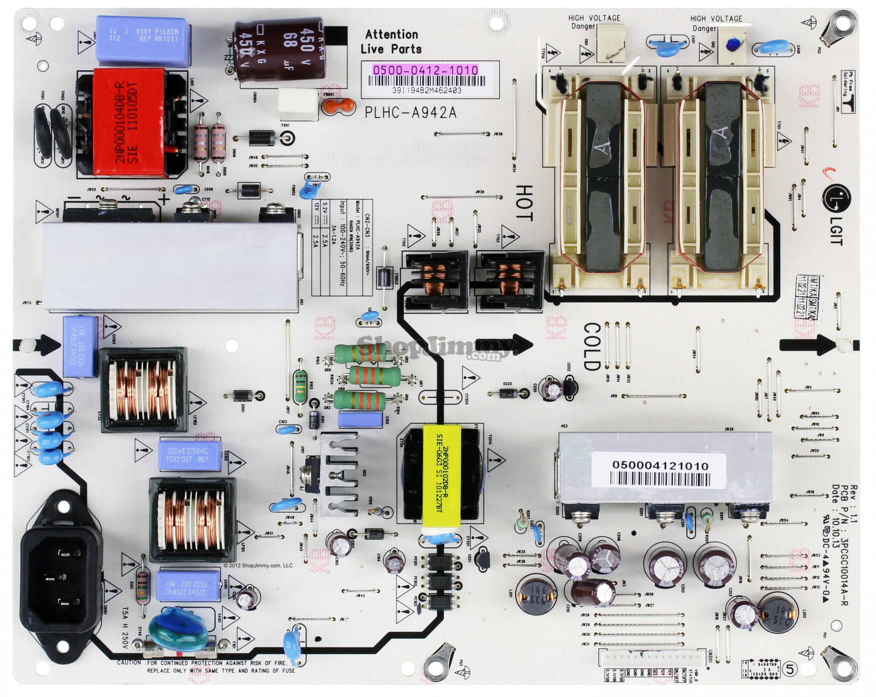

                    The main DC is working, this main DC is used by the standby power supply to run.
                    So now we need to work in that section where the caps are.
                    http://www.shopjimmy.com/vizio-0500-...upply-unit.htm
                    I will have to download the pictures from SJ first so I can tell you what test points to look at next.
                                I am sorry about follow through on your thread, the thread was not high lighted so I did not remember about it.
                                I will try again this evening.
                                Pictures provided by SHOPJIMMY.
                                • hdguy
                                  • Sep 2014
                                  • 49
                                  Excellent - I am looking forward to learning the next steps!

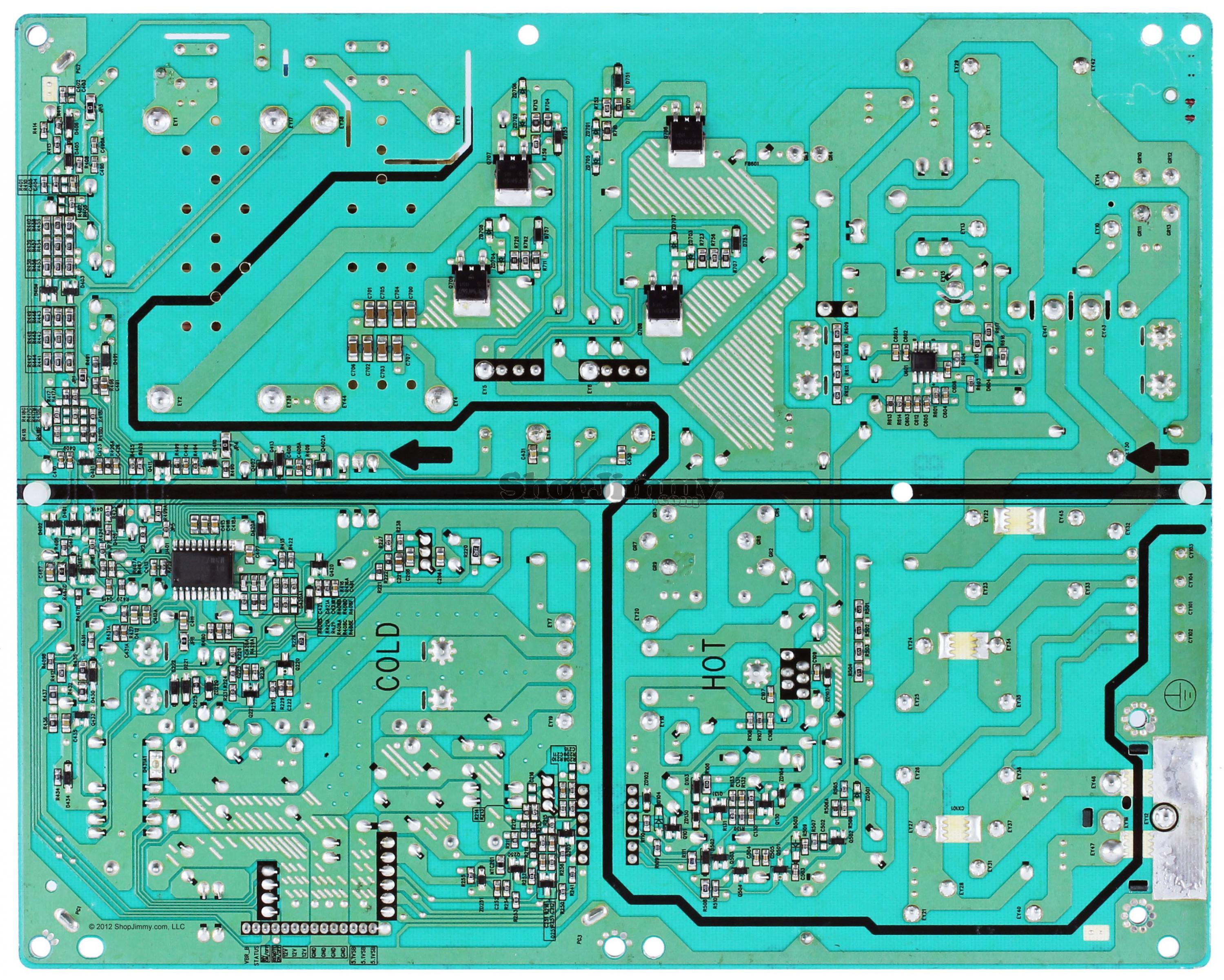

                                    OK, check fuse F601? WHITE RECTANGULAR BOX close to the 450VDC large cap to see if it is OK first, if it is then:
                                    you can test the power supply board by itself first without having other boards connected to it, you will be measuring the DC Voltages on the two legs of the cap C104, C105 which are in the hot DEADLY side of the circuit so care must be taken.
                                    You will have to flip the board so you can easily work on the bottom side of the board, make sure not to touch anything or let the probes slip on you.
                                    We also need the P/N of U101 SMPS IC so we can look up the spec sheet for it.
                                    You should pug the board into GFCI outlet for safety.
