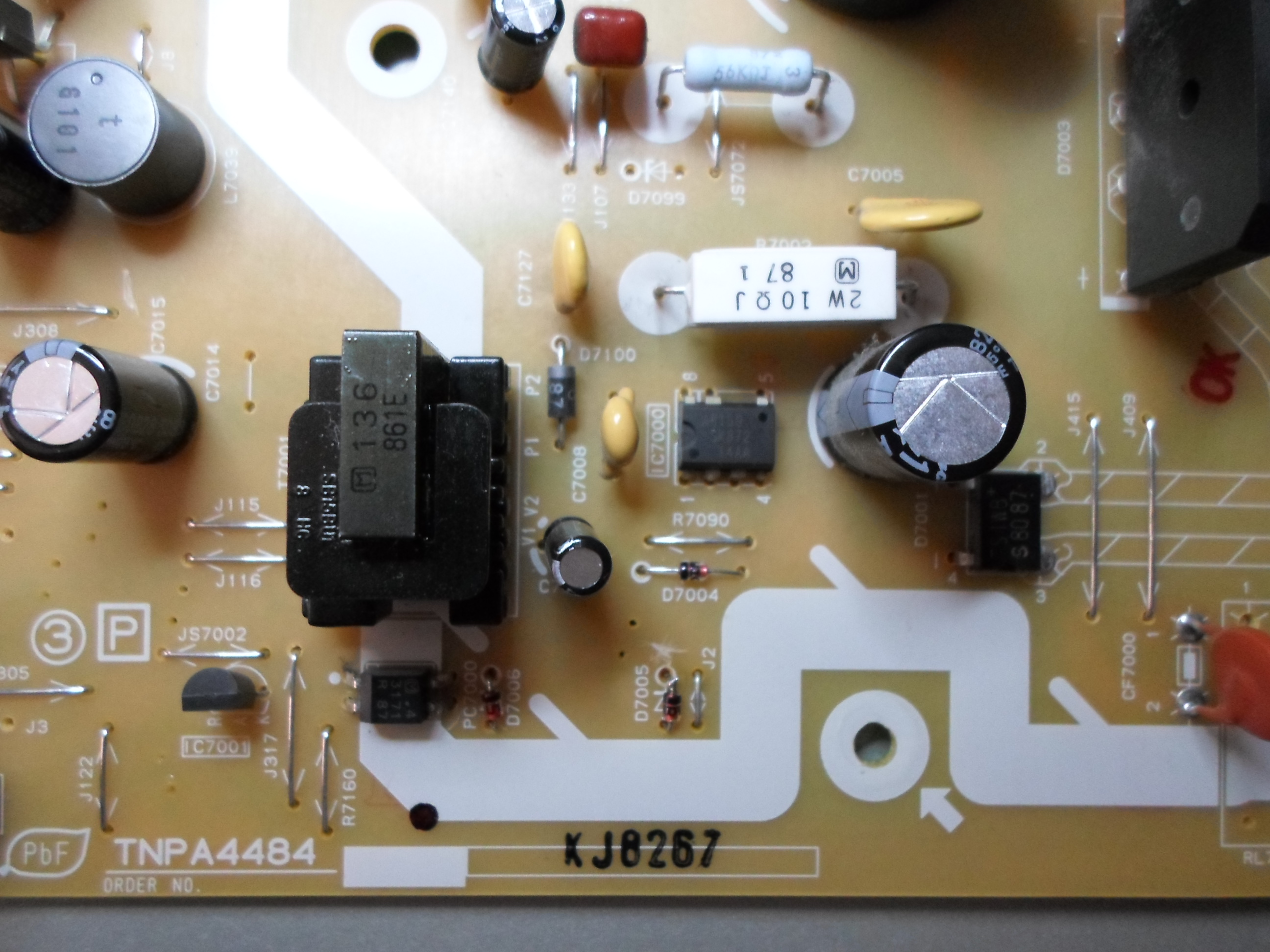

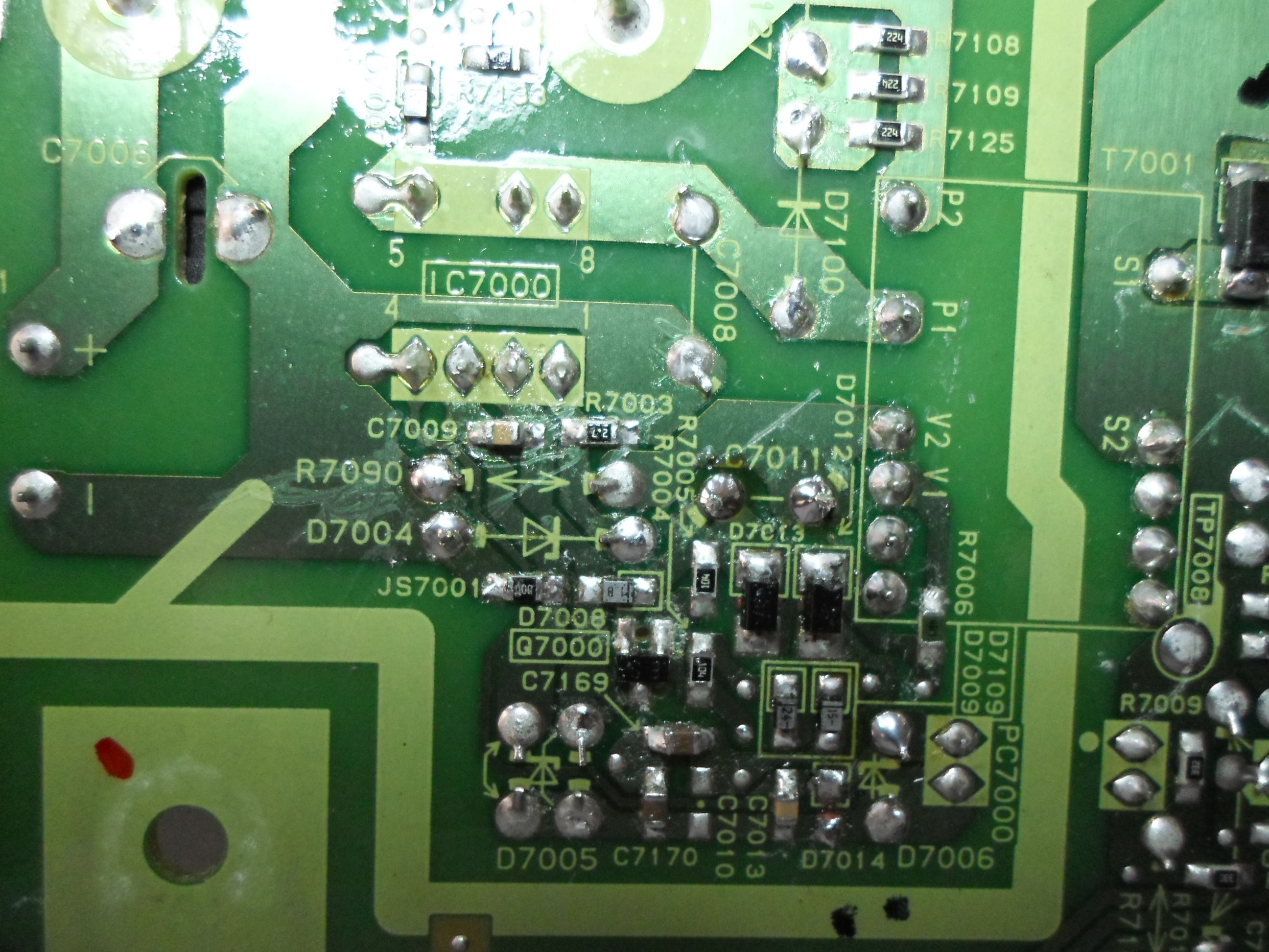

            Re: Panasonic TC-32LX85 Dead
            can you post a picture of the area? are there parts on both sides of the board in that area?
              #86
              Pics... C7011 is directly right of transformer.
                #87
                Im trying to use freeze spray and heat to isolate the area, but I can't seem to get it stay 'off' with the freeze, but the heat definitely works to get it on. I think it's something on the bottom.
                The last time I got it stay off I blew heat down the 2 small holes from the top, which are right above Q7000 and it came on instantly. Ill have to keep experimenting..

                  #88
                  I think this is fixed, replaced IC7000, Q7000, and PC7000 and it seems to be working consistently. I suspected Q7000 but I replaced all 3 at the same time just to be sure.
