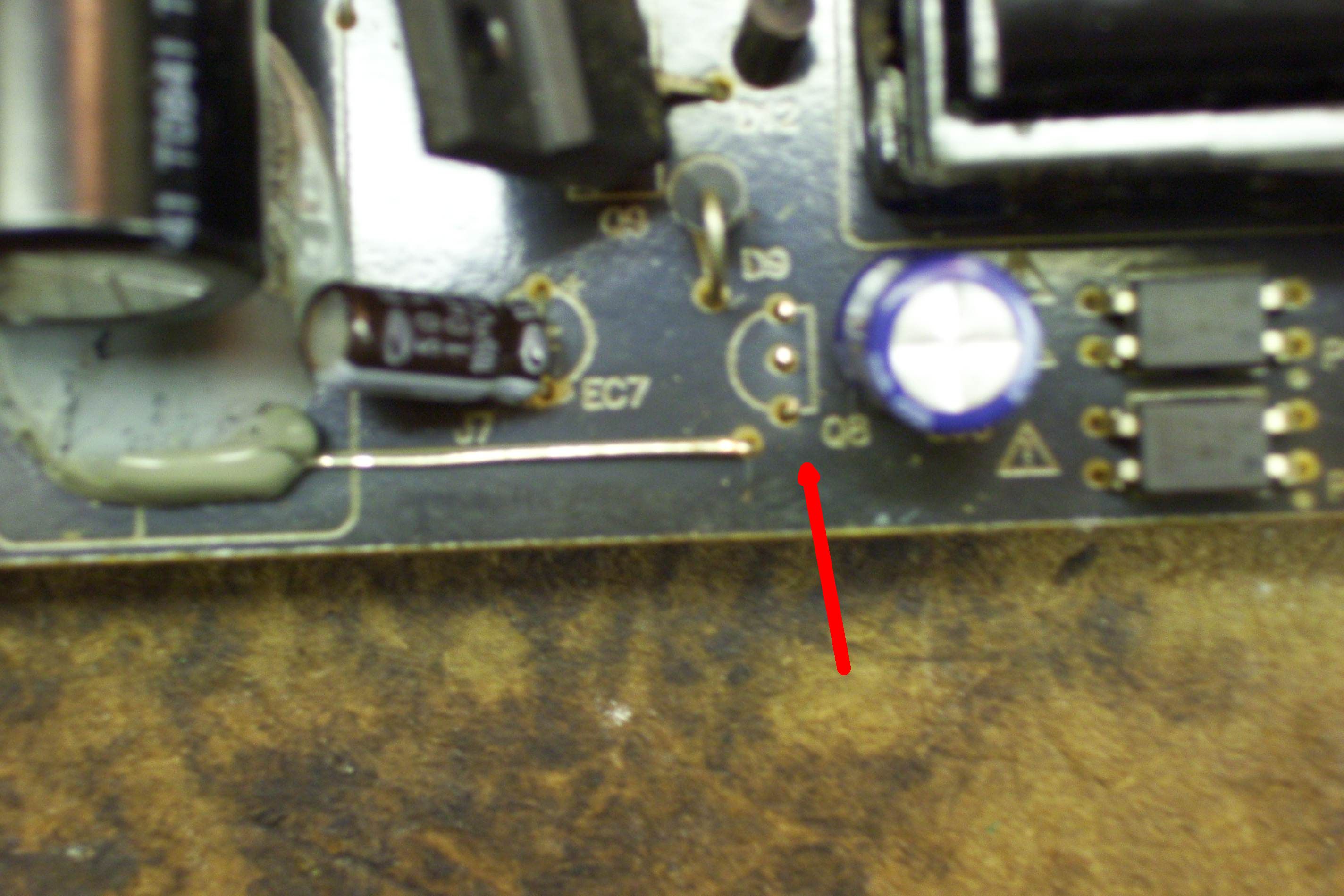

    Sceptre32 MegMeet mp116 Solved
    Sceptre x320bv-hd megmeet mp116 rev 1.4-- 2010.03.02
    Weird Intermittent Problem
    Tv would work fine for hours on end but if turned off
    When Left in standby for any amount of time and turn on
    it would startup and then lose both picture and backlights
    for a second, and then come back on. In other words on off on off on off indefinately.
    Unplug and leave cool down and it would work for hours again.
    Found out it was Losing both 12 and 24 volts 5 volts always there
    Hard to trace as I thought it was going into protective shut down
    But it wasn't.
    I also thought something was drawing too much current so
    I unplugged inverter board and tv would stay on but
    plug inverter board back in and unplug T-Con board and
    TV would also stay on.
    So power board could not handle the full current load to run tv.

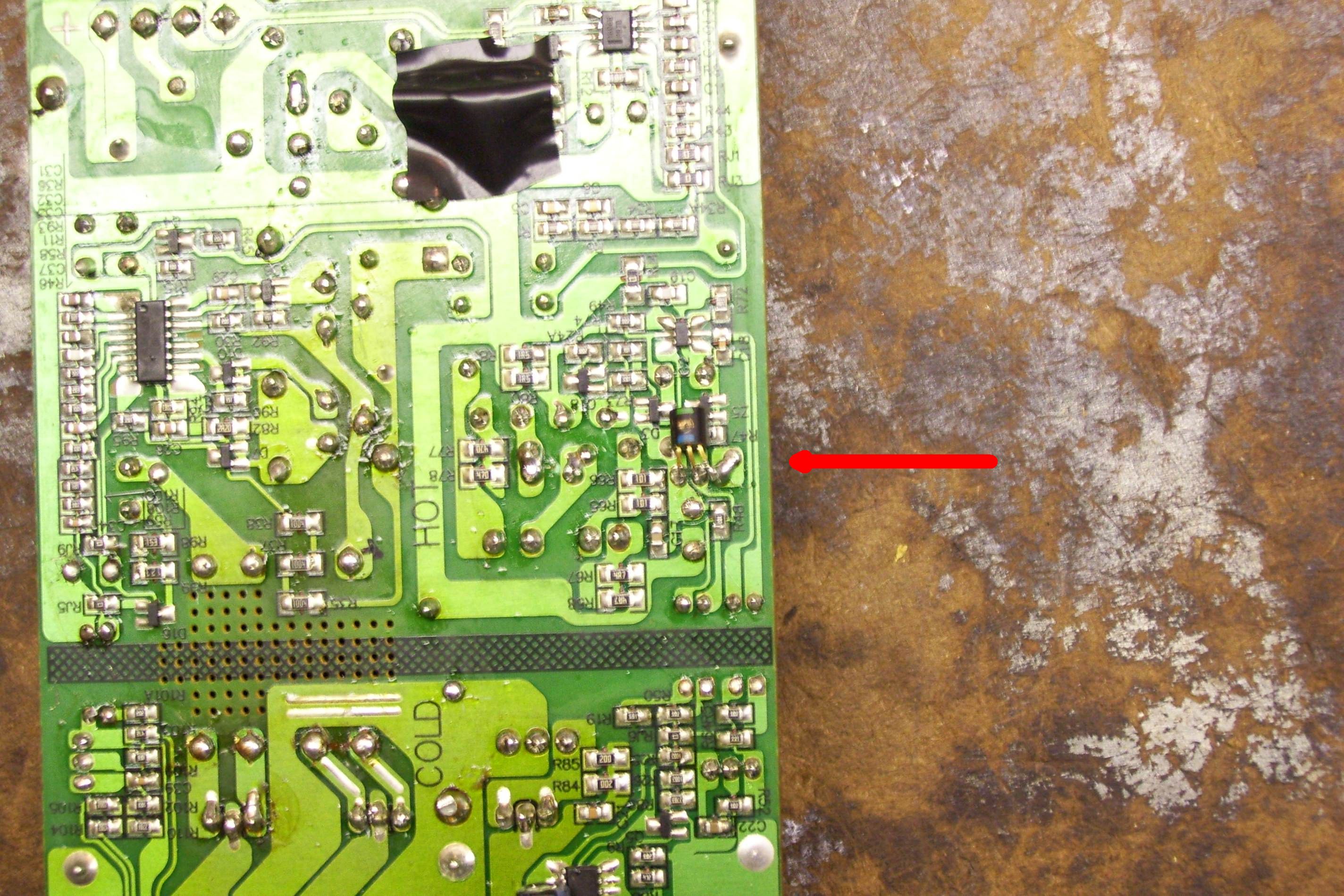

    Maybe cold solder joint or something shorting out but in the end I replaced one switching Transistor 2n4401 (Q8) which is connected to the opto-isolaters and it works great now.
    I am out of desoldering wick so I just clipped the leads of the old transistor and soldered the new transistor on the bottom of the board
    Meter was no help reading the transistor voltage as the on off cycle was too fast for the
    Meter to stabilize. So I figured it might be bad and gave it a shot
    Hope this info might help someone in the future

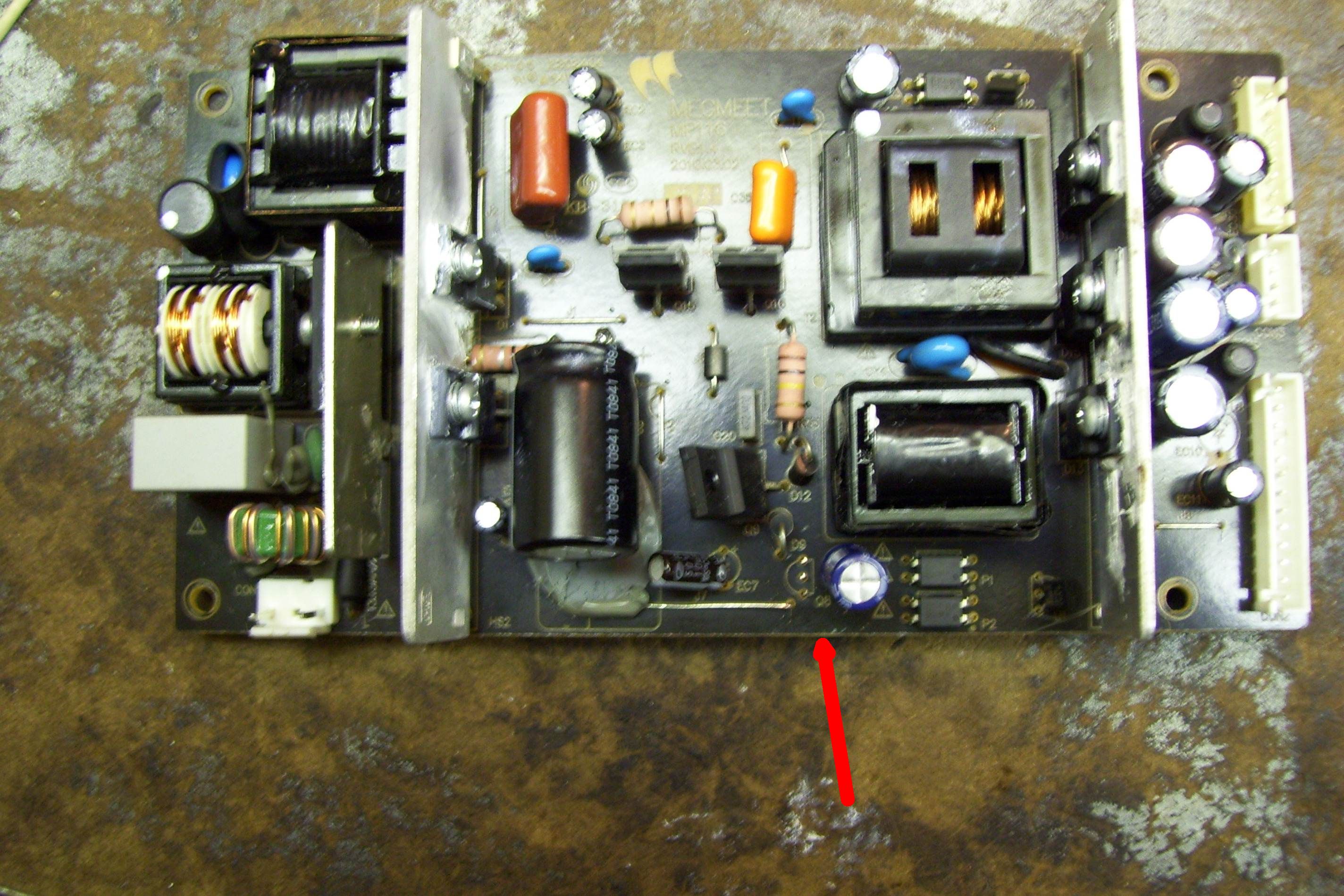

              Yo have two startup caps, the EC7 black, and the blue one to the right of the transistor that should be replaced or check the capacitance and the ESR.
              You can also heat up those two caps with hair dryer for a few minutes to see if the Voltage will become normal.

                          I had the same problem again after a nasty brown-out so I did what bdm suggested and replaced the blue (or black on my power board)100uf 35v capacitor (next to the transistor in question)with a better quality cap and it's back to normal again. Yesterday, another savage brown-out and the TV's fine. Another thing I noticed with my tv is that I no longer have to point the remote straight on at the censor to operate, now that I have replaced the suspect caps and transistor. Yeh! I hope all this helps with everyone that is having problem
                          s with this particular power board model. Good luck.

                            Any one can supply good clear pictures of the top and the bottom side of the board so I can figure out what the function of that transistor is?
                            There are many version of this model MP116.
                            The MP116A, that transistor is the switch for supplying the B+ to run the PFC and the 24V power supply when PS_ON is applied to the board.

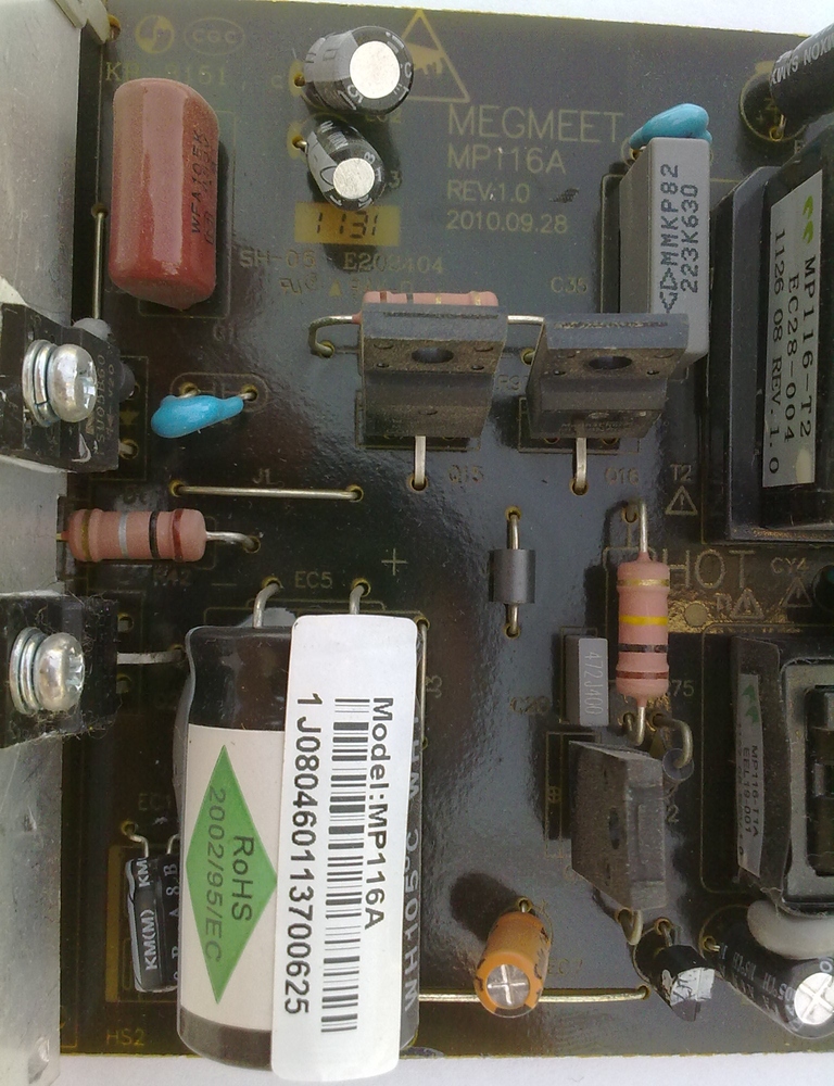

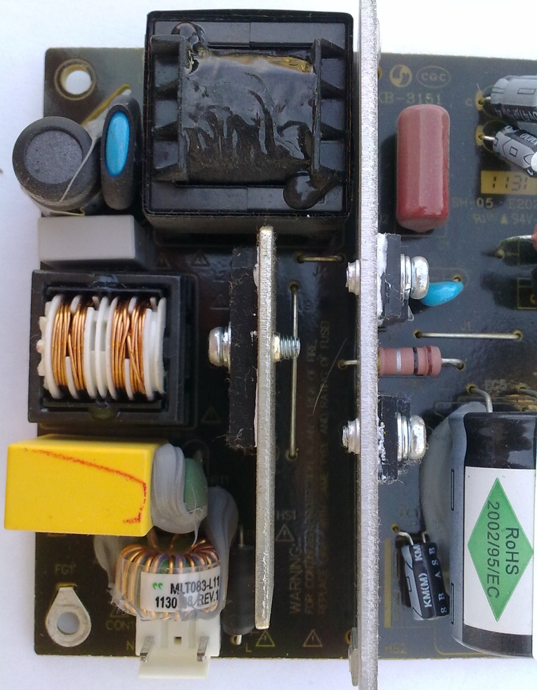

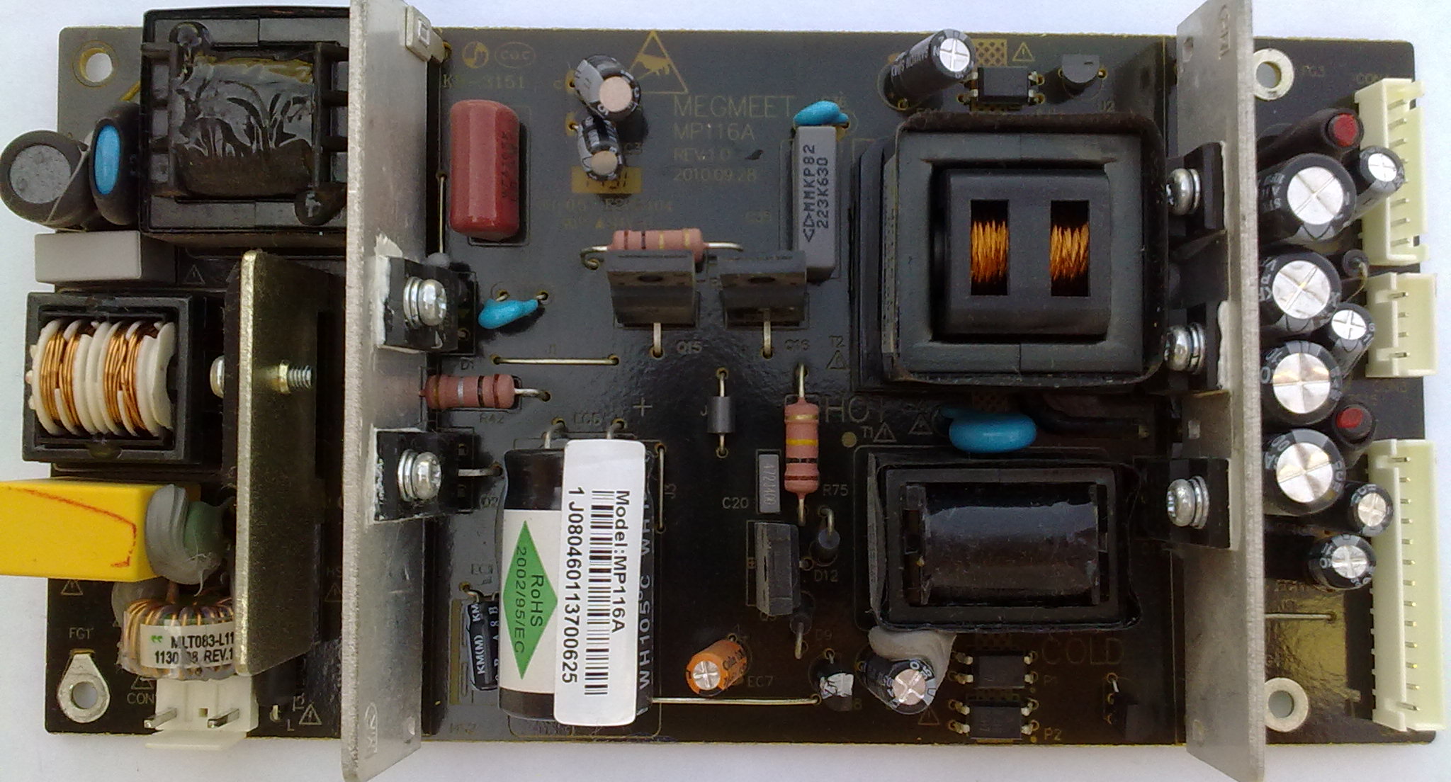

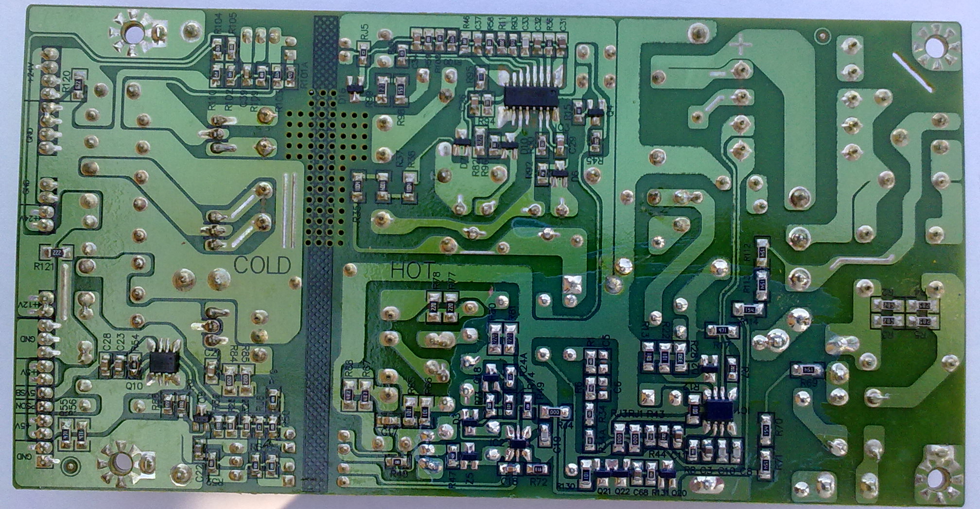

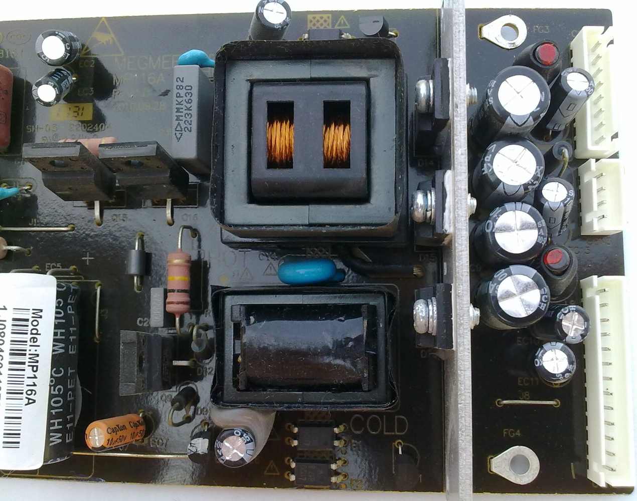

                                        Here's the Megmeet MP116A, Rev 1.0, 2010/09/28:
                                        (I don't know why the forum ruins the links to the large images, so here they are plainly: top, bottom, left, middle, right.)
                                        On the top, U1 and U2 are AZ431 (adjustable shunt regulator).
                                        On the bottom, IC1 is probably NCP1606B PFC controller from On semi. The unlabled 16 pin IC is ST L6599D high-voltage resonant controller. There's also IC2 which is a small 6 pin one, and Q10 which is 8 pin and reads ...(6?)3652.
                                        Another top view of a very slightly different MP116A board (date code 1147, above it's 1131), from this thread:
                                        https://www.badcaps.net/forum/attach...8&d=1381571466
                                        The model, revision, and date are the same, but there are minor differences, like the presence of C68 at the bottom, or a place for D17 below the output capacitors.
