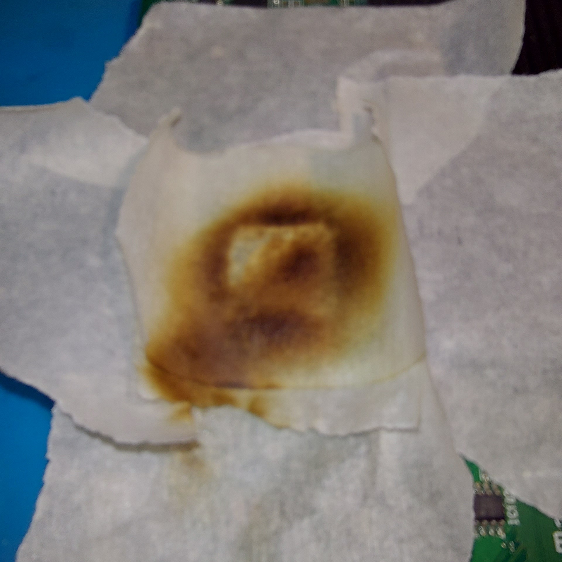

        Originally posted by Diah
        i would sugust with out... but if you like to use it try use high pressure cold air to let it go via the chip down side
        Hey Diah.....I followed your original instruction rather than over complicate things using flux. I used what we call masking tape and heated up the said chip what felt like ages...see attached.....maybe not long enough but started to worry a little, unfortunately no difference.
        • Diah
          • Feb 2013
          • 6460
          #64
          Originally posted by Longon
          Click image for larger version  Name:	20250917_224402.jpg Views:	0 Size:	665.5 KB ID:	3727890
          this is nothings... heat not enough or time of heating are short... the whole should bean near to black color

            OK I'll be a little more aggressive this time.....just was unsure whether to continue. learning as I go...

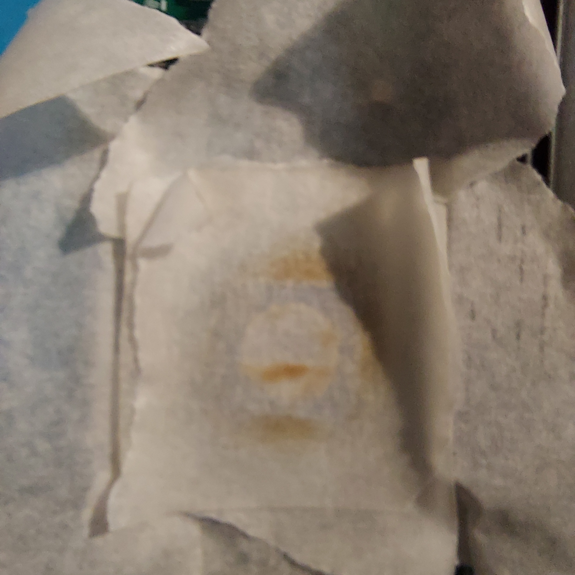

              #66
              Attempt no.2........was there for so long my arm nearly fell asleep!! The temperature was not directly under the heat gun but close by..going to give it 30 min and I'll retry.

                #67
                Hi Diah..............Still no change matey!!

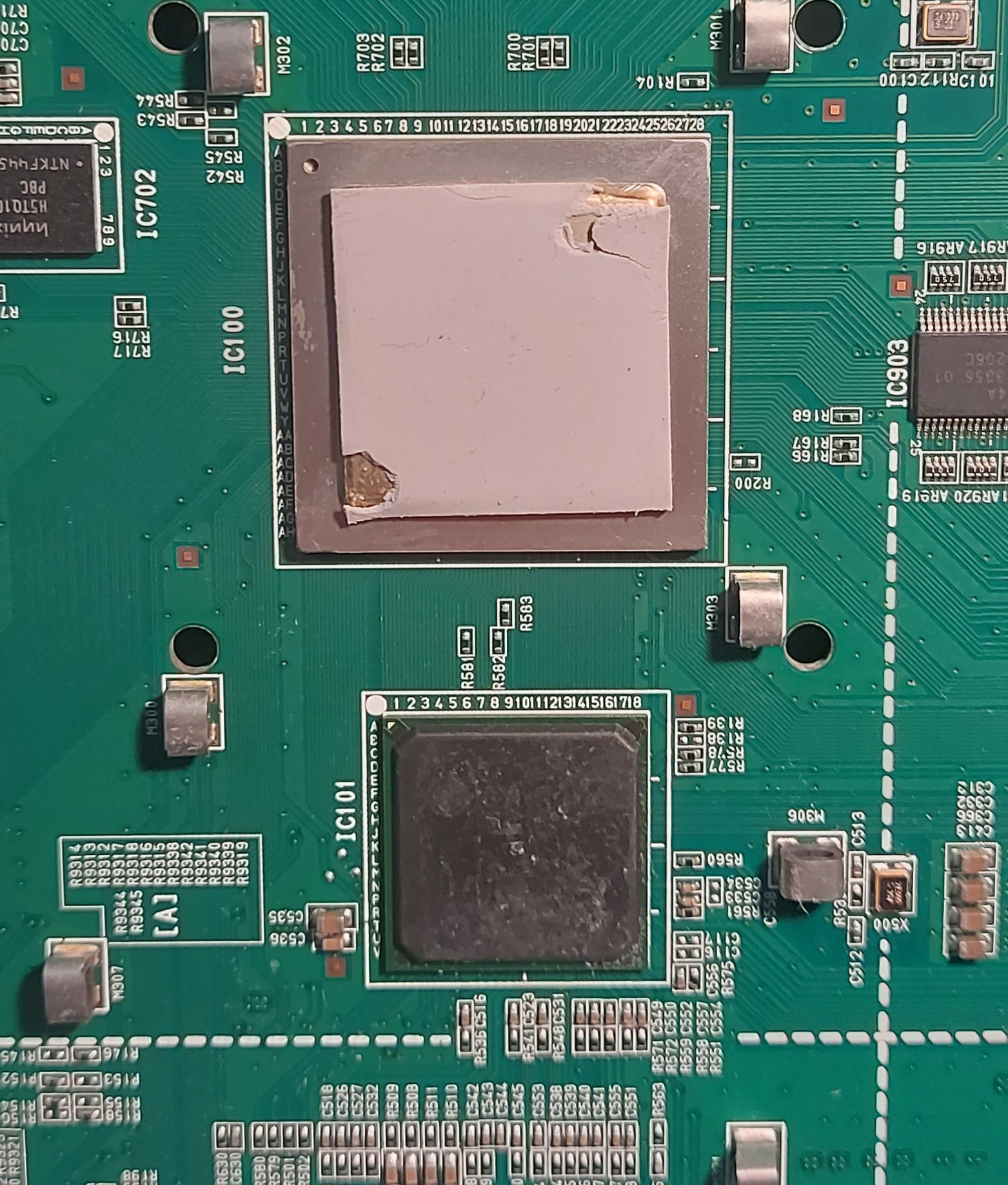

                    #69
                    Hi Diah.......Shall I do as before on both IC 100 and 101..? or just main SoC?
                    Long Click image for larger version

                      #70
                      ic 100 only

                        #71
                        Diah....After reflowing the ic 100 there's still no change here matey....
