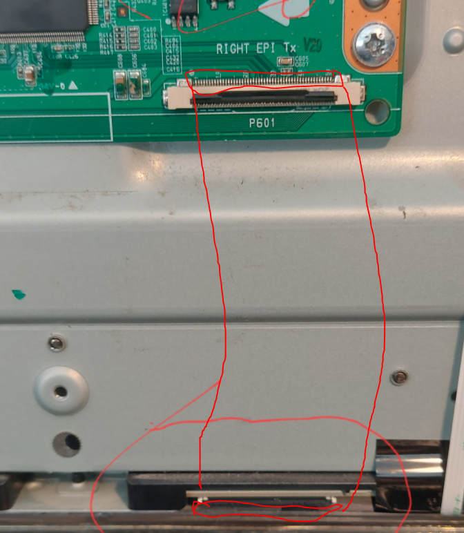

    Not quite sure what you mean matey?
    See attached confirming where the issue is..

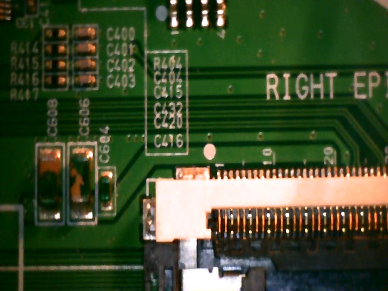

      Each connector has contacts on the other side (which are soldered to the board) and there is a numbering of each output, insert the cable and use a multimeter (on the continuity tester) to check each line, that is, one probe on the T-CON connector, the second probe on the connector (on the soldering side) of the buffer bar, and you continuity test each line with a multimeter, moving the probes to each contact (1pin.- 1pin., 2pin.- 2pin., 3pin.- 3pin.,..........) and do the same between the motherboard and T-CON.
      • Davi.p
        Hobbist Tech
        • Sep 2009
        • 4498
        • Italy - Milan
        For shure it has not to be like so, therefore simply try to pry those pins back to the original position using a needle , it's very kindly not touching well the cable side..

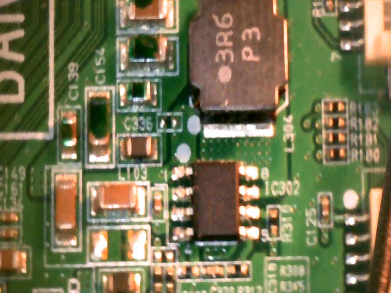

          Put pins back, checked lvds and ribbons for continuity all ok-replaced and still no change. led's still working ok, tried other inputs hdmi nothing changed!
          I began checking generally again in and around IC 302 and various caps associated seems that there maybe a problem with.....does this IC and buck converter have any affect or is this totally seperate. I compared to other power supplies and IC 300/3 are simular resistance and V but totally different to 302!!!

          Also I'm only getting 0.3 v caps 604/6/8 and 5/7 1.8 v...are these correct?

            IC 302
            pin 1-0v
            2-11.5
            3-0
            4-0.8
            5-0.75
            6-3.3
            7-1.04
            8-1.04
            and caps 139/154/332/329/131 just around 1 v.........Do these sound OK as am unsure but doesn't seem right...

              If T-CON sees any faults (low resistance or short circuit) on the output voltages for the panel, it blocks them, disconnect one cable from T-CON and the panel (from the T-CON side) and turn on the TV and see what's wrong with the image, then reconnect the cable and disconnect the second one and also check the image (the image will appear on at least half of the screen).

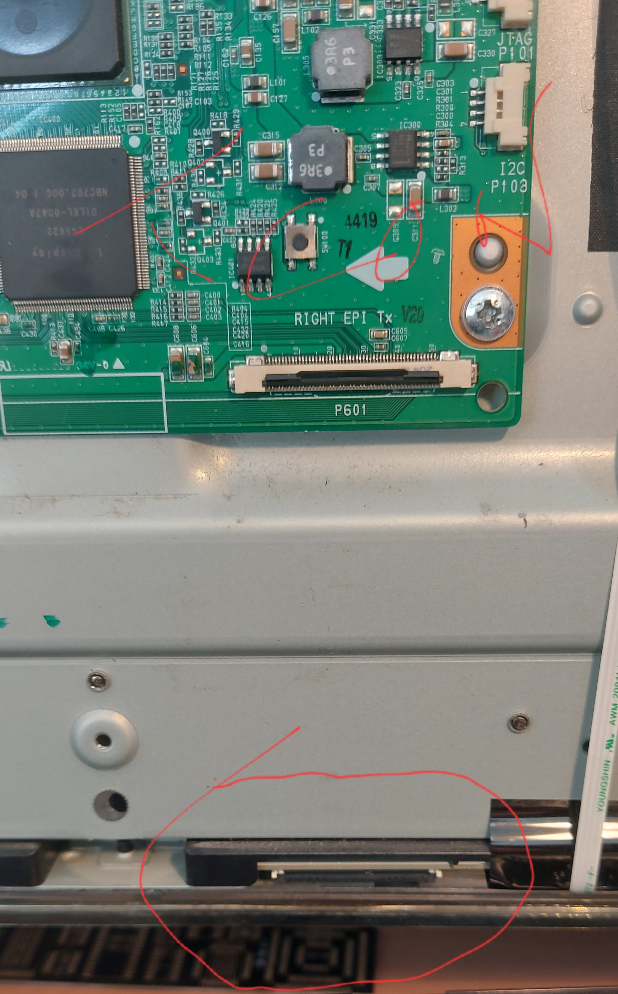

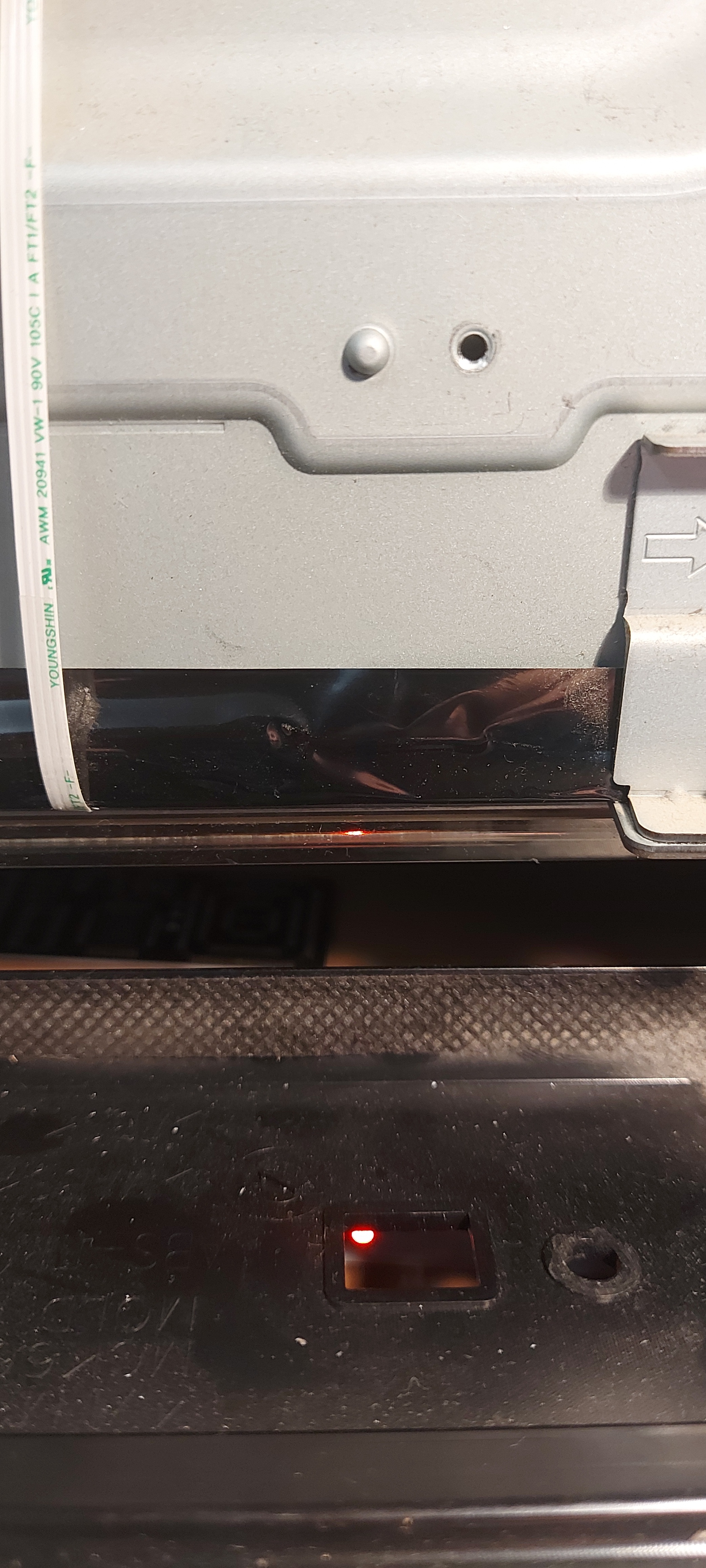

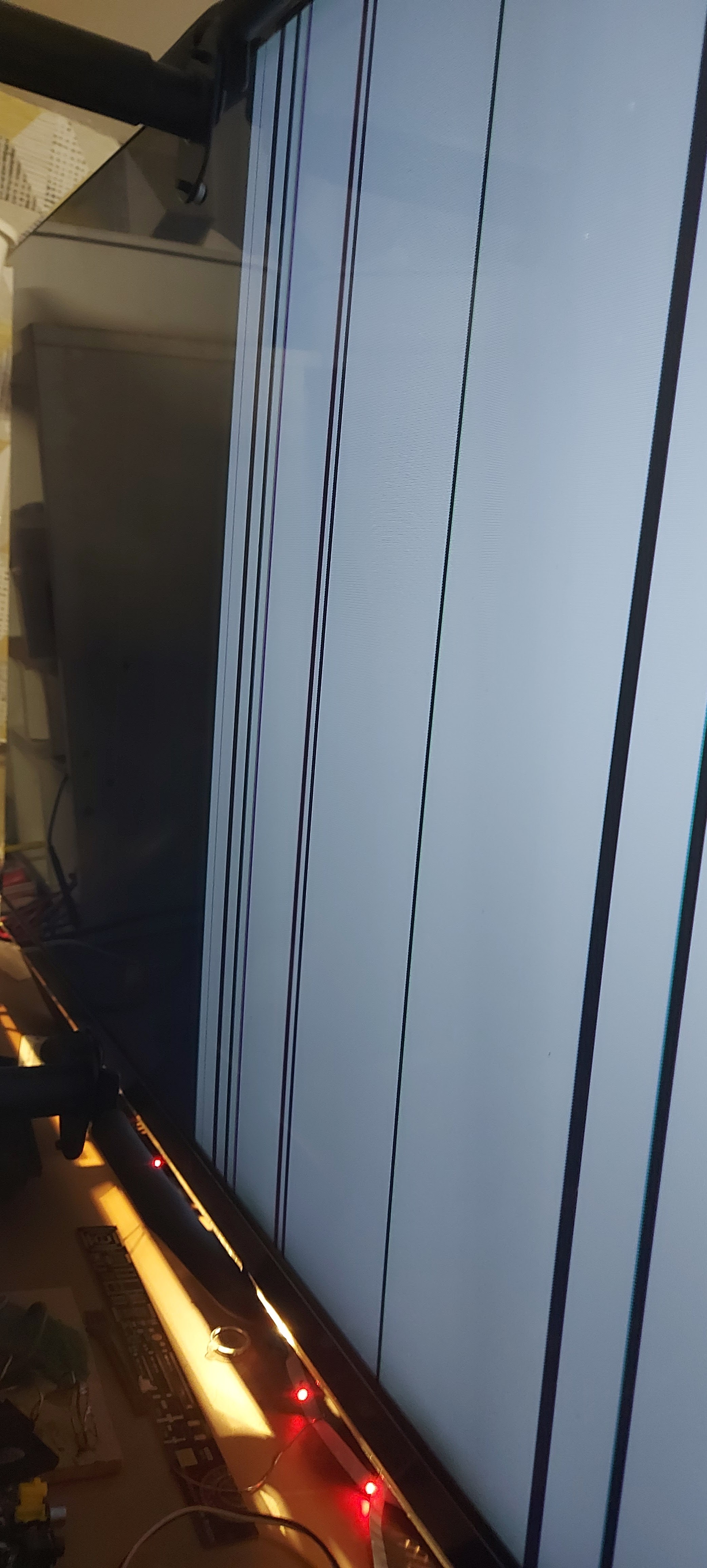

                Hi L....Pic 1 is after removing left ribbon from T-con and pic 2, the right! This supposed to happen?
                Long Click image for larger version
ID:	3717916 Click image for larger version

                  Originally posted by Davi.p
                  Ok now i understood the first post, i would bet more on a damage of main board than the tcon board, if you do the panel test then you can find better the fault, now i wonder why you changed cables and which one you mean, the tcon output side or input? The worst scenario is the output one as you probably fried a Cof, in the best of cases you burned one small cap on screen strip boards
                  Hi D......Sorry for delay in responding.
                  If I need to check the Cof or caps I've never delved that far into checking these components. They are taped down quite well and is there anything I should be aware of whilst removing and inspecting except for being extra careful as don't want to cause any further damage anywhere!
                  Where should I also test on the main board as you mentioned doing a panel test..to be honest I can't quite remember with any certainty which of the cables I changed at the time whilst the TV was still powered but I suspect it was the ribbon on the T-con side!

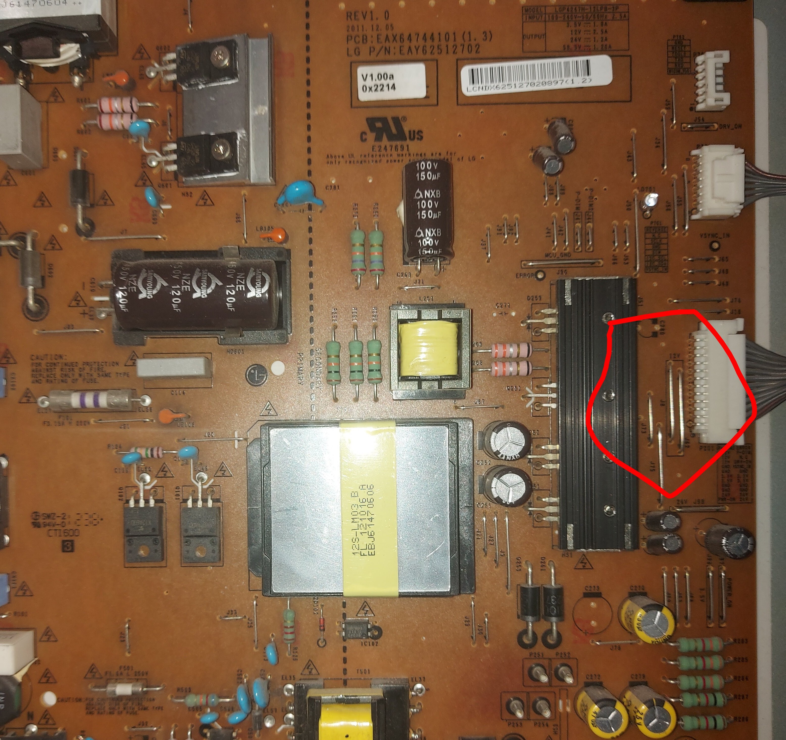

                                    Rather than make a mistake and feeding in AC I put in a DC 12v and nothing happened!!
                                    Can you advise where I should jump 12v from and to on attached photo...so confident I'm doing correctly..

                                      the board has an output connector to the main board, it surely has a contact for 12v, you can solder a wire under

                                        Hey there sorry for delay in responding....I finally found the time to action your advice. I used the jumper as my 12v and attached to the T-con and nothing!
                                        Was this correct as you asked?
