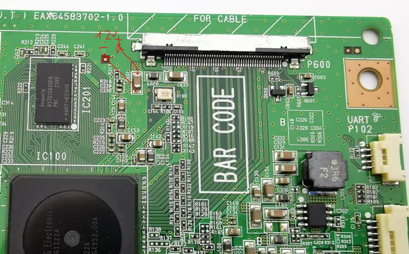

      If there was an image and when connecting the LVDS cable under voltage and installing the cable with a skew, then the fuse could have burned out, but I do not see it at the T-CON input, it may be at the LVDS output of the motherboard, check the voltage on this capacitor, it should be 12v.
              LG , LM series T-CON integrated at MB, no 12 V to Panel.. panel VCC walk arounr the panel self under the bezel side, any glass broken at Panel will damage the VCC rail and this i have 3 time found at LM series, one things more he didn't said any about the edge LED BG, they are with age of TV now time they will be over working time limited
                Again, you didn’t guess, and in your opinion, this isn’t a separate T-CON?

                      It will do, disconnect the LVDS cable from both sides (from the motherboard and from the t-con) and carefully inspect the contact pads under a magnifying glass for damage... (All this is done on a de-energized TV).

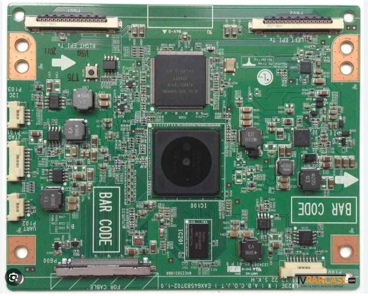

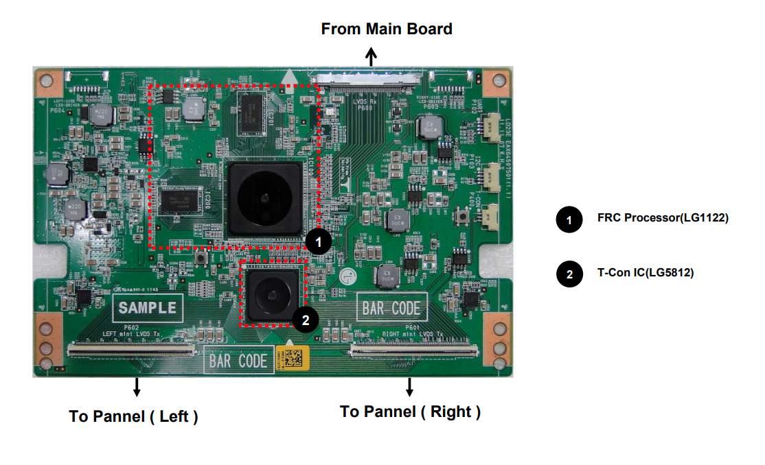

                                the SoC had GPU circuit. LM series as i said no external T-CON... the one Lotas upload photo of it aren't T-CON we do know.. if you have issue at edge LED backlight.. the GPU at MB will shutdown.
                                • lotas
                                  • Jan 2016
                                  • 4784
                                  • Russia
                                  It's a nightmare, I won't even argue! https://www.tvparts.co.uk/lcd-tv-spa...60v-zb-bekwljg
                                  • Diah
                                    • Feb 2013
                                    • 6460
                                    nothings nightmare.. this is early version of LM, later this GPU was included at MB. goes direct to Panel. point stop.

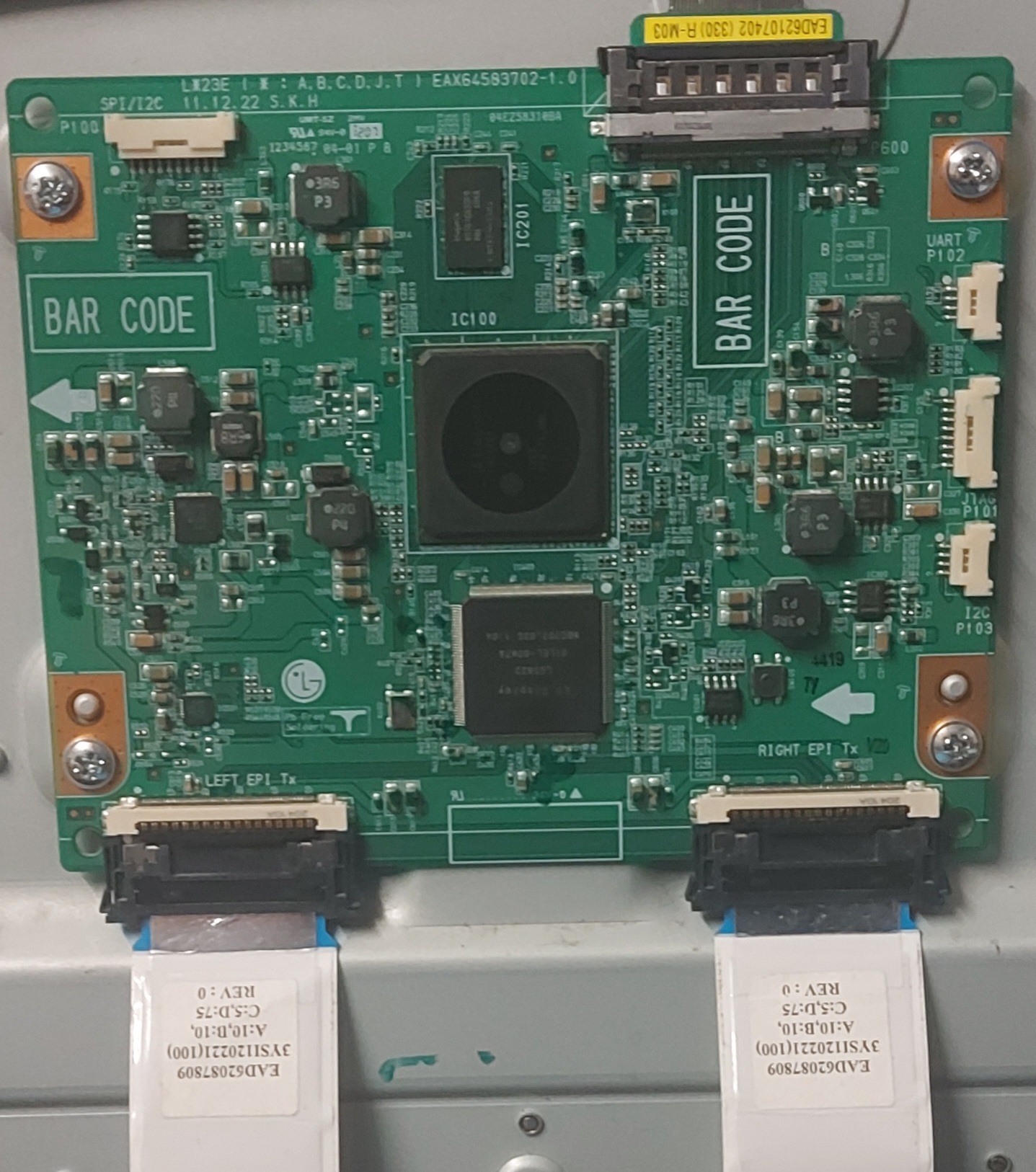

                                    • Longon
                                      • Jul 2025
                                      • 46
                                      • United Kingdom
                                      1
ID:	3715458 Click image for larger version
ID:	3715457 Click image for larger version
                                      pic 1-3

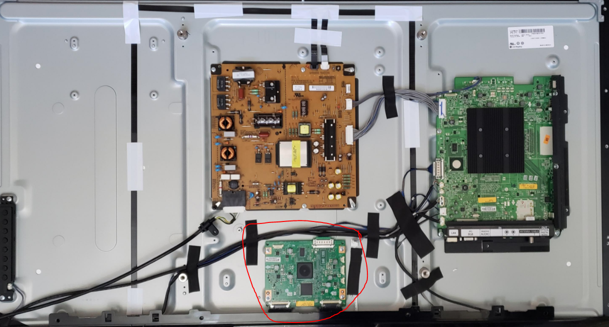

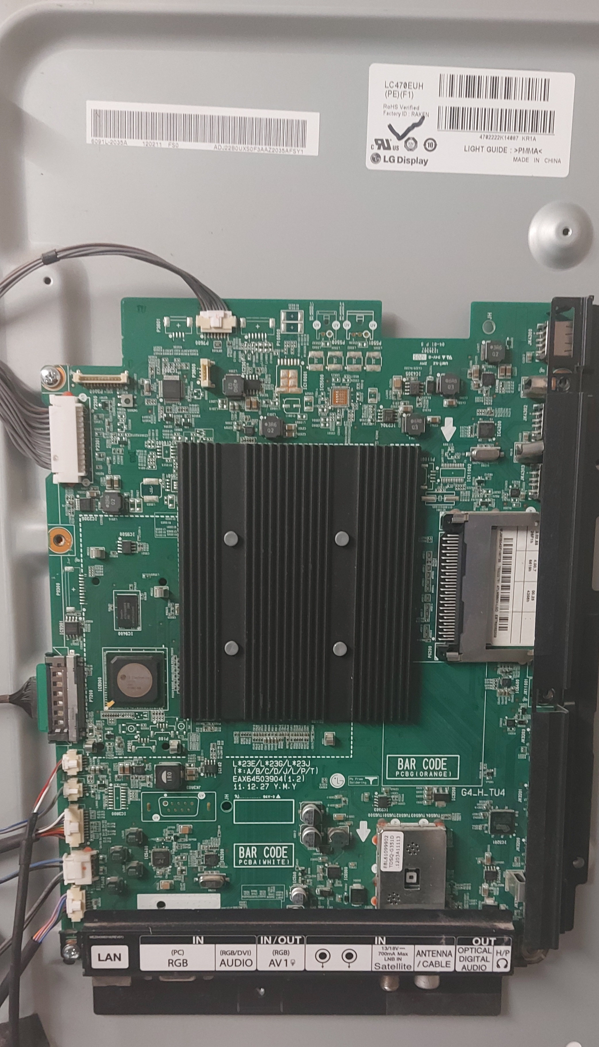

                                      Hi all......
                                      To save any confusion I've attached pics of my particular TV including PSU, Motherboard and T-con. I was in the process of removing the output ribbon 1 at a time...and this time i made sure that the power was off before moving anything. Attached is also where I originally taped over the ribbon to the left side off T-con output to remove slight vertical lines (little difficult to see on pic) which worked fine. Whilst viewing a little closer just in case of any damage which I hadn't noticed and then came across (pic 5) the right side input of CoF a couple of pins look strange!! I compared it to the other side which I presume would be identical and this is not the case.....Am not sure what to make of it..is this corrector or could it be part of the problem?
                                      Any ideas anyone?
                                      Cheers matey's
                                      Long

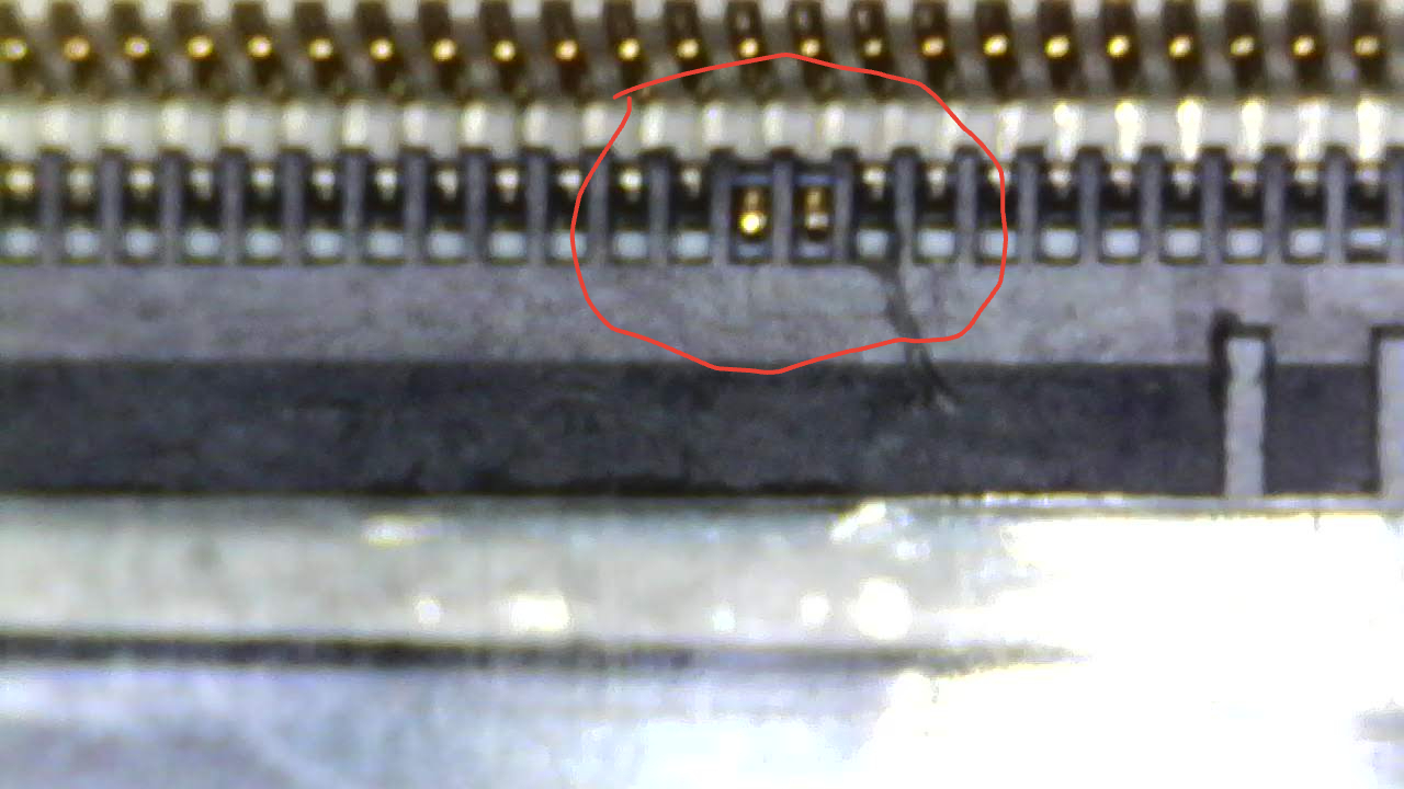

                                      (pic 4-5)
ID:	3715460 Click image for larger version

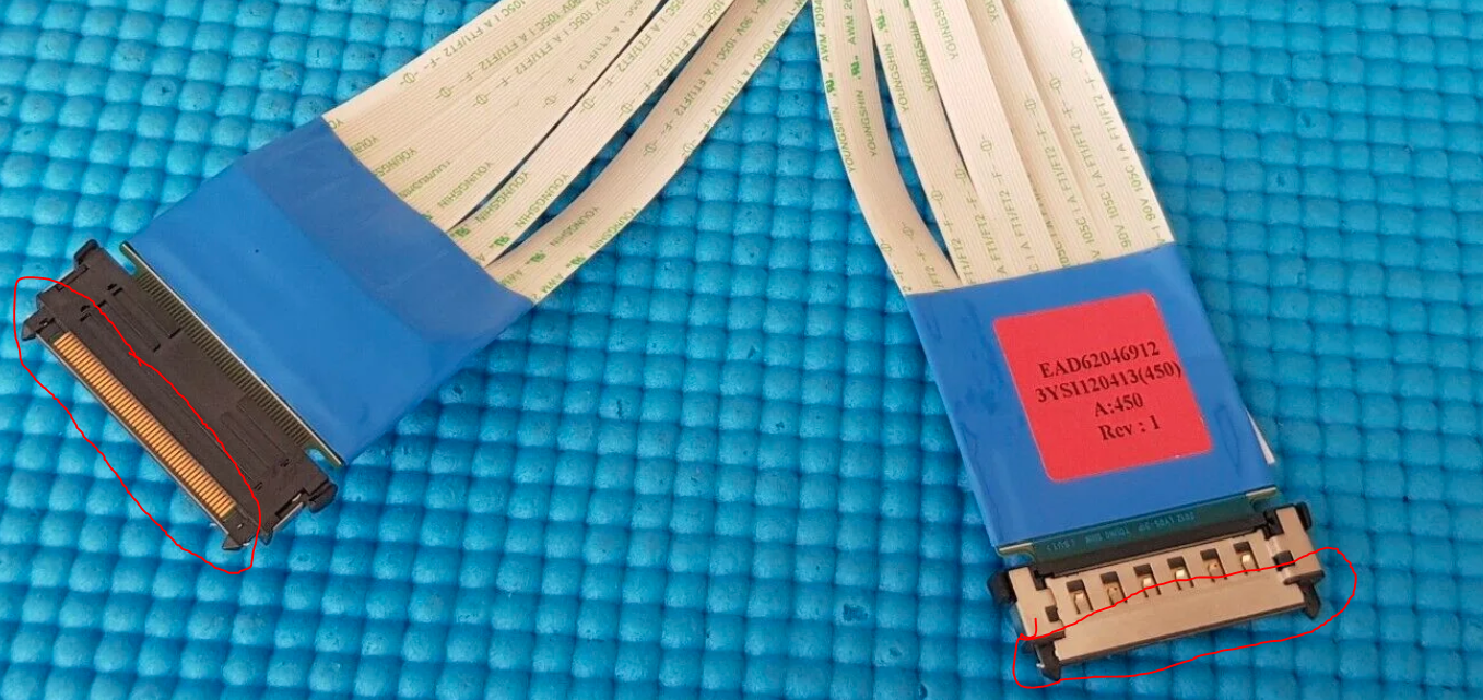

                                      • lotas
                                        • Jan 2016
                                        • 4784
                                        • Russia
                                        Yes, it could be a bad contact between the connector and the cable, insert the cable back from both sides, take a multimeter with thin needles on the probes and ring each line from the motherboard to T-CON.
