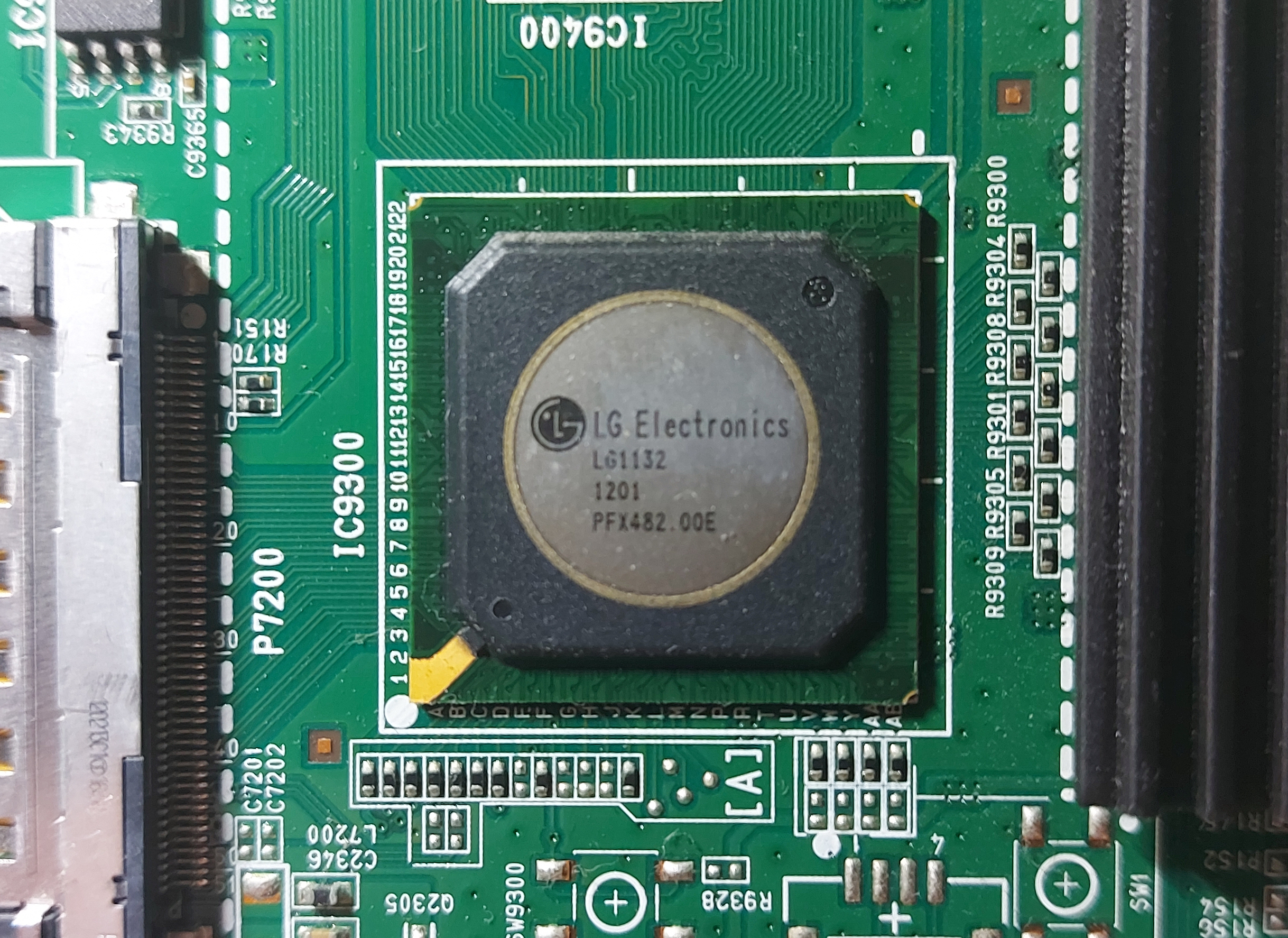

    Originally posted by Diah
    GPU could not tested panel in stand alone... yours issue at MB. if the panel buffer boards didn't suffer from liquid damage at buffer boardsb

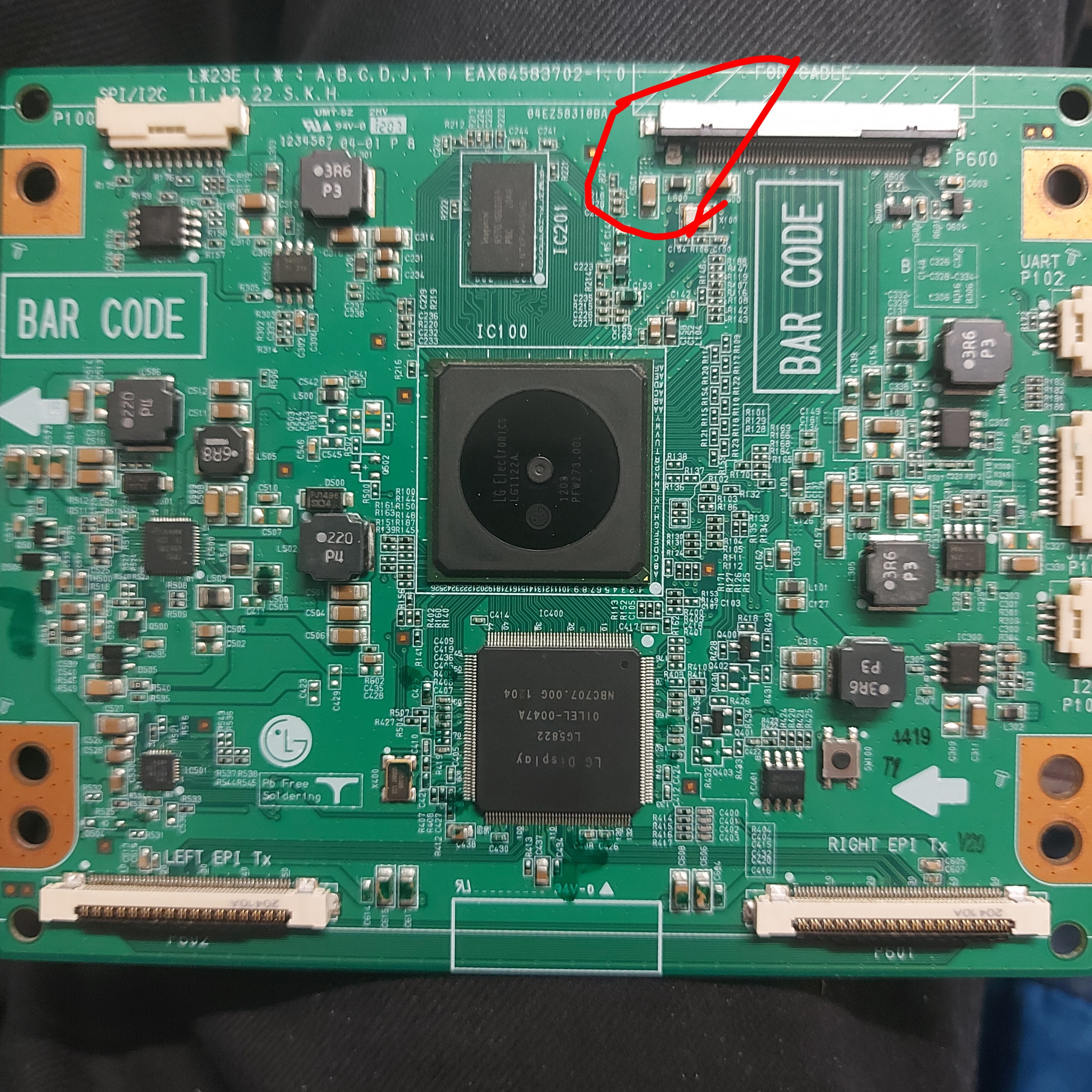

      on the tcon , near the input connector between 2 caps there is an inductance, small, check it both sides for voltage, i forgot to say it, where do you have soldered the 12v wire? in saw on fuse but there is no fuse so you had to use that inductance..

        again this non T-CON, this is GPU circuit of early LM series.. later they installed it at MB, this why you will not find any Fuse of 12V. cause its going with 3.3V line too to operate FRC.. answers from others ignore its just fantasy ... who knows when he have this early version and later under hist hand.
            Hey D....Is this the location of where you mentioned, I'm guessing you meant inductor (inductance) and not clear what you mean "in saw on fuse but there is no fuse so you had to use that inductance." There are no fuses on the T-con or main board as far as I can make out..
            I measured both ways and all I'm getting is a nominal 9.8mv
              yes its
              Hi Diah....Whats your feelings on this issue, as...if I'm correct, there seems to be a difference in opinion which I seem to be stuck in the middle!!

                      if the panel dint have any liquid damage on the buffer boards , then refllow the chip on MB IC9300

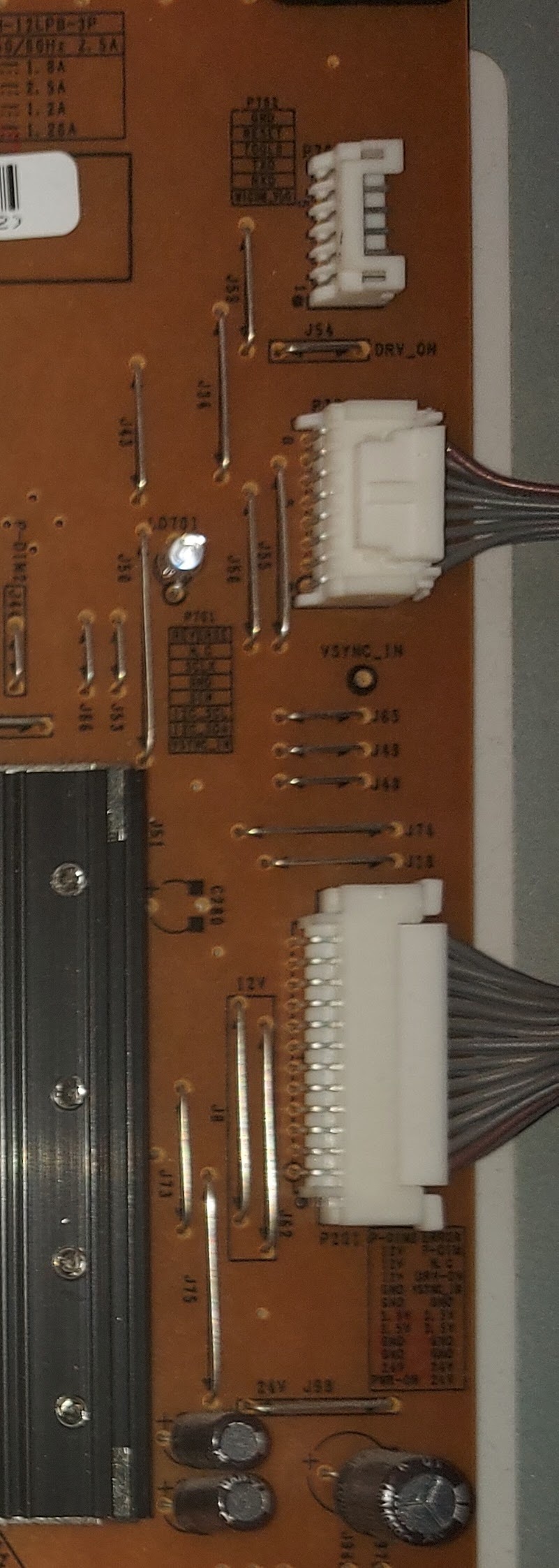

                        Sorry, the idiot who projected Android obliges me to the automatic corrector, i mean, the inductor it's maybe used instead as fuse and is toghether an inrush current limiter, i don't know, so in your screen stand alone test, where do you put the side of wire for injecting 12v to tcon? 9mv has no sense, i trust you do not see a thing so! I do not remeber my old post, but toghether with the jumping wiire to tcon you need also to do 2 jumpers on the power board to enable full on PSB and backlight, if you aren't able i tell you how, i need PSB output table schematic if there isn't
                        PS: jump 3,5v to PWR-ON and to DRV-ON

                          i don't want a schematic, only the pinout of connector..
                          what you show on the last pic is normal for lg screens, them don't show image if half connected, only bars, my opinion screen is ok but wait for the test
                            Davi... As requested pinout connectors. If you need anything else that I've missed then let me know.
                            Click image for larger version  Name:	20250910_220138.jpg Views:	0 Size:	325.4 KB ID:	3726463
                            With regards to....PS: jump 3,5v to PWR-ON and to DRV-ON, these already have a supply.....
                            and you say "enable full on PSB and backlight, if you aren't able i tell you how, i need PSB output table schematic if there isn't"
                            The backlight has always came on with no problems?
