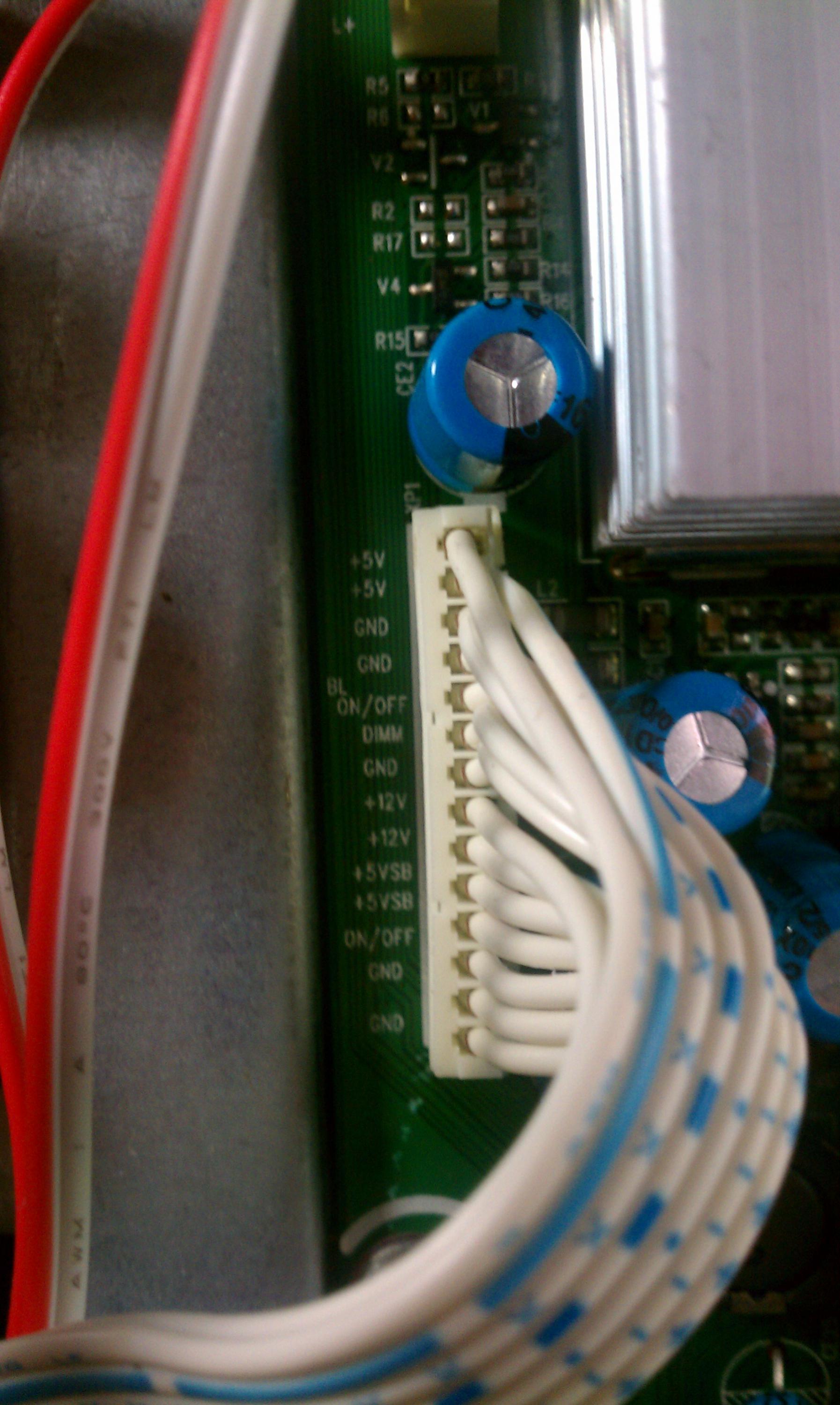

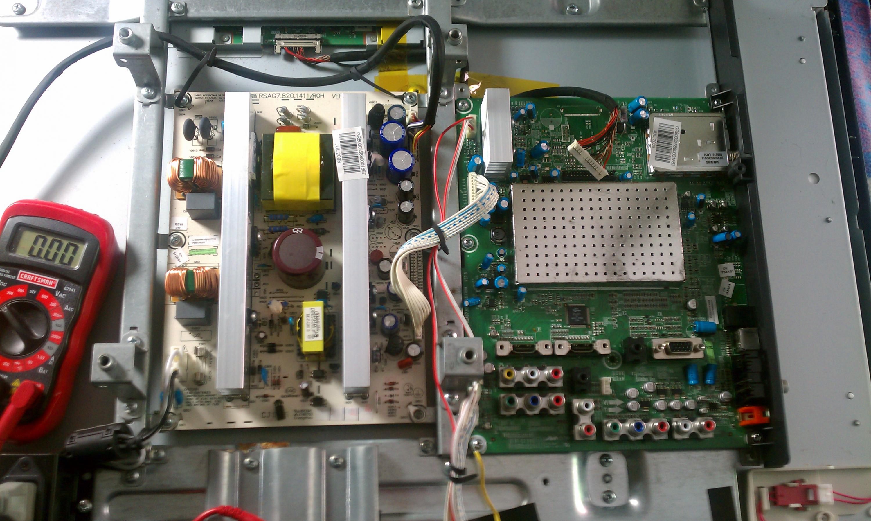

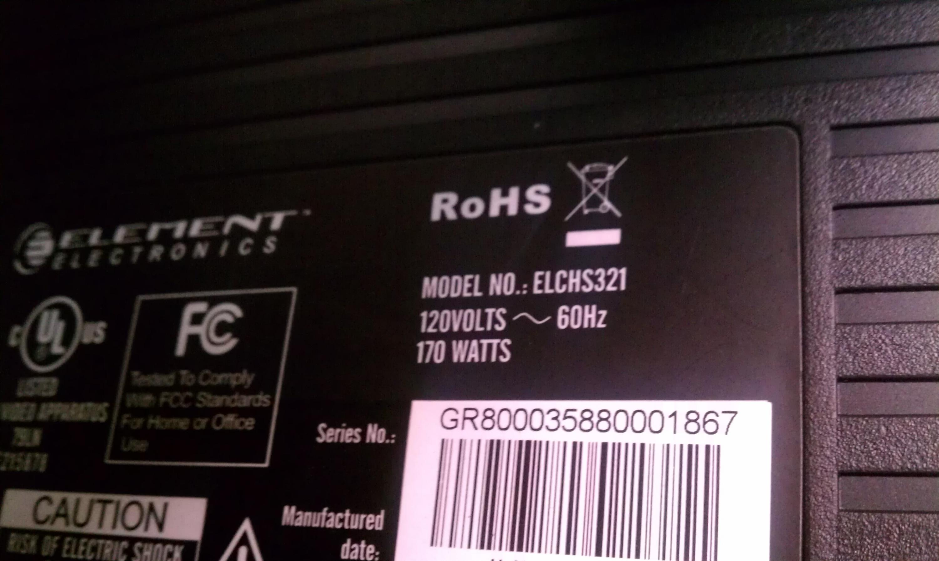

    got a Element ELCHS321 from the recycler yesterday for 10 bux.
    when plugged in i see the red LED and i can see 5vsb on the board
    but when i push power, nothing changes.
    heres some pics
    and the voltages on the connection from the PSU to the Mainboard
    pin/name/voltage
    1,+5v,0.83v
    2,+5v,0.83v
    3,gnd,0
    4,gnd,0
    5,bl-on/off,0.02v
    6,dimm,0.83v
    7,gnd,0
    8,+12v,3.2v
    9,+12v,3.2v
    10,+5vsb,5.14v
    11,+5vsb,5.14v
    12,on/off,3.87v
    13,gnd,0
    14,gnd,0
    i dont see any change in on/off or any pin for that matter when i push power button.

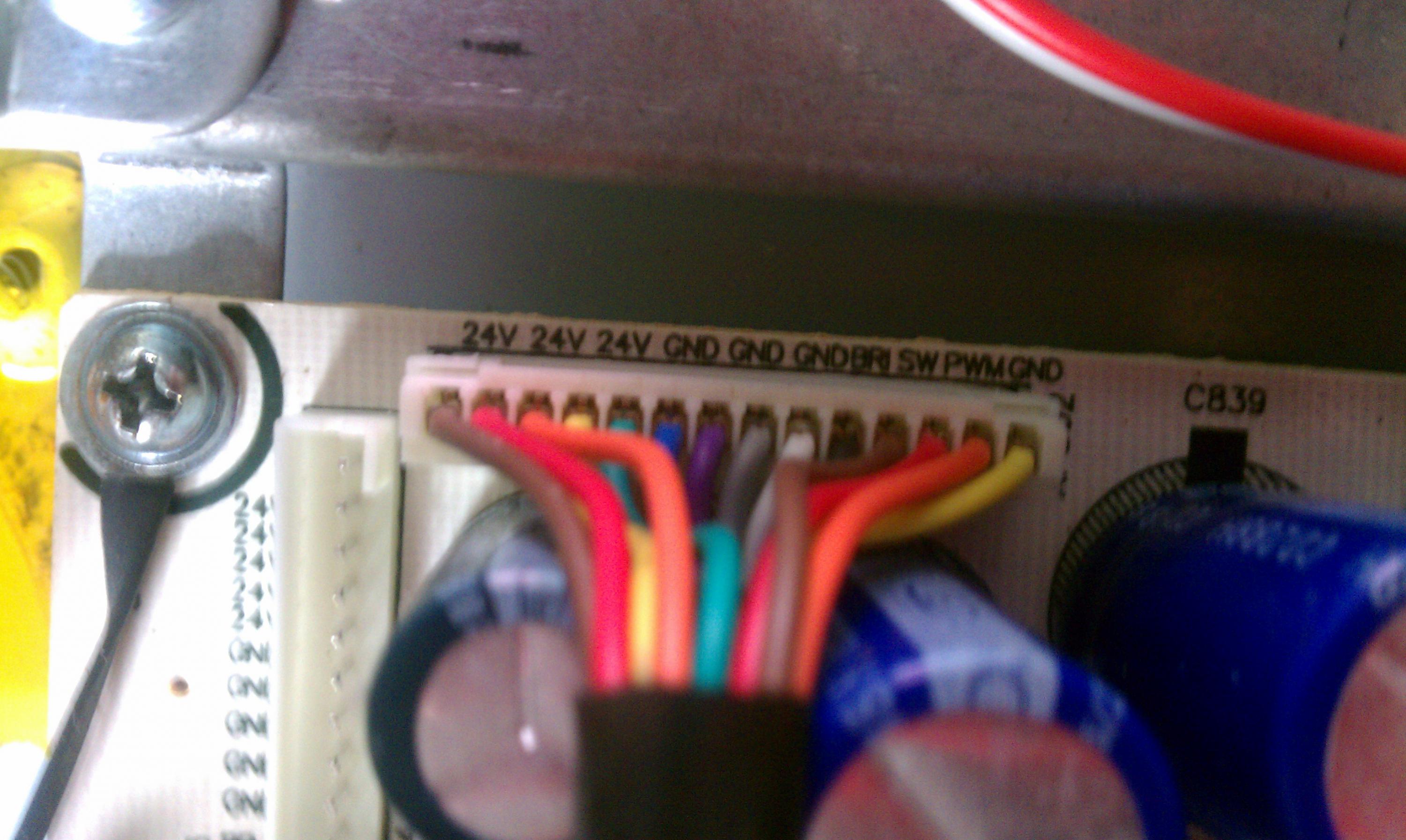

      Re: Element ELCHS321 has 5vsb and red light but wont turn on
      the connector to the inverter has 14 pins also
      the labels are kind of confusing as they dont label each pin individually
      but here are the readings i got on the pins
      1,4.93v
      2,4.93v
      3,4.93v
      4,4.93v
      5,4.93v
      6,0v
      7,0v
      8,0v
      9,0v
      10,0v
      11,0v BRI
      12,0.02v SW
      13,0.85v PWM
      14,0 GND
      seems like pin 1-5 are labeled 24v
      pins 6-11 are labeled ground
      but maybe pin 11 is BRI
      because after that there is
      only
      SW
      PWM
      GND

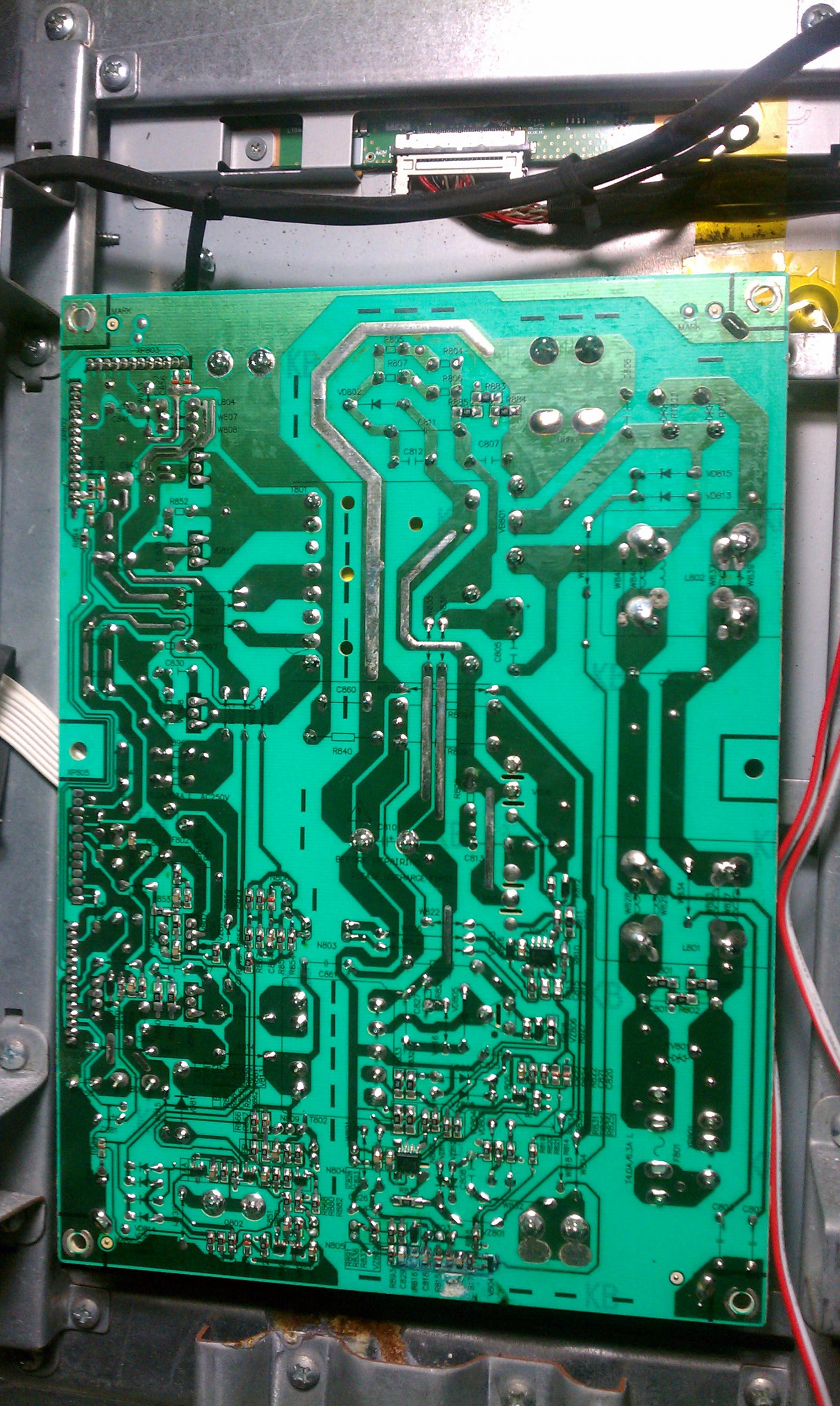

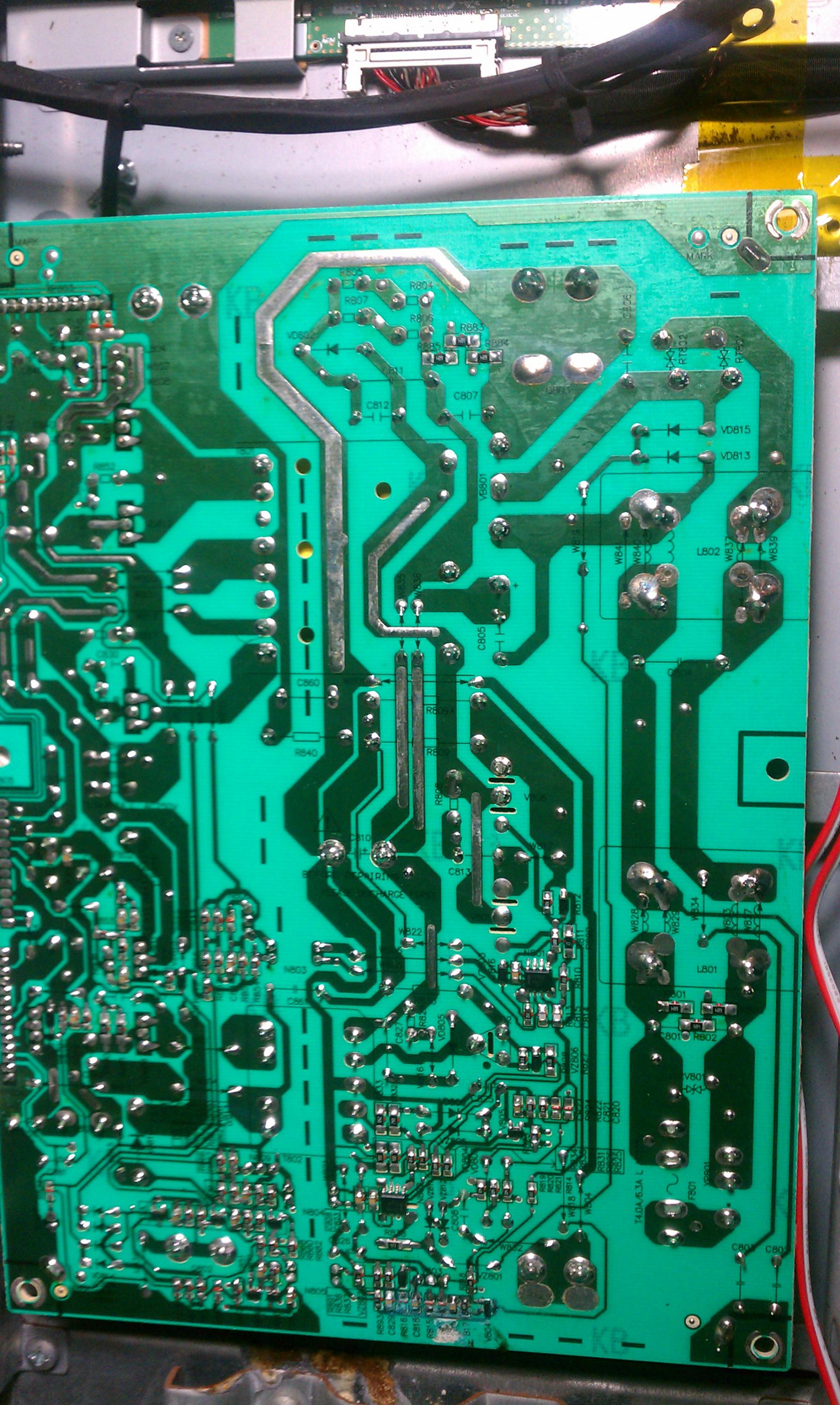

        heres some pictures of the back of the PSU...
        spooky, the main cap still has a charge of 120v after being unplugged for a couple minutes!
        i just checked again and it still has like 55v
        its been like 10 minutes!
        is that a sign of something wrong in the circuit? arent they supposed to discharge a lot faster?
        seems like they do on the other sets ive worked on...

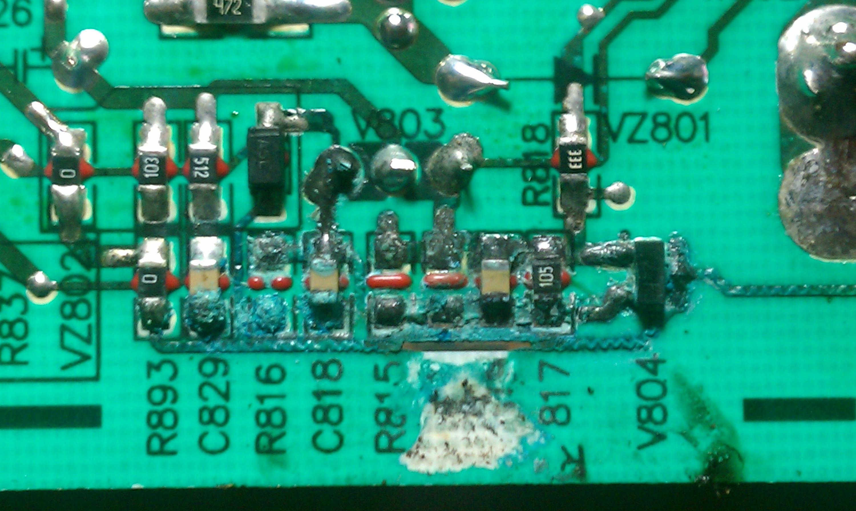

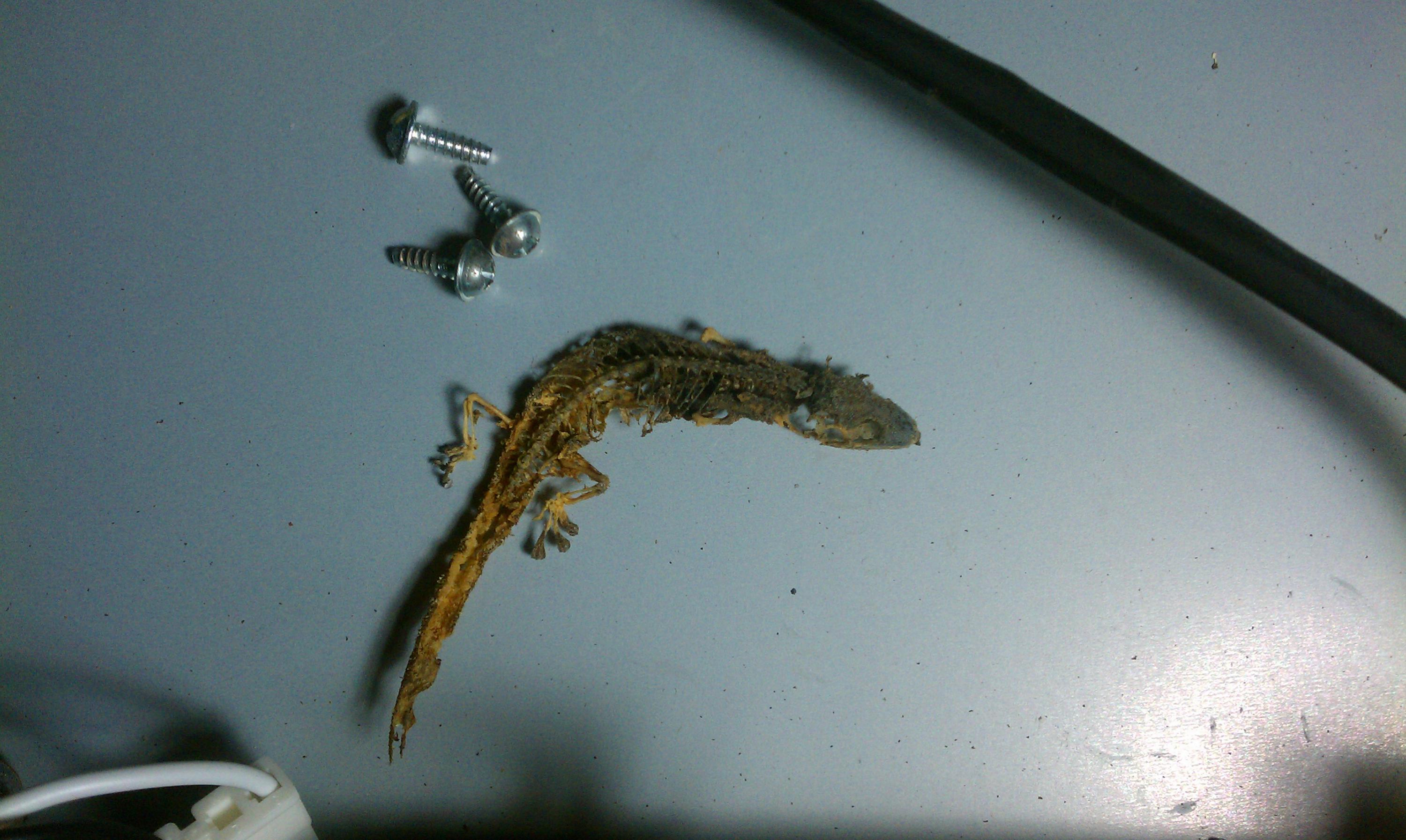

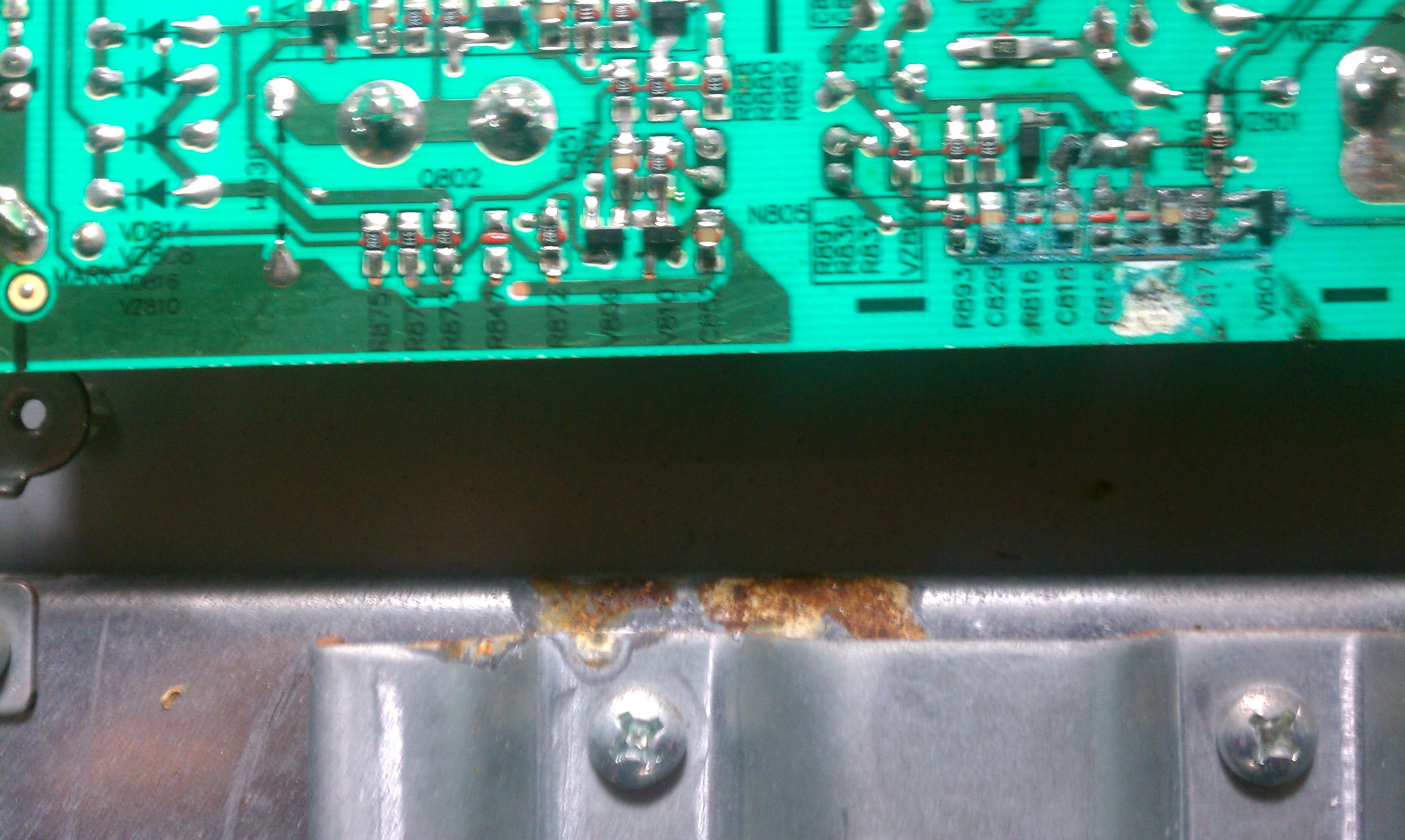

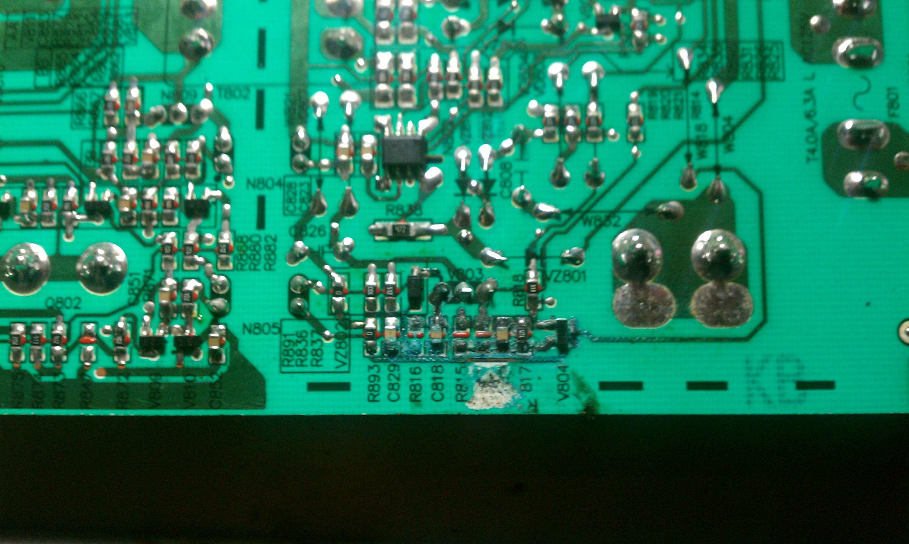

          well i think i found the problem!
          after i looked closer at the board i noticed that a gecko had gotten into the TV at some point and got fried under the PSU board and then fell down into the case.
          where he died you can see he rusted some of the case as he decomposed, and on the PCB where he must have initially got fried, theres a row of resistors that are all corroded, probably ruined.
          HAH! believe it or not this is not the first time ive seen this.
          pretty common in hawaii to have critters crawl up and die in electronics.
          i assume they find it when its off and think its a cool place to chill, and then when someone turns on the power, ZZZZZAAAAAPPPP!!!!
          can this type of thing be cleaned and fixed up, or do i just need a new board?
              1) So far the main board does send out PS_ON (12,on/off,3.87v) to the power supply board but the power supply is not putting out the 24V as needed by the inverter board.
              2) The main board is not sending out the BL_ON (5,bl-on/off,0.02v) (it is labeled as SW (same as BL_ON or Inverter ON) pin on the inverter board).
              Try disconnecting the cable from the power supply to the inverter board to see if the 24VDC will show up.
              11,0v BRI: Analog dimming control, not used.
              12,0.02v SW: BL_ON (same as Inverter ON).
              13,0.85v PWM: This inverter uses PWM Dimming control.
              14,0 GND
              The board looks badly corroded, did you check all the connectors and all the boards for more corrosion? Moisture damaged?

                    Clean up all the corroded traces and replace any if destroyed for a start
                      i dont see anything corroded except where the gecko got fried.
                      i tried disconnecting the inverter from the PSU and it didnt change anything.
                      i cleaned up the traces as best i can but no luck... how can i test those components to see which ones are fried? they are tiny SMT capacitors and resistors?

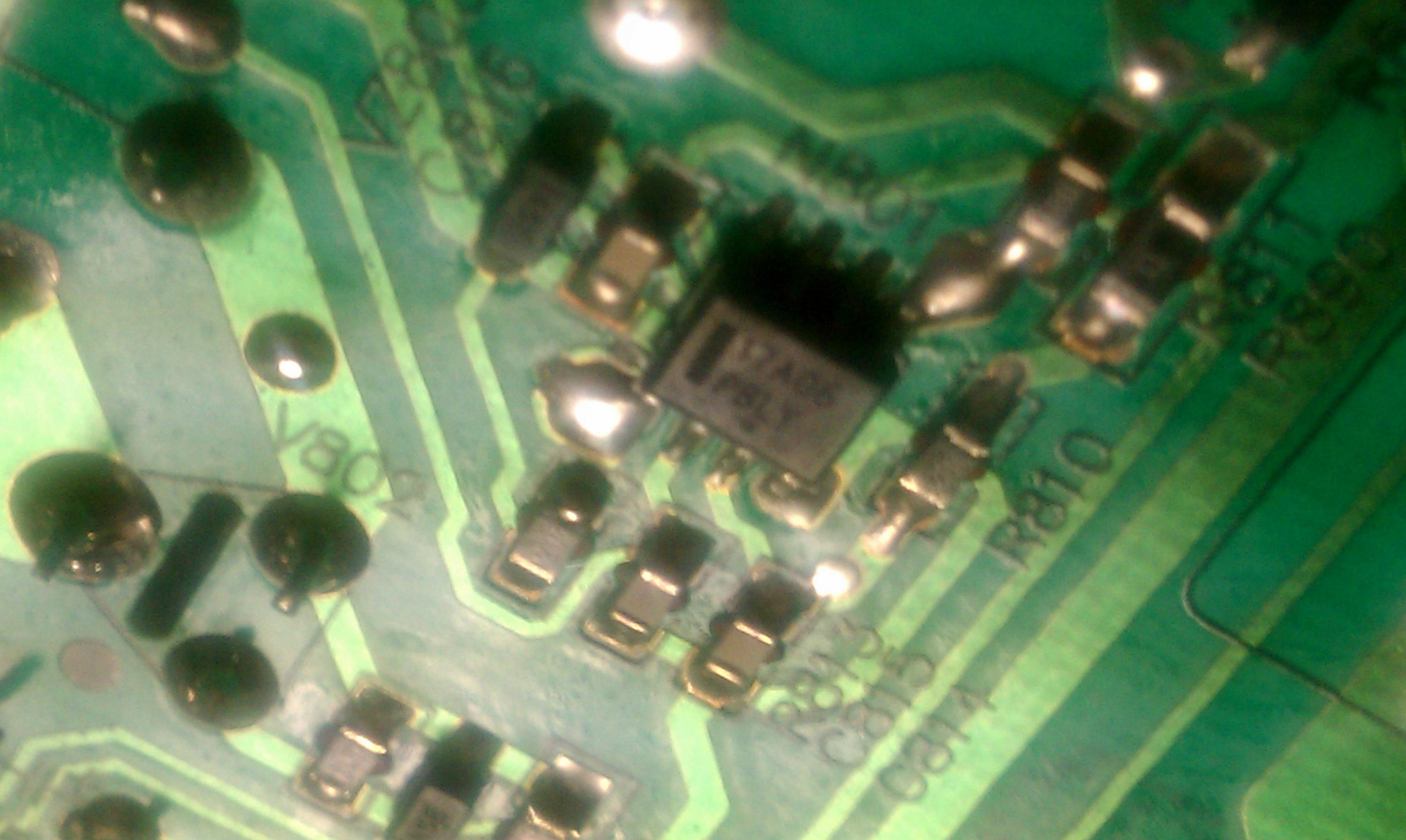

                        i do have 2 8 leg IC's on the underside... are these the mosfets you speak of?
                        what should i test on them?
                        Don't fear the repair...
                          ugh can someone please tell me what im doing wrong and why i can never seem to find the datasheet for anything?
                          1207A - nothing
                          PFLQ - nothing
                          17A06 - nothing
                          PBLY
                          what are the magic google terms?
                          i read all of mmartell's thread but i still dont really understand what i should be looking for. plus my board is different :/ still a noob
                          • triplefour
                            • May 2014
                            • 1747

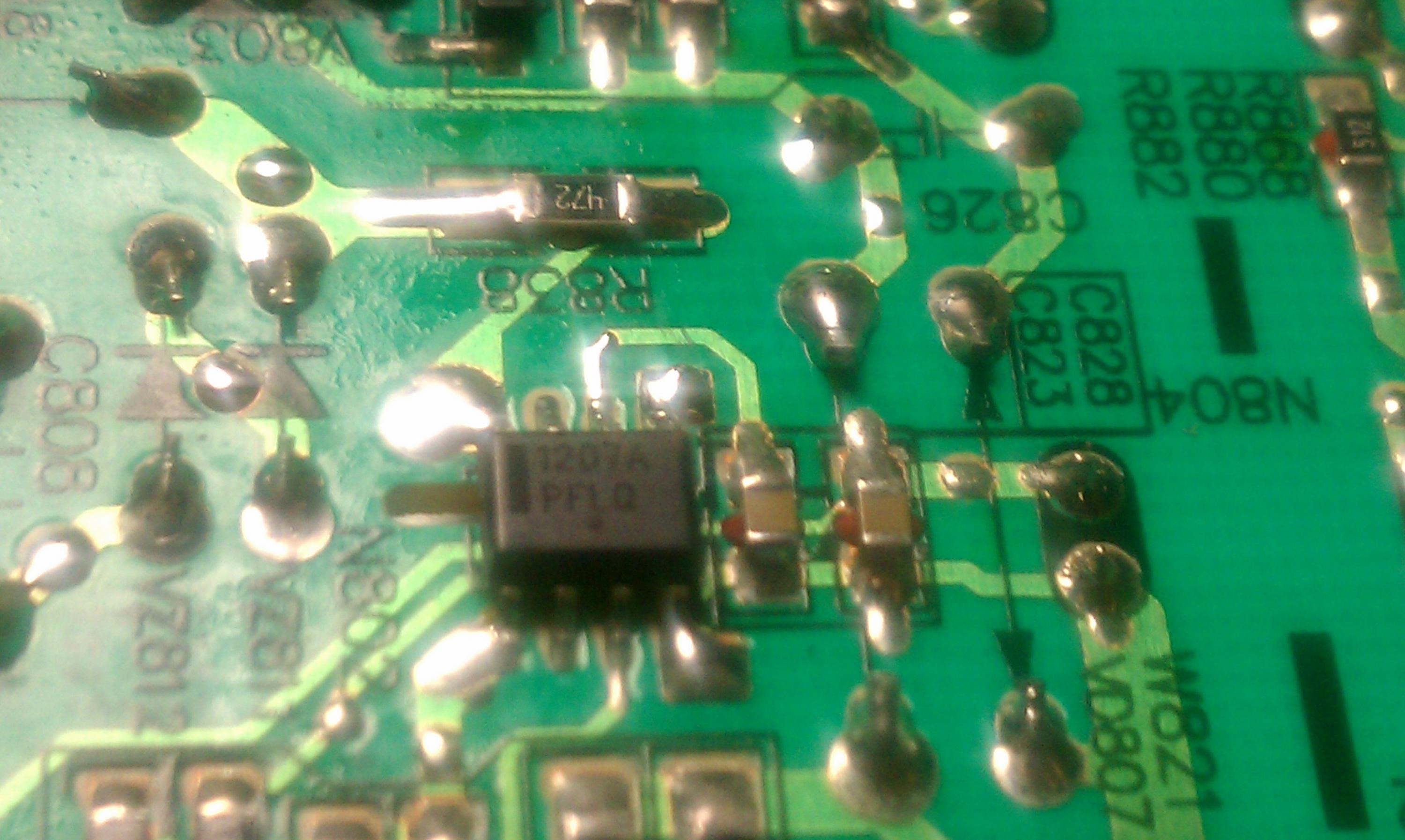

                            on the 1207A i see 150v on pin1 and 75v on pin 3 but 0 on all other pins.
                            all pins on 17A06 are zero as well...
                            and as usual, cant find a service manual...
                                    hmm now i see it in the results i got but i guess im supposed to know that its a pwm current mode controller... all the extra letters around it threw me off...
                                    NCP1207ADR2
                                    • triplefour
                                      • May 2014
                                      • 1747
                                      ok from the datasheet i now see that the voltages i was seeing were on the HV pin and the Vcc pin... but why am i getting zero on all the other pins, and on the 17A06?
                                      in mmartell's thread the IC was a mosfet with a S, D and G but mine is totally different... what am i supposed to look for here?
                                      • Agent24
                                        I see dead caps
                                        • Oct 2007
                                        • 5084
                                        • New Zealand
                                        Do you have a scope? You could check for a drive waveform on pin 5. Also check feedback pin to see if it's not causing a shutdown.
                                        If the other IC has no power, find out where it gets power from, it may be it gets switched via something else or the fact it has no power is a clue to the fault
