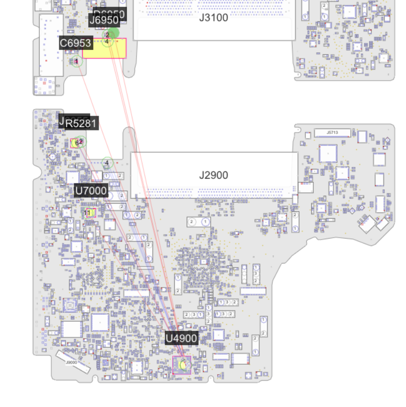

    Hey! how are you guys? i wonder if you could help me with this macbook 820-2936 that does not turn on. (Doesn't have green/orange light).
    History:
    this macbook came for a short on C6990 that blows D6990 and R6990 on his way. i re-placed the componets and it work again.
    A month later comes back again and has the actual problem (no green/orange light and dont turn on)
    The macbook can turn on with only the battery connected but in fact, dosent charge.

    isl 625 (U7000):
    (CHGR_AGATE) pin 1 = 0v
    (CHGR_DCIN) pin 2 = 19.4v

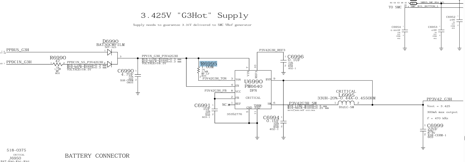

    PP3V42_G3H = 3.3v
    >> Start with this one, it should be 3v42.
    What is the input voltage to this regulator?
    Then, remove all power. Check the resistance of the feedback resistors used by this regulator. Do not power on while checking resistance and do not power on if these parts are removed.

      i'm sorry. i was measuring with my cheap multimeter
      PP3V42_G3H = 3.44v
      PPBUS_G3H = some times get 12.22 and 12.55
      input voltaje on U6990 (3.425V "G3Hot" Supply)
      from D6990 PPVIN_G3H_P3V42G3H to pin 7 of U6990
      PIN 7 (VIN) = 19.77v
      R6990 = 46.5 Ohms
      R69951 = 0.85 Mohm
