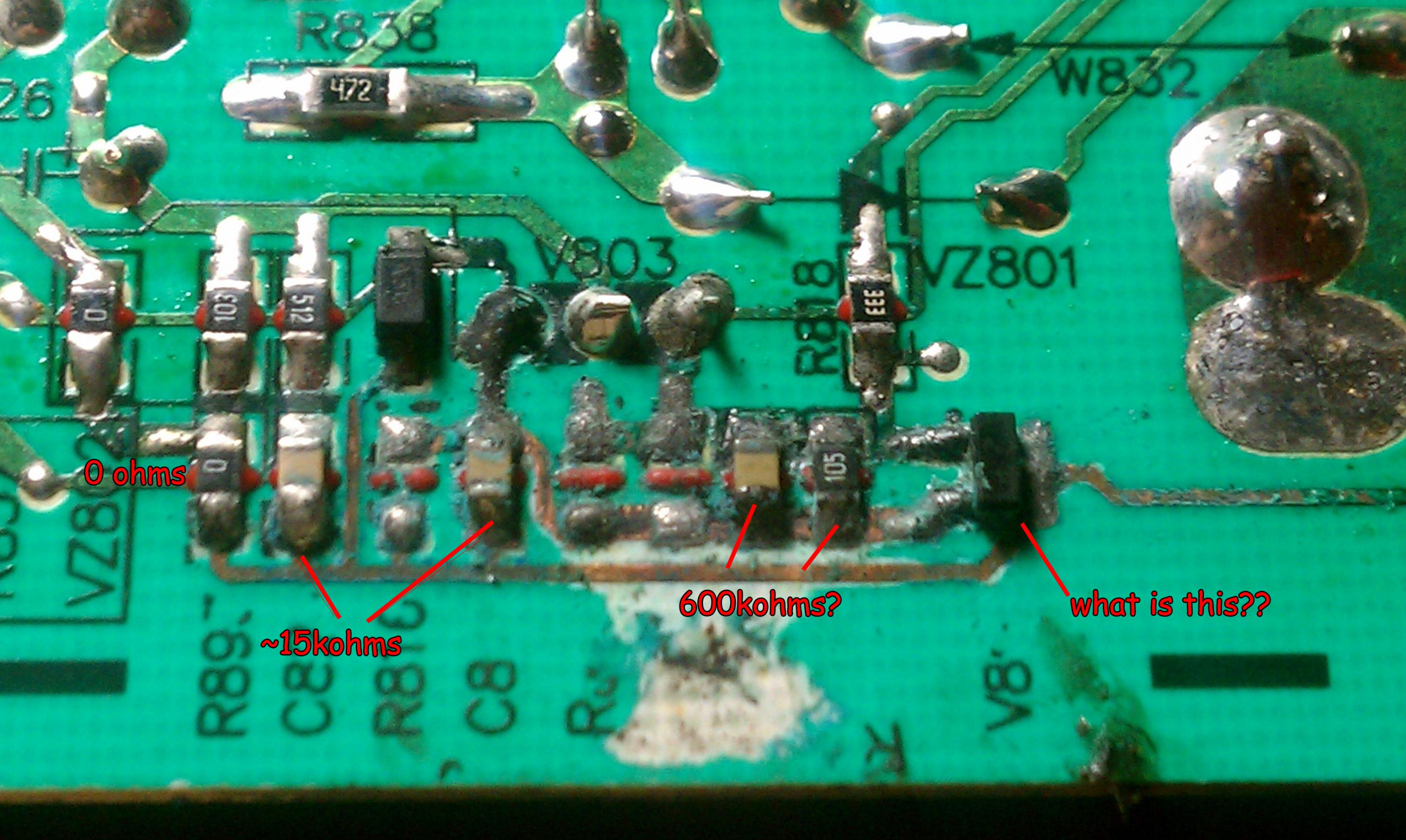

    so i was trying to measure these smt components as best i can. the o resistor checks out at 0, the 2 ceramic caps on the left check out around 14-15kohms each but the resistor labeled 105 (whats that supposed to mean?)
    and the ceramic cap directly to the left of them both read crazy high ohms that jump around or keep growing until infinite.
    can i desolder these caps and test with my ESR?
    i never messed around with these tiny smt caps before

      Re: Element ELCHS321 has 5vsb and red light but wont turn on
      Clean that board up, man! Get yourself a toothbrush (preferably your wife's or girlfriends ) and some isopropyl alcohol and start scrubbing. Don't worry about the smd stuff yet.
      It looks from here like the leg of that mosfet is burnt but can't tell because of the condition of the board.

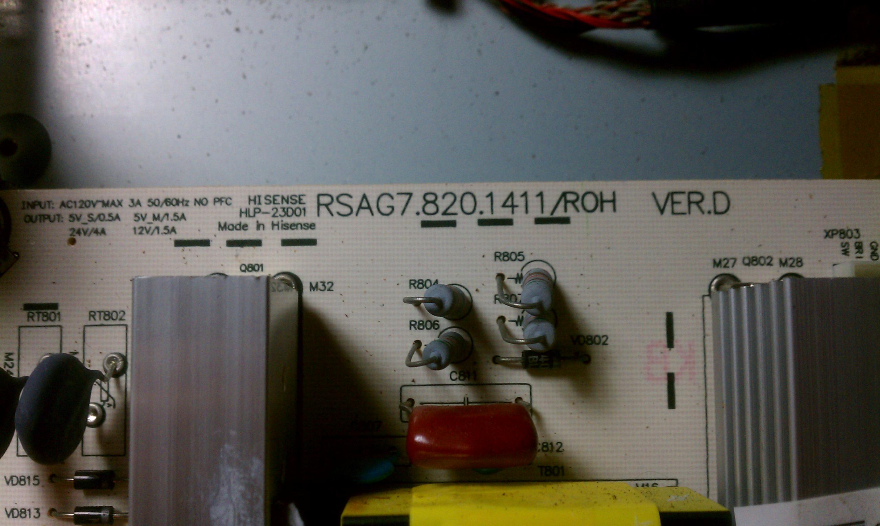

      And I thought my set was similar due to the model numbering but it's possible it's not anywhere near the same. Post a pic of the entire back of the set.
        wifes toothbrush...haha! no wonder tech's are single
        ok i cleaned it all up with the propyl
        and took another picture of the back, and the model numbers on my PSU...
        RSAG7.820.1411/R0H VER.D
        what next?
        typing "schematic" at the end of that in google didnt get me anywhere :/

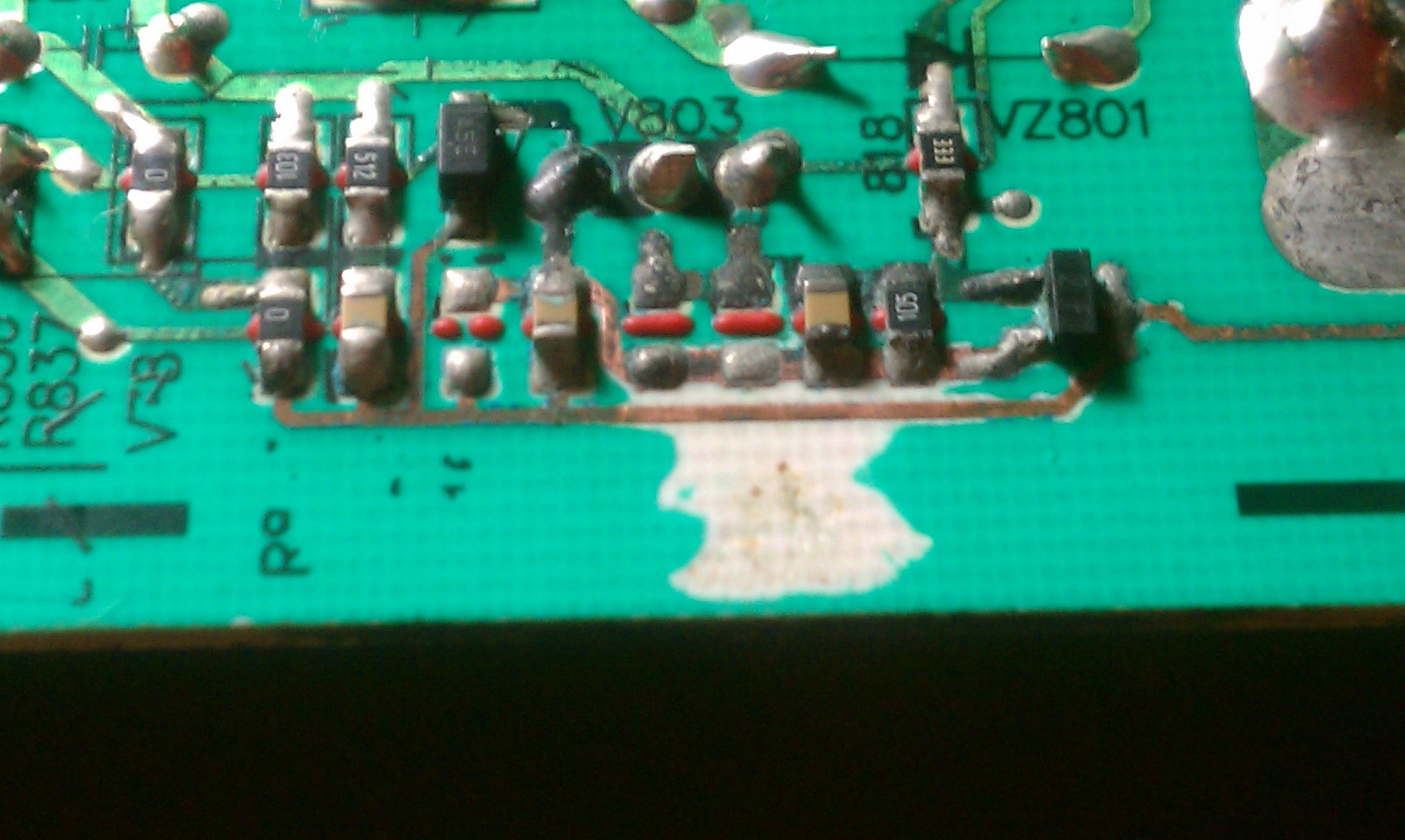

          Some of those traces look suspect. Make sure there is continuity along them.
            yeah i checked, the traces seem fine... its the cap and resistor on the right im worried about..and i dont even know what that other thing is...
            edit: resistance on that cap and resistor on the right have gotten better with the cleaning. they seem close to what im getting on the other caps...my digital meter's battery ran out though so im only using the analog meter and im not really sure how to read the ohms. i just know the needle is going to around the same place....
              well i let it rest that night and the next night, i didn't even mess with it i was just going to put it all back together and put it on the side till i figured out something else...but after i had it back together i decided to try power it on and boom! it totally works now!
              i guess all it needed was the dead gecko cleaned off real good!
              dang another TV fixed but no lesson to learn.
              oh well! now i can sell this TV and get a Hot Air station.
                The lesson is probably that conductive and corrosive lizard residue stuck on a circuit board can cause improper operation and PCB damage.
