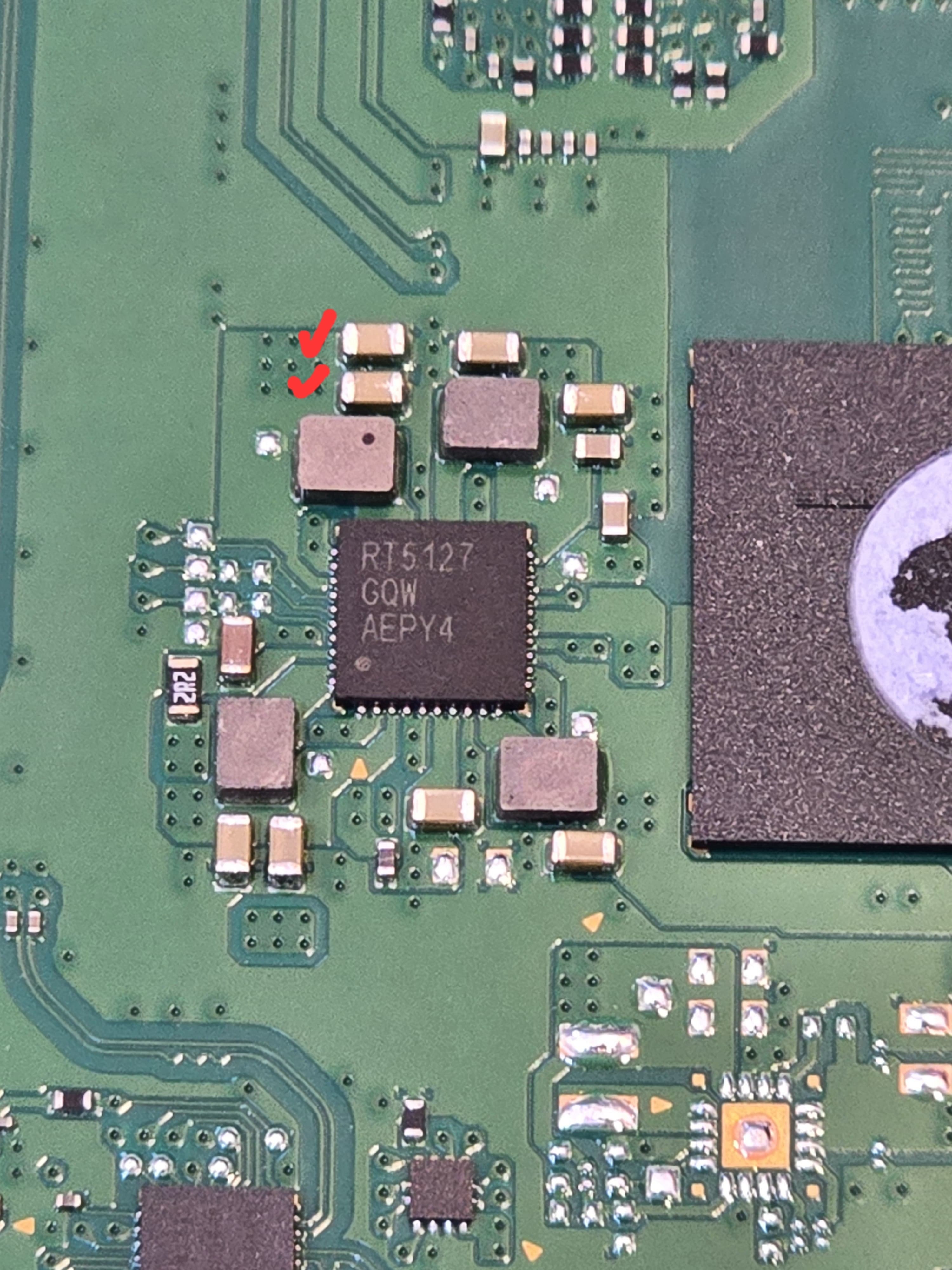

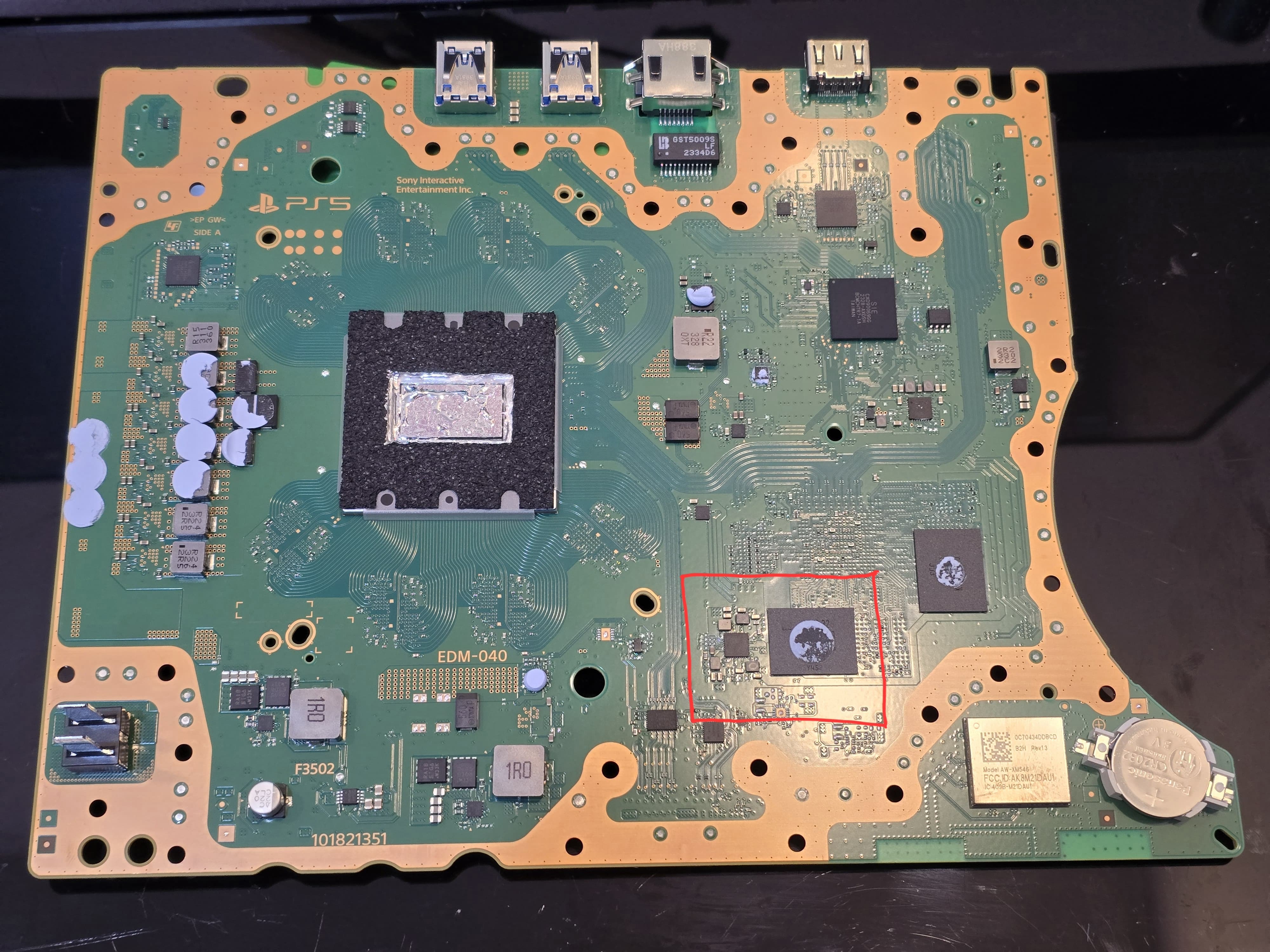

Hello everyone, I am new to this PS5 troubleshooting, I need help on diagnosing the problem. My PS5 Slim board EDM-040 that beep and only shows blue light then immediately turn off.
I've checked the PSU its normal 12V. I've checked all the capacitors its all good no shorts, but there are 2 caps shorted, I think its near the SSD. You can look at the image attachment.
When tested it only shows 0.003 while other caps show 0.4 to 1. WHen in continuity mode those 2 caps goes beep/shorted.
Any help to where should I check on or suggestion would be very appreciated.
