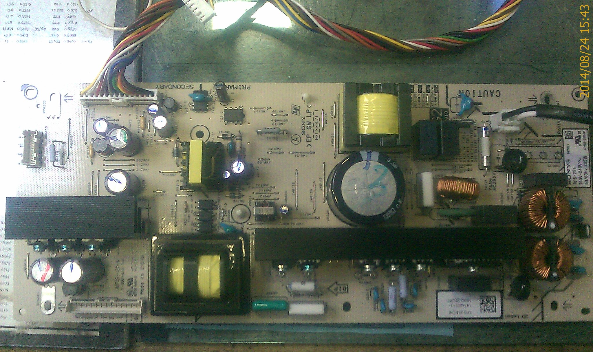

    hi i have been tinkering with this tv i got..no power 100% dead no lights on front nothing..no backlight....no sound....nothing..no clicks...
    have done some research....took tv apart...i do have 3.3v standby voltage from power supply but standbylight not on....'but no other voltages...anywhere
    i then ndisconnected the cable to main board and jumpered the 3.3v standby pin to the power on pin on main board end of cable......and i get no voltages anywhere on the power supply board other than the 3.3 standby volatage and obviously 3.3 pwr on volatage
    so my question is that if i do have 3.3 standby voltage why do i not get a standbylight???....and i originally thought it was a mainboard issue since soemone said if you get standby voltages but no standby liught ...the main board is the problem and the power supply is good.....well im not sure about that in my case since i have no volatges on power supply other than 3.3 standby ....
    any ideas whats going on here??....i highly doubt both boards would go bad at same time
    thank you

        The main board gives the command to the power supply to turn on.
        Usually you need to use some resistor (100ohm-2.5kohm) between the standby and Ps-On pins and nother one between the standby and inverter on pins.
        The main board has to be disconnected.
        The backlight, should turn on if the power supply, inverter and backlight is good.
        You would also have the voltages at the power supply.

            well like i said i do have 3.3 standby voltage but no standby light
            when i jumper the 3.3 standby voltage to the pwr on pin i get not voltages anywhere on the power supply
            according to many tutorials..once you supply power to power on pin that should turn on power supply and all voltages on board should be enabled
            is this true?

                As tom said some boards require you to pull PSON to ground so try that and see if you get anything.

                  You should post some clear pictures, with your power supply board.

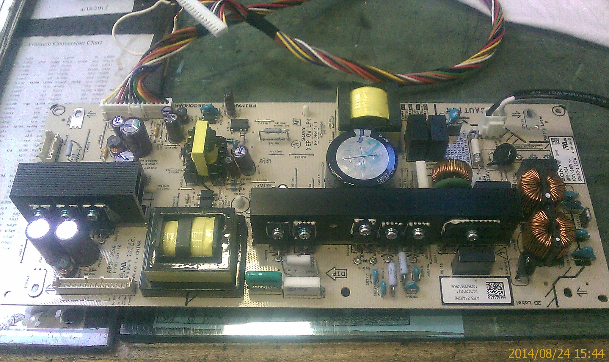

                      Re: Sony KDL-40ex400 LCD tv no power...100% dead
                      here are two pics as you can see i have the jumper wire connected from standby 3.3 v to pwr on
                      im trying to troubleshott if problem is main board or power supply
                      originally since i get no standby light but i do have standby voltage i would have thought it was for sure main board issue however when doing some tests on power supply i dont see any voltages other than 3.3 standby
                      so now im stuck
                          I don't think that is a good idea to unplug everything from the power supply.
                          You should live the board in the TV and unplug only the main board plug.
                          Use resistors as I suggested, not just wires.
                          I have just done this on a Vizio TV and I had the backlight turned on this way.
                          I know now, that have a mainboard issue.
                            The PS_ON (PWR ON) signal for this board is active HIGH (<1VDC = OFF, > 3.0V = ON).
                            The main thing you have to ask is that are you getting PS_ON signal form the main board or not.
                            "i highly doubt both boards would go bad at same time" it is not out of the question at all.
