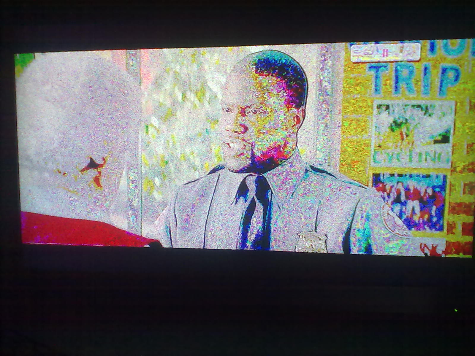

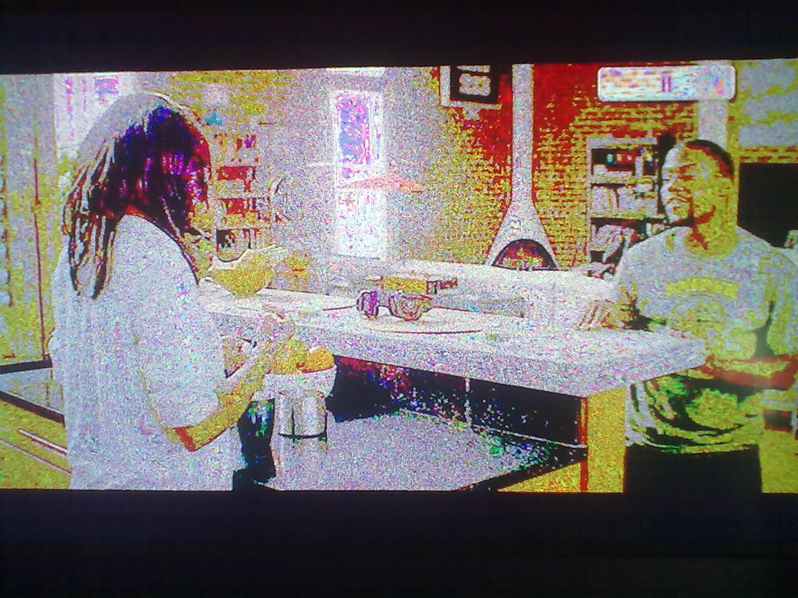

    Ok so I got given this LCD by a friend who was clearing his garage "it won't turn on" he said ,,,,,,I've tested the voltage on psu seems fine ,the backlight works ,so I'm guessing main board problem but don't know how to check these " EEPROM" ,,,,so I ordered a replacement board from TVparts uk now I get bad solariziation on screen,,,,two questions ,,can my original board be repaired or my replacement board be reset (on option byte) but I need a service code
    Re: Bush lcd40fhda8
    Would help to post pictures of the fault.
      Re: Bush lcd40fhda8
      Is the main board you got identical (as in from the same TV/correct display type). This problem is common if the board is for a different display. In some sets you can change display type in the service menu, but if it's a recent Vestel chassis you would need to change the firmware, I've had no luck getting firmware from Vestel (other than for Comet OEM products)

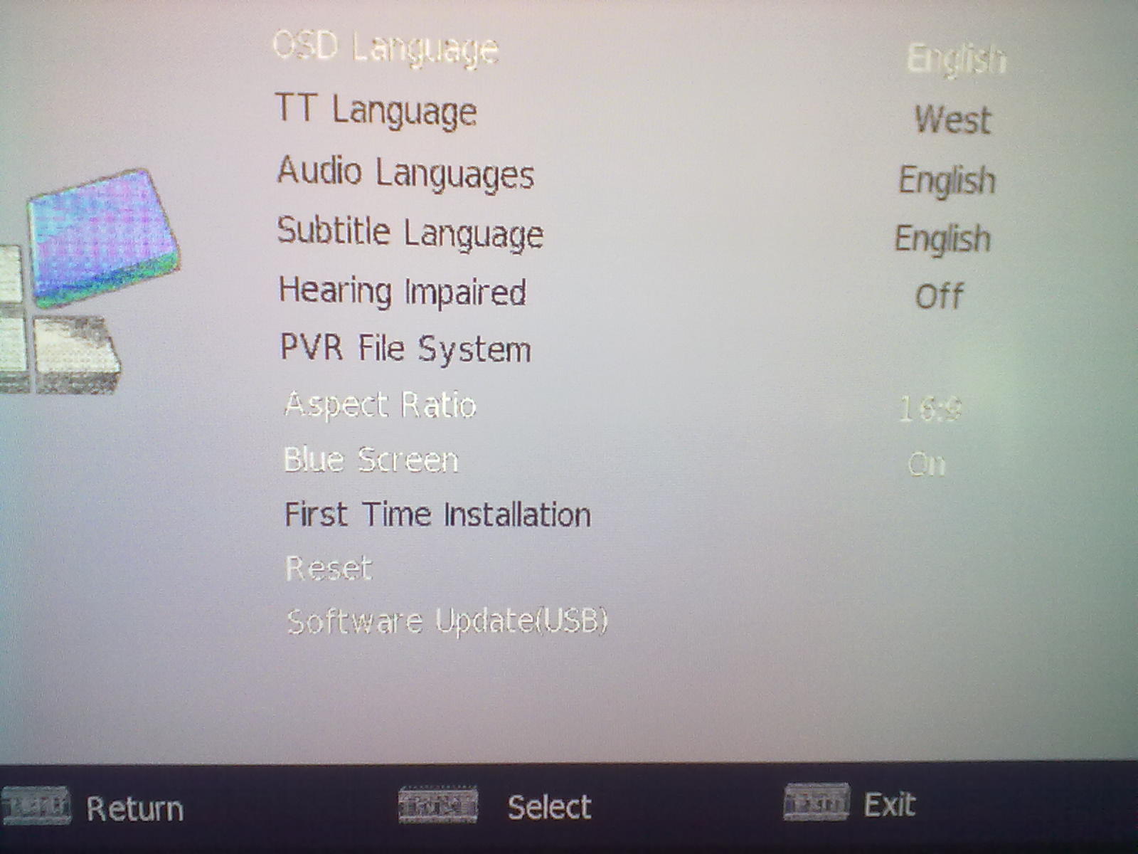

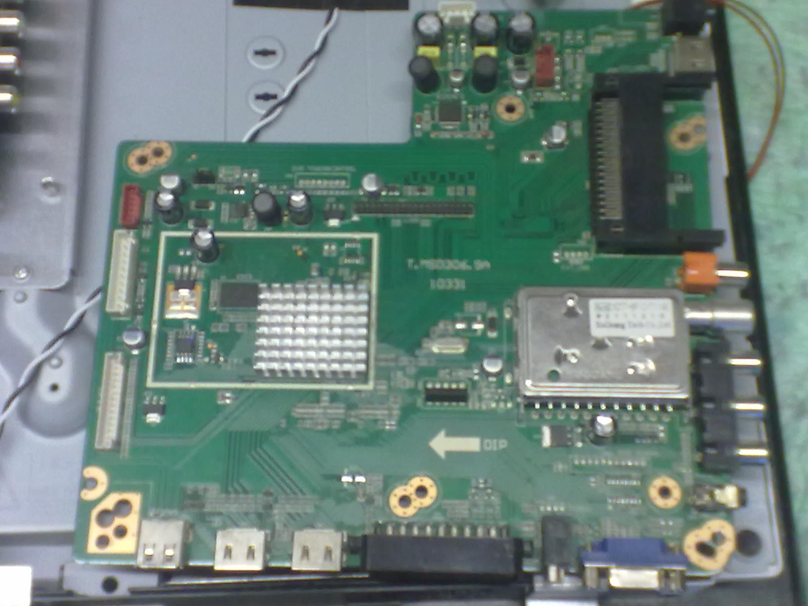

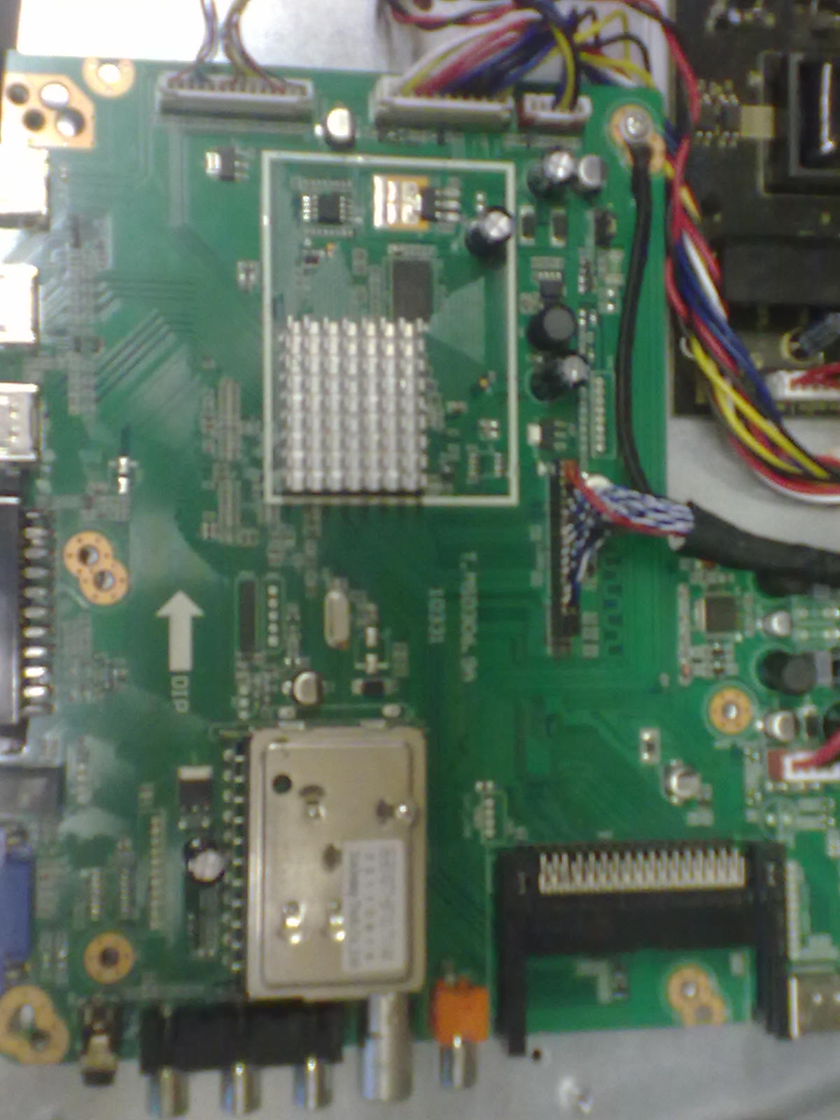

        yes identical boards,,,when i ordered the replacement board i quoted the model number..i can go into software update but what with and where from is another matter..her are some pics of the 2 identical boards

          can you post a picture of the fault shown on the tv screen i see toms asked you for the same too.
            Re: Bush lcd40fhda8
            Pictures are poor - need to be in focus - are they Vestel? What are the board numbers.
              Re: Bush lcd40fhda8

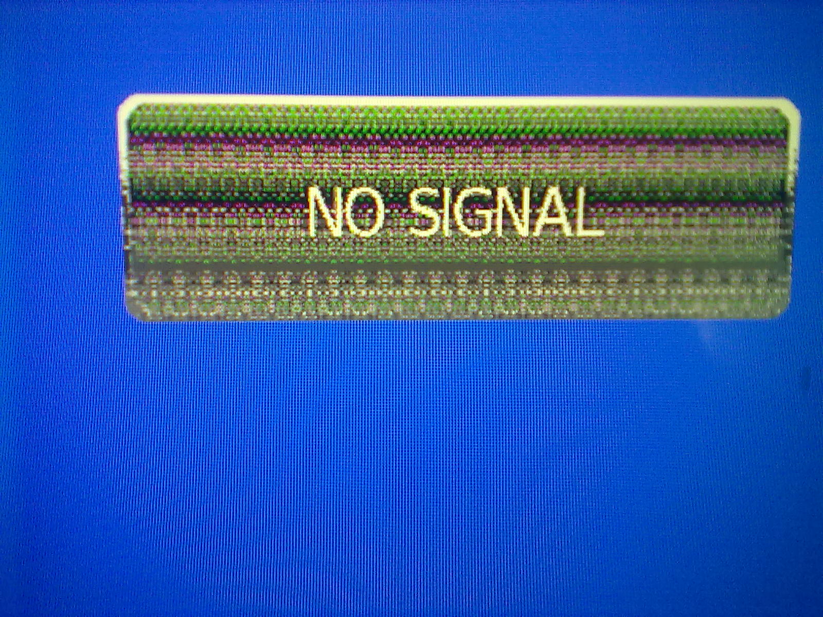

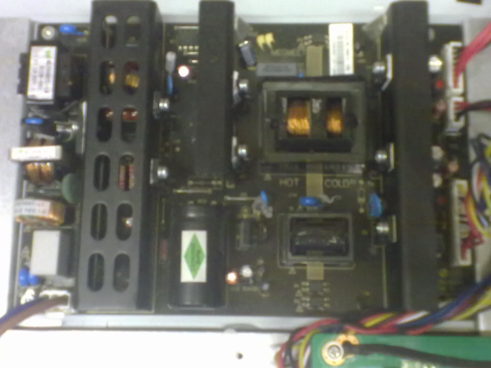

              ok, here are some pics of "solarization" and a settings menu..main board no: T.MD306.9A 10331.........PSU no:MLT668L-VM

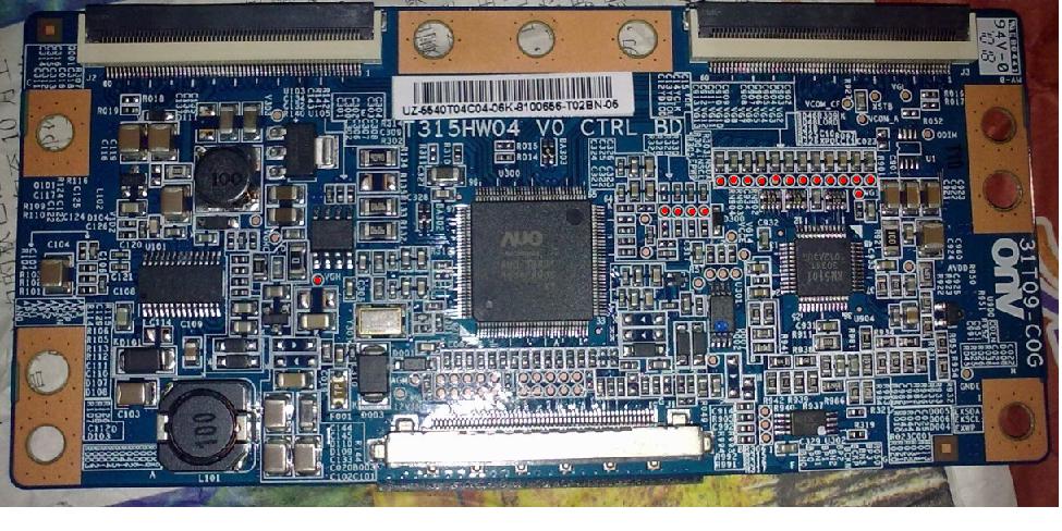

                Ok you need to find the Tcon Board get the board number and post it
                  Re: Bush lcd40fhda8
                  If the panel is made by AUOPTO, the T-CON should looks something like this:
                  http://flattvparts.co.uk/bush-lcd40f...w04-vb-ctrl-bd
                  Or SAMASUNG panel version:
                  http://www.ebay.com/itm/V460H1-C11-V...-/281111520069
                    Re: Bush lcd40fhda8
                    t-con board number T315hw04 v0 ..
                      Re: Bush lcd40fhda8
                      Which versions? V0? look at the numbers on the barcode sticker.
                      V3: http://www.shopjimmy.com/auo-55-46t0...-con-board.htm
                      V0: http://www.shopjimmy.com/auo-55-46t0...-con-board.htm
                        Re: Bush lcd40fhda8
                        Ok so you need to test and list the 13 gl voltages that are in a line with 1 below - the description for them is above,
                        There is also another 4 points I cant see the description for and i that is VGH
                        there should also be a VGL if you can spot it.
                          Re: Bush lcd40fhda8
                          ok here goes from left to right on pic above,, the point on its own 27.2 the 4 together read .023 , .006 , 0.1 , 1.3 , the points (long combo) 0.6 , 3.1 , 4.6 , 5.4 , 7.2 , 7.7 , 8.5 , 9.0 , 9.9 , 10.7 , 12.2 , 14.8 , ,,,the point under them on its own is 15.1,,,,there are 4 other points near the connector all around 3.1
