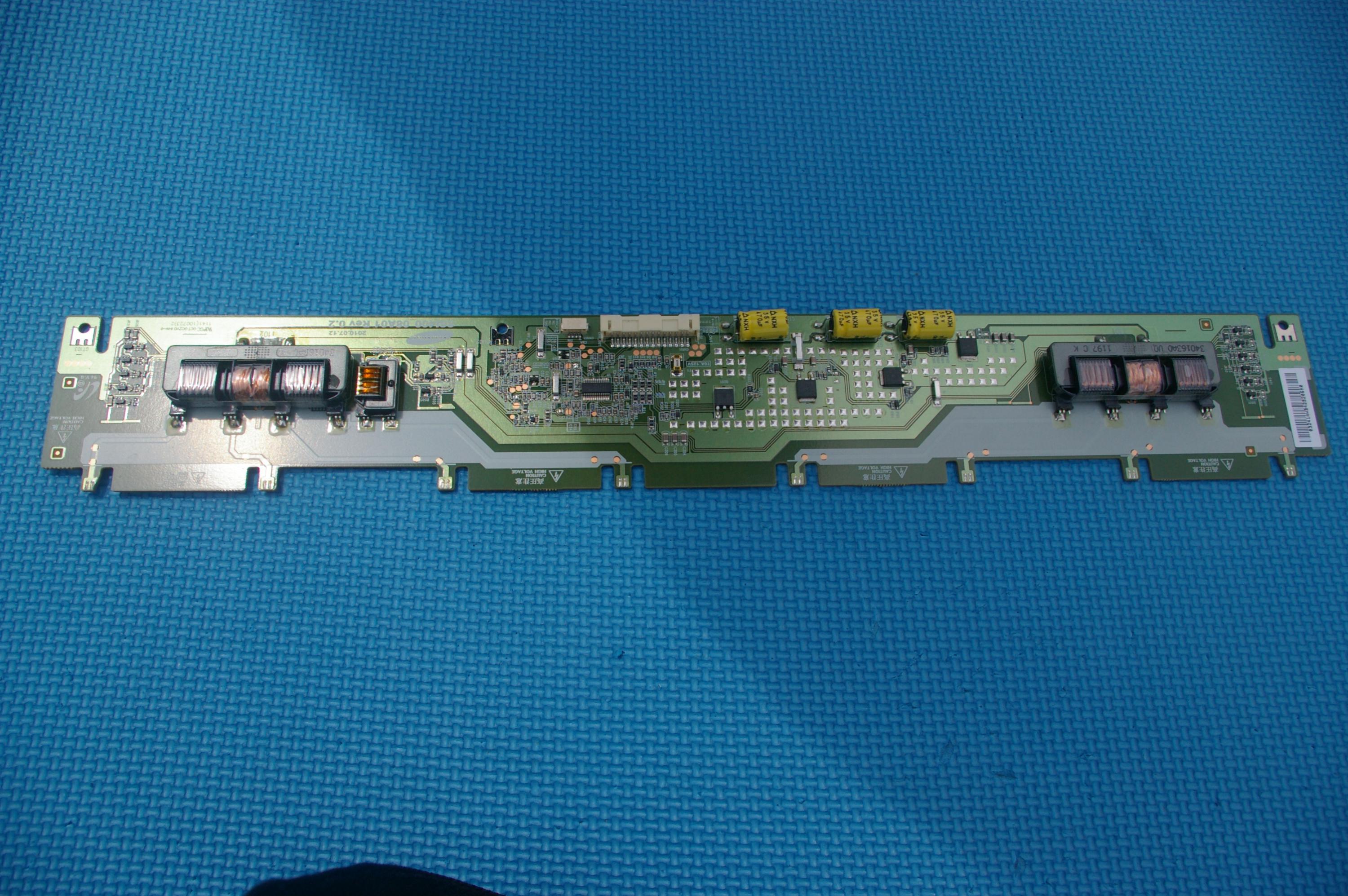

                  40MF401B/F7 backlight inverter. Here is a picture. I think the board may be the same one sent to the buyer, but would like to make sure it's still in working order. Thanks for any idea on how to bench test this.

                      Without a schematic for the board you still might be able to figure it out from the pinout and specs of the chip that is below the white connectors in your picture.
                            Not sure exactly what you mean by that. Based on my experience, I don't think I'll be able to figure it out from any information on the board itself.

                              What I mean is,
                              does the chip have anything printed on it? If you can identify it you may be able to get a pinout of it and determine what voltages need to be applied where to operate it and possibly turn the board on so you can bench test it.

                                I may be wrong but I am not sure you should power up a board without lamps. I believe it might damage the inverters. In normal use the error detection from not having a bulb would switch off the power supply saving the inverters but using an external supply that would not happen. In any case without bulbs there has to be a limit to what you can test.
                                Secondary Voltages would be too high. I dont really think you can bench test it stand alone - that is without more parts, but I often think wrong

                                  I wasn't suggesting that. Find out what the thing is first. Knowing what the chip is, is a starting place.

                                    You will need 8 lamps and 24V power supply with current rating at least 7A.
                                    I never try testing the board by itself before but I will give it a try in the future since I have lots of spare power supplies.

                                        I have bench tested an inverter board from a laptop but it only required one CCFL tube connected to work (laptop had two tubes running from the same board connector in parallel) and I use it for testing individual tubes now. No matter what the inverter type is you will have to know where and what voltages to supply. There's Vcc supply voltage, enable signal voltage, dimming control voltage, etc. That's why the need for a schematic or at least the pinout & specs of the chip. Whether or not you need all 8 tubes connected or not for it to work is not known. It is possible but good trouble shooting techniques written up here suggest that it is not necessary; i.e. disconnecting tubes and trying to light one at a time to check for bad tubes, and the opposite; removing one tube at a time.
