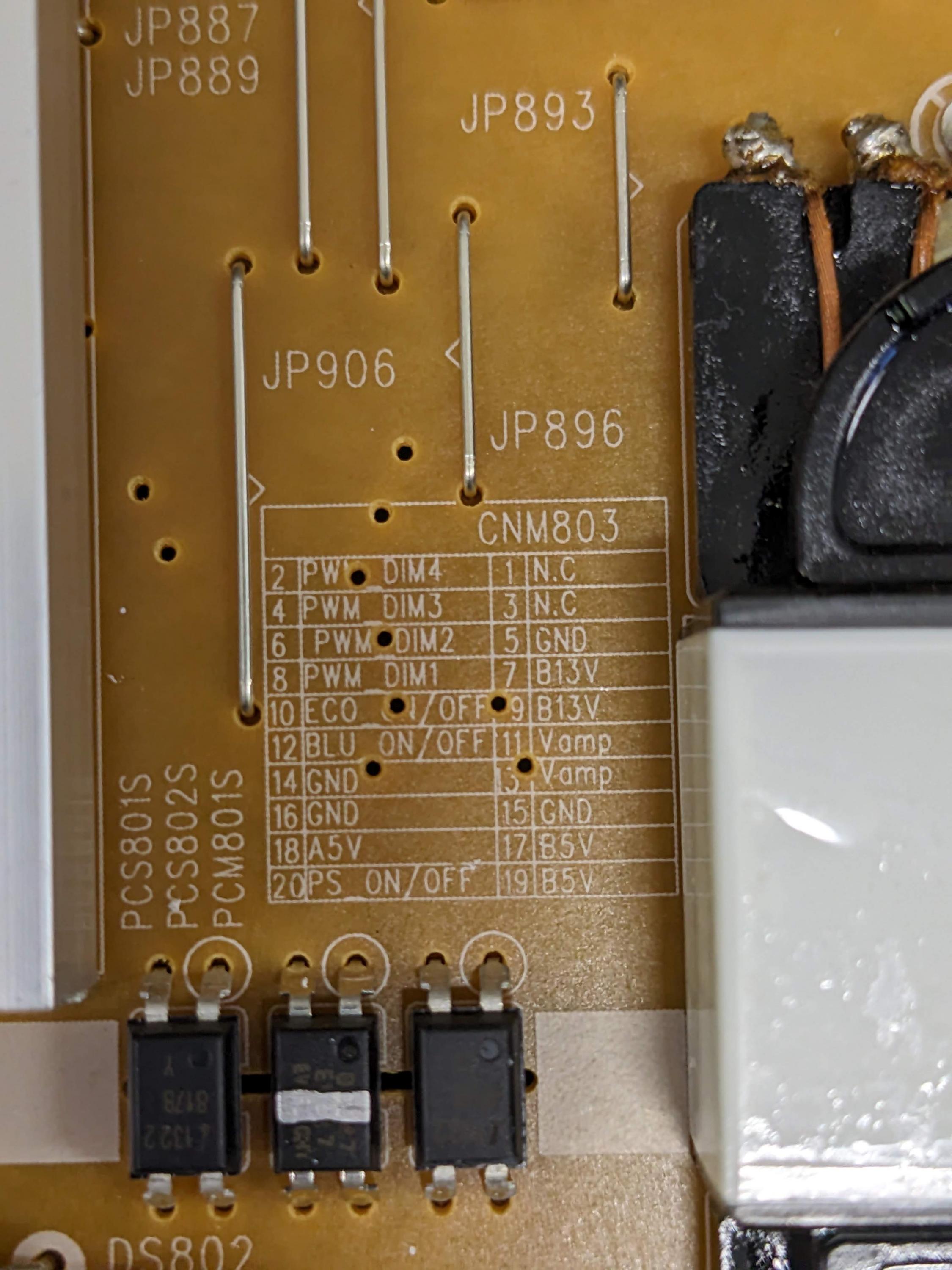

    Hey!
    I've got this power supply board that's had some components replaced and I'd like to confirm all the voltages before I install it.
    This is what I have when I plug in the board on the bench;
    1 - N.C. - 0 VDC
    2 - PWM_DIM4 - 0 VDC
    3 - N.C. - 0 VDC
    4 - PWM_DIM3 - 0 VDC
    5 - GND - 0 VDC
    6 - PWM_DIM2 - 0 VDC
    7 - B13V - 0 VDC
    8 - PWM_DIM1 - 0 VDC
    9 - B13V - 0 VDC
    10 - ECO_ON/OFF - 0 VDC
    11 - Vamp - 0 VDC
    12 - BLU_ON/OFF - 0VDC
    13 - Vamp - 0 VDC
    14 - GND - 0 VDC
    15 - GND - 0 VDC
    16 - GND - 0 VDC
    17 - B5V - 0 VDC
    18 - A5V - 5.3 VDC
    19 - B5V - 0VDC
    20 - PS_ON/OFF - 3.3 VDC
    Since there is voltage on the PS_ON/OFF, I assumed a High to Low enable and shorted the 3.3 to GND. Heard a relay click, but no other voltages appeared on any of the pins above. Is there something I'm missing?

    What are the components that were replaced? You seem to only have standby voltage, check the voltage across one of the main filter caps, (CP803) The voltage should be 165vdc in standby and around 385vdc when ON if the pfc circuit is working.
    I suspect the main switching section is not working, check that CP814 is not burnt (likely covered in silicone) also check that solder connections on both transformers TM801CS and TM802CS

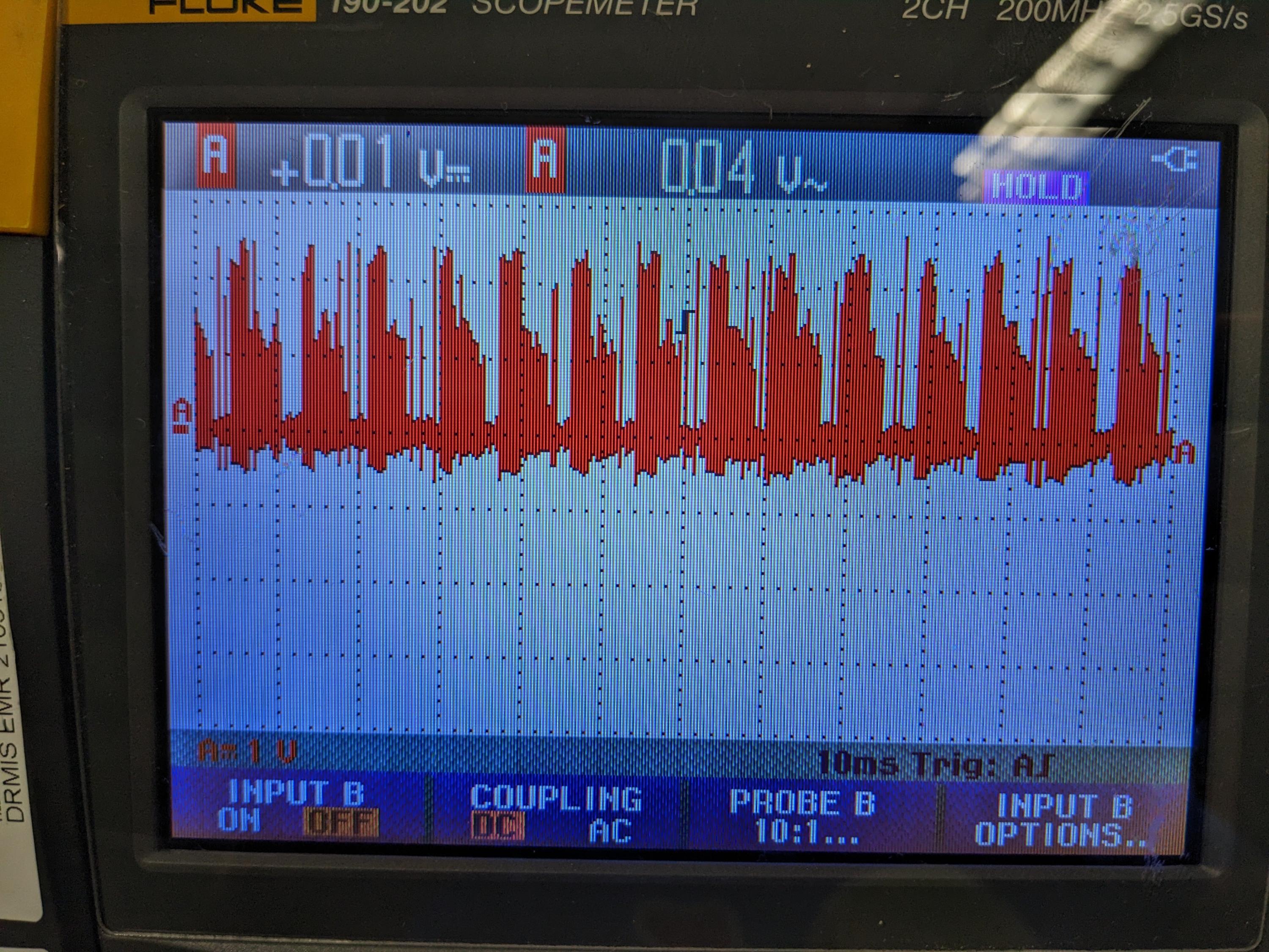

                  So my work looks good. I didn't explicitly mention this, but in Standby (5VDC and 3.3VDC available), the VDC across the filter caps is 168VDC.
                  The FET driver ICs (ICM801S and ICP801S, i think?) don't have anything on Vcc to GND, any thoughts on where/how those voltages are generated? One of those generates the switching voltage for the two main TXFMRs right?
                  Apologies if I'm mixing things up, I'm trying to understand and explain at the same time!

                    IN post #3 you had 389v on the main cap, now it is 168v, When the voltage is 389v the PFC circuit is/was working, when the voltage is 168v the PFC is NOT working.
                    VCC for ICM801S and ICP801S comes from the standby transformer and is controlled by a transistor, In the schematic of the 622B (and on your board), DS802 is the supply diode, QS801 is the regulator/switch which supplies the VCC_AUX (17vdc) to those ic's and is controlled via PCS802S optocoupler. (PS_ON/OFF) controls QS861 which turns the optocoupler on/off
                    QS861 also energizes RL801S which supplies A/C to the main bridge BD801S
                    Remember that voltages on the primary side are reference to HOT ground, not COLD (chassis) ground

                      Ok, I'm going to try to explain what I know now.
                      First, ICP801CS got shorted (accidentally somehow) and was bad. I replaced it now have ~390VDC, so PFC is working.
                      Second, my board does not have the same ICM801CS chip as the schematic in Post #7. My board has an Fairchild FAN7621. This chip provides gate drive signals to a highside and lowside MOSFET (FDPF18N50T x 2). The HO gate drive signal (Pin 3) measured 14.2VDC on pin 3. The signal on the LO line (Pin 14) looks like a drive signal I think (See pic). The Drain of the lowside FET is connected directly to the source of the highside FET and also connected to TXFMR TM802CS. I've got ~390VDC at the Drain of the highside FET and GND at the source of the low side FET......
                      .....I'm thinking one of those FETs are bad? Gonna pull them and take some ohm readings..
