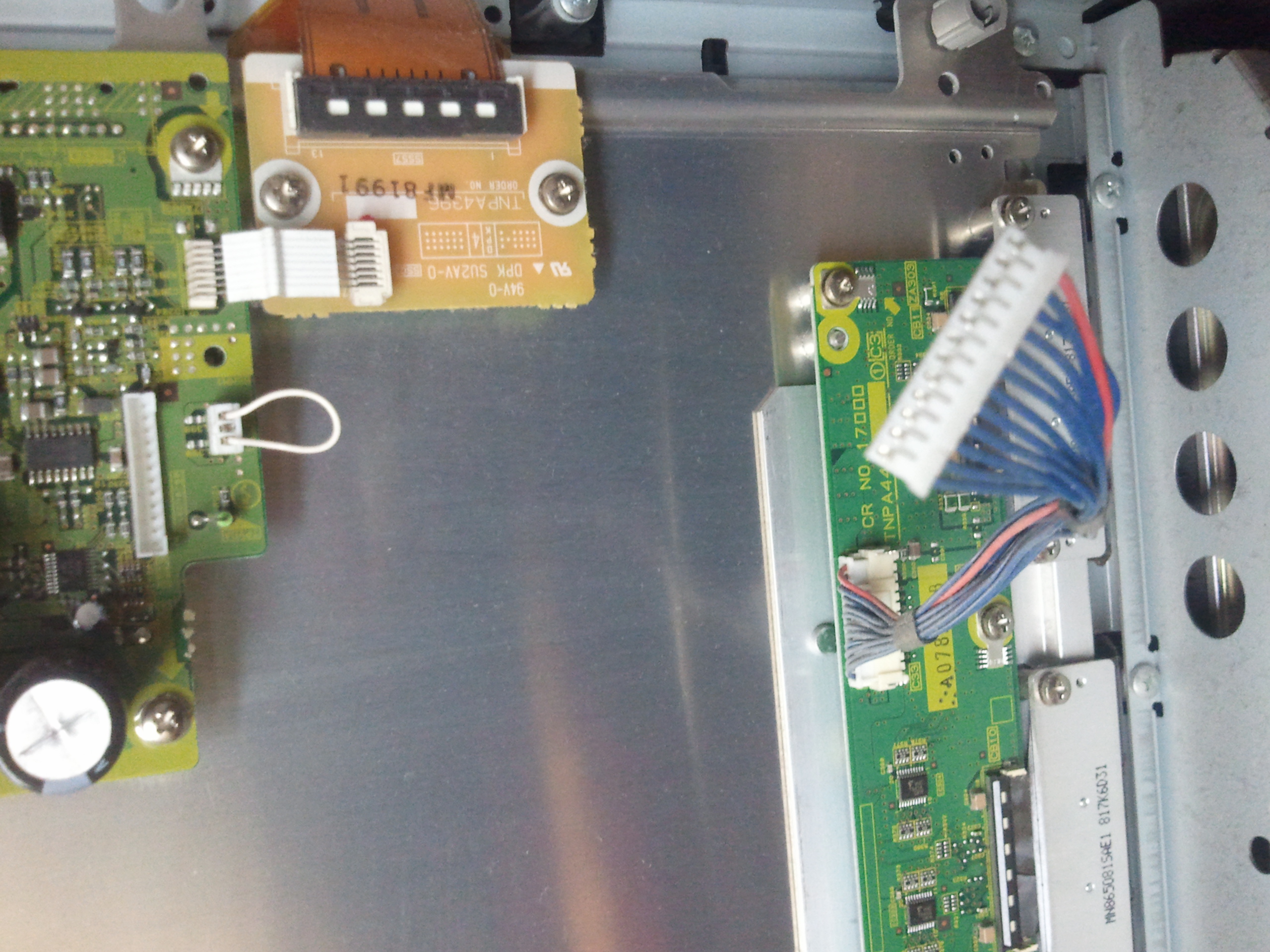

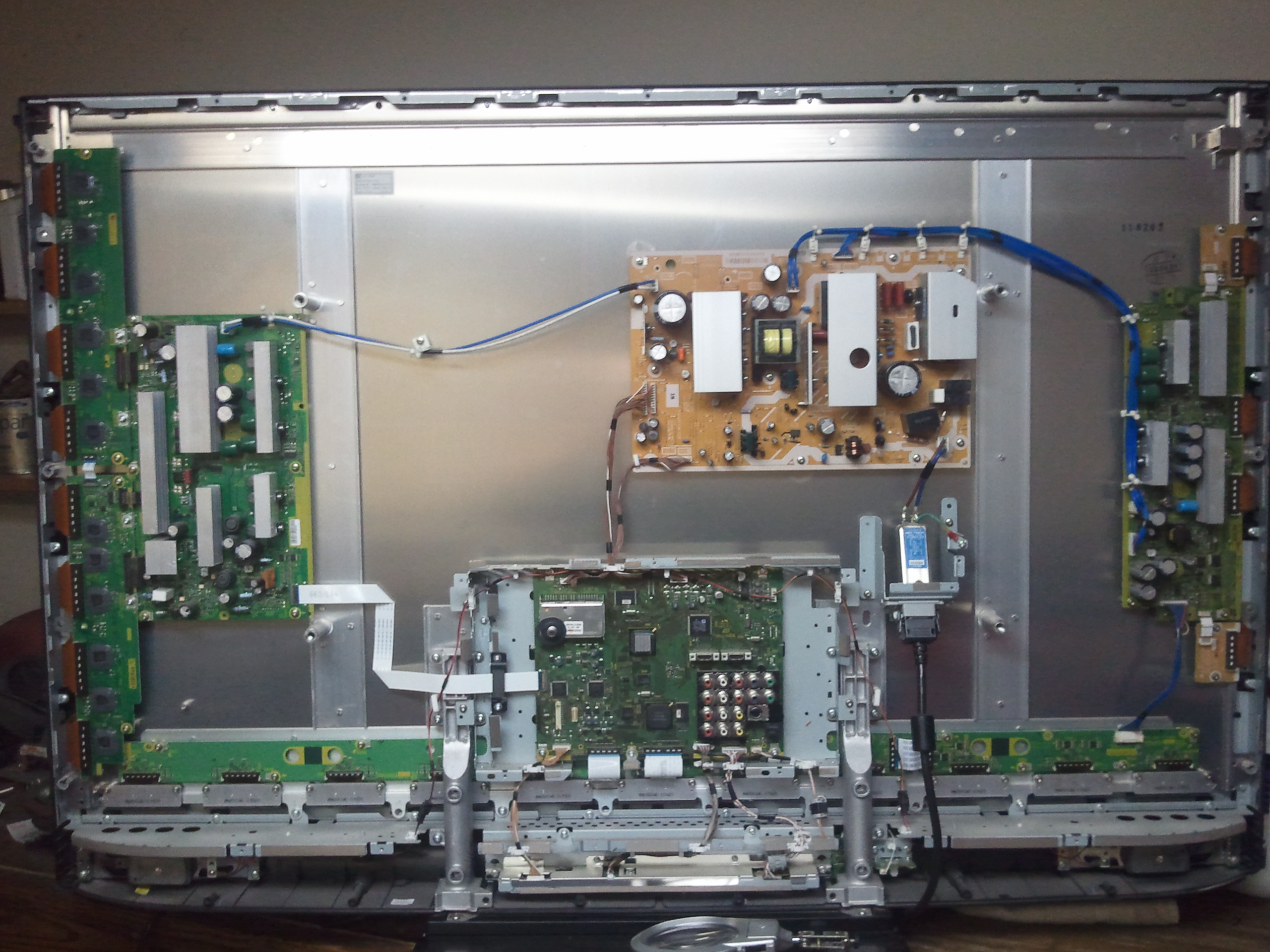

    working on a panasonic TH-50PX80U it will power on and the screen is dim it changes from black to a shade of gray. other then that no picture at all.

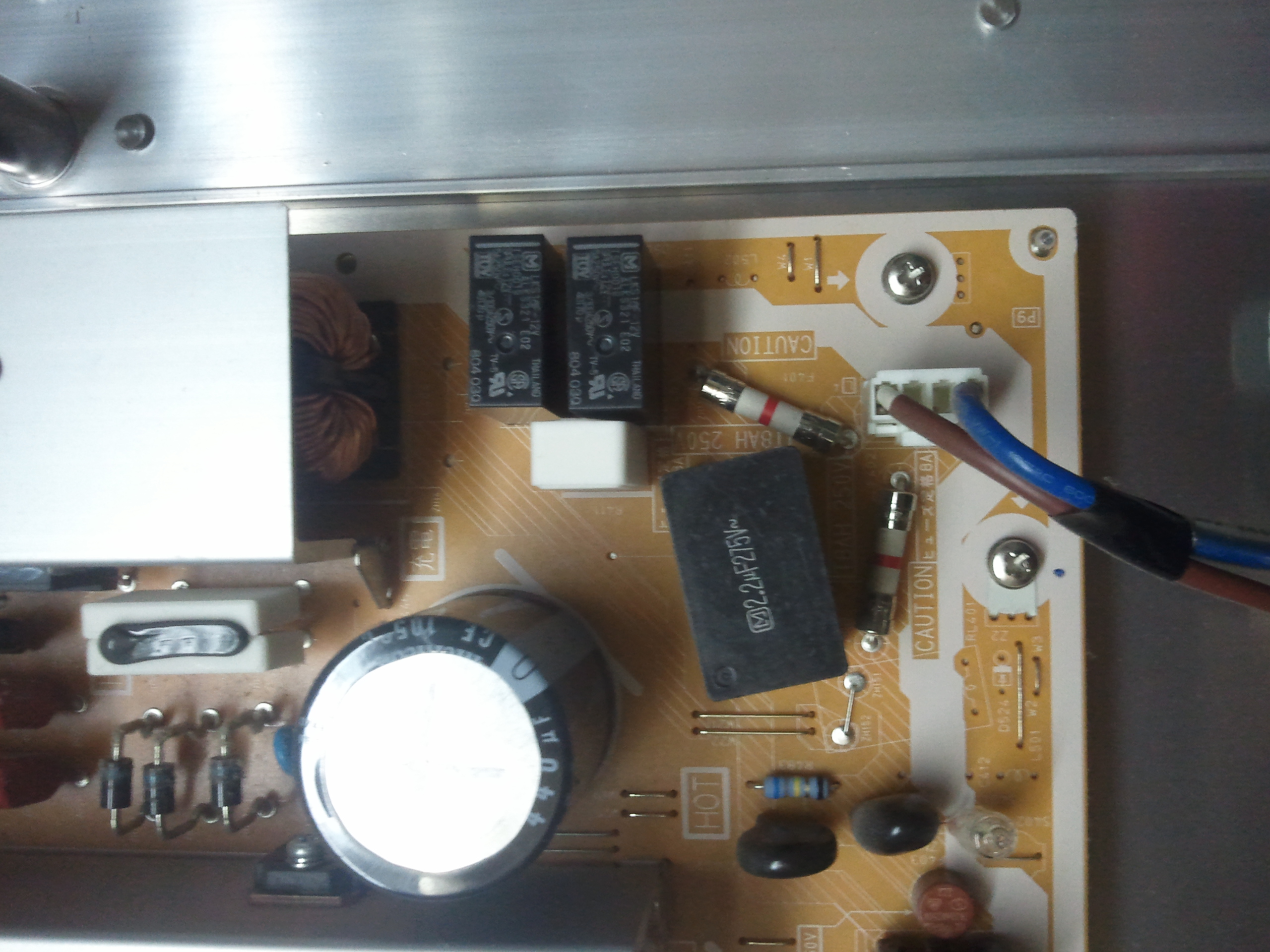

    I tested 2 fuses (see picture) one was at 16.4 on both ends the other is 0.10 on both ends. the sustain boards have green leds.. the are on." green " unplugging either sustain boards power causes the Tv not to turn on..
    the TV will turn on with the power light is red.. but if I turn it off with the power button it turns off but in about 4 seconds turns off again. so i have to unplug the tv to turn it off.. and suggestions?

    Re: panasonic TH-50PX80U no picture

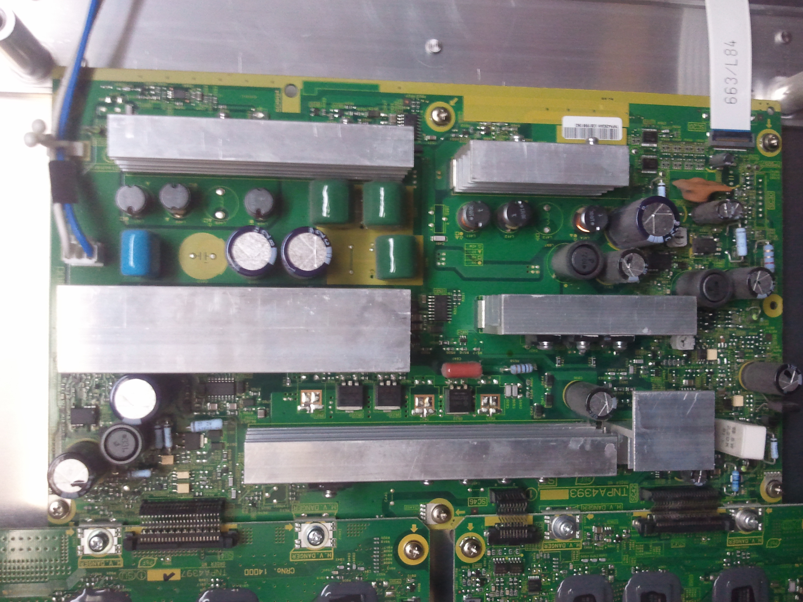

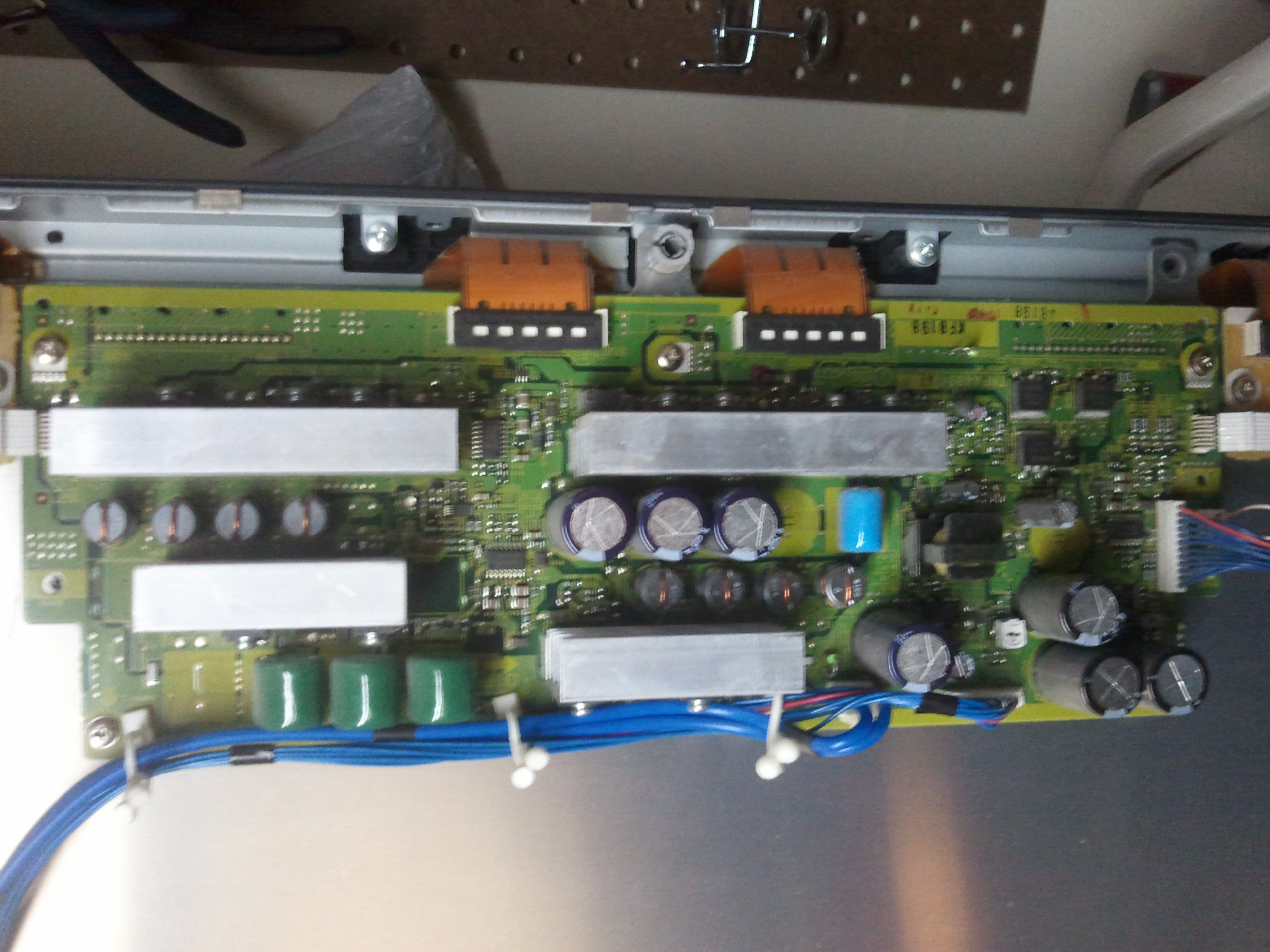

    I did notice unplugging a cable from z-sustain will cause one side of screen to display " blue rain " no sign of a picture! just static
      You probably have a Z-sustain fault due to the dim picture.
      And ya Panasonics are touchy when removing boards.
      If you are referring to those 2 fuses in the second picture, if those were bad your set would fail to have power. Little confused though how you tested them.

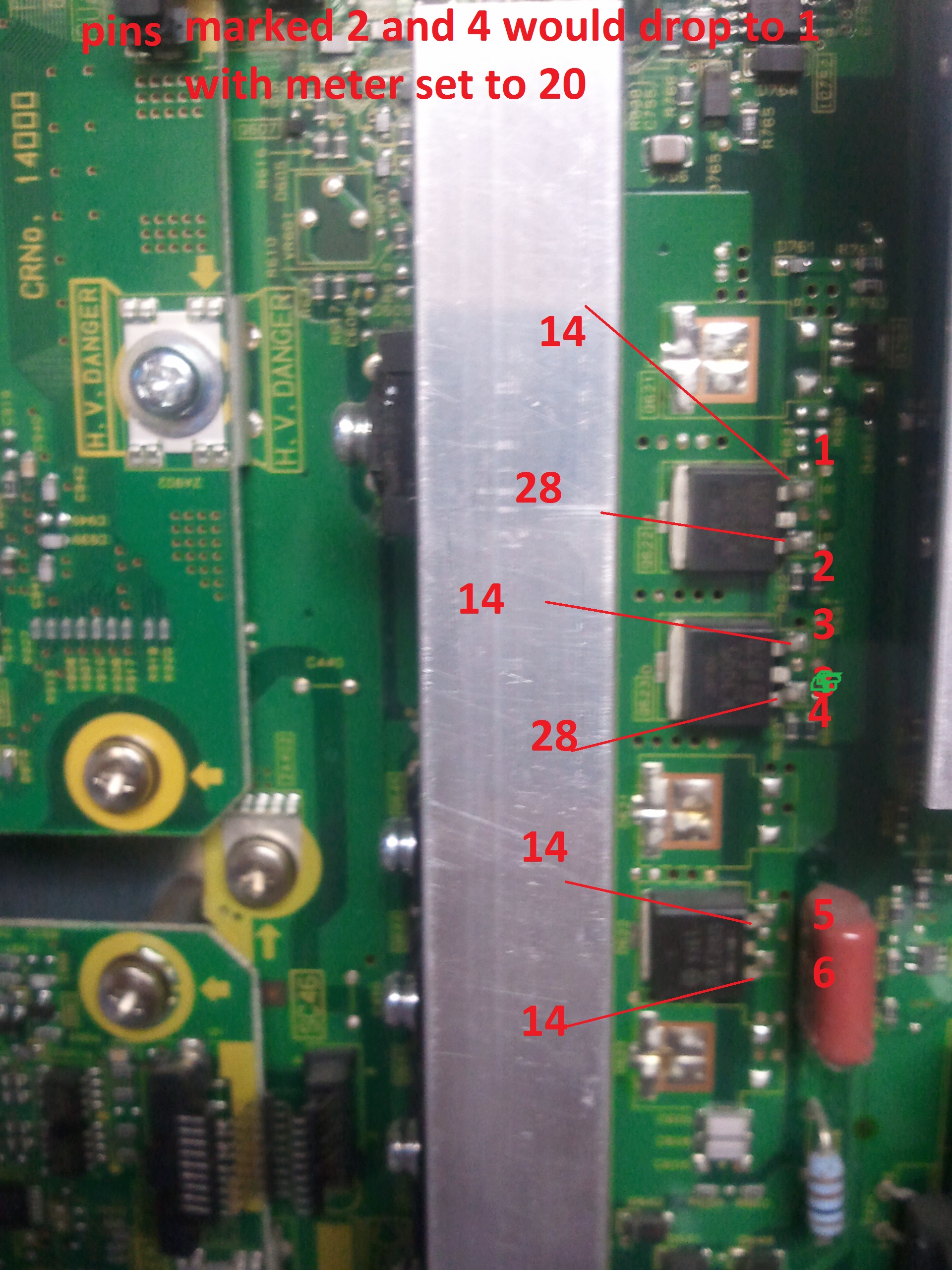

        I can get the screen full bright by ajustment.. just nothing on screen no menu ect.. I tested some voltage regulators all the information is in the pictures thanks. from both y-z sustain

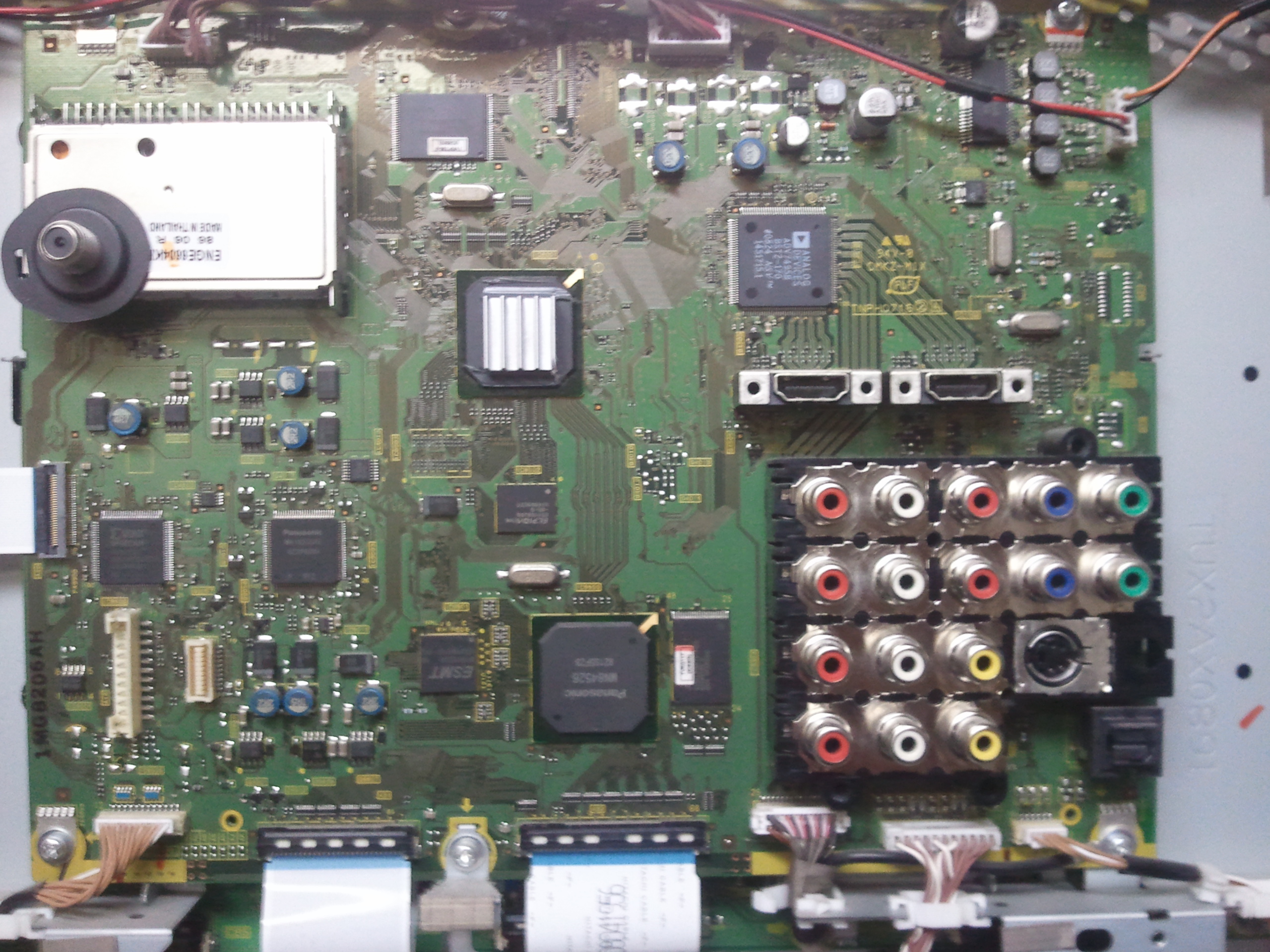

          That sounds like a main board problem. Here's the manuals if you don't have them.

            forgot to upload the pictures...

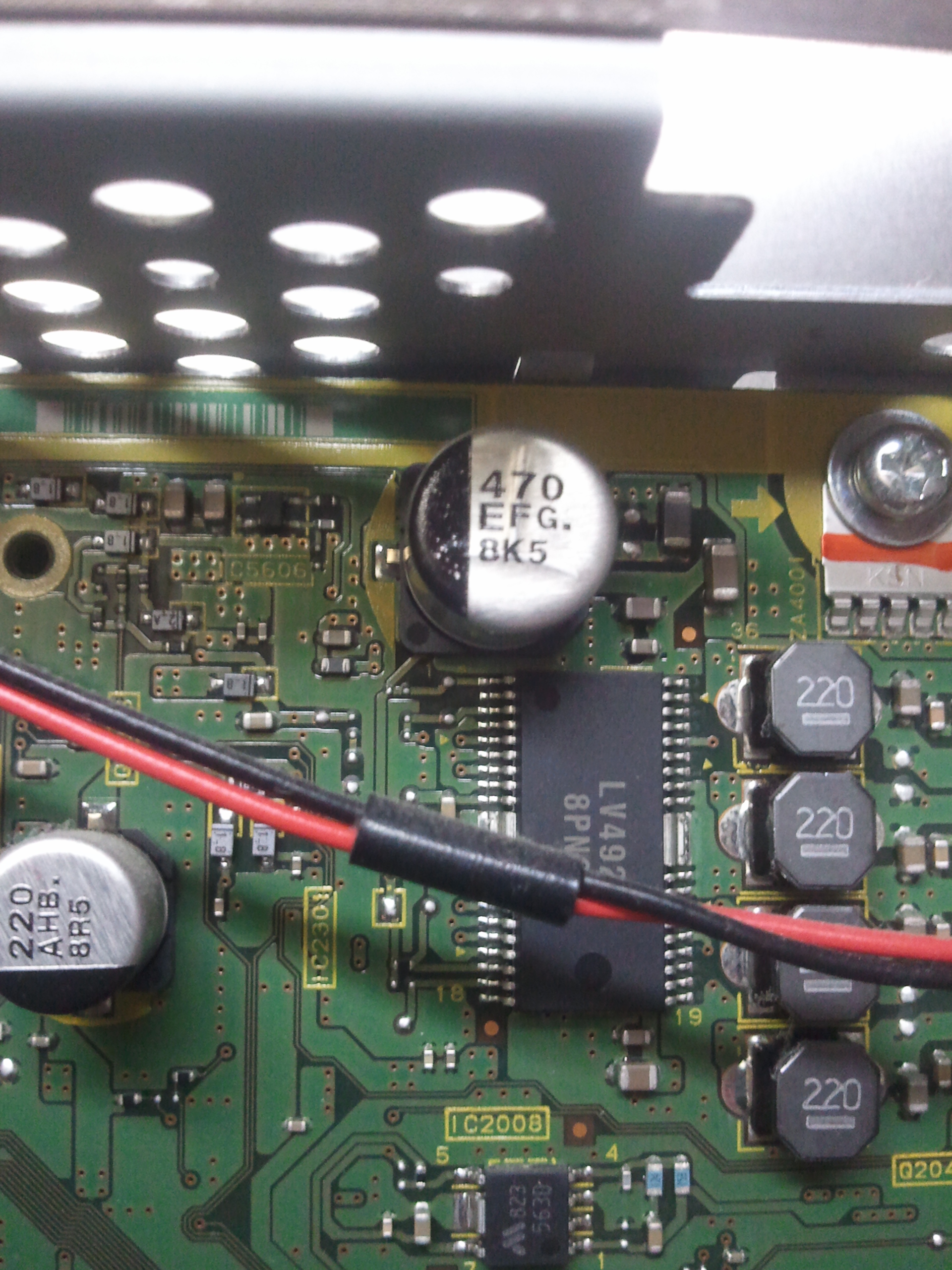

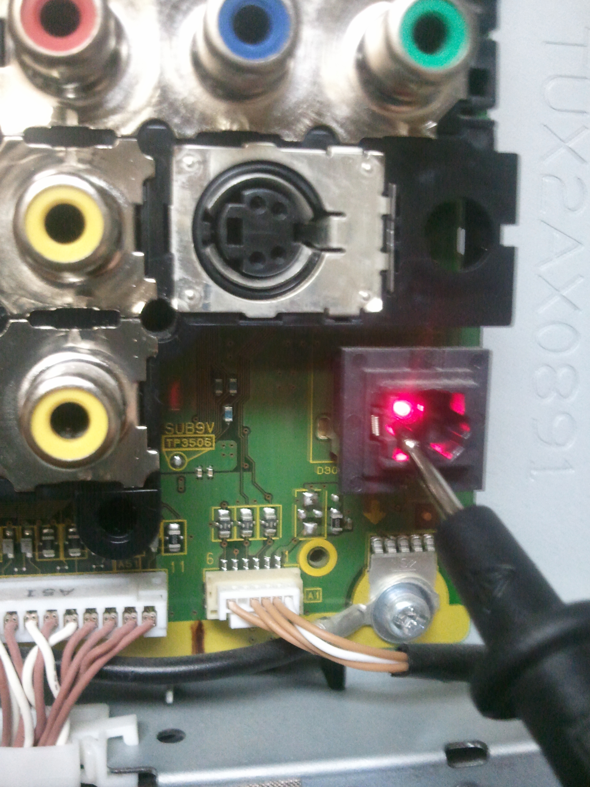

              I noticed on the main board the is a little red led under a flap. im thinking this it because of a issue on the board? I also noticed what looks like a bad capacitor?

                Ok, I misread and thought you had a picture
                Ok, I would go with DavidOH with the main being a culprit or even the CTRL (D) board.
                The red light is for the optical out and is normal.
                That cap looks to be good too - its paint may just look weird and the tri-wing shape is the stamped vent hole.

                  Don't know about the cap. The flap with the red light is the digital audio out. It uses a fiber opitic cable.

                    Are there any small smd fuses on the main board? Usually there's at least 1.

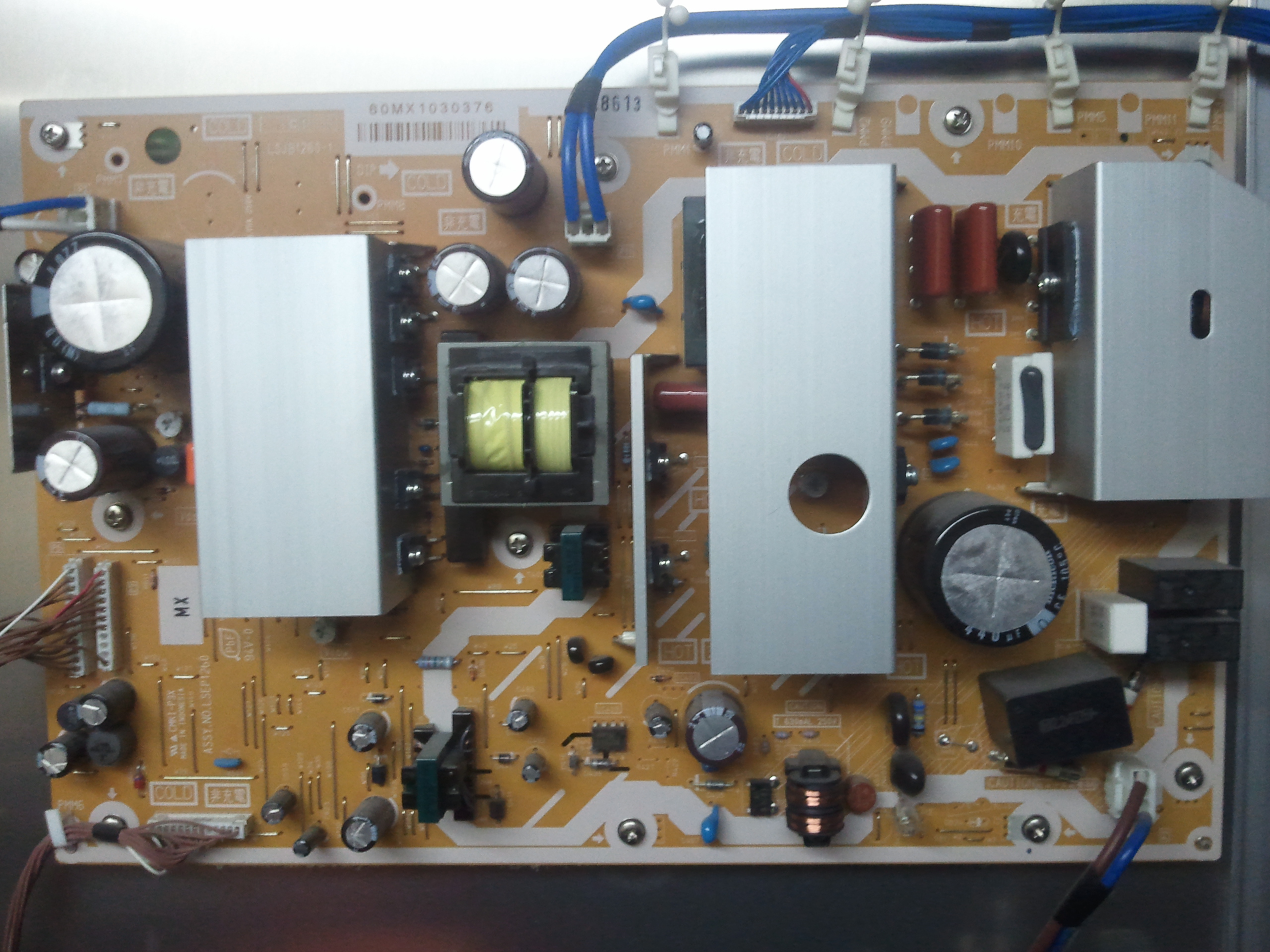

                      there is a ajustment on the power board that will turn the screen to Fulbright. I'm not looking at the board now so I can't tell you what it is. but I have ajusted it back down. I did not notice any surface mount fuses. but I will post more pictures of the mainboard when I get off today. I'm thinking it's the mainboard to. both the sustains has a green LED lit on it. I am assuming that that means there okay?
                      but the screen seems fine just no information going to it. thanks everyone for your help

                        It is not wise to adjust potentiometers in a plasma set if you don't know what you are adjusting. Some of those adjustments are pretty critical, and they rarely shift, so adjusting them just tends to mask the original problem, or introduce others

                          you're probably right! I just love to tinker hopefully that won't get in trouble one day :-) no smf on front side could they possibly put one on the back side? I haven't removed the board yet
                            You probably adjusted Va and hopefully panel address drivers were OK with receiving >65V, which is the typical rating for them. Otherwise, you kill the panel.
                            When you disconnect the power to the address buffers on the bottom of the screen weird stuff happens, blue rain could be one possible symptom. If you still get blue rain the panel's probably still OK.

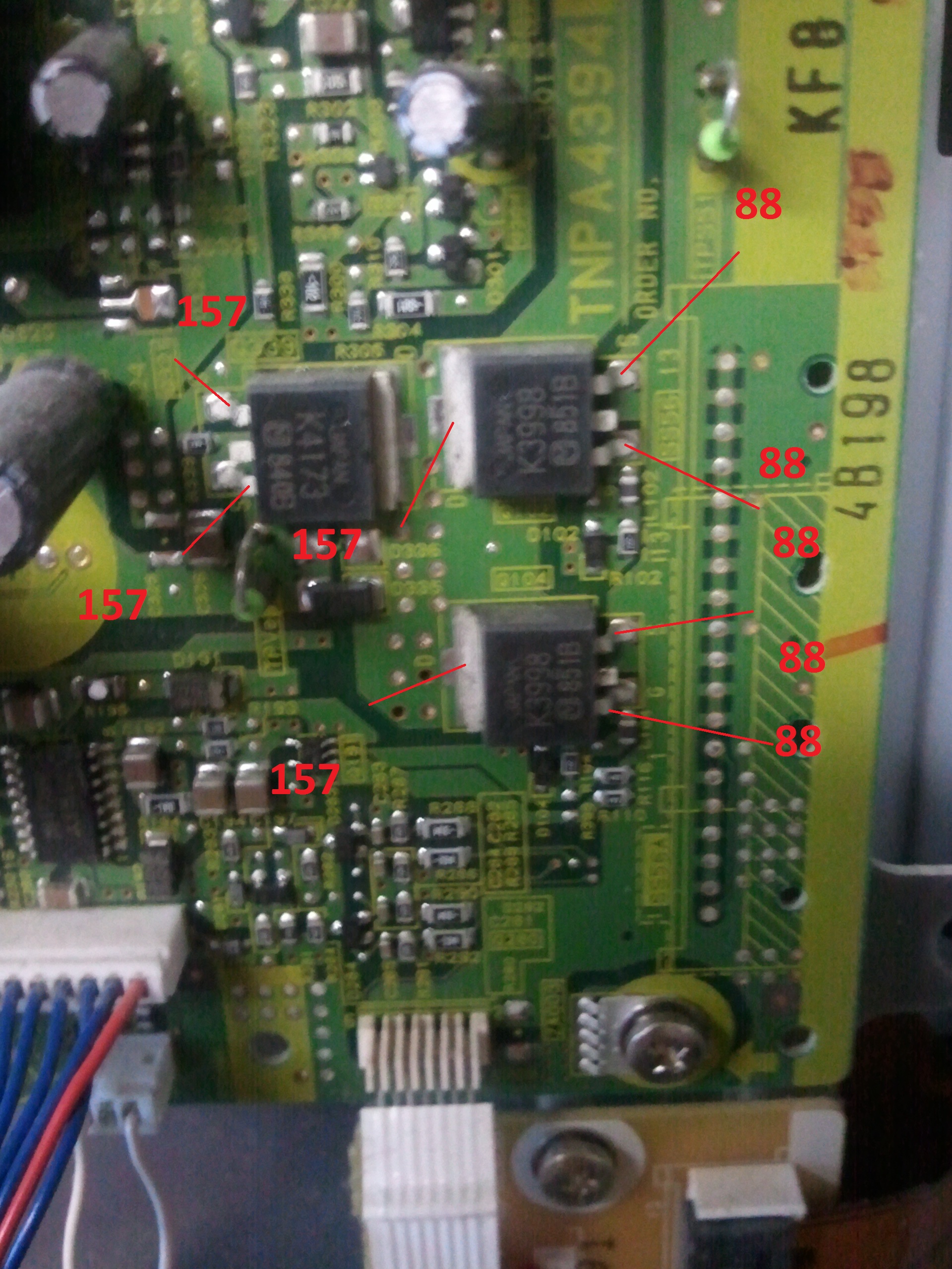

                              Green LEDs are indeed an indication of an OK board.
                              I realize that this looks to have an integrated D board so A board is really the only option. But just for kicks, just check those ribbons coming from the main.
                              Panasonics also are funny about not having any fuses (except on P/S) but I suppose that is they are confident in their voltage detection circuits to mostly do the job (and there are a bit more fuses on those power supplies than most).
                                It seems when the sustains on most TVs fail is on first power up (i.e. from cold), so the fuses are of no use -- PSU immediately enters current limit.
                                  I still get the " blue rain " don't seem to be any fuses at all on the mainboard. I have pulled the mainboard I will reinstall it making sure all the cables are connected well.
