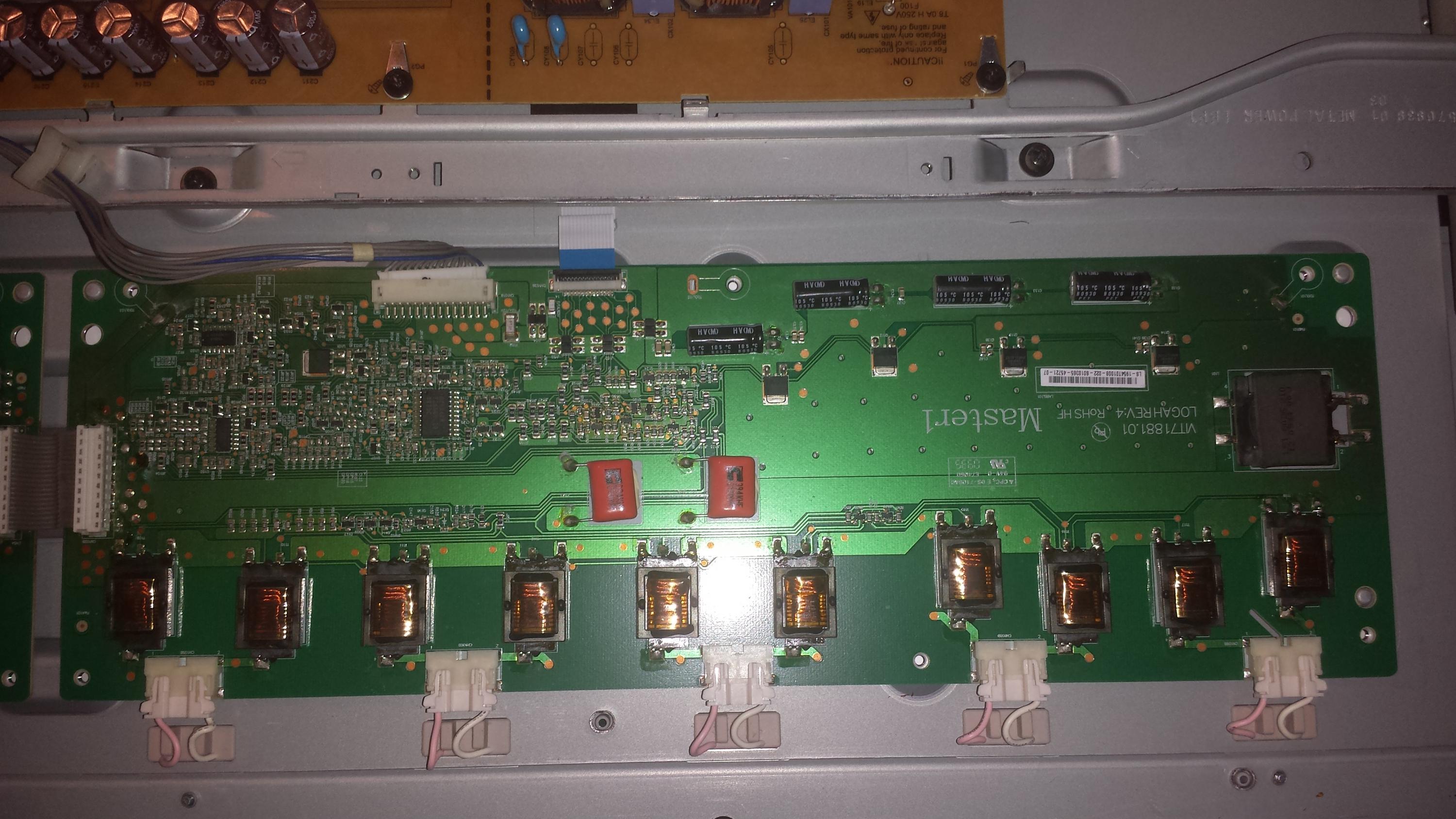

    LG 55LD520 wont turn on
    My LG 55LD520 recently stopped turning on. The red light at the bottom still comes on and when I push the power button it still turns blue but there is nothing on the screen. I took it apart and there doesn't seem to be anything burnt or any bulging caps. I started checking voltages and i was getting only 1 wire going to the main board with 3.5v so I unplugged the backlight inverter boards and I started getting all 12v and 3.5, but still there is no 24v at any of the pins going to the main board or to the back light inverter boards. what is my next step? I have attached pic. If you need any more let me know. Please help and thanks in advance.

    Re: LG 55LD520 wont turn on
    Please can you repost your pictures using manage attachments jpgs less then 3mb should work, then ask a mod to remove the offline ones.
    Maybe help to dust the board down and retake the pictures in better light without flash so we can see the components better.

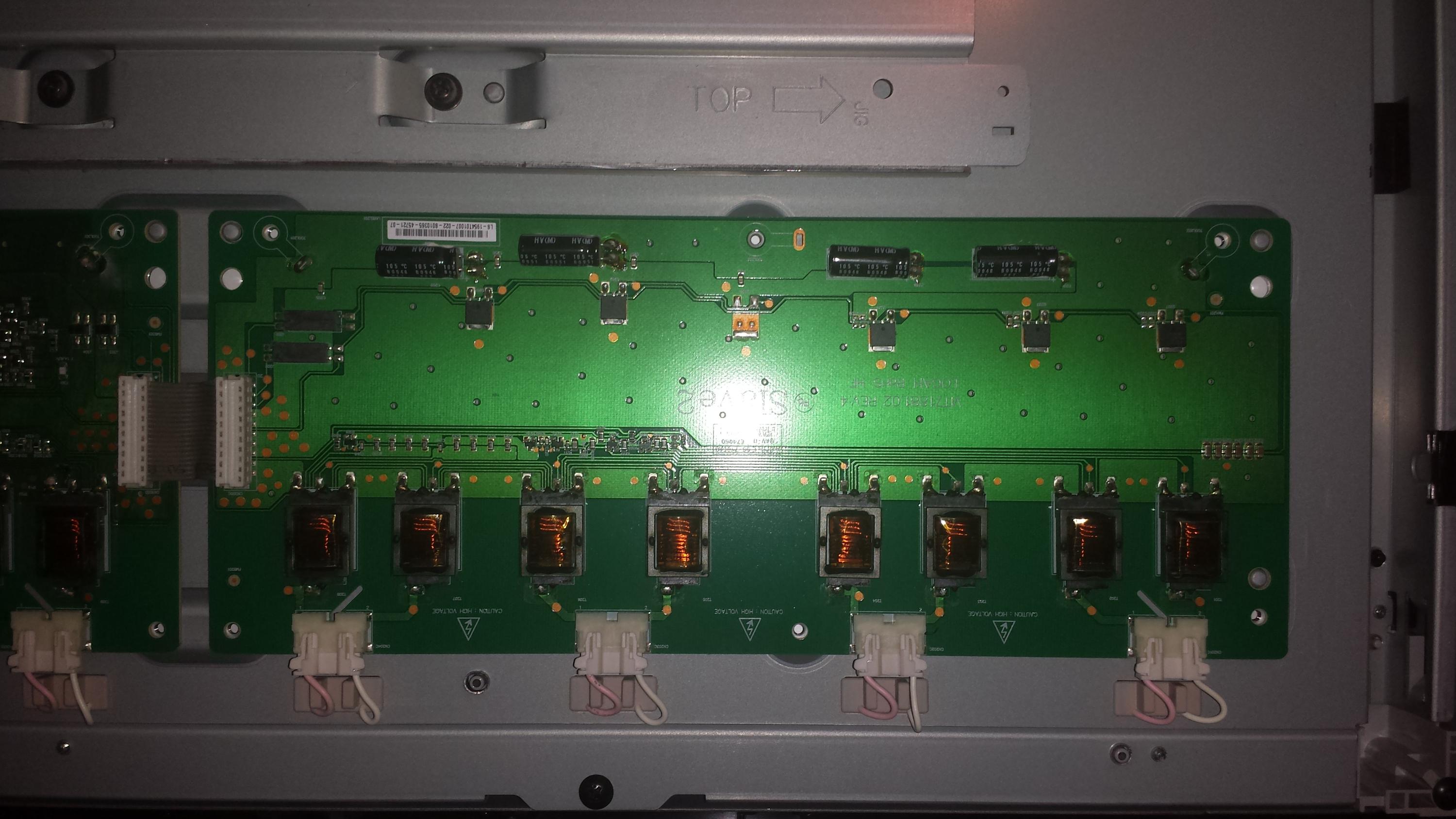

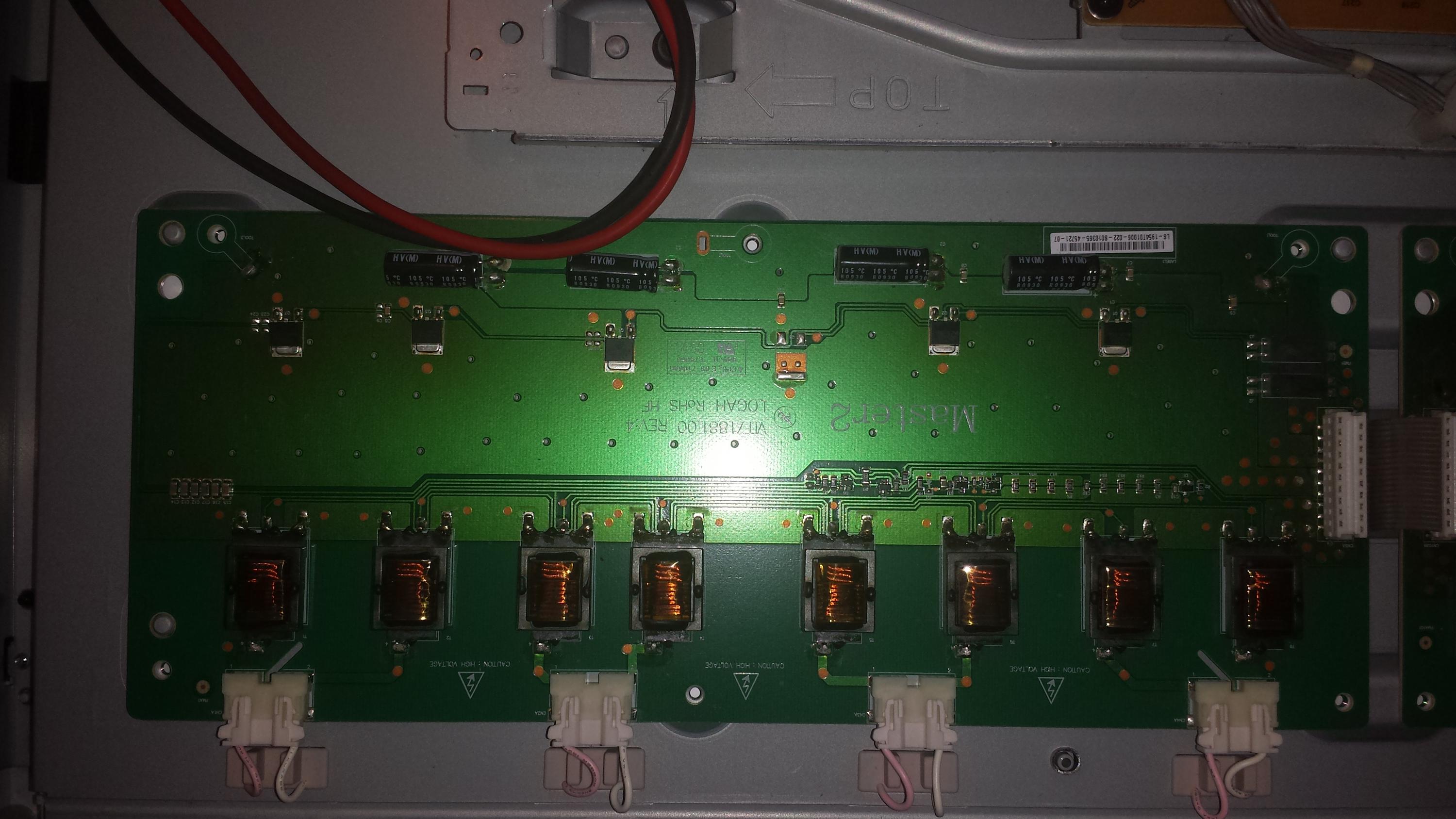

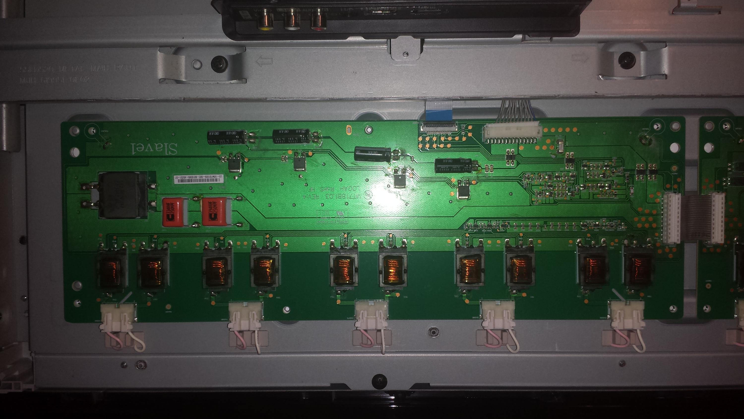

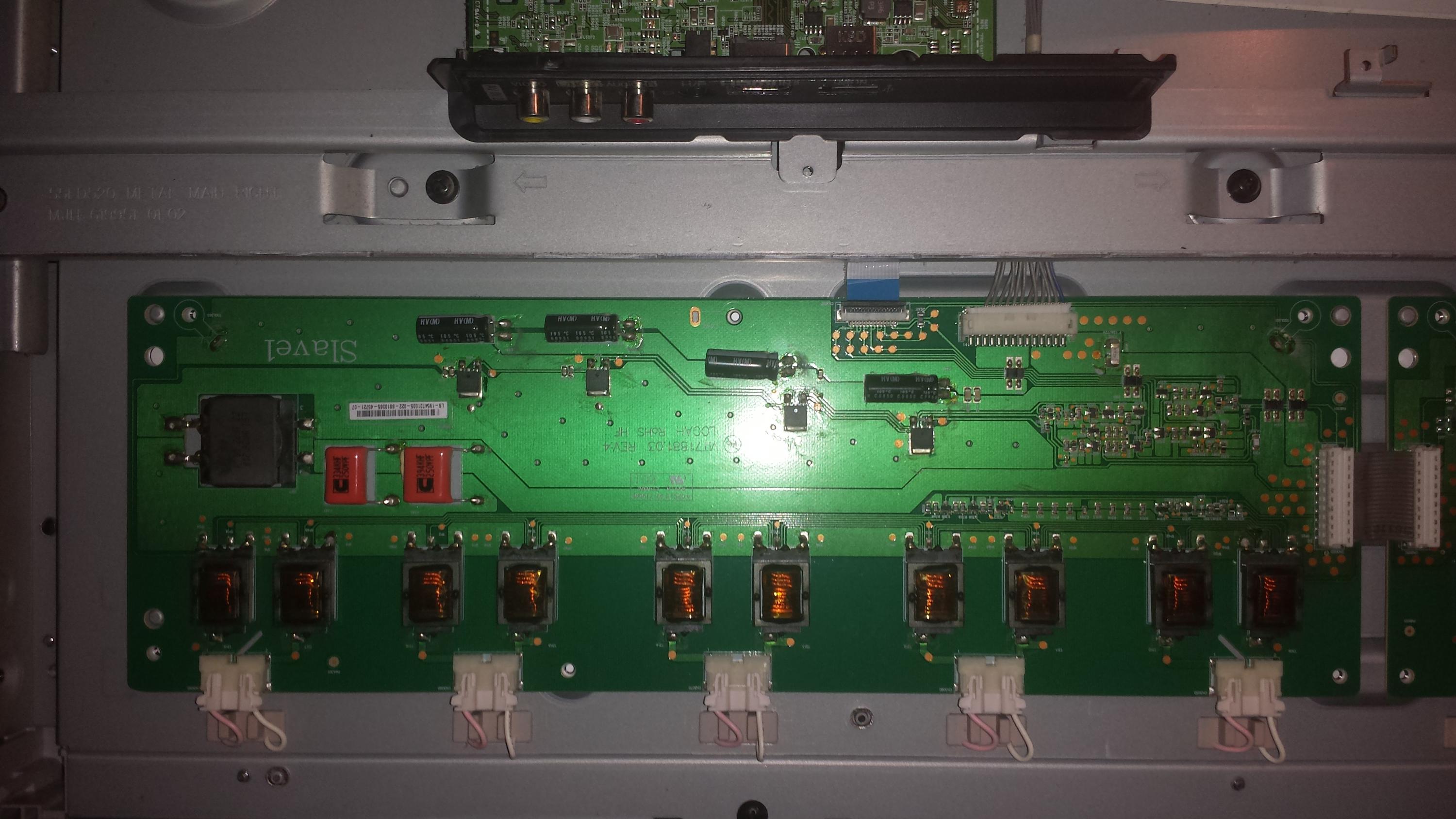

      Here are the pictures. I can not take pics without flash my camera doesn't work well without it. but here are some better pics.
        Has someone been resoldering the caps on the inverter board?
        Did you read this thread?
        https://www.badcaps.net/forum/showth...t=33900&page=1
          No they are original.
            OK as voltages drop off when inverter is connected it may be a shorted mosfet.
            This is mentioned in the other thread and there is a link to testing.
            I suspect there is no 24v because it will be stopped from starting by a protect circuit.
              There is no 24 even when the inverter boards are unplugged.
                Yes but unplugging the boards may be interpreted as a fault so protection might kick in shutting off the 24v
                Need to check the mosfets for a short.
                  You have a shorted mosfet on either the master or slave board. Bad design there are two types mosfets tied to switch neg/pos for the ac to transformers. Half the mosfets on each board switch positive and the other half switch the negative. If the timing gets screwed up both sets will turn on at the same time and burns up. Mine actually had cought fire. Look up the part numbers on the two types, you will see that they are opposite and the drains of all are tied together. I did not keep my notes, I remember it when I see that model tv

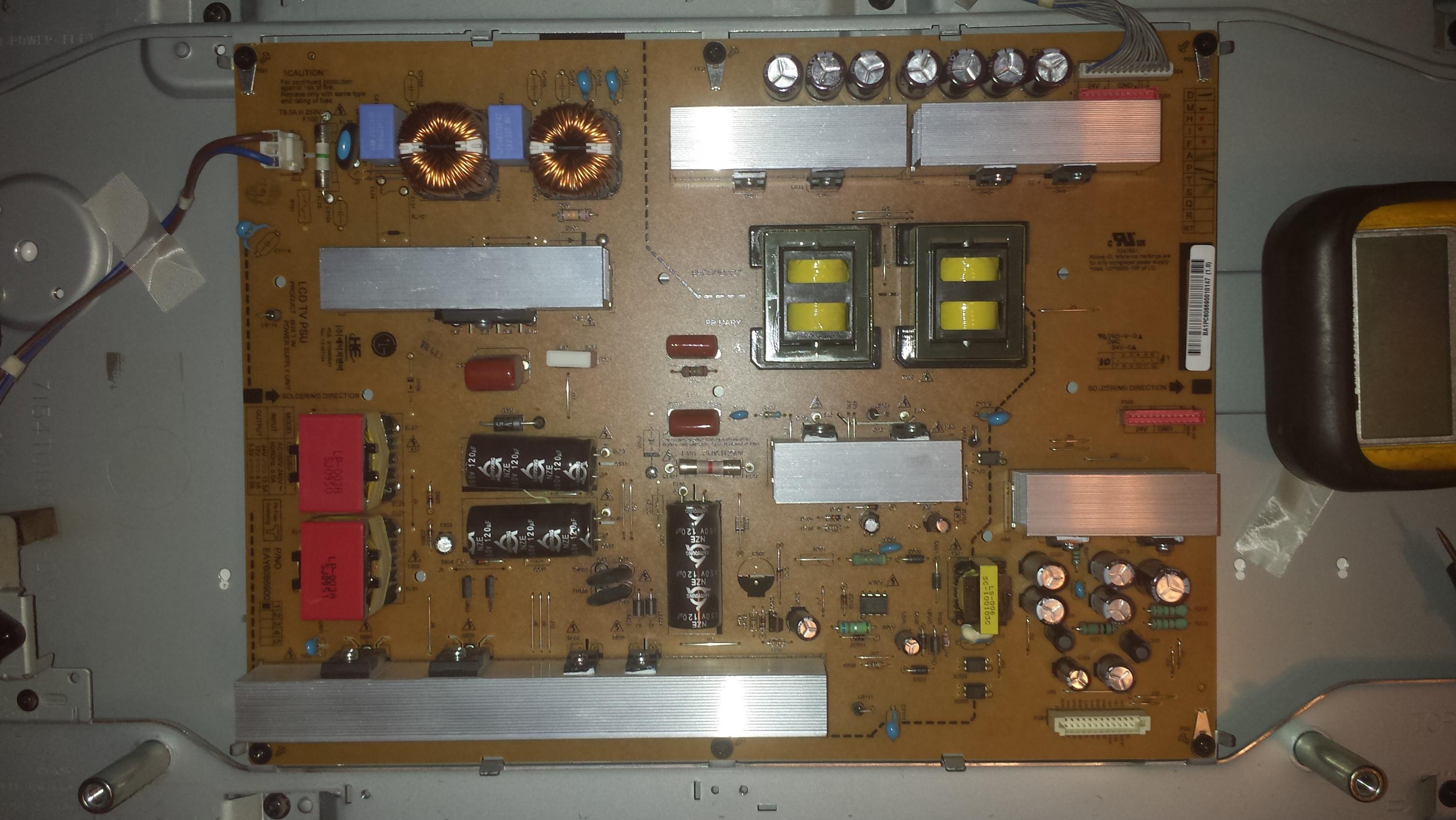

                      The 24VDC should be present (with or without the load) when TV is on and the PS_ON is present. What DC voltage do you get on the filter cap C613? it should be around 360~400VDC measure at the two legs of the cap. You can use two 12V car lamps in series as the load for the 24V.
                        I measured the voltage at those at all 3 caps and it was 393vdc. I have a question. If it was a mosfet on the slave or master board wouldn't unplugging them one at a time change something?
                          You should have the 24VDC without having the inverter boards connected, so you need to fix that 24VDC SMPS section first.
                            That is what I am trying get figured out. Any other ideas about what to check? On the bottom side of the board the traces that runto the 24v go to the long bank of caps by the heatsink.
                              Yes - according to Ltank - post13 in the linked thread I gave earlier
                                    Ok - but when you get the 24v back you can try again to narrow down which mosfet might be shorted.
                                    How about posting a picture of the bottom of the power supply. Is there any voltage on any of the caps in the row.
                                        Ok after a few minutes of checking I have narrowed it down to master 2. With it completely out the tv tries to turn on. The back light flickers. The weird thing is that it has to be taken completely out off the chassis. Even when it is just unplugged it still kills the 24v. How do I test the mosfets?
