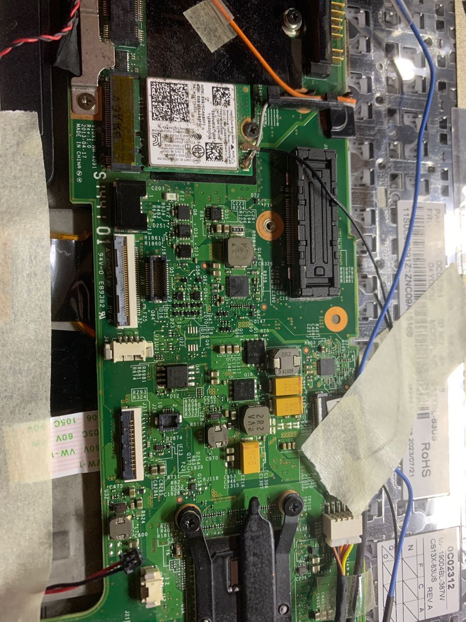

    lenovo x240 nm-a091 wont turn on
    i got this laptop with no power issue....i flashed the bios and laptop can turn on and use normally....but when i shut it down and rest for few minute (2-3 minutes), it wont turn on....i have to flash bios again...any idea what is the problem?...when i shutdown and suddenly press power button to turn on, it will turn on normally....problem happen when i rest the laptop 2-3 minutes after shutdown, it will not turn on....i need to flash bios again
    board number VIUX1 NM-A091 REV:1.0
  • mcplslg123
    • Jun 2015
    • 7262
    • india
    When its not turning on,just heat up the area around PCH(smaller die of SOC) and not on top of it. Try turning it on again. Does it turn on?
    • dqtech
      Badcaps
      • Jul 2018
      • 632
      • N/A
      yes it does turn on when i reflow processor....but after few minutes shutdown cannot turn on again.....i replace processor and laptop working normally right now
