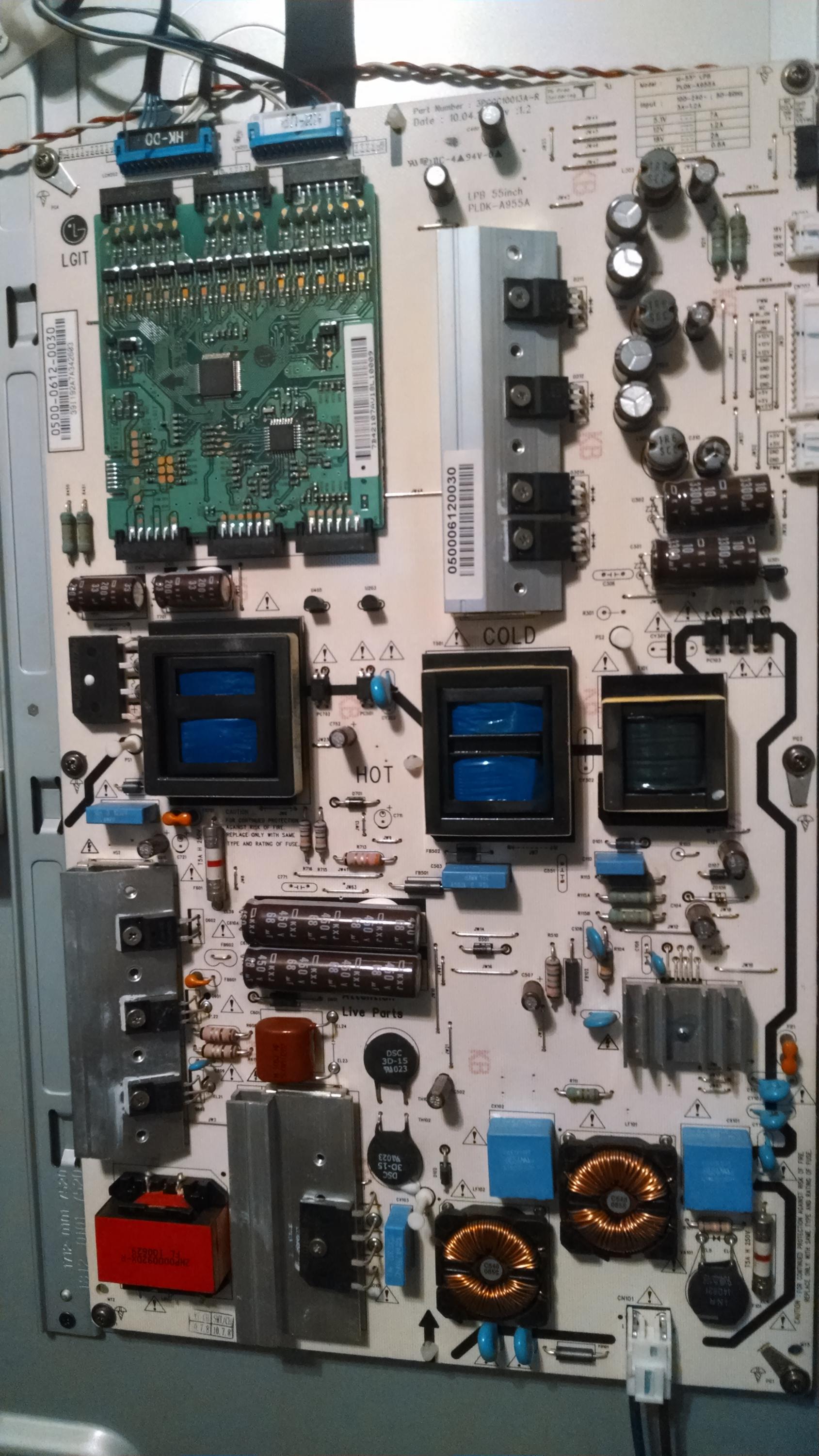

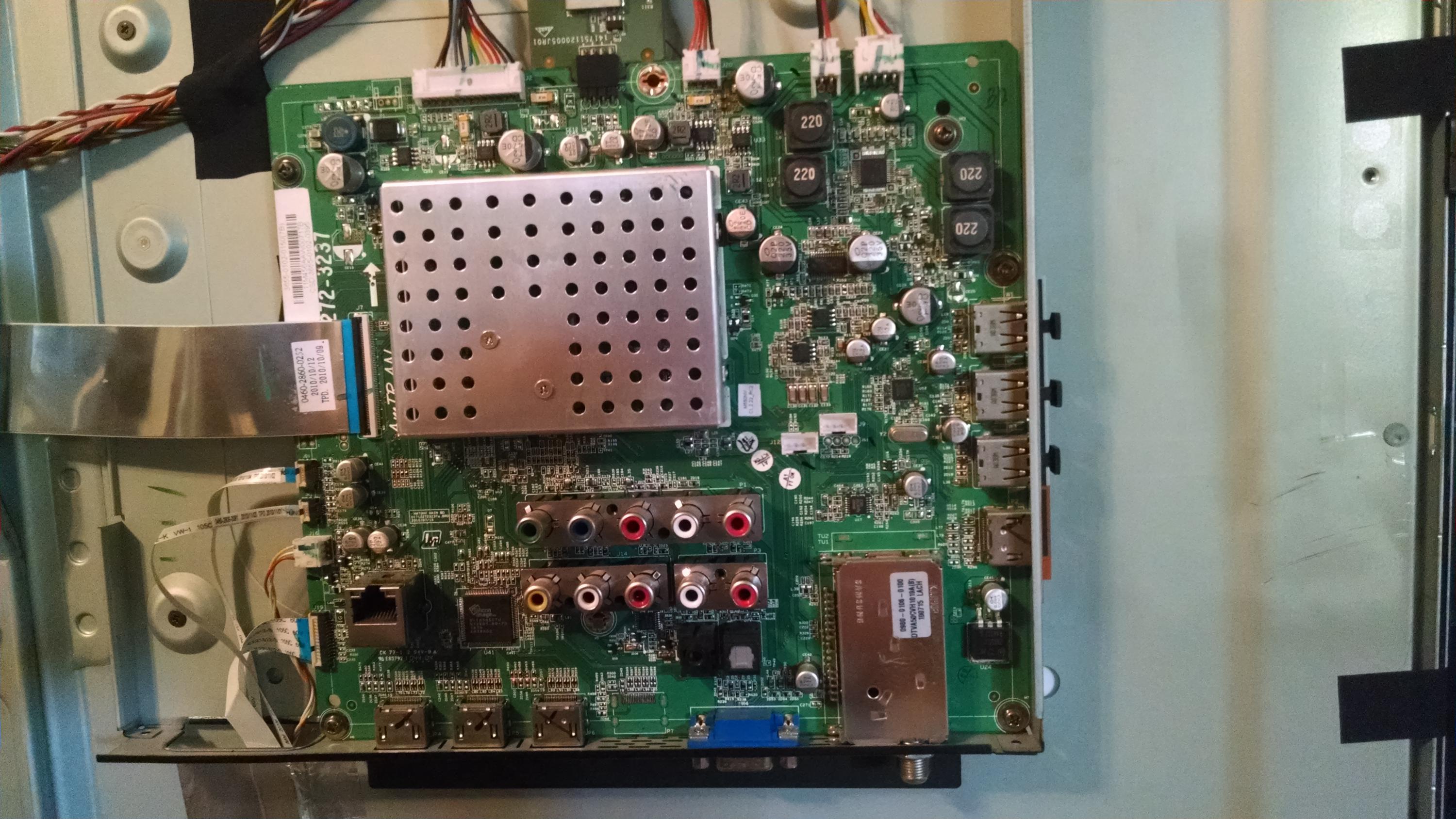

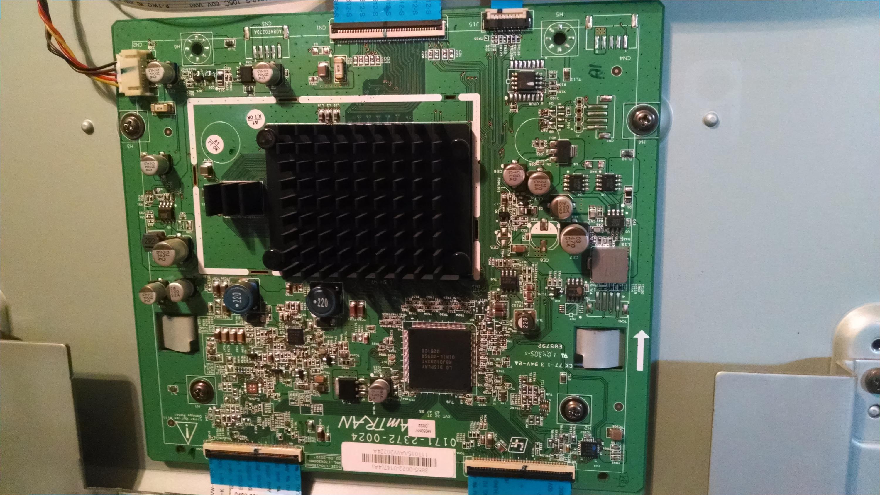

    Okay folks I know there have been a few on this t.v before and believe me I have read them. I have already inspected caps and there do not seem to be any bulging at all. Here is what happens. I plug the television in the logo does the white / orange flash for an extended period of time. Then I am able to power the tv on and I get the Vizio startup screen (Non-responsive) to anything and then it powers itself down and backon again in an endless loop unless I unplug. Of course here are the pictures.

          under the metal shield, TSOP48 memory chip, smart TV.

            Thank you and through some testing I have come back to the power supply with a few issues. I think there may be more than one failure on this television possible voltage regulators so until I get the time to chase all of that down. I guess I am in a holding pattern.

                replace the main board, EEPROM is most like the problem but its a smart TV. So the it need to be reprogram by Vizio.

                  I ended up replacing the power supply but it did not resolve the issue. No change in the problem now I wonder did I purchase an equally defective power supply or could it in fact be the mainboard. This has been the most stubborn tv to day as just about everything checks fine on the thing. grrr.

                      I replaced the mainboard and yes that fixed the problem. I did however swap old power supply back in and the tv stopped working so apparently something was wrong with both boards. Power Surge perhaps?

                              I came across a Vizio M550NV that was stuck on the "Vizio logo" when powering on. I remove the metal shield to access the flash memory chip. I wanted to re-solder the flash memory chips to see of any changes, but there was none.
                              I purchase a working replacement main board for the M550NV. So I removed the flash memory chip from the working board and place it on the non working main board to confirm the problem and the memory chip was the problem and the TV power up fine.
                              So I copy the working flash memory with my programmer and copy to new memory chip.
                              The copy flash memory chip works on the fail board, no more stuck on logo. All apps are working and the TV is functioning great !!!

                                    TV went out but backlight is still on. No Vizio logo at startup though. Replaced T-Con board. No luck. Now I think it is the main board that is the issue.

                                      I too have now replaced the TCON board and the main board. I just purchased the power supply board- if this doesn't work then I'm SOL.
