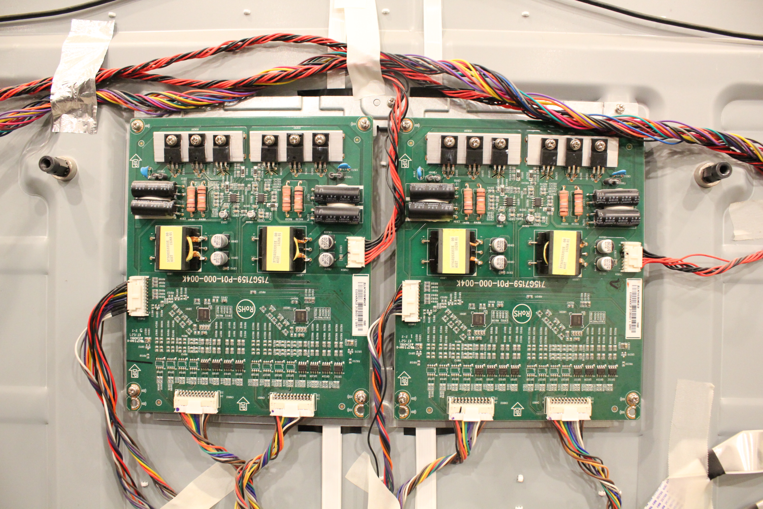

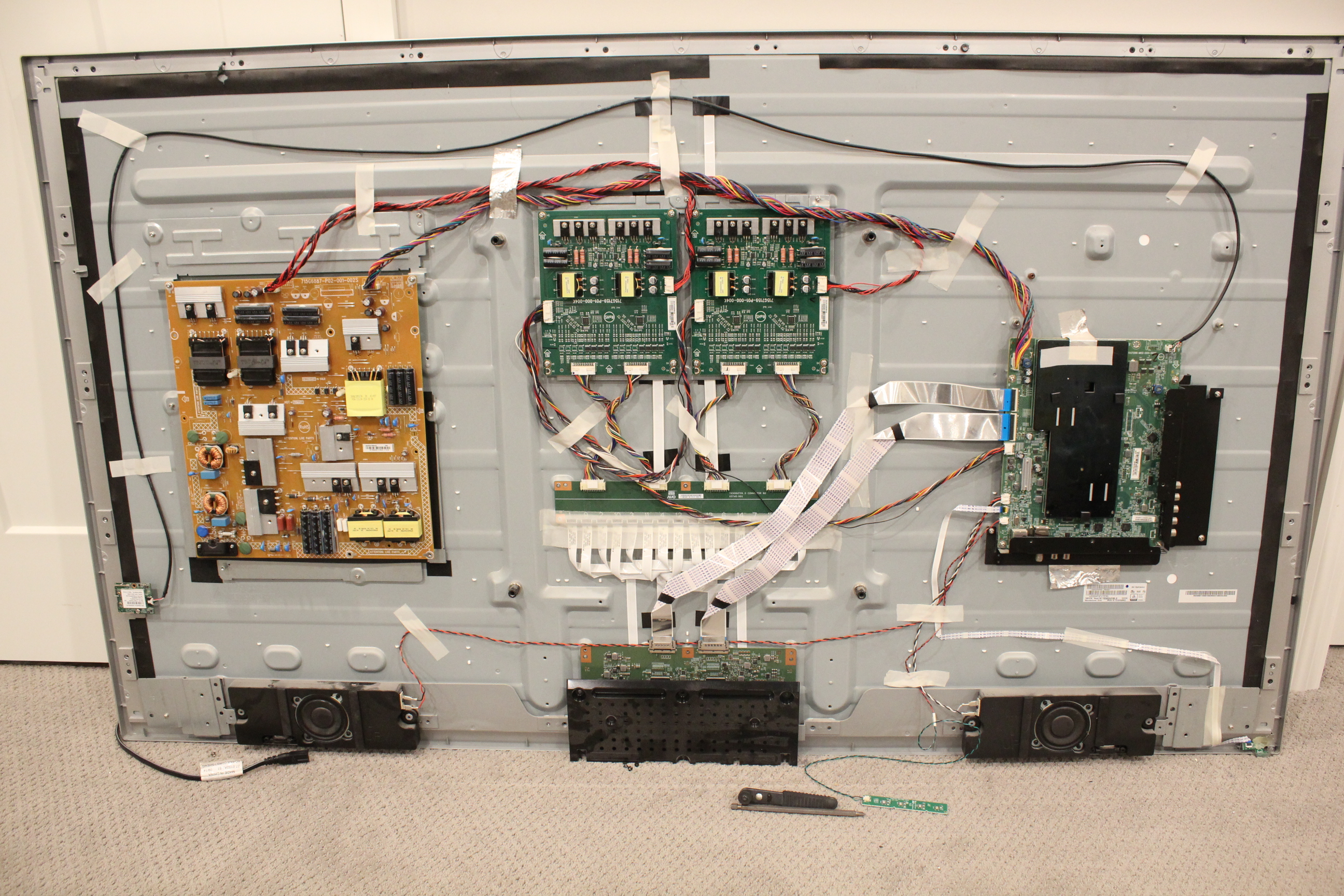

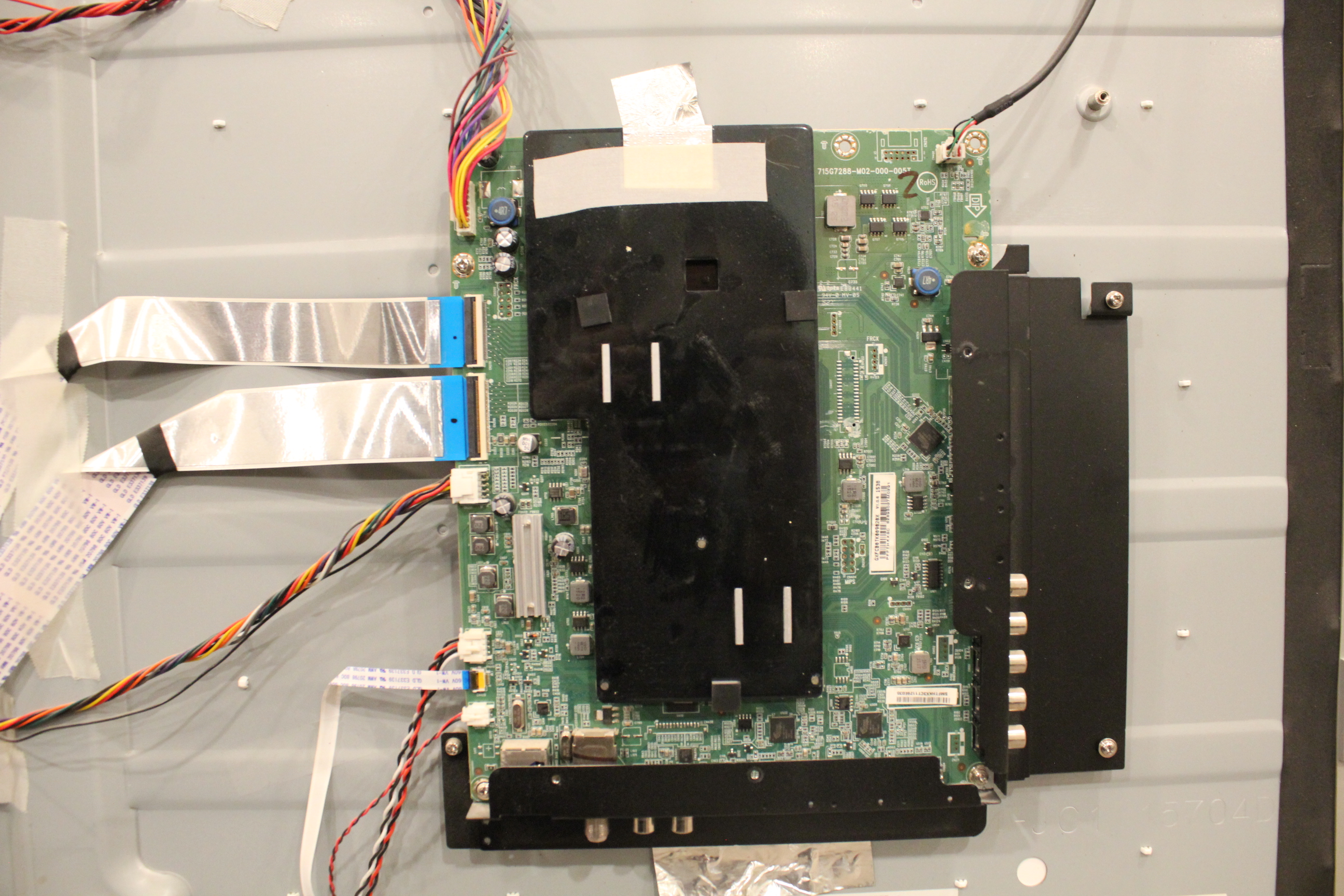

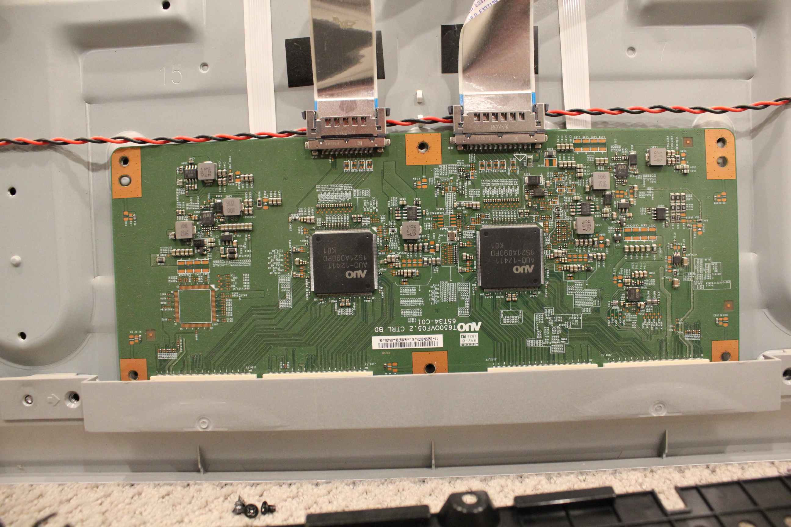

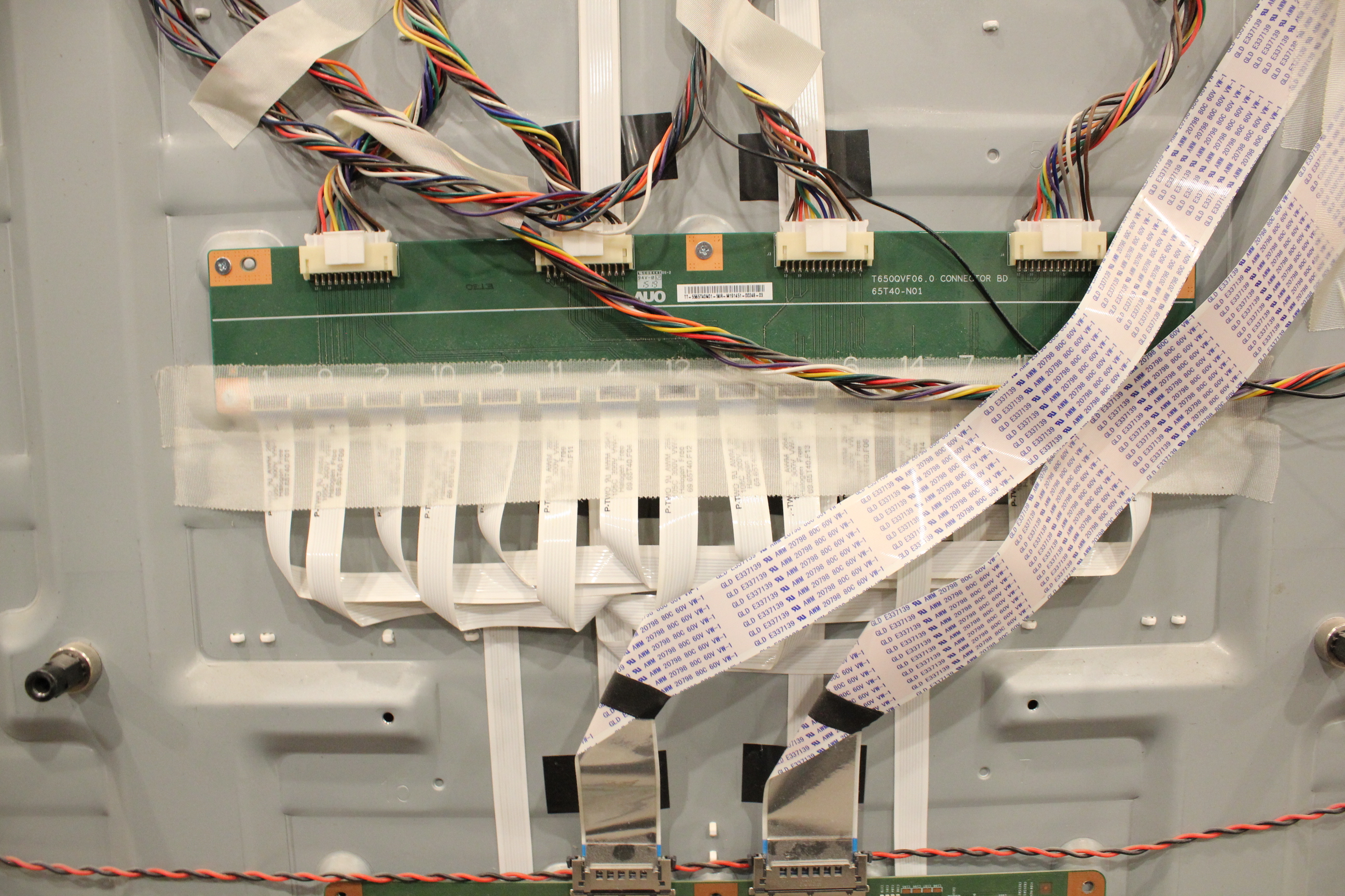

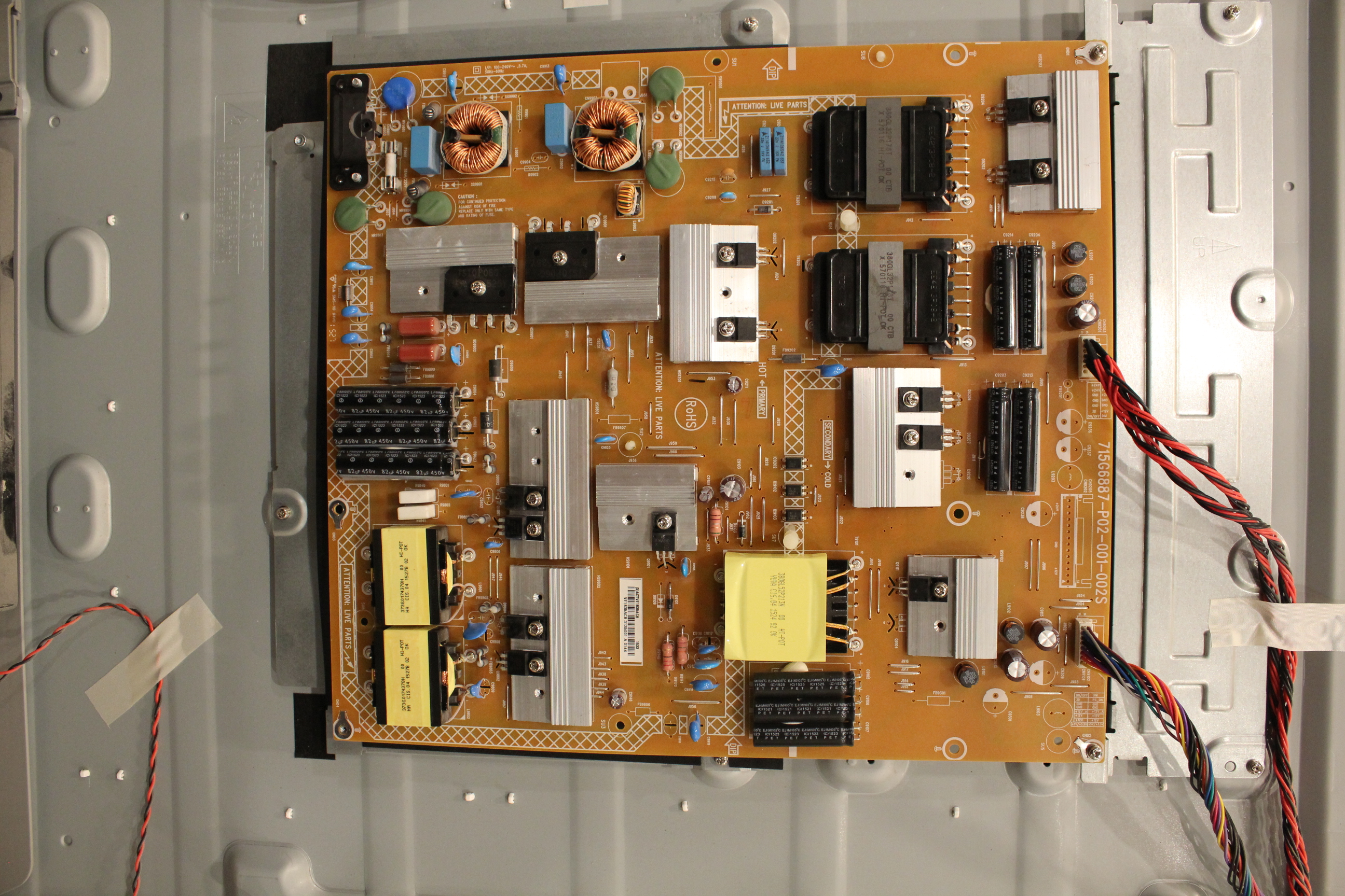

Vizio M65-C1 | Logo appears for 10 seconds then off
  • Bob1394
    • Feb 2023
    • 4
    Vizio M65-C1 | Logo appears for 10 seconds then off
    I have used the search, and am stumped.
    My Vizio M65-C1, Vizio logo appears for about 10 seconds then goes off.Power LED blinks 15 times then the TV powers down.
    I have read through many threads on the M65-C1 including the following threads. I feel like I must be looking right past the solution to my problem:
    https://www.badcaps.net/forum/showthread.php?t=81088
    https://www.badcaps.net/forum/showthread.php?t=84241 (not clear on the Eprom actions)
    Observations
    1) [Interaction] Power turned on via TV button (or remote)
    2) [Observe] The white external facing power LED illuminates and screen turns on with the Visio logo.
    3) [Observe] Within about 10 seconds the logo goes off, the backlight is off, and CN9101 pin #15 is still at 3.22 volts (I believe this means calling for the backlight to be on).
    4) [Observe] About a minute after the logo goes away and the backlight, the white power led flashes 15 times.
    5) [Observe] A short while after the power led flashes, the TV powers itself down. Confirmed by checking voltages across key pins and observe the "power off" voltages.
    Pin Voltages
    CN9101 -____________OFF______ON
    PIN 1 - +5V/+3.5V__5.12V_____5.14
    PIN 3 - +12V -______19.17V___19.13
    PIN 5 - +12V -______19.17V___19.14
    PIN 7 - +12V_A _____19.17V___19.16
    PIN 9 - GND -________0V______0
    PIN 11 - GND ________0V______0
    PIN 13 - 3D _________0V______0
    PIN 15 - ON/OFF _____0.1V____3.22
    CN9102 -
    PIN 2 - +5V/+3.5V -__5.12V___5.14
    PIN 4 - +12V - ______19.17V__19.16
    PIN 6 - +12V - ______19.17V__19.14
    PIN 8 - +12V_A -_____19.17V__19.16
    PIN 10 - GND -_______0V______0V
    PIN 12 - GND - ______0V______0V
    PIN 14 - PS_ON -_____0.5V____3.68
    PIN 16 - DIM -_______0V______3.27
    CN9201 -
    PIN 1 - ON/OFF - ____No Wires Leaving Header
    PIN 3 - 3D __________No Wires Leaving Header
    PIN 5 - GND _________0V______0V
    PIN 7 - GND _________0V______0V
    PIN 9 - GND -________0V______0V
    PIN 11 - +24V - _____0.01V___24.24V
    PIN 13 - +24V - _____0.01V___24.24V
    CN9203
    PIN 2 - DIM - _______No Wires Leaving Header
    PIN 4 - +12V - ______No Wires Leaving Header
    PIN 6 - GND - _______0V______0V
    PIN 8 - GND - _______0V______0V
    PIN 10 - +24V -______No Wires Leaving Header
    PIN 12 - +24V -______0.01V___24.24V
    PIN 14 - +24V - _____0.01V___24.24V
    Photos of boards attached.
    Thank you for any advice and direction you can provide.
  • nomoresonys
    • Jan 2013
    • 12307
    • U.S.
    Re: Vizio M65-C1 | Logo appears for 10 seconds then off
    those powerboard voltages look good to me, how about a picture of the whole back, as to see how everything is connected.
    • nomoresonys
      • Jan 2013
      • 12307
      • U.S.
      Re: Vizio M65-C1 | Logo appears for 10 seconds then off
      you don't have the same problem as either of those threads, you don't have any obvious issues with your voltages as they did.
      • nomoresonys
        • Jan 2013
        • 12307
        • U.S.
        Re: Vizio M65-C1 | Logo appears for 10 seconds then off
        might be a backlight/backlight circuit issue.
        • Storyteller12
          • Jun 2020
          • 625
          Re: Vizio M65-C1 | Logo appears for 10 seconds then off
          Most likely BGA chip Do you have a heat gun? If not use hair dryer and heat up large heatsink over each chip for 45 sec to a 1-1/2 min. Real common problem on Vizio “m” series
          • Bob1394
            • Feb 2023
            • 4
            Re: Vizio M65-C1 | Logo appears for 10 seconds then off
            Photo attached of entire back to show wiring.
            I do have a heat gun, am aware of this technique for reflowing solder for ICs. I am going to give this a try, though want to research the techniques for success a bit. :-)
            • diif
              • Feb 2014
              • 6978
              • England
              Re: Vizio M65-C1 | Logo appears for 10 seconds then off
              Buy yourself a cheap thermometer, a TM-902C off ebay is under $10.
              Lead free solder melts at 218C/424F, use flux.
              • Bob1394
                • Feb 2023
                • 4
                Re: Vizio M65-C1 | Logo appears for 10 seconds then off
                Originally posted by diif
                ___
                Fixed. Solution:
                1) Protected nearby electronics with aluminum tape (had on hand. Kapton likely better to use).
                2) Applied reballing liquid flux around edges of the BGA chip (board has two BGAs, did this process on them seperately)
                3) Used 1500 watt heat gun at roughly 6" away. Moved in circular motion.
                4) Once I reached a temp of 150*C or 302* F, I slowly moved the heat gun closer and bring the temp to 235* C or 455* F. Advice I found online indicated not to apply this amount of heat for more than 4 minutes.
                5) Then I let the BGA and card cool down to room temperature.
                6) Remove tape and protections. Reassemble (don't forget to clean the heatsinks and add new heat transfer paste). Win.
                TV has been working great for the past few weeks since repaired.
                Thank you for you input and advice. You have helped saved a TV from the landfill. :-)
                Last edited by Bob1394; 03-04-2023, 11:08 AM.
                • alfatv
                  • Sep 2020
                  • 353
                  Re: Vizio M65-C1 | Logo appears for 10 seconds then off
                  Originally posted by Bob1394
                  . Advice I found online indicated not to apply this amount of heat for more than 4 minutes.
                  Yes, the internet is full of experts.
                  There are already proven reflow profiles developed by industry.
                  https://en.wikipedia.org/wiki/Reflow_soldering
                  That's reason you need thermometer and the clock is also not hard to find.
                  • Super360
                    Vizio E701i-A3 Vizio logo flashing then turns off
                    by Super360
                    Ok so here's the story. I was watching tv one day when all of a sudden I heard a pop from the back of the tv set and rushed to unplug the set. By this time the tv already had smoke coming out the back. It was not storming or inclement weather that day to cause a power surge to the best of my abilities. When I opened the tv up, I found that the three capacitors on the psu (highlighted in red) were all bulging and looked they had exploded. I replaced all of them right away and when I went to start up the tv after the "fix" it started just showing the flashing vizio logo as soon as power...
                    07-25-2024, 07:06 PM
                  • x_orange90_x
                    Vizio V555-G1 stuck on wallpaper; now stuck on V logo
                    by x_orange90_x
                    I just got this tv today and it's getting stuck on the wallpaper. When I first power it on it goes to the V logo, then a black screen for about 15 seconds, then a Chromecast error for just a few seconds, and then finally to a wallpaper. It stays frozen on this wallpaper and does not respond to anything on the remote besides power on/off. Likewise the buttons on the tv do nothing either (besides power). I did the "reset" by holding the volume down and input buttons together for 10 seconds. It showed a message at the top of the screen saying it was Wiping Data and would restart soon. After...
                    12-28-2023, 06:26 AM
                  • JaquesPratt
                    Vizio D32f-E1 Powers on, has backlight, won't boot/no logo, no menu or video
                    by JaquesPratt
                    I have a Vizio D32f-E1 LCD TV that does NOT have a TCON board.
                    This TV recently went through some 'death throes' and now won't boot. The first problem that began to manifest was while watching tv, the screen would 'freeze', and the image would dim over a few seconds until it was very dark. HOWEVER, the audio of the show would continue as normal. I could power off the TV for 5-20 seconds, power back on, and the video would be normal. This would occur 1-3 times when the TV was first started, and would not happen again after the TV was 'warmed up'. Not ideal, but this glitch was manageable....
                    07-16-2024, 01:04 AM
                  • Teban1306
                    [REQUEST] ThinkPad T14 Gen 1 (20S1) - Custom Boot Logo Modification
                    by Teban1306
                    [REQUEST] ThinkPad T14 Gen 1 (20S1) - Custom Boot Logo Modification
                    Hello everyone!
                    I hope this is the right section for this request. I'm looking for help to modify the boot logo on my ThinkPad T14 Gen 1.
                    System Information:
                    • Model: Lenovo ThinkPad T14 Gen 1
                    • Machine Type: 20S1S4E600 (Intel i7 variant)
                    • Current BIOS: N2XET42W (1.33) - Latest version
                    • BIOS File: n2xuj25w.exe (12.98 MB) - Downloaded from Lenovo support
                    What I'm trying to achieve:
                    Replace the default "LENOVO" boot logo with a custom image during POST.
                    🔧 What I've tried:
                    09-14-2025, 11:49 AM
