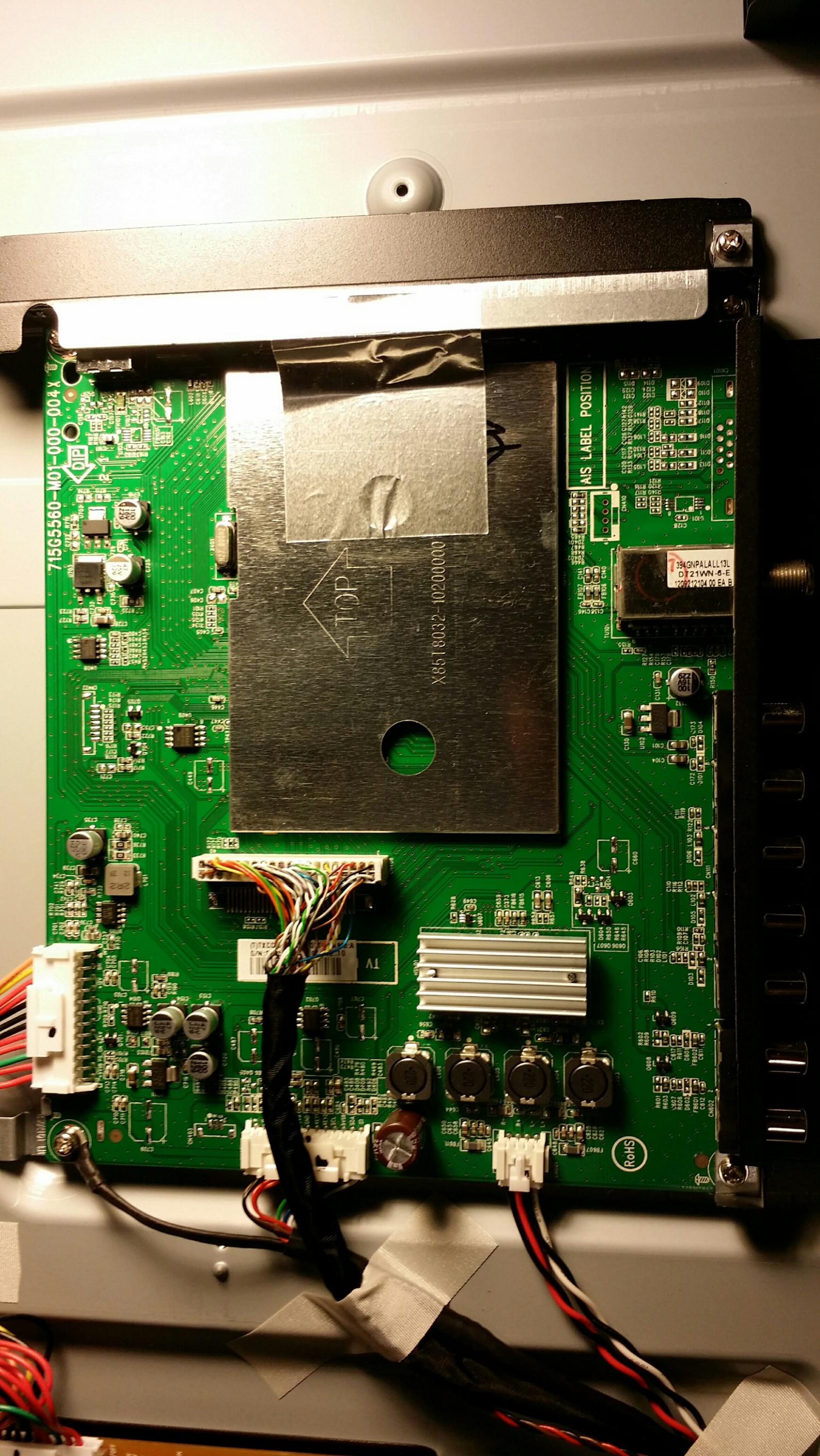

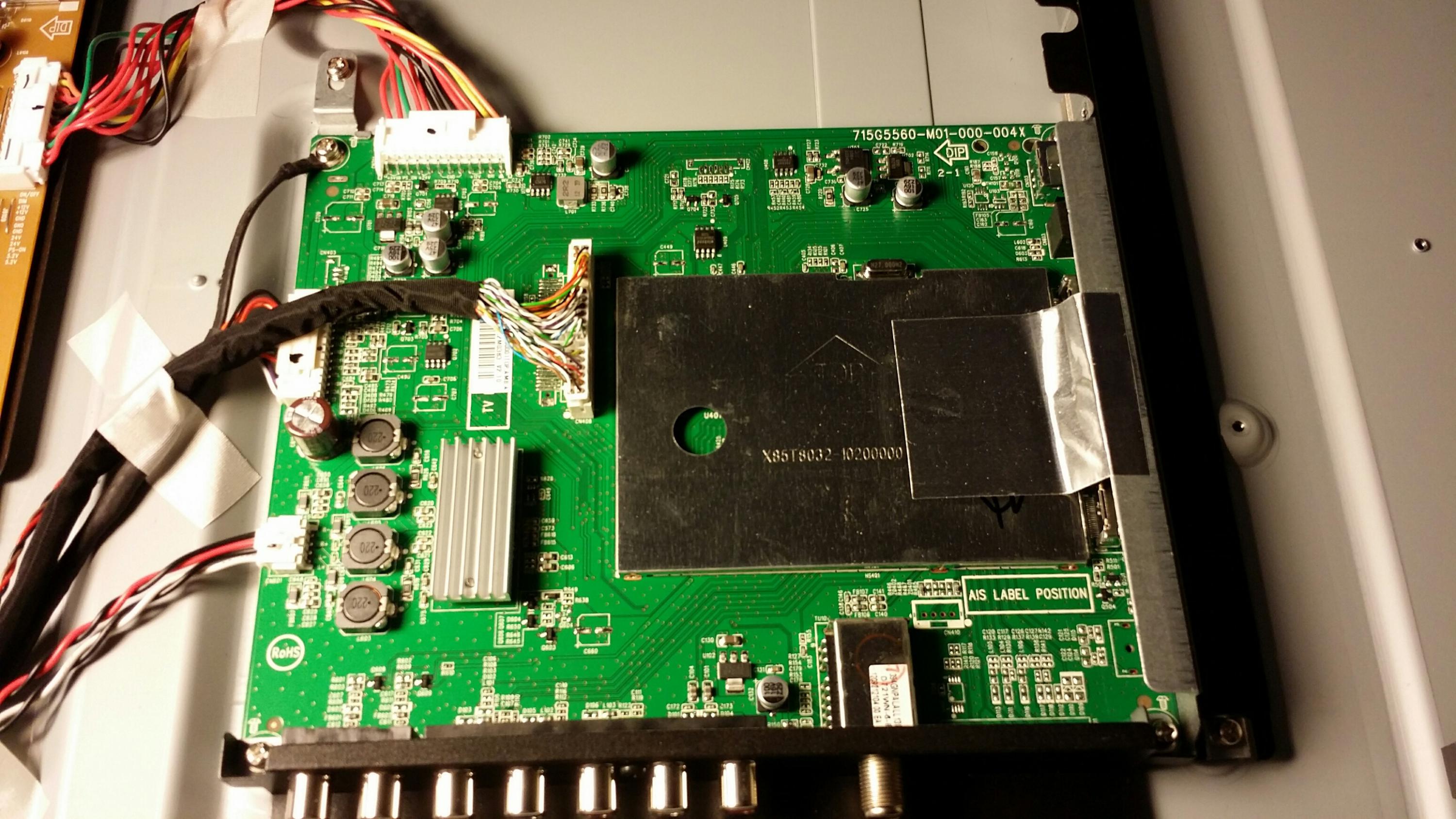

    I am looking at a VIZIO Razor 46" LED LCD tv that is only 1.5 years old. this tv was purchased at Costco but the customer was told that the TV only has a 90 day warranty. I have pictures and tests.

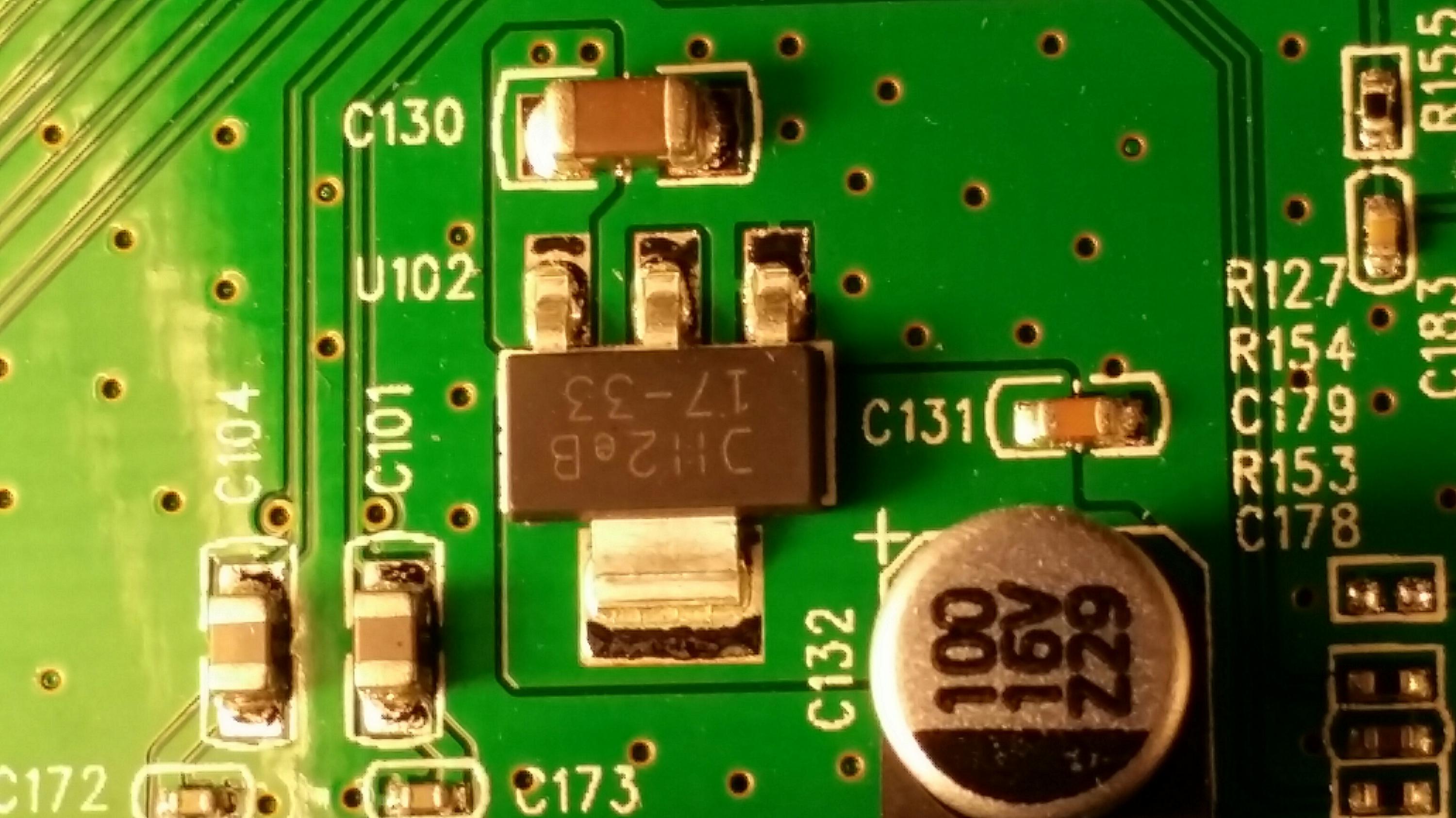

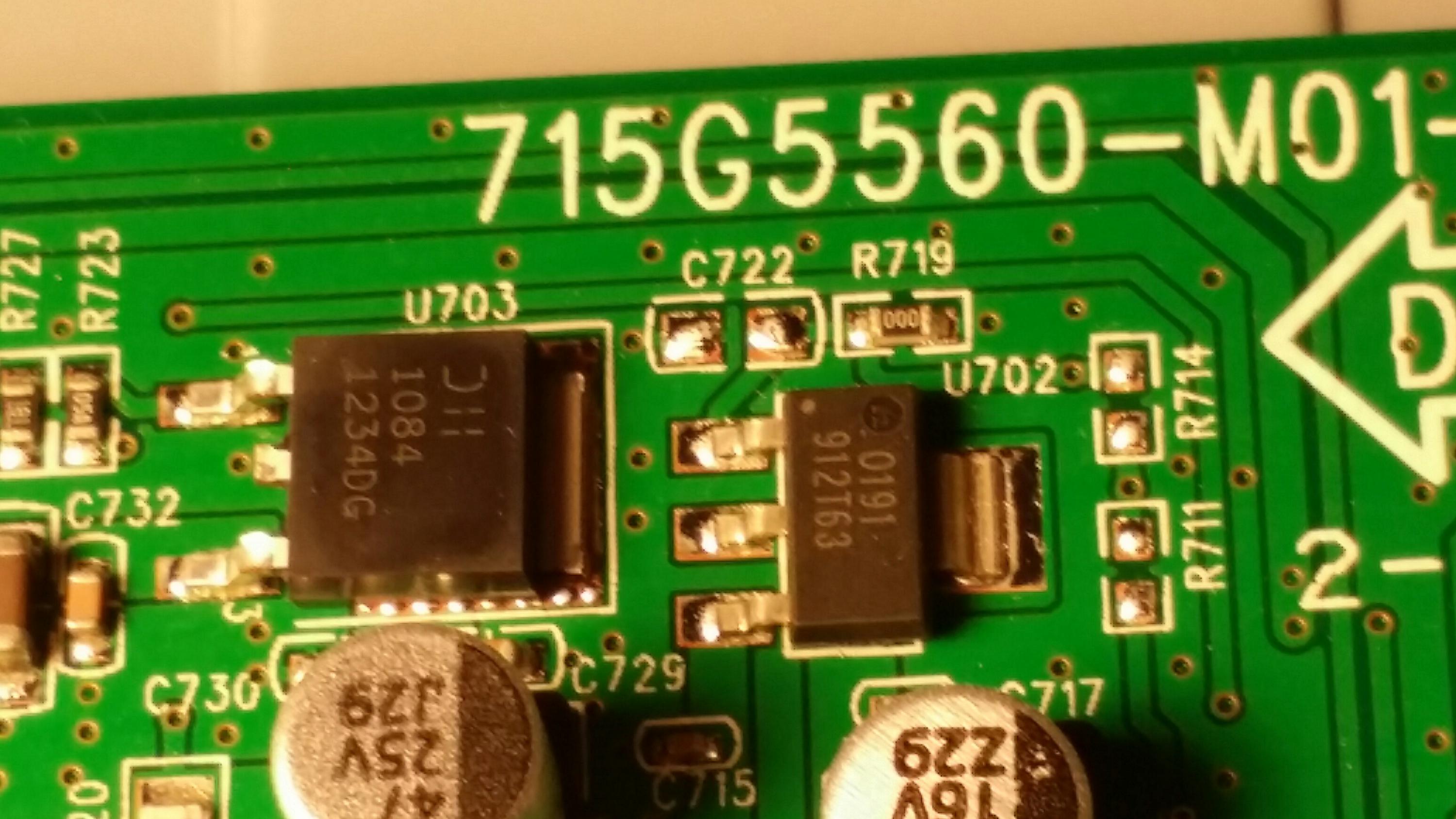

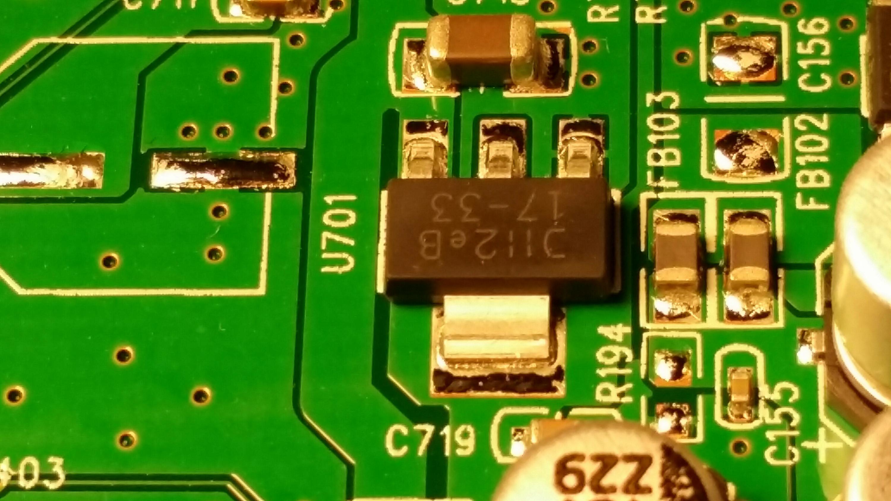

    U701 5.2 3.2 0
    U702 3.2 1.2 0
    U703 5.1 3.2 0
    U102 5.1 3.2 0

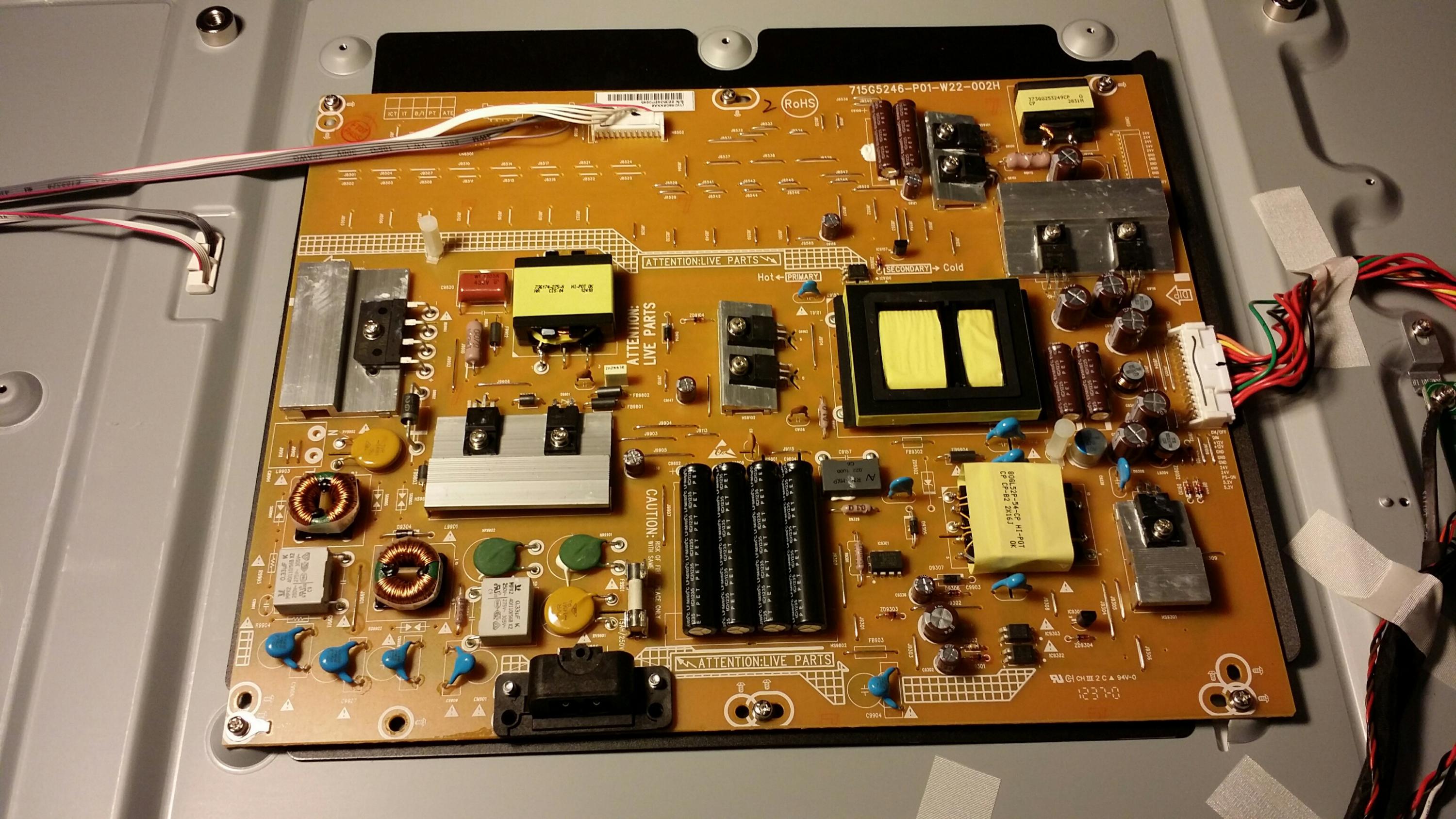

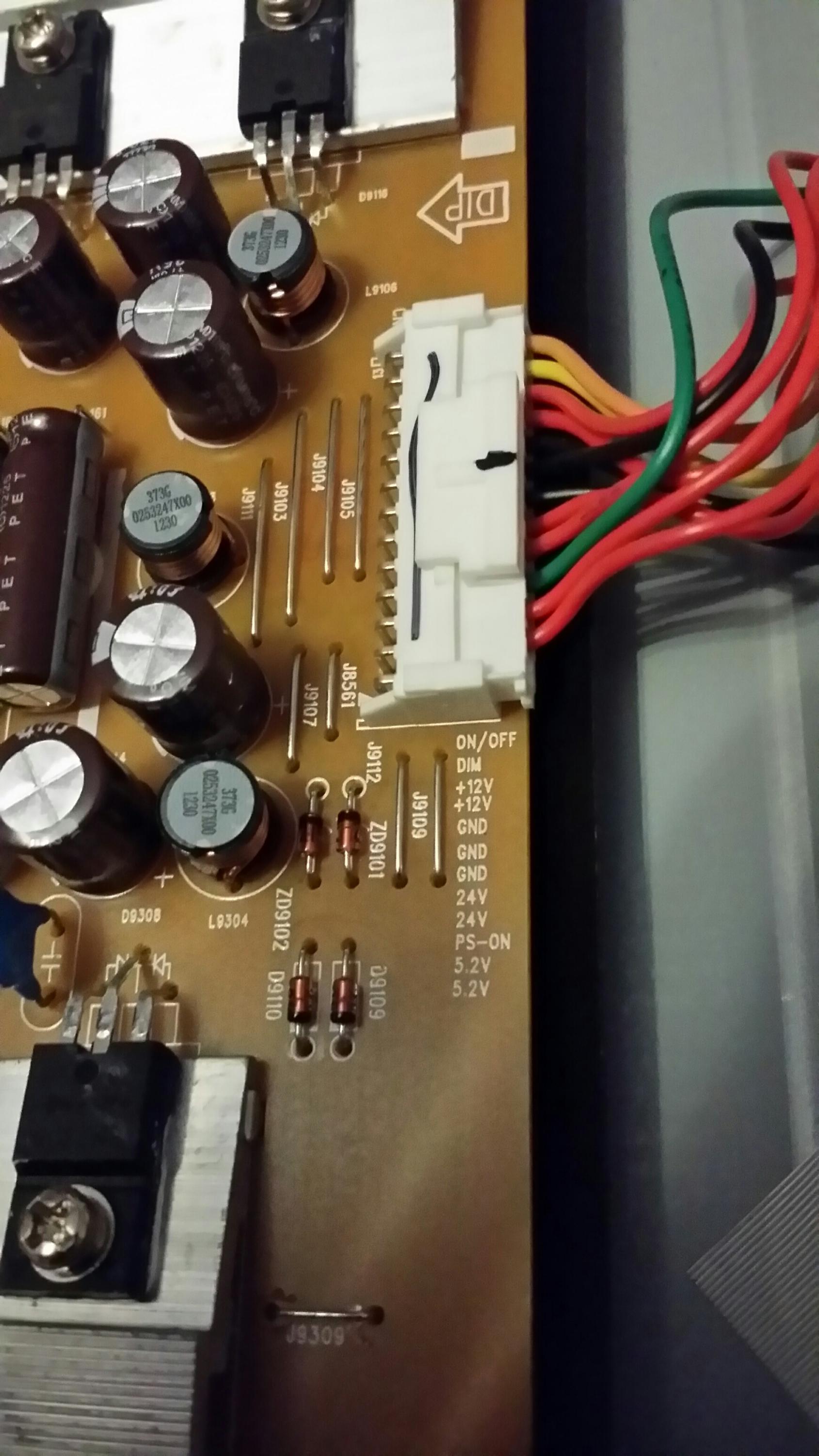

    power to main board I have all correct voltages
    11.8
    24.2
    5.1
    not sure where to look next.
    so the tv turns on and the led lights up white but no picture or sound. and no backlight.

    Does anyone know where I can get a service or training manual on this new of a tv. I have tested all of the voltage regulators but not sure if any of them are wrong. I tested the main rectifier when the tv was plugged in but off. and it is 168 vdc. when I push the power button that changes to 123vdc. once the tv is on the power led lights up. but the tv at this point won't turn off. the led stays lit no matter using the remote or the button on the tv to turn it off. when I unplug the tv and then let is sit and then plug it in the power light goes on and then slowly goes out.

      Re: Vizio E461-A1 no picture or sound
      Vizio SMs are like hens teeth. Here is a guide to VRs
      https://www.badcaps.net/forum/showthread.php?t=22231
      Whilst all a little low 0.05 to 0.1 they look as if they will be ok.
      Chances are it is the eeprom many cases of that being the problem on unresponsive vizios.
      There is even an after market for them which is an indication of how many are bad.

                          I am working on this same model set for a friend and it is completely dead. Power supply voltages check out ok, however when I push the power button on either the set or the remote absolutely nothing happens. I suspect it's also the EEPROM. I located it on the main board, but worried about trying to remove the old one and solder in the new. I have never had much luck soldering in surface mount components. I have the usual small pencil irons, solder wick, also a solder sucker. Since a used main board is quite expensive, (even on e bay), I am going to try my luck at replacing it. Any suggestions as to how to remove the old and replace it without ruining the board?
                          • walterbeers
                            • Aug 2016
                            • 4
                            Well, I tried removing the EEPROM, I was very careful, but still the foil lifted up on 2 of the pins. Does anyone know of where I can get a rebult main board for this model Vizio E4461-A1 Board number is 715G5560-M01-000-004X
