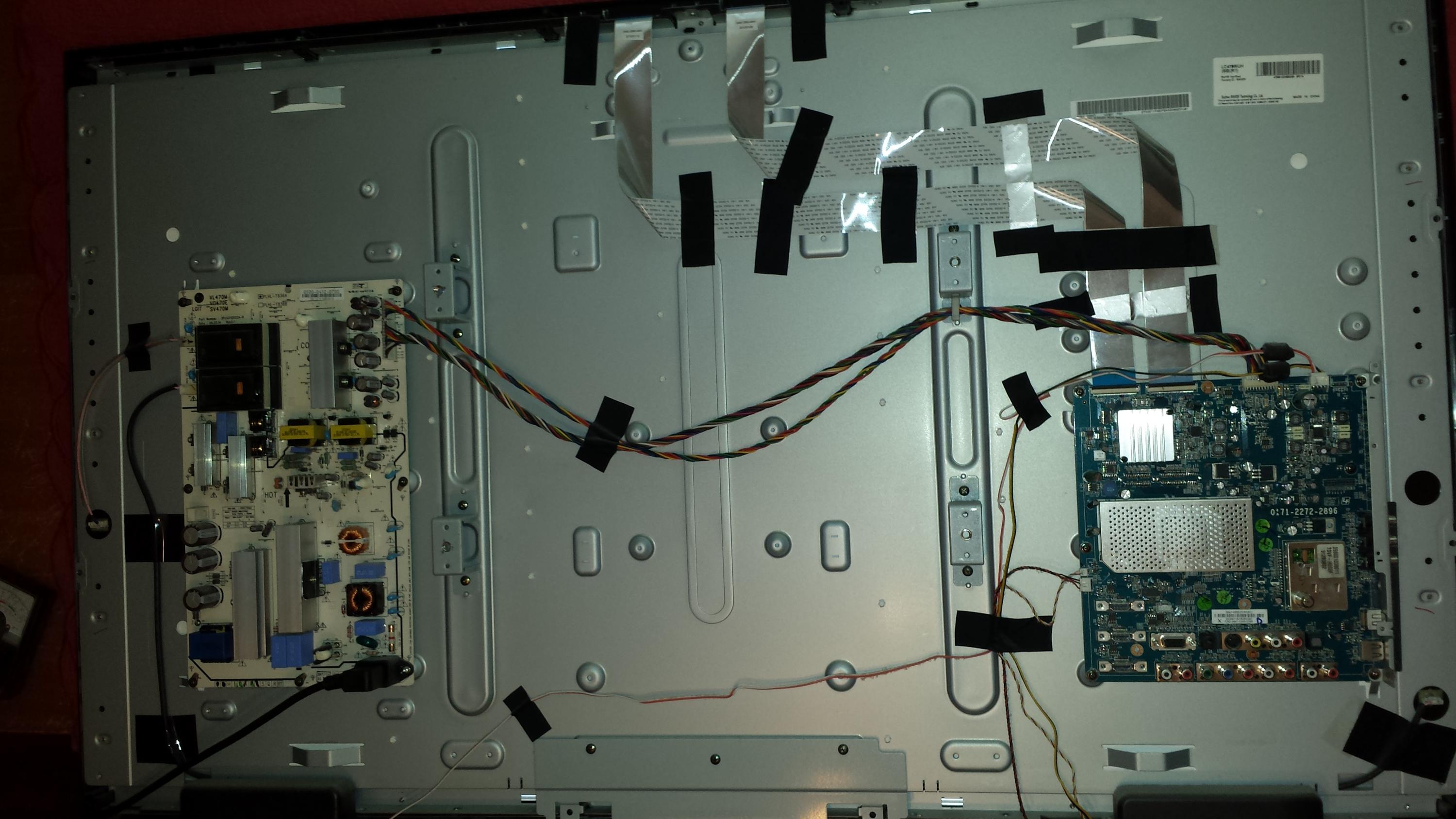

    Last night we were watching tv and the picture and sound went off. It was like you put the tv in standby mode. Awhile back one of the hdmi connectors stopped working. A few months ago the remote stopped working, not sure if it's the remote or the sensor, so i've been walking to the tv like it was 1982 to change the channels/volume/etc.
    So back to the main problem. I have unplugged the tv overnight and still no picture or sound. The visio on the front will light up but that is all. What do I need to check in regards to possibly determine the problem and replacing components?
    Re: Visio VL470M No Picture
    It sounds like the main board problem, but first thing to do is to up load good clear pictures of the back side of the TV so we can see what we are dealing with, then good clear pictures of each board so we can give you some voltage test points to help narrow down the problem. Do you have tools?

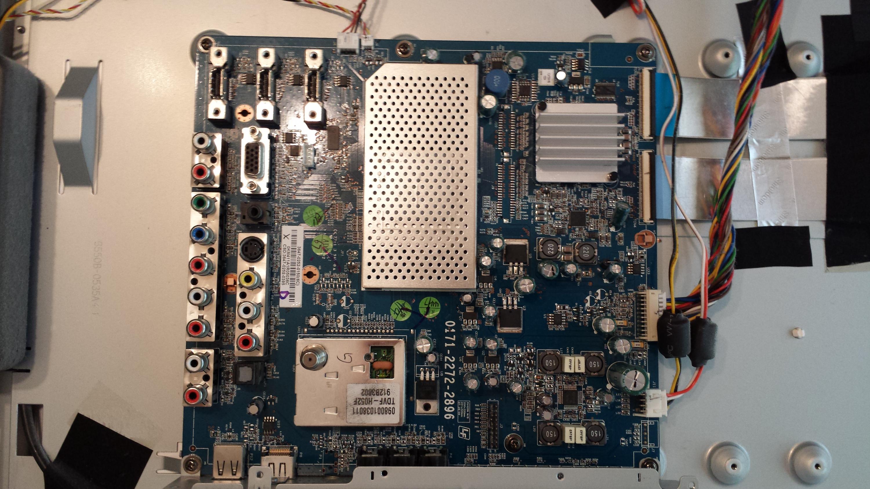

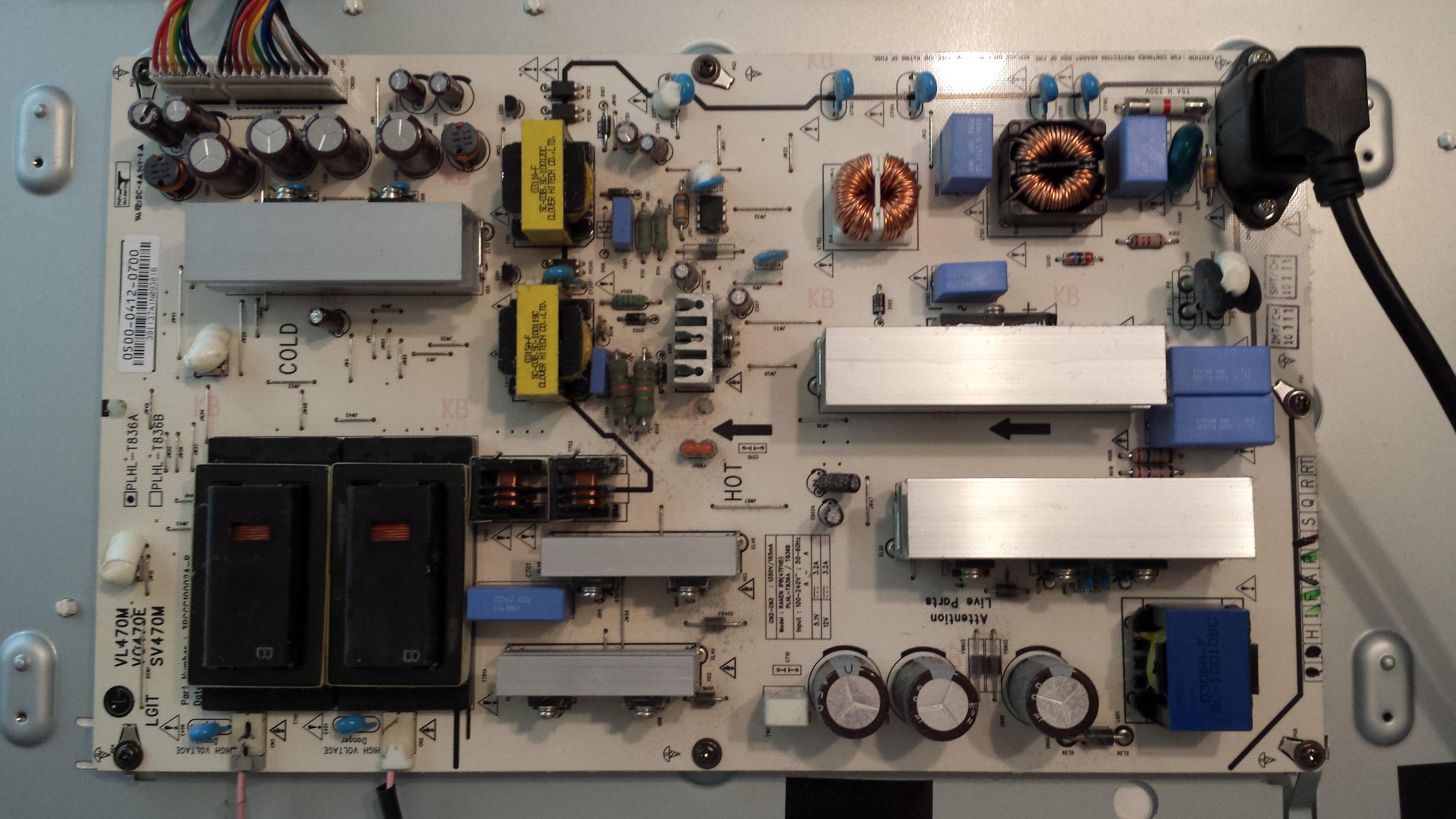

      Thanks for the response. I do have tools. I have attached pictures of the entire back, power board and main board.

        There are some 3-pin voltage regulators on that main board that you need to check the DC voltage readings.
        Please read this thread and report the readings in the format as shown.
        https://www.badcaps.net/forum/showth...999#post300999

                  What are the part numbers on U2,U3,U5 and U6 ? Input of 6.46 deffinatley seems bad.
                  U6 is surely bad.What is the voltage from the Power supply into the mmain board? Ususally 12 vdc in gets regulated to down to 5vdc then it goes to the other voltage regulators. 3.3vdc or 2.5vdc or even 1.8vdc. The part numbers when looked up will tell you what the input range is and the what the output is supplossed to be.

                    main in is 6.60

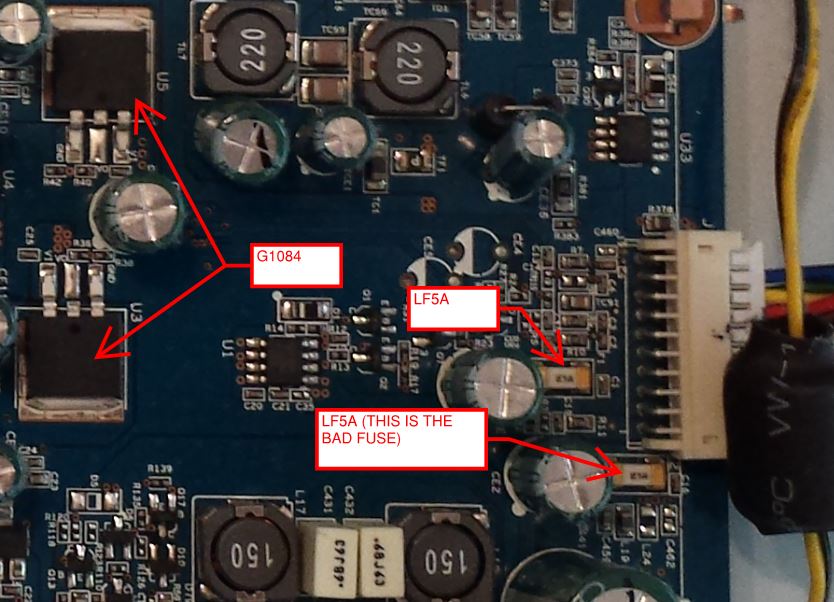

                              Ok guys I realized the multimeter I just purchased was defective so I purchased another. I do apologize for the faulty information and really appreciate your help! This is the correct voltages with tab up pins left to right:
                              U2
                              1117
                              pin 1 = 2.07
                              pin 2 = 3.33
                              pin 3 = 5.13
                              tab = 3.33

                              One of the LF5A fuses has 5.13 on both sides. The other has 12.26 on one side and 0.00 on other.

                                  I have confirmed that the LF5A fuse is faulty and needs to be replaced. How do I determine what fuse to buy from Digikey?

                                      The size is roughly 1/4"x3/32". Let me know if you need a closer view. Thanks!
                                        Just for testing purpose, you can use 5A axial lead fuse, or car fuse for now, just have to solder the wires to the legs of the fuse, then solder the wires to the blown fuse, no need to remove the old fuse, and see what you get.
