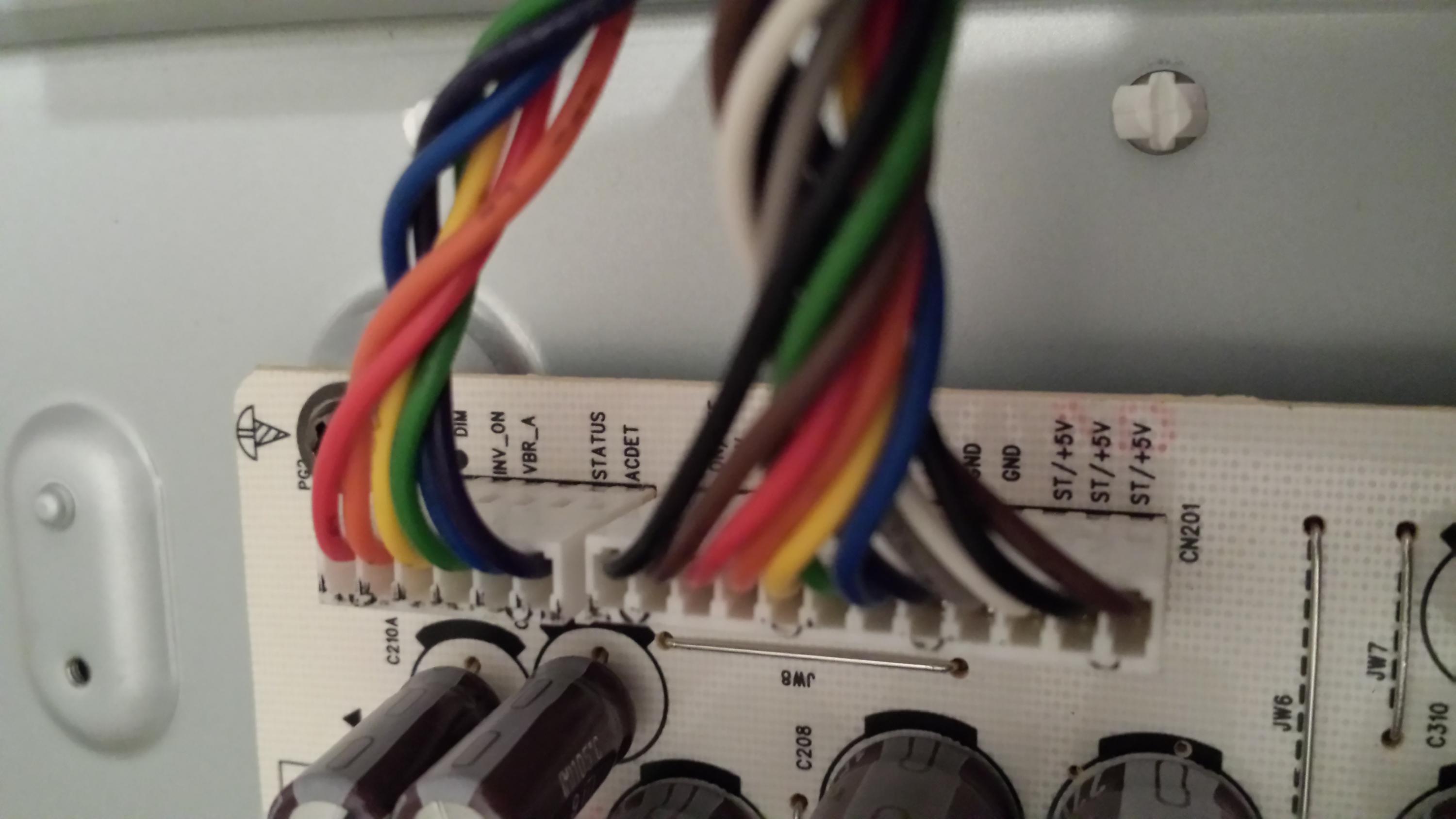

                    #29
                    Re: Visio VL470M No Picture
                    No. In the attached pic, the only voltage I'm getting is about 1.76 on the 4th pin starting at the far left. That pin does not have a description.

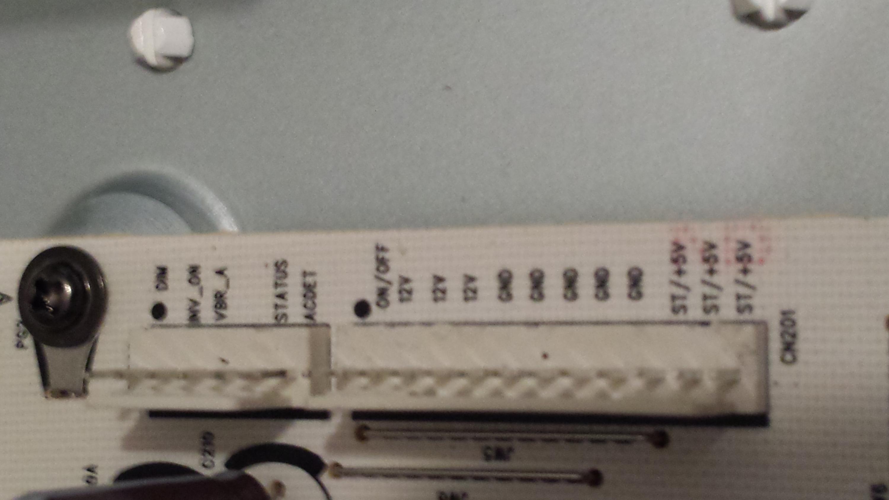

                      Can you remove the connectors so I can see the labeling of each pin of the connectors? The wires are in the way.
                                  sorry BudM, didn't see that post. Here is a new pic without the connectors.
                                    #37
                                    OK, check the DC voltage on the ON/OFF (PS_ON), INV_ON (BL_ON: Backlights ON) using black probe on the chassis, red probe on the pin, check when TV is OFF and when TV is ON.
                                      BudM, See attached image for the requested voltages.

                                          #40
                                          ON = with connectors from mainboard in socket
                                          OFF = without both connectors
                                          The reason I tested without both connectors is that when I plug the tv in, it is not in standby mode.
