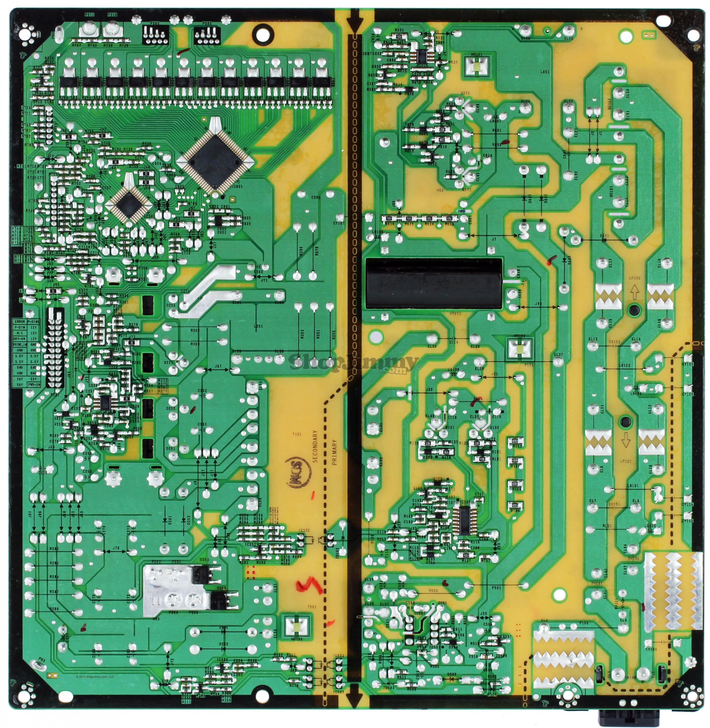

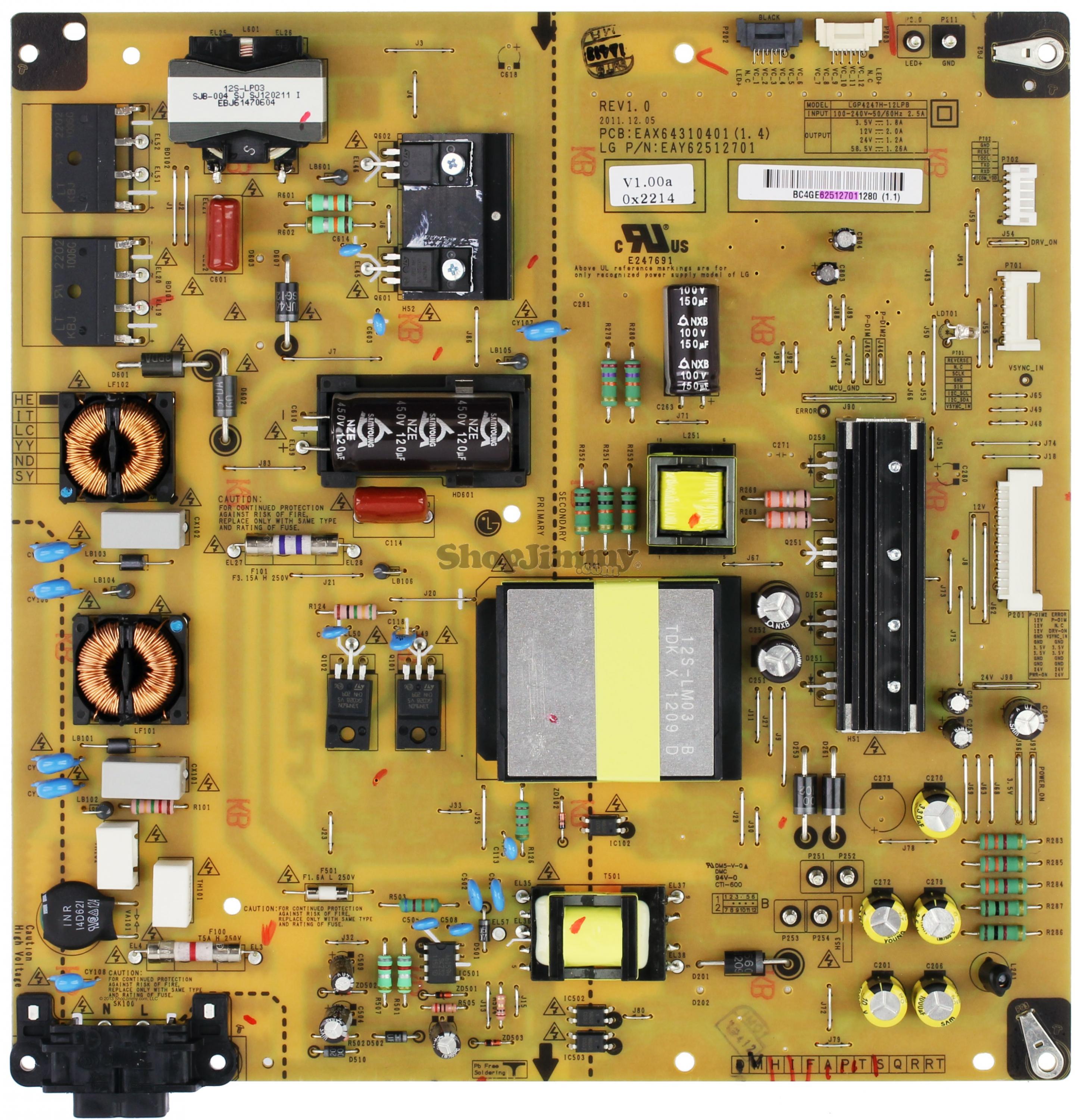

            We need to find out if the BL-ON (DRV-ON) signal to keep the backlights on is still present when the backlights drop out, so you need to check DCV on connector P201 DRV-ON to see if it has >2.5VDC at that pin when TV is on and when the backlights drops out.
            This TV has 12 LED strings controlled by 12 circuits. You will have to check the DCV of each pin of the LED connectors P202, P203. You MUST provide the pin names and follow by the DCV reading for EACH pin.
            Lg eay62512701 (eax64310401).
            Pictures provided by shopjimmy.

                Re: LG 47inch TV turns on but backlight shuts off quickly
                Drv-on is at 3.3v when BL comes on and stays exactly the same when BL goes off.
                LED + (P210) is at 36v when power is switched on and when BL comes on it goes to 56v then drops slightly to 53v when BL goes off.
                Connectors P201 and P202 voltages are all at 7v when BL is on but jumps to 18-19v when the BL goes off.
                  Originally posted by Diah
                  this PWB even if you disconnect the LED plugs the green indicator will turn on flashing . also its possible you have bad soldering ... if there no bad soldering then you have one shorted edge LED
                  Thanx Diah. I resoldered any suspicious connections and replaced main filter and C263 (100uf at 150 volts) and still the same so maybe it is LED array.
